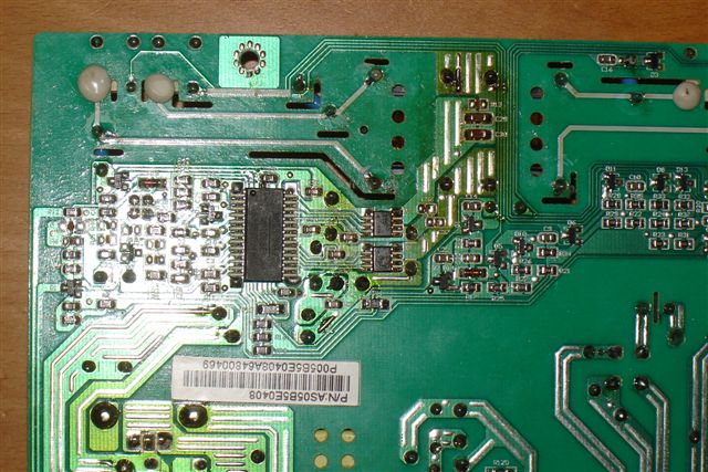

    Hi, everybody.
    I smoothly moved from level one - bad caps to level 2 - not working inverter.
    There is FSP055-2PI02A power board with inverter. I recapped it, but it still won't work. It starts only for 4-5 seconds and then turns CCFL off. During light on it hazzles silently. Inverter logic chip is MP1038EY.
    I want to replace those two N-MOSFETs, but I can't read type of them.
    Have you any suggestion, what type of MOSFET to use?
    Thank you
  • dondrusco
    • Apr 2009
    • 89
    Re: Fujitsu Scaleoview L22W-3 inverter fail
    I measured backlight transformer once again, and there is the problem.
    One secondary circuit has resistance 1kOhm - it is OK. But the second one has more than 10kOhm.
    The type is SPI 8TC00332. I found it only in the United States. Is there any option to buy it in Europe?
    Thank you in advance
    • dondrusco
      • Apr 2009
      • 89
      Fine, repaired.
      I ordered new transformer from lcdparts.net
      Now it works fine.

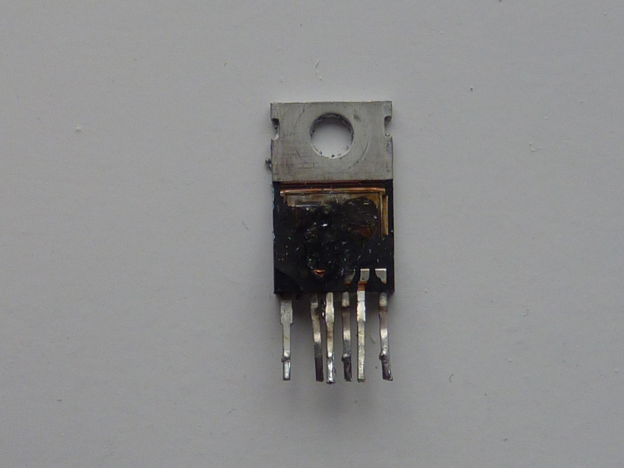

                  • Toasty
                    • Jul 2007
                    • 4171
                    Not a FET.
                    TOPSwitch.
                    Report mains cap brand and series please.
                    veritas odium parit
                    • BarrelRoll
                      • Jan 2011
                      • 34
                      I'm holding an X221W power supply in my hand right now. The IC in question is this:
                      First line:
                      F 1 H06
                      Second line:
                      CM0565R
                      • Toasty
                        • Jul 2007
                        • 4171
                        Fairchild - CM0565R - Power Switch
                        aka: TOPSwitch for all intents and purposes.
                        PDF attached
                        MOSFET Switcher, PWM combo
                        Not finding anyone with stock. Most are storehouses that want to sell you $300 - $1000 or better. Not one piece.
                        Toast
                        veritas odium parit
