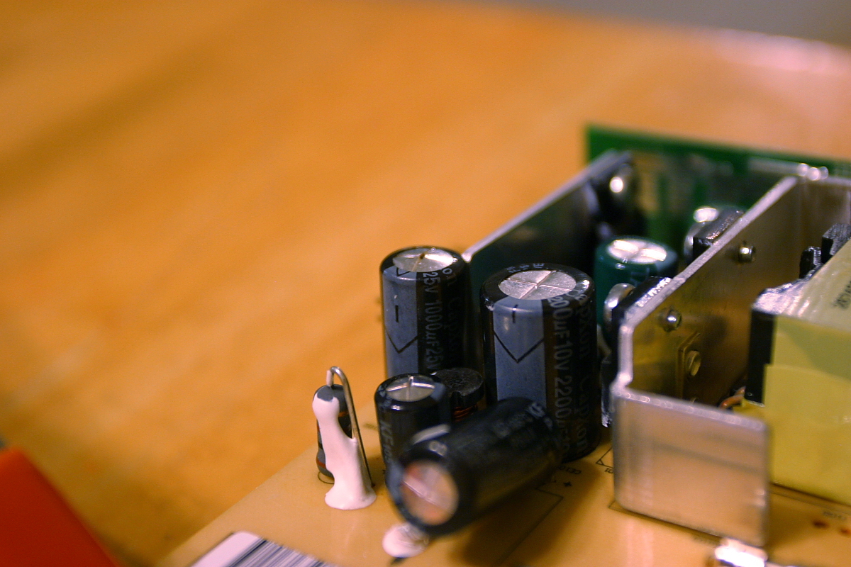

    Well, you won't believe it, but just 2 months after my HP L1906 LCD got caps replaced, my ViewSonic VX2235wm just instantly went very dim. Fresh from the HP repair, I decided to disassemble the ViewSonic, and guess what I found? You got it, bulging CapXcon's. Thankfully, there are only 9 caps on the power board, and of those only 7 were CapXcon. I will replace all but the monster 480uF. It appears OK as do the TAICON's. Will post pics when I get my parts from Digikey and do repair.

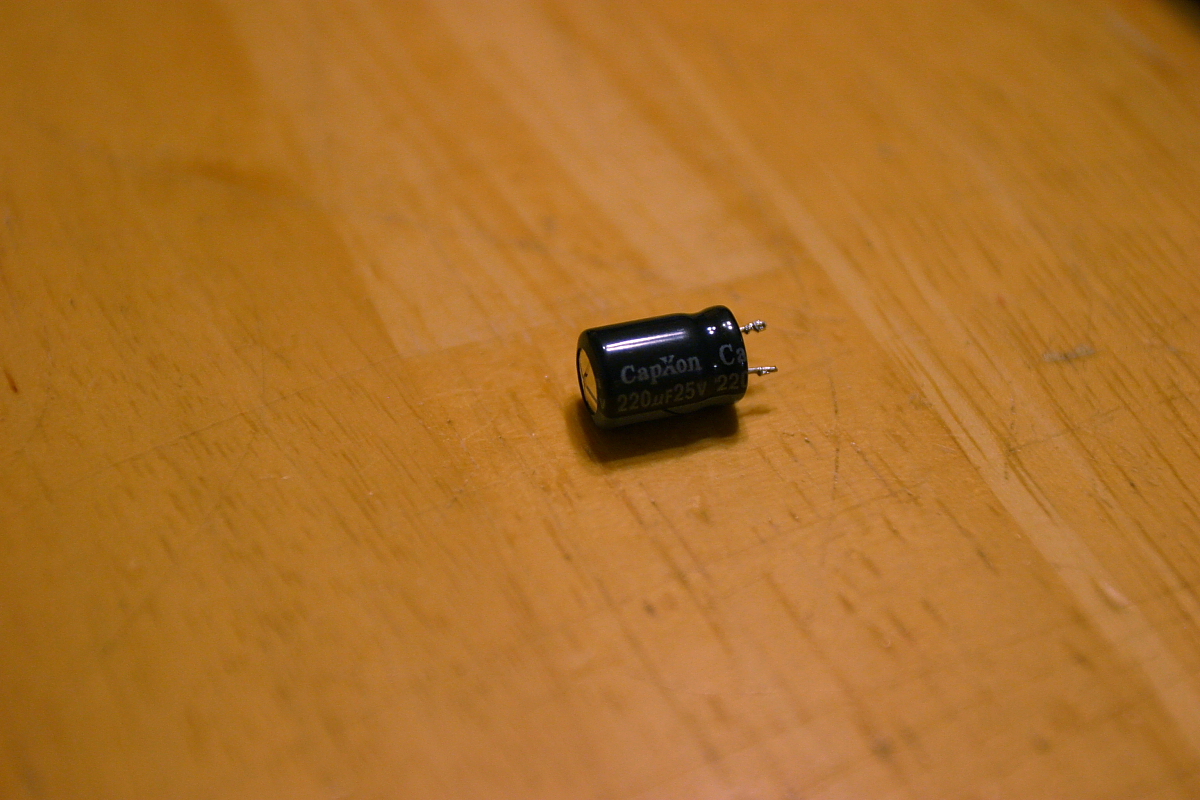

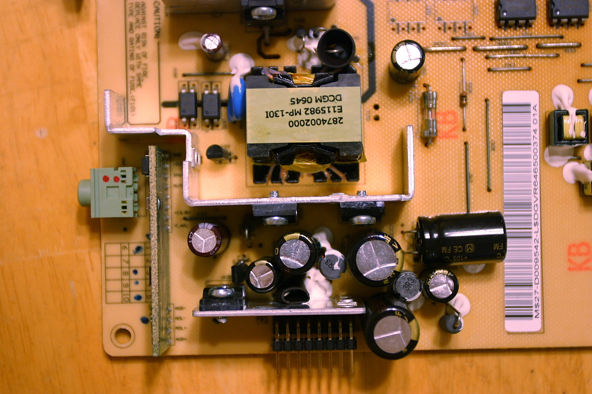

        OK, got my parts in from Digikey. Fast processing and shipping, as usual. Here are the board pics. Notice the black CapXcons are bulging. There were two that were in really bad shape with the bottoms literally coming out of the canister.

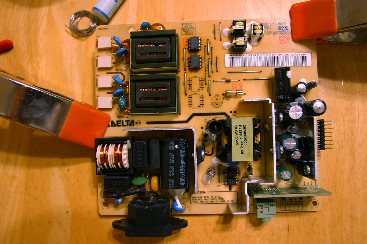

          Woohoo! Repair went great ... took all of 1 hour (see pic). Monitor is working great now. Nice bright picture, and running in digital mode without any static lines. Hard to believe you don't see these capacitor problems on one of those CNBC or CNN specials. I wonder how much unnecessary landfill space has been taken up with electronics that only had bad caps. Amazing huh?
