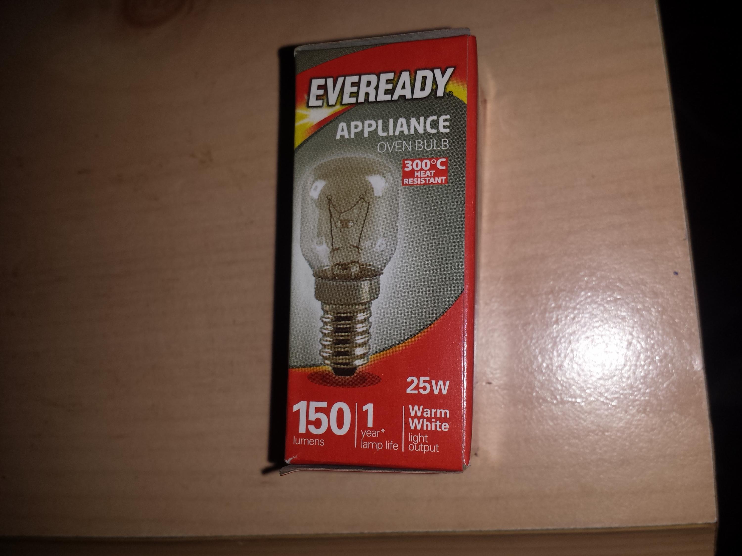

          #124
          Re: Help with dead Commodore 1802
          Originally posted by R_J
          What do you have in place of the resistor? if there is nothing there, You will not get any voltage across the capacitor because you are not getting any AC to the diodes.
          I put this bulb ain place of the resistor maybe i need a bigger bulb? It measures 72.5 ohms.
            • 31260
            #125
            strange, you should see some voltage and some life from the lamp.

              #126
              Well I just wired one of those ever ready bulbs to 240v mains and it doesnt light up. They all seem to be the same. They are nor open circuit and show a resistance but dont iluminate with 240v ac. I think these bulbs are what are fitted into ovens etc but surely they should light up. I will go andf buy some more of the bigger ceiling type bulbs tomorrow and have another go. No wonder we havent been getting anywhere.
                • 31260
                #127
                it's really strange that you see a resistance but no life - be interesting to do an autopsy and cut the metal cap open!

                    #129
                    I just checked a couple incandescent lamps, these are 120vac 60watt = 16Ω. (Christmas light) 120vac 7 watt = 189Ω, Appliance lamp 120vac 40watt = 27Ω
                    You are not going to believe this but that length of 3 core flex i was using had a break in it and after i cut 6 inches of each end it now works. What are the chances of that.
                    I didnt think to check the cable as it looked like it was good. Anyway i now have the bulbs iluminating as they should. I will have another go at it later now to see if i can make any sense now over what we checked.

                            #133
                            The bulb you are using has too high a resistance, and remember that 72.5Ω you measured is the DC resistance, it is going to increase even more when it lights.
                            The A/C voltage is being droped from 240vac to around 13vac to supply the diodes which then outputs 18vdc.
                            So you need to find a regular 60~100 watt Incandescent lamp
