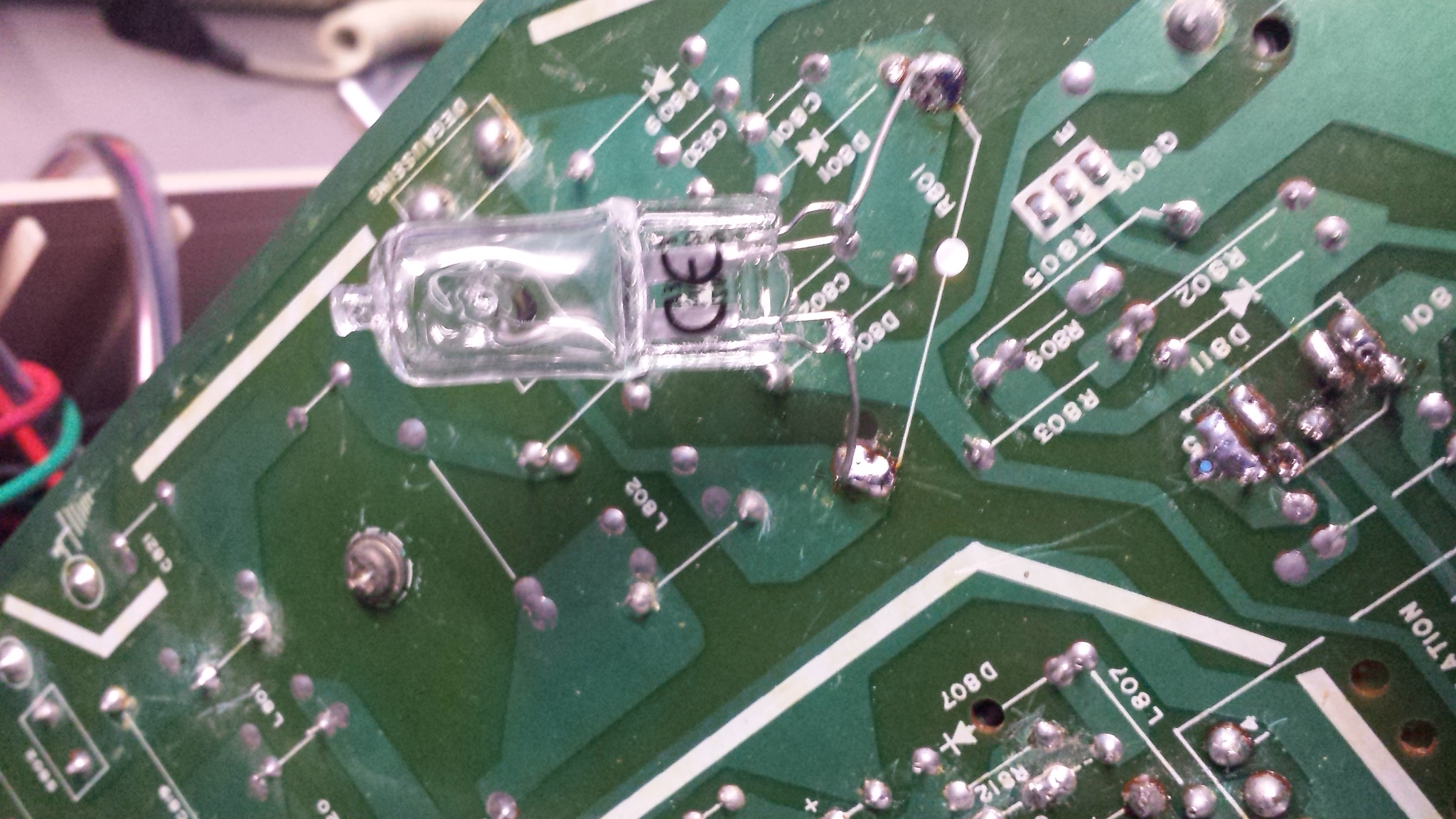

                      Really good idea that STJ. I managed to get a nice little 240v 20w halogen bulb and removed the resistor soldering the bulb it its place.
                      Before I power up the monitor I want to check this will do the job.

                        is that really a 240v lamp? i thought the ones with straight pins where 12v?

                          Yes its got U shape pins (see attached) and I had to solder them to a couple bits of wire I soldered into the holes the resisitor goes. I hope this will do.

                            it will work for the task, although a not-halogen bulb has slower inrush.
