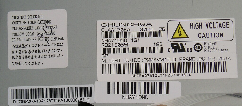

    What screen does it have (panel)? AUO, Chimei, Samsung? Maybe I have a spare one to give you.

            Panel is made by Chunghwa.

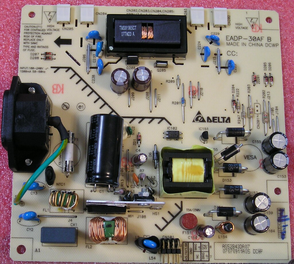

            Power supply board has 2 1000uF 10V Nichicon PW(M) caps in parallel for the 5.1 Volt supply, 2 680uF 25V Nichicon HD(M) caps in parallel for the inverter. I did not remove them from the board, but the ESR was less than .05 for each pair. This is in the range where wiggling a probe will change the reading.
            There is also a pair of 470uF 25V Capxon GLs in the inverter. I didn't bother testing those.

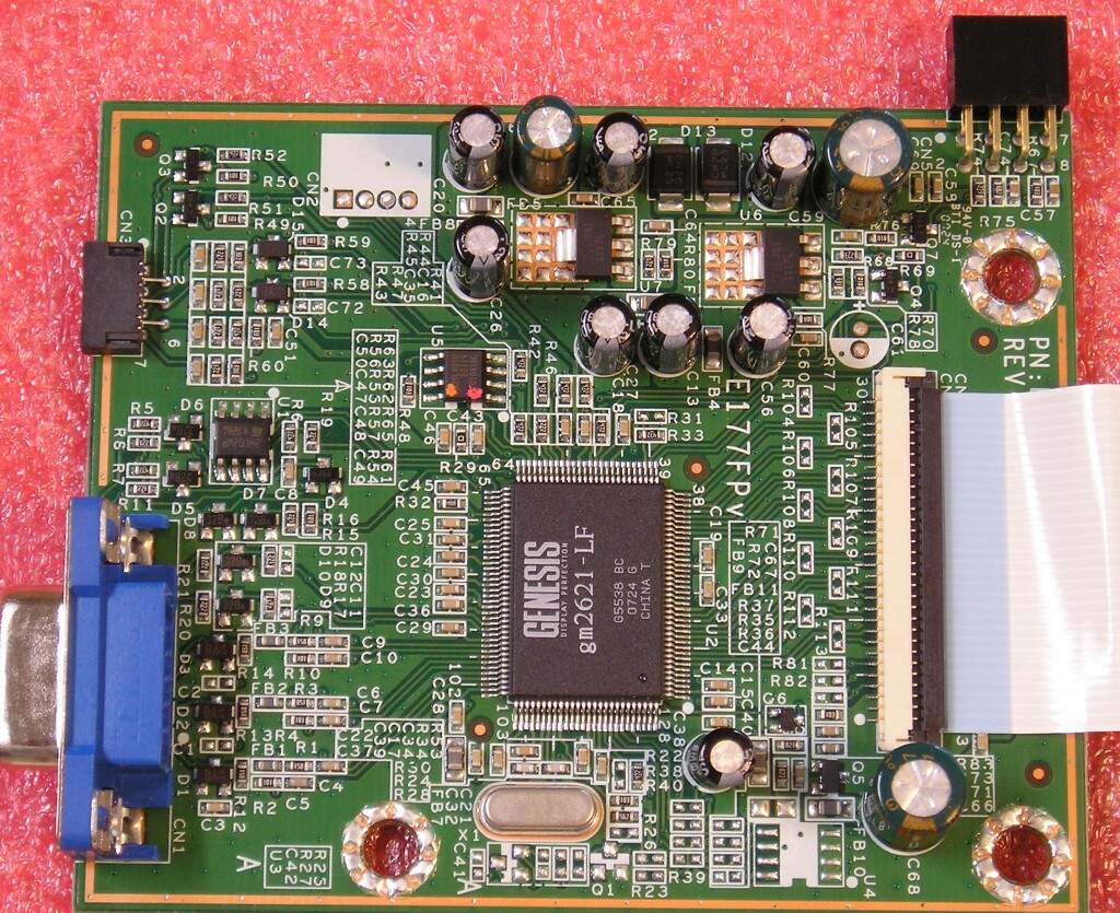

            The logic board is a little more complex. It has 11 capacitors in five groups.
            Group 1 was a 330uF 16V Teapo SC with an ESR of .06
            Group 2 was a 22uF 25V Luxon SM with an ESR of 1.1
            Group 3 was a 330uF 16V Teapo SC in parallel with a 22uF 25V Luxon SM, the pair had an ESR of .06
            Group 4 was four 22uF 25V Luxon SM in parallel, the group had an ESR of .40
            Group 5 was a 100uF 25V Teapo SC in parallel with two 22uF 25V Luxon SM, the group had an ESR of .30
            There appear to be two voltage regulators on the logic board. I have not tried to measure the voltage out of each. I have been unable to find a data sheet for the Gemini chip that gives it's power supply voltages.
              Panel is made by Chunghwa. Testing with a known good panel will tell me where to look. I don't mind replacing all the caps on the boards, but I'm not going to do that until I have confidence it's not the panel.
                    Bill
                    No luck. I have 15" and 19" Chung Hwa panels, not 17". Looking at my notes, I had three Hanns-G 171D with that same problem, and the three panesl were dead. I still have one complete panel, another gave the CCFLs for another unit, and one was fixed with a panel from another unit. But the constant there was the gm chip and the white screens. Fuse on panel was right on the three panels I had and yet only white screen. I tested the three VBoards with the good panel and they are OK. My panes were bad. I guess yours is too

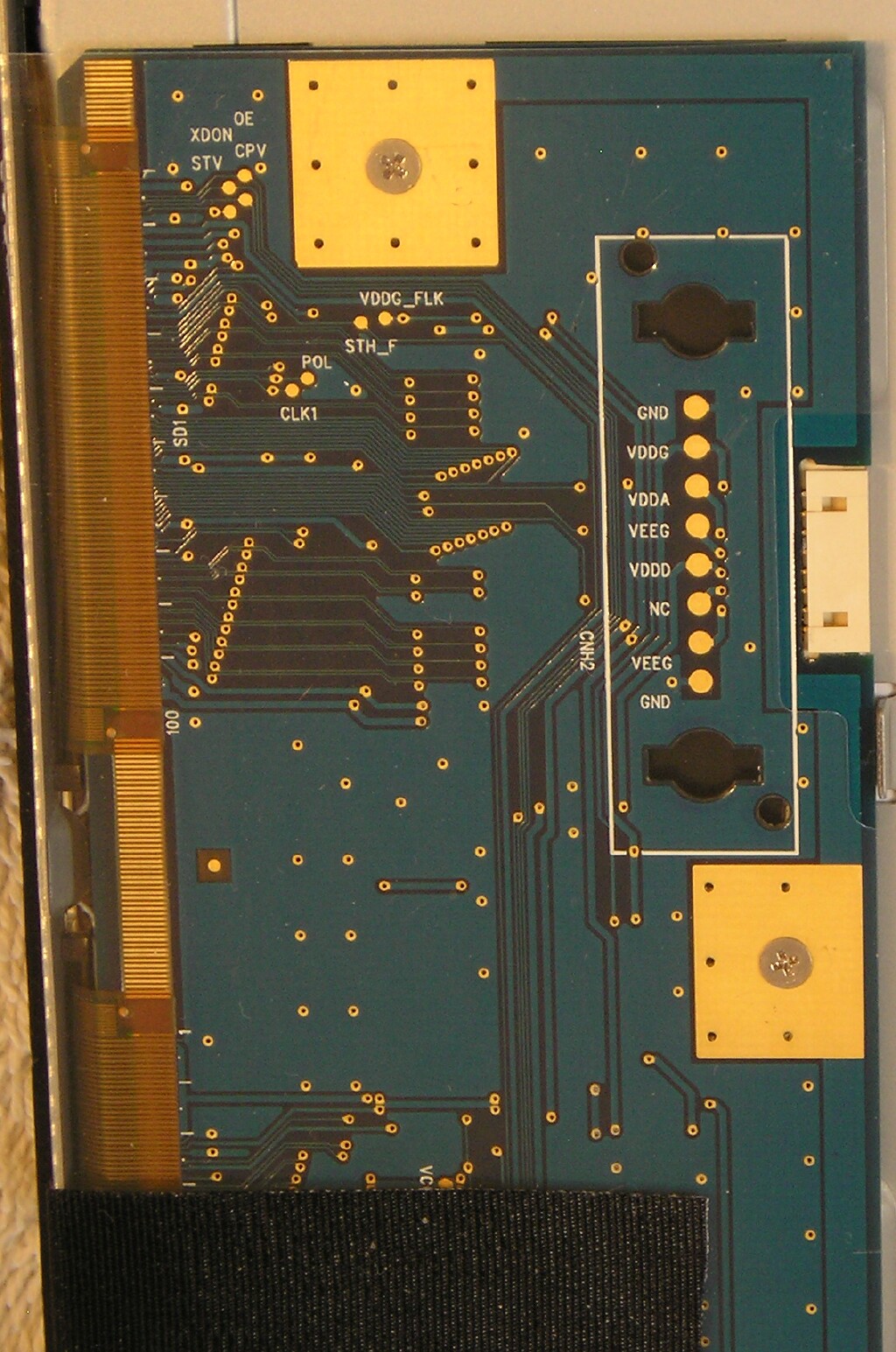

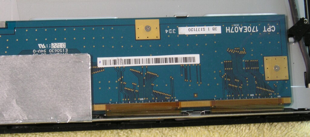

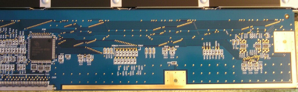

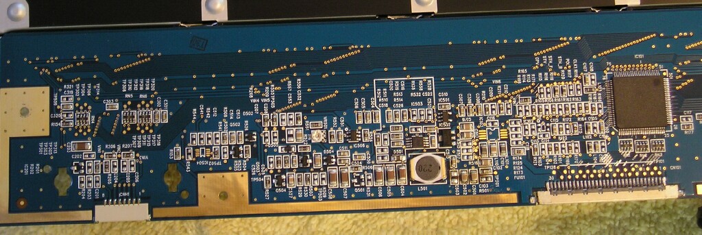

                        To clarify details on the panel, I've taken a few more pictures. I've discovered a tripod makes doing that so much easier!!
                        Working on the LCD panel electronics board doesn't look to bad - provided you enjoy soldering with a tip the size of a sewing needle and using a microscope to view the components.
