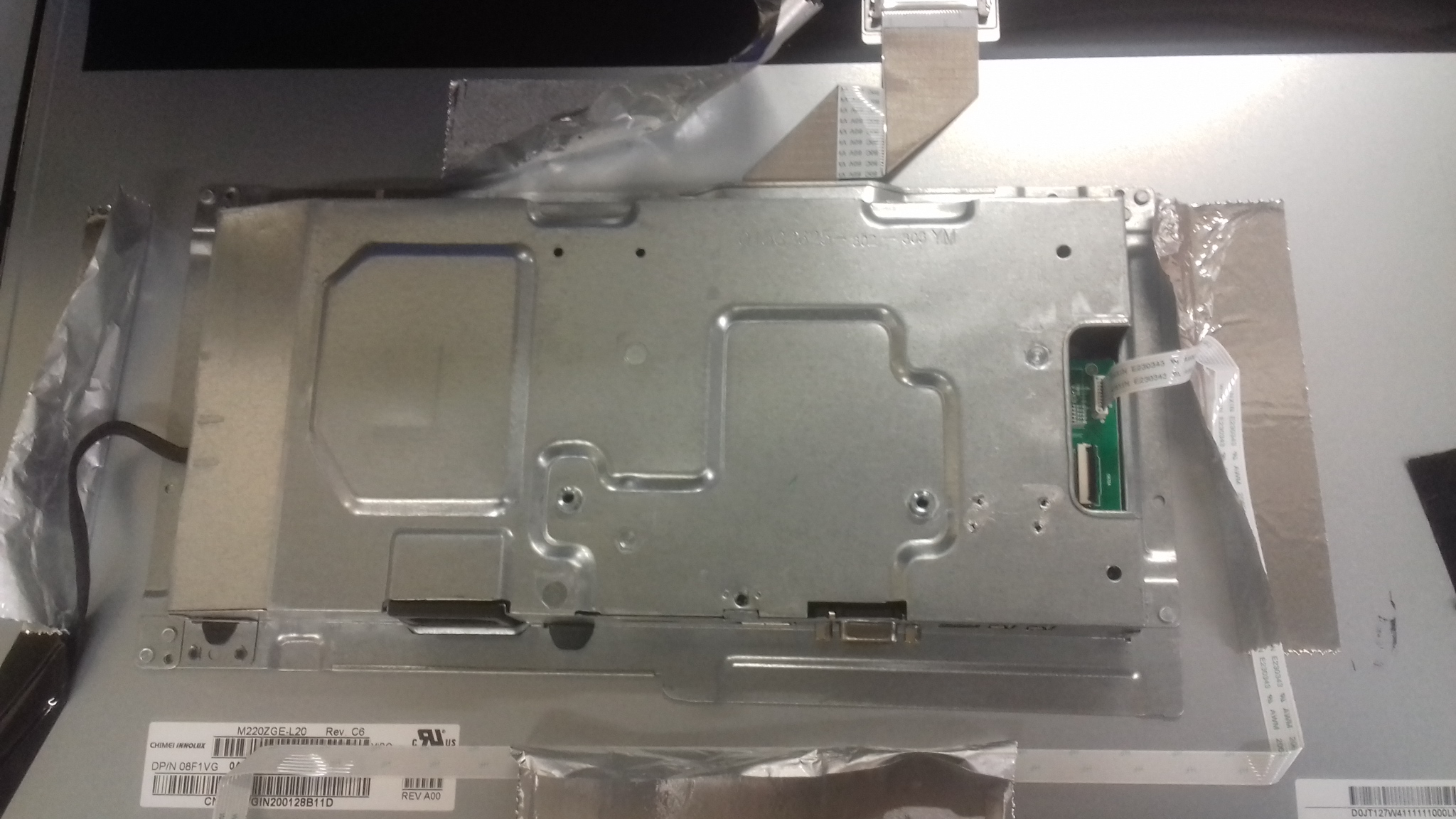

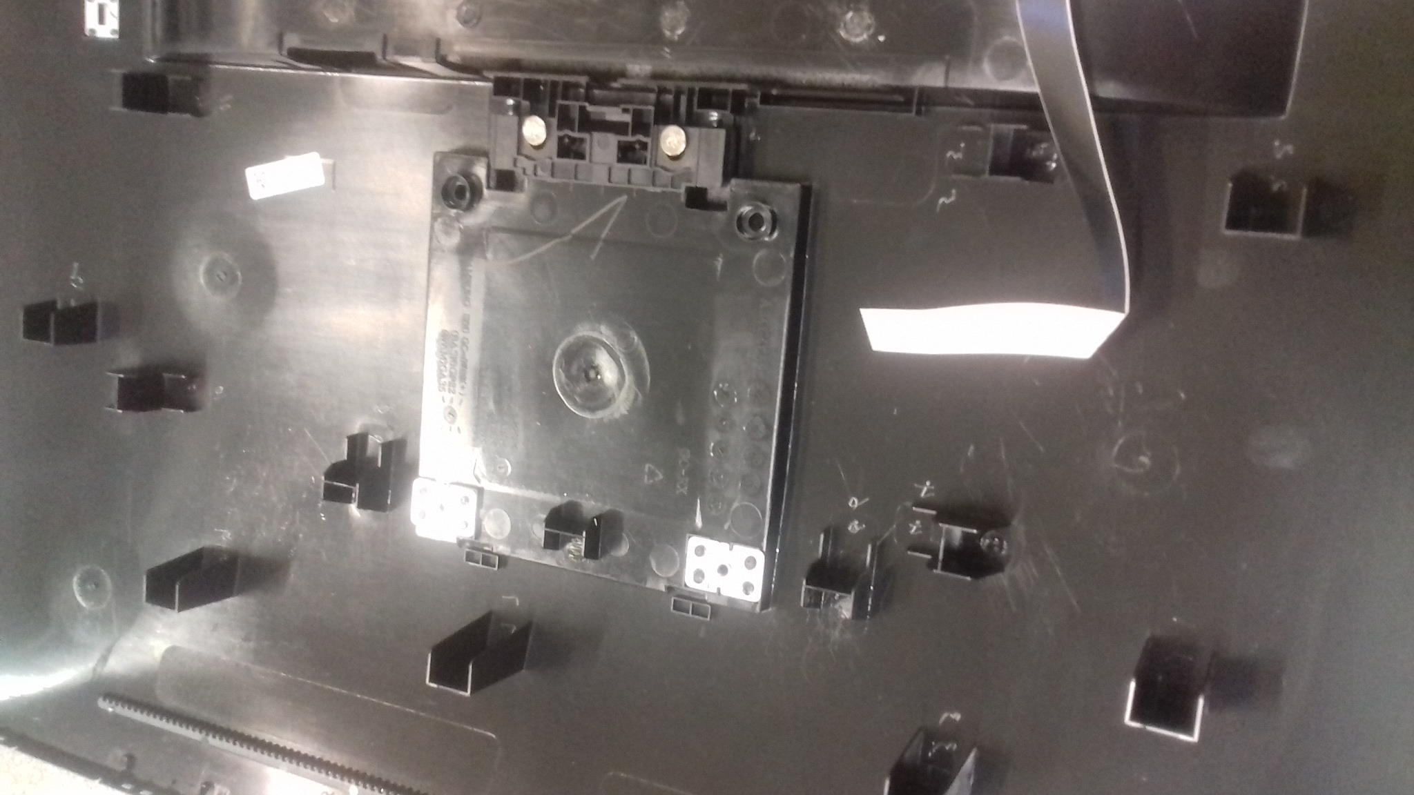

    Anyway, open it up (not too bad, clips came apart easier than some), but first thing I notice is that the enclosure is fully stuck on using silver tape, no locating lines or holes for screws. The back of the monitor has deep mouldings to locate the enclosure when putting it back together though.

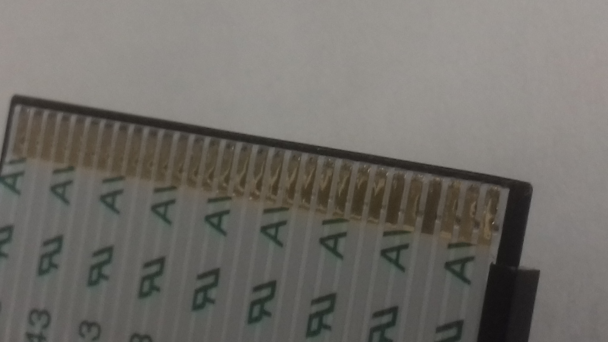

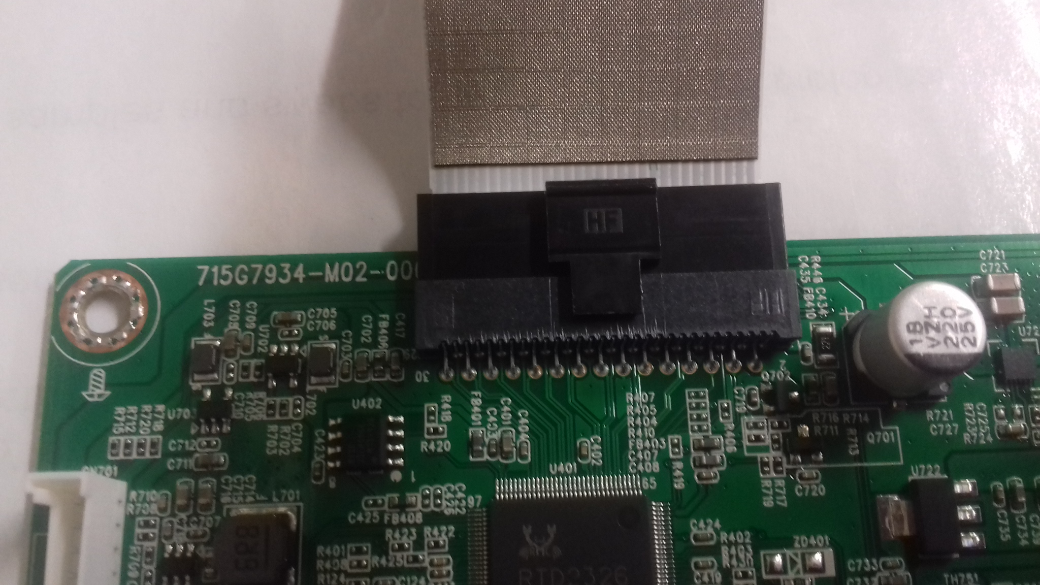

    I had a look at the boards and couldn't see anything obviously bad. Had a look at the video cable, and when I disconnected it from the video board, some of the pins (the right-most ones on the thumbnail photo, bottom pins on full view photo) looked a bit screwy, hard to pick it up on the photo. That end of the cable appears to be glued onto the plastic clip that then goes into the connector. I pressed around the pins to flatten them, connected and disconnected the cable a few times, half put the monitor back together, and the video comes on fine!
