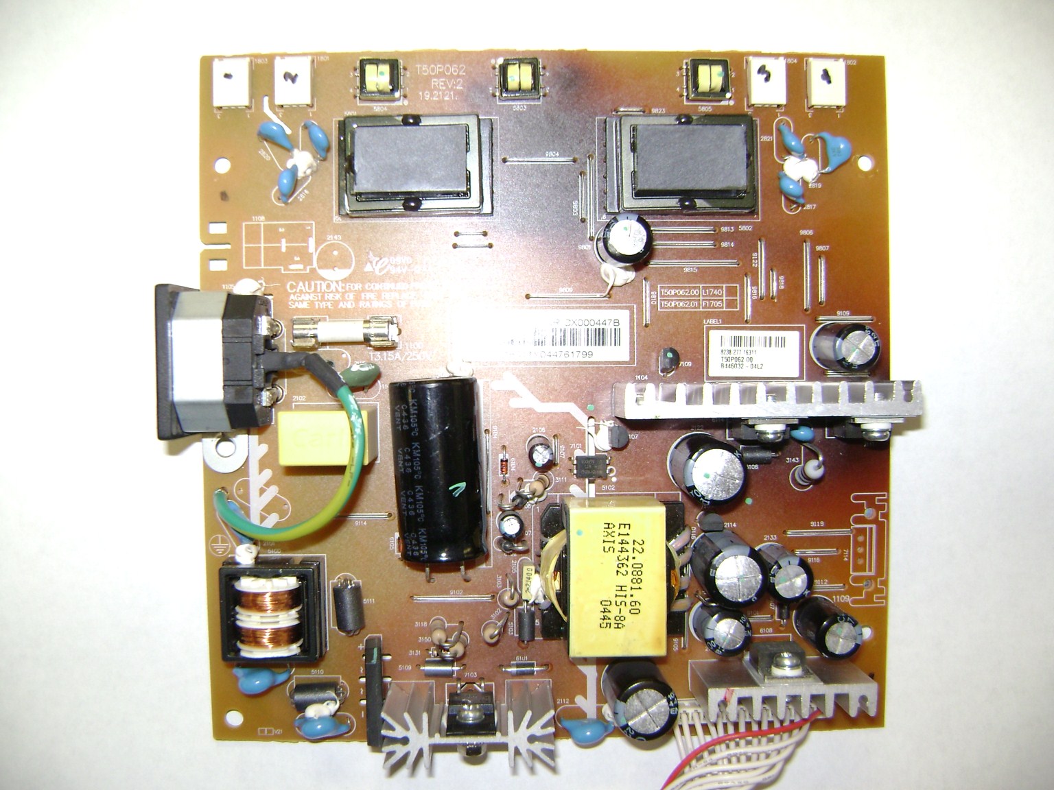

    c5707 or 2sc5707 replacements found
    I just found this place earlier today and have been reading all morning. first off thanks for all the help so far. anyway while working on some hp 1740 monitors i have found that the c5707's on benq inverter boards (in this case 48.L1G02.A01) often fail. While looking for replacements I contacted a Mouser tech and was directed to this as a upgraded replacement http://www.mouser.com/Search/Product...bbdniJVM8qc%3d
    I just ordered them and thought I would share this info with the rest of the class.

    Re: c5707 or 2sc5707 replacements found
    not even close!
      Well thanks
      I already ordered them on there advice, Looks like i'm off to ebay to get them then.
        You can return them, or if they were all you ordered, just refuse the package (leave BIG note for delivery service). Contact them and relate the info that their tech misguided you.
              dmbj,
              here's a picture of the inverter/power supply board used in one of the four
              hp L1740 lcd monitors.
              George
                I hope that board darkening is from the C5707s and not from shorted turns in the transformer which caused them to blow.
