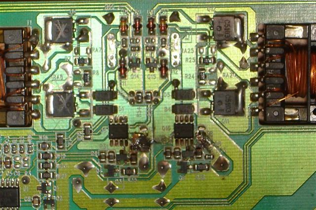

    I have one power board from 20'' LCD Gericom. It has 6 CCFTs.
    It has Royer circuit in inverter. I found 2 SMT capacitors fired.
    I want to replace two transistors SC S5103 in Royer + 2x capacitors (cold join)
    A question - capacity/voltage of this capacitors, and what about MOSFET APM9435 - replace too?

    Re: Gericom T2000 inverter caps
    OK, I measured all transistors and schottky diodes - they are OK.
    I soldered cold join on 1 cap and make bridge over fired PCB - monitor works!
    I need only advice, what kind of capacitors to use instead of fired.
      Thanks to this forum - I found similar board with the same symptoms and solution.
      https://www.badcaps.net/forum/showthread.php?t=5346
      Admin, you can close this thread
