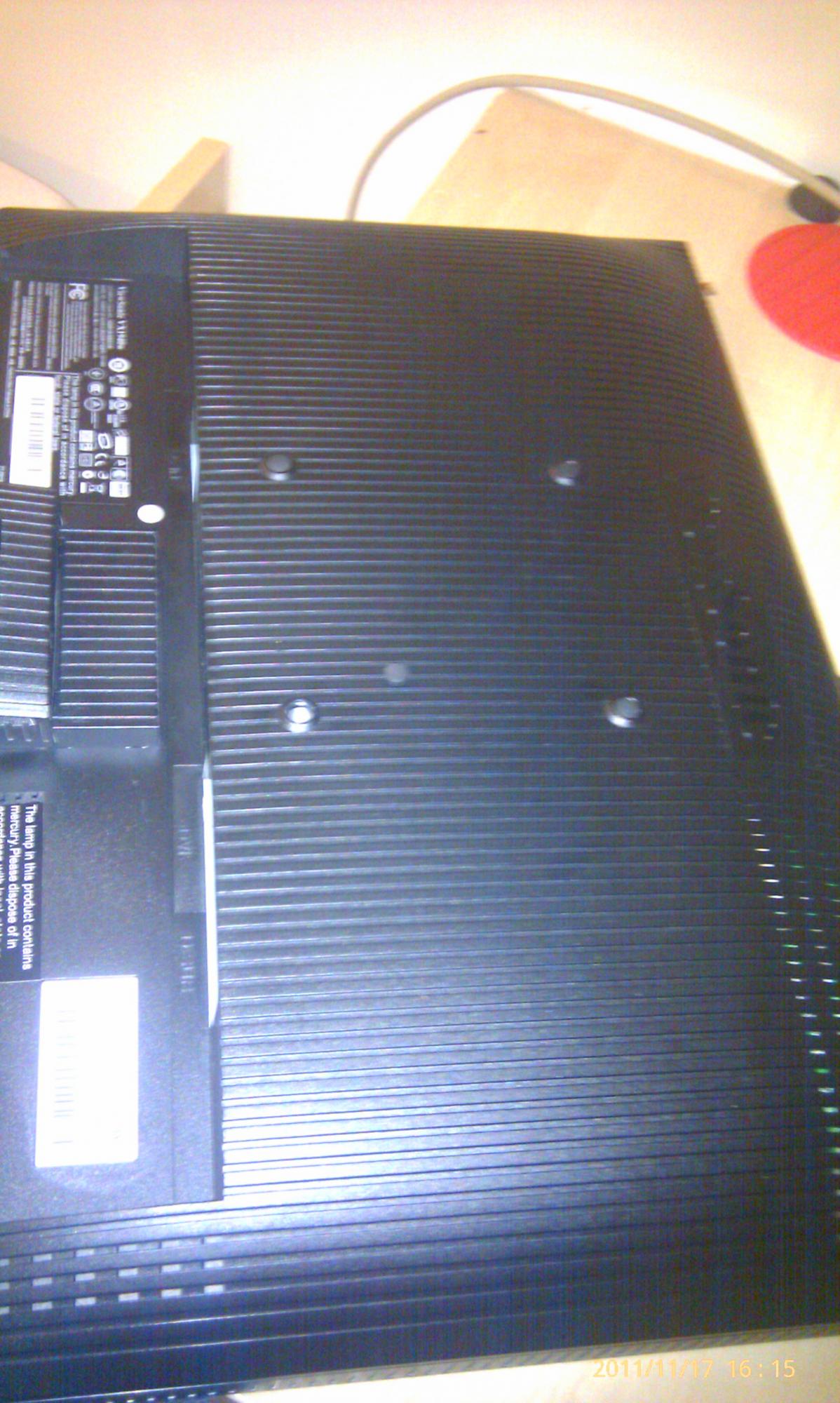

                            Re: ViewSonic VX1940w
                            Front bezel? Could you explain a bit more?
                            Also, just saw at the back theres four screw holes. But there not screws (see attached images). Any ideas here?
                            • jayoung
                              • May 2011
                              • 172
                              The screw holes in the back are utilized when the monitor is wall mounted as opposed to free standing on it's own stand.

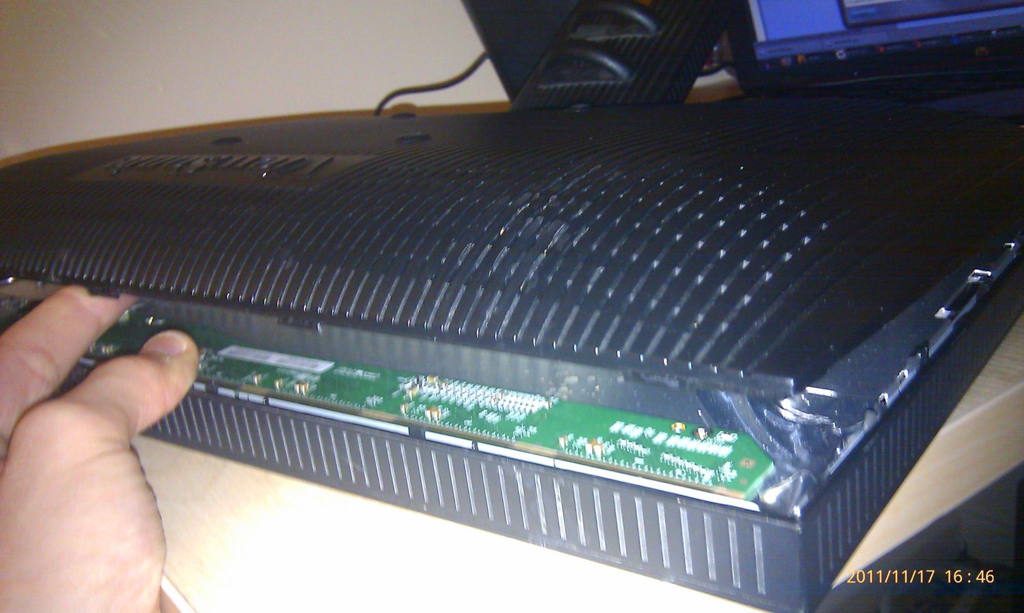

                                • Tjcrazy
                                  • Nov 2011
                                  • 29
                                  Ive managed to get most of the screen case of (see pic), but theres still something not prying lose.
                                  I think it may be some screws at the rear bottom of the case, that holds the case stand in place (see pics). Any idea how to get to these to unscrew them? At the moment they are under the plastic casing.

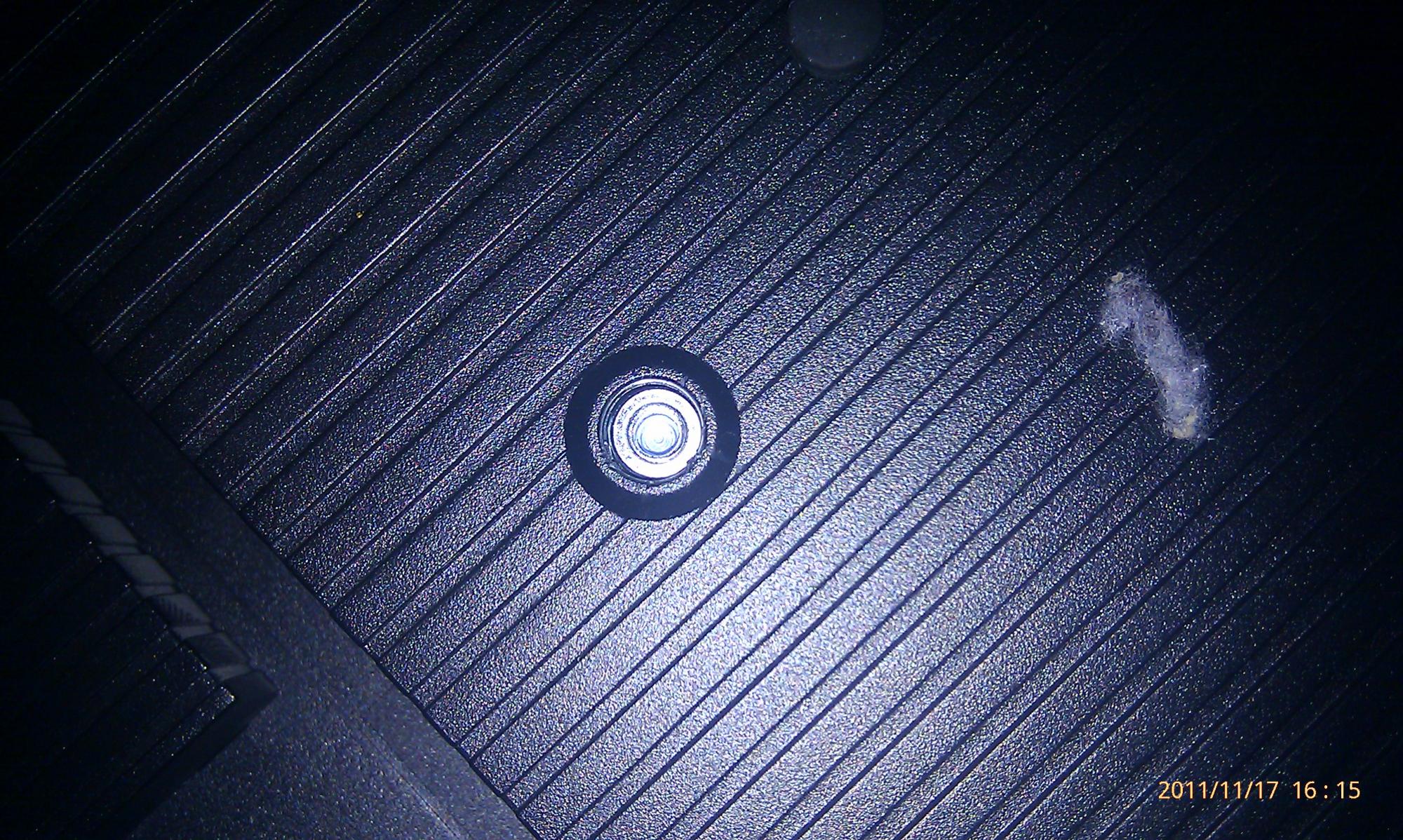

                                  • jayoung
                                    • May 2011
                                    • 172
                                    It appears that the base needs to be removed before the rest will come off. The base is sometimes held on with screws, but sometimes it just slides on and snaps in place. I would check to see if the plastic part above the base will "pop" off and expose any screws beneath it.
                                    • alexanna
                                      • Mar 2010
                                      • 1346
                                      get a flash light and look straight down hollow part of the base,where the stand was snapped in,there's probably 3 or 4 screws holding it on.
                                      Whatever I do, I consider it a success, if in the end I am breathing, seeing, feeling and hearing!
                                      • Tjcrazy
                                        • Nov 2011
                                        • 29
                                        Woo! Yeah, got access to the screws. Problem is, being a newly moved in uni student, I dont own a screwdriver.. so I guess I'll have to purchase one tomorrow.
