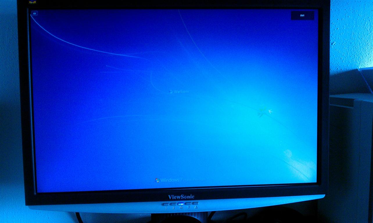

                      Well, today after work i went to the electronics shop i mentioned before.
                      They didn't have the exact same caps, but they promised me the ones they gave me would work.
                      After paying 2.95 euro's, i went home, plugged in the soldering iron, and waited impatiencently.
                      On the images you can see how it went.
                      They fitted like a glove, and the soldering went fine (no, not pro. but still pretty good i recon).
                      Put everything together, and.... well... check the pictures.
                      I geuss i owe you all a very very very huge thanks.
                      Instead of having to spend 100 euro's on a new screen, i fixed it for 2.95 euro.
                      AWESOME! (now just hope it won't break down again).
