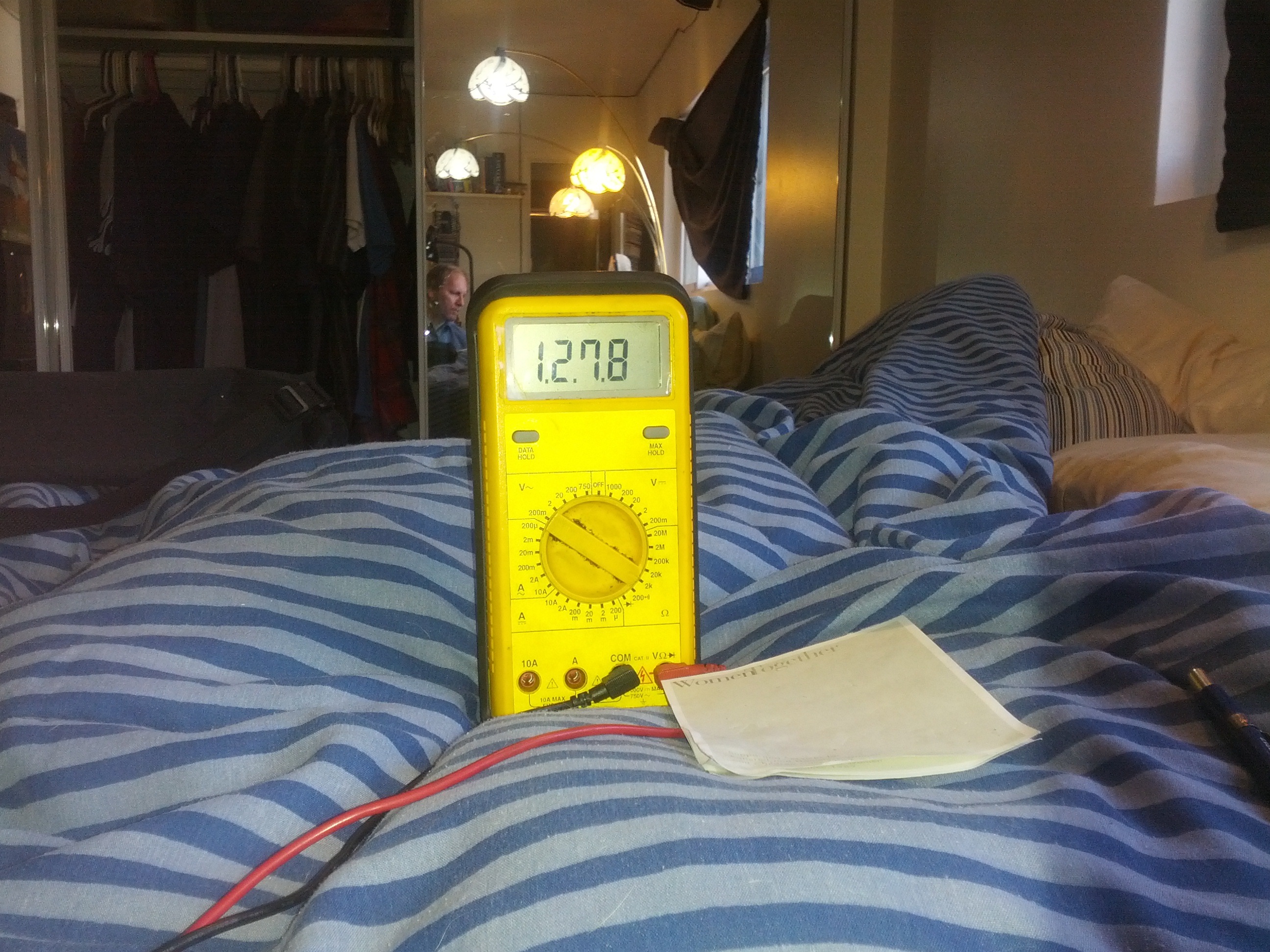

    Power off - do this test

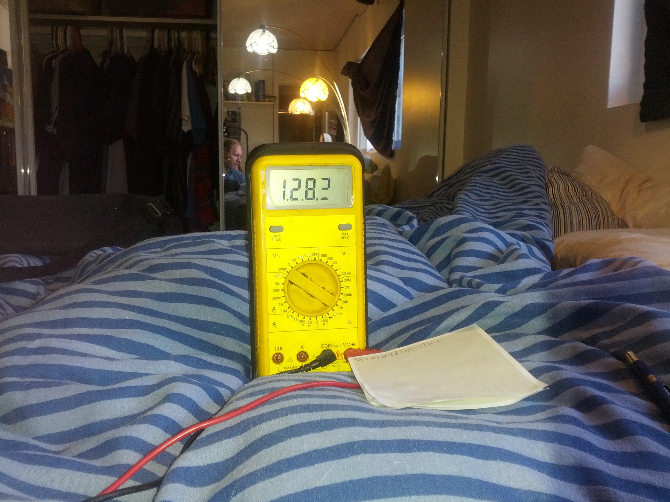

      OK did the test. Check out the files attached. Rar files have video files in them. When I first put probe on yellow contacts my readings were 1.7.X.X then started dropping slowly but then stabilized at around 1.3.x.x. The same happened with red contacts but readings started at 1.6.xx then dropped and stabilized around 1.2.8.0. Further readings looked like what you see in the videos (1.3.xx then dropping a little then stabilizing).

        Just the figures would do - they seem to be within 3% so ok.
        (never seen dots between each digit before.)
        You need to examine the ends of the ccls for burning/bad wiring.
        Do you have a spare bulb in another monitor or can you make one of these.
        https://www.badcaps.net/forum/showthread.php?t=19987
          @selldoor re the decimal point
          http://www.eevblog.com/forum/chat/re...900/#msg172900
          http://www.eevblog.com/forum/chat/re...909/#msg172909
          http://www.eevblog.com/forum/chat/re...979/#msg172979

            Hmm that could be interesting then. - perhaps OP should start on fixing his meter?
