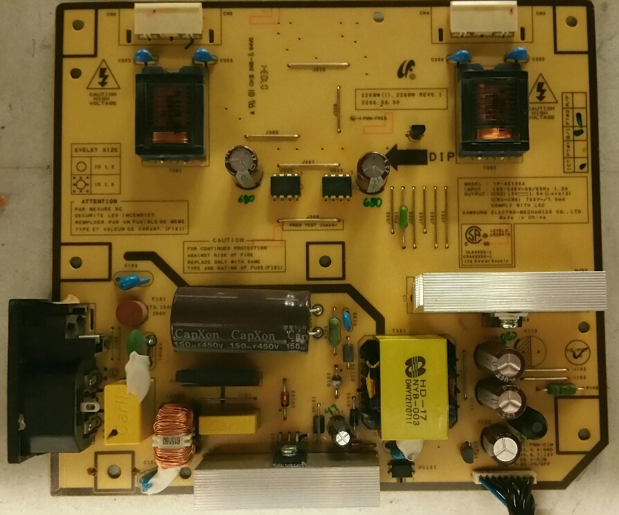

        Ok, I have a Rev. 0.1 board and had the same problem as everyone else. I replaced all 6 Caps with the ones listed in this thread.
        Now I have NO POWER at all. No power LED or anything. I've checked TH101 and F101, all good. I have .04vAC across the leads of C105 (Big Cap). I put the old C107 back in to verify and same problem. Not sure of where to test next...

            How about good clear pictures of the top and the bottom sides of YOUR board?
            BTW, are you talking about the AC Voltage reading on the bog black DC main filter cap C105?

                So why do you try to read AC on the DC cap? It should have about 160~170VDC reading between the two legs of that main filter cap if the 120Vac input is present at the rectifier AC input legs (two inner legs).

                  Don't go on a goose chase. C105 should have 170 DC VOLTS not AC volts on it.
                  Just back up and look for cold solder joints/bridges. The standby voltage should be there. Sometimes I've added a new problem when recapping these boards.

                    Ok, yup, silly me. It does have the 167VDC there. I'll try reflowing the solder.
                    Ok, solder reflow worked, Now I have rapid flashing power LED... and slight clicking sound from "HOT" area on board.
                    Edit #3: Ok, Held power button for like 10 seconds, and seemed to turn on. Going to throw it back together and see if it works...

                                        If you run these Samsung LCD monitors "into the ground" - keep using them with shot PSU caps and high ripple on the +13V rail, the other capacitors get cooked on the IP board.
                                        I also replace the IP board caps for the +13V_IN to 5V and 3.3V buck regulators. 100uF input and the outputs are usually polymer.
                                        This stops the oddball problems with the digital board which happen due to the power supply board having bad caps.

                                          I opened it today, just for a check, and wanted to measure the big cap 150uF/450V...
                                          Cap measured 119uF. That's why it always seemed not that "bright" enough. A new 180uF/450V is in it now. Monitor now is much better in terms of colour...
