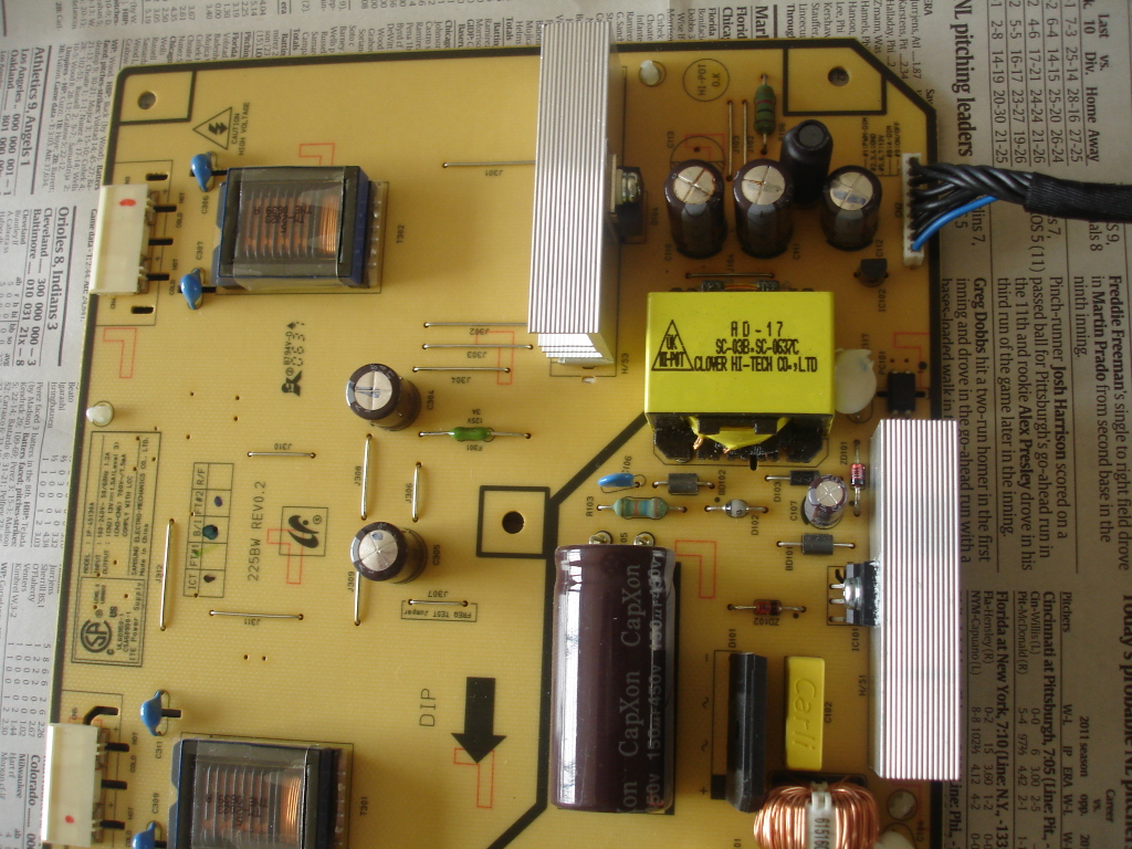

      Re: Samsung Syncmaster 225BW
      My 225BW just started to do this same thing, and of course, two of the caps are buldging/leaking.
      Can anyone tell me the digikey part numbers to replace all the CapXon caps on this power supply board? I'd gladly pay a premium for good quality caps..
      1 x 150uf 450v (42mm long, 20mm diam?)
      2 x 680uf 25v (16mm long?, 10mm diam)
      2 x 820uf 25v (20mm long, 10mm diam)
      1 x 330uf 25v (12.5mm long, 10mm diam)
      Thanks in advance, I really appreciate the help-- I am comfortable with electronics/etc. but I'd like to make sure I get the right parts.

        These are the caps that I had ordered from digikey: 2-820uF/25v(part#565-1960-ND) 3-330uF/25v(part#565-1547-ND) 1-47uF/50v(part#493-3283-ND
        The 150uF/450v (C105) rarely needs to be changed! I would just change the ones I have listed here!

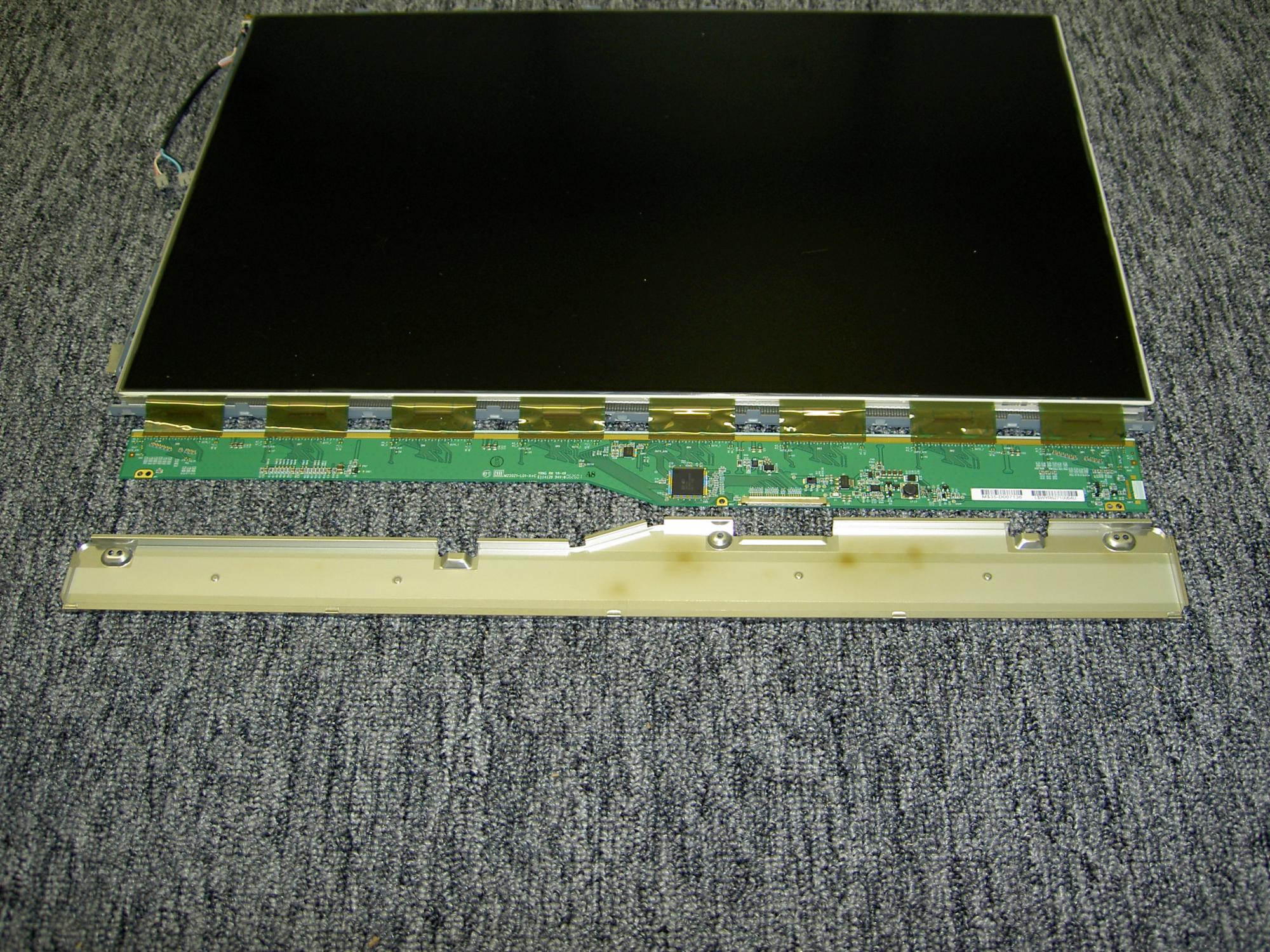

          OK- I took apart the other half of the monitor! I have it down to where I see like 3- thin plastic sheets and under that appears to be some sort of glass that is attached to 2-long rectangle pieces I would guess would be the CCFL's? I am a little weary about tearing down the 19" monitor, as this is the only way to communicate here! LOL
          Maybe there is another way?

            Thanks for the response, but I think that list might not be a fit for the 225bw? I don't have any 47uf caps on the power supply that I can see.

              Perhaps your model may be newer/older then mine. The values I have listed are the ones that I had replaced in my monitor! I would suggest calling digikey and speaking with a tech there. Let them know the values and voltages you need to do the replacements. Also let them know the dimensions of the caps, and they will be able to help you! As far as the 820uf and 330uf caps, I ordered the United Chemi-Con brand. You may want to see if that brand has the other values and sizes you are looking for!
                Emile
                Oh my gosh! I really hope we find a bad CCFL!
                At this point I didn't mean for you to disassemble the LCD pannel.
                I am trying to decide which would be the best way to continue from here.

                    I think it would be a good idea to inspect the CCFLs, lets go ahead and remove the CCFL channels from the frame work.
                    Some CCFL channels simply just slide out; see if you notice a small screw anywhere on the CCFL channel that's holding the channel to the frame. If you do it may just slide out.
                    If there's no screw, there is a black piece that snaps around the thick plastic and into the metal framework of the LCD.
                    Carefully remove it along with the thin plastic sheets.
                    Make note and keep all the thin plastic sheets in order.
                    There is usually some silver tape at the center of the LCD securing the CCFL channels to the metal frame, remove it.
                    Lay the LCD down with the metal frame work facing you, and lift the frame work off the thick plastic.
                    Then remove the CCFL channels.
                    Let me know when you get to that point.

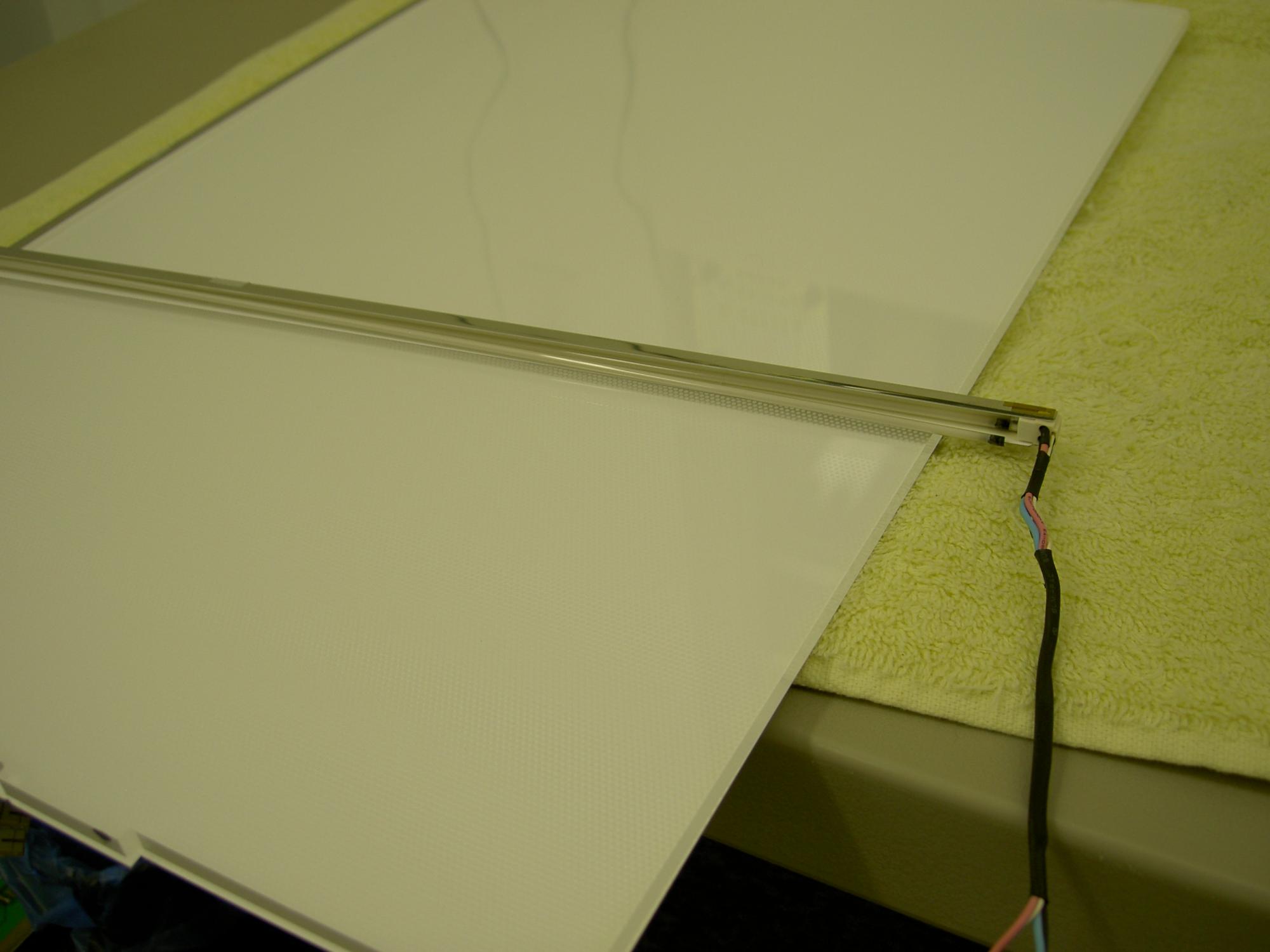

                      I removed one of the CCFL's and one of the bulbs were broke off by the end. I took a pic of it to show you. I guess I will have to order 2-new ones and hope that this was the problem. Do you know where I can purchase these CCFL's?

                        I really glad you found a problem.
                        If you ever do this again, unless you really want to there's no need to disassemble the LCD panel to substitute CCFLs.
                        You just unplug the CCFLs from the monitor's inverter that you're working on, and plug in the test CCFLs to The inverter.
                        I have used ccflwarehouse with great success; I would phone them, let them know what you're working on. They will make sure you get the correct parts.
                        One thing I always do is to test the new CCFL/s in the inverter before I assemble everything.

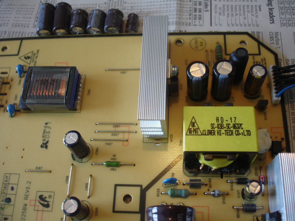

                                      I have two 225BWs. Both purchased at the same time & both have been in service about 3.5 years.
                                      One has worked flawlessly...and still does.
                                      The other started having issues about 6 months ago.
                                      The symptoms were:
                                      - Slow to wake from PS mode
                                      - Flickering/shimmering when waking
                                      - Horizontal lines thru display until 'fully awake'.
                                      Sometimes upon awake the image would be very grayed out. Not like bad CCFLs, but very narrow horizontal bands thru it. My fix was to power off/on. Usually, it would work normally immediately after the poser off/on.....until it went into PS mode again. This got worse and worse until it was taking over an hour sometimes to fully wake up.
                                      Sooooo....I gambled and order a cap set from DigiKey...2 actually...1 set for each monitor.
                                      Tuned up my rusty decades old soldering skills and fired up my 30 yr old Weller pencil. An hour later it was repaired & WORKING !!!
                                      I spent 2 hrs total for teardown, cap research/order, & repair the one monitor....& 8 bucks on parts for both.
                                      1 beer = $2
                                      2 cap sets = $8
                                      Money saved by fixing mon. = $150
                                      Satisfaction = Priceless
                                      Before & after pics (including the puffy lil bastidges that were the problem)

                                        Oops...Timeout before I completed pic edit..& figured out I can 'upload from URL'..
                                        Before & After
