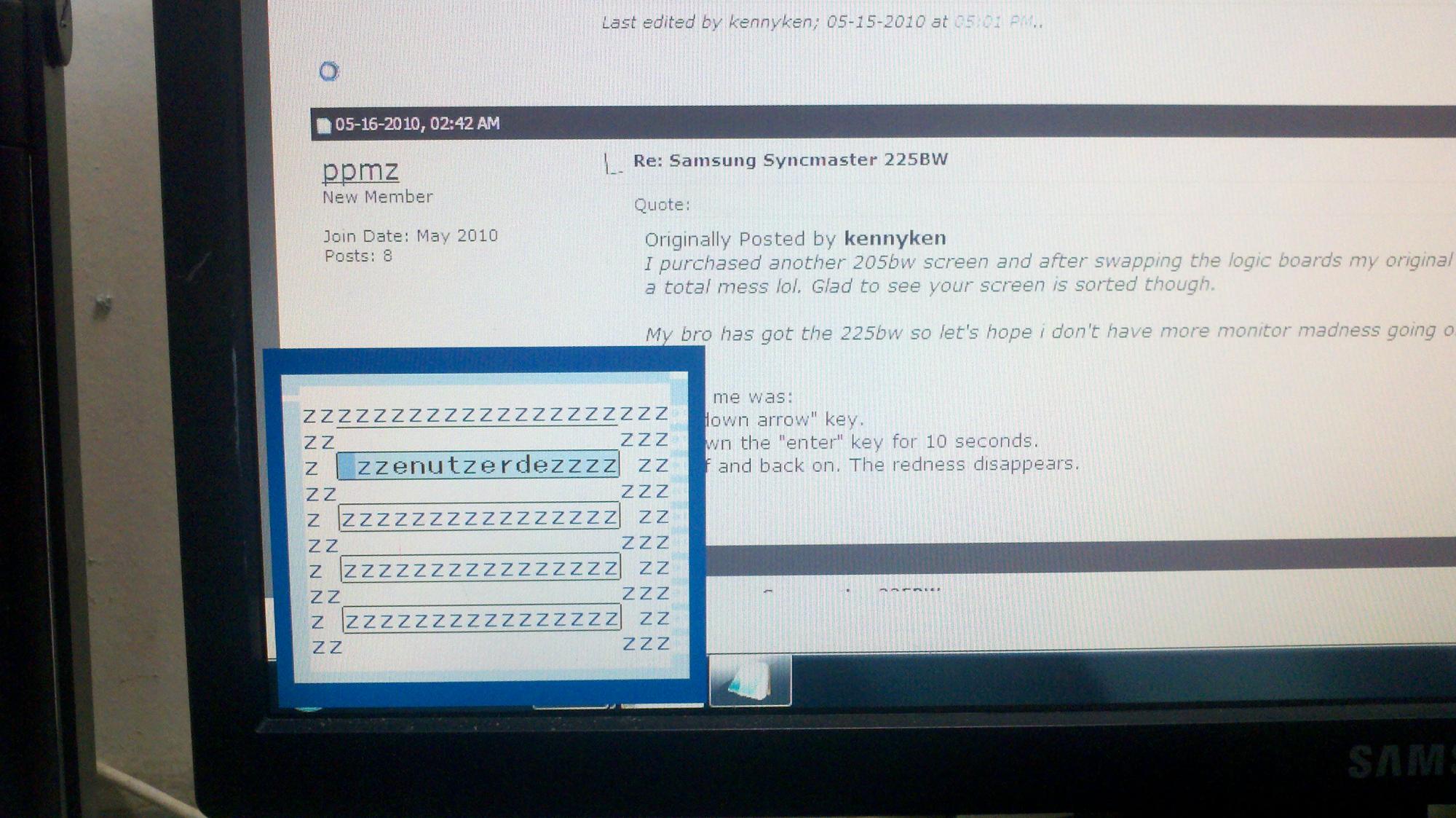

            this one went corrupt after the recap.
            i may have blasted it with rf though.
            lit off a 300w 2m amp on an indoor 1/4wave on the hvac duct.
            no outdoor antenna on the new place yet.
            anyone know a button combo to reset to factory specs?
            any front buttons lock it up or give the menu shown.

              #466
              Re: Samsung Syncmaster 225BW
              https://www.badcaps.net/forum/showpo...&postcount=189

                      #470
                      wiping the eeprom and letting the unit initialise it fixed it.it got corrupted.

                                #475
                                ok a follow up.
                                initialised the eeprom and the unit recovered....for a while.
                                one chilly morning it powered up red with blank menu.
                                revisited and DUH!!!! all the 100uf sm caps on the logic board were high esr.
                                so replace all of them too.the ones near the linear reg were worst.
                                the big duh is because i have repaired so many samsung industrial units and i should know by now these are always bad.i used 100/25 fc.
