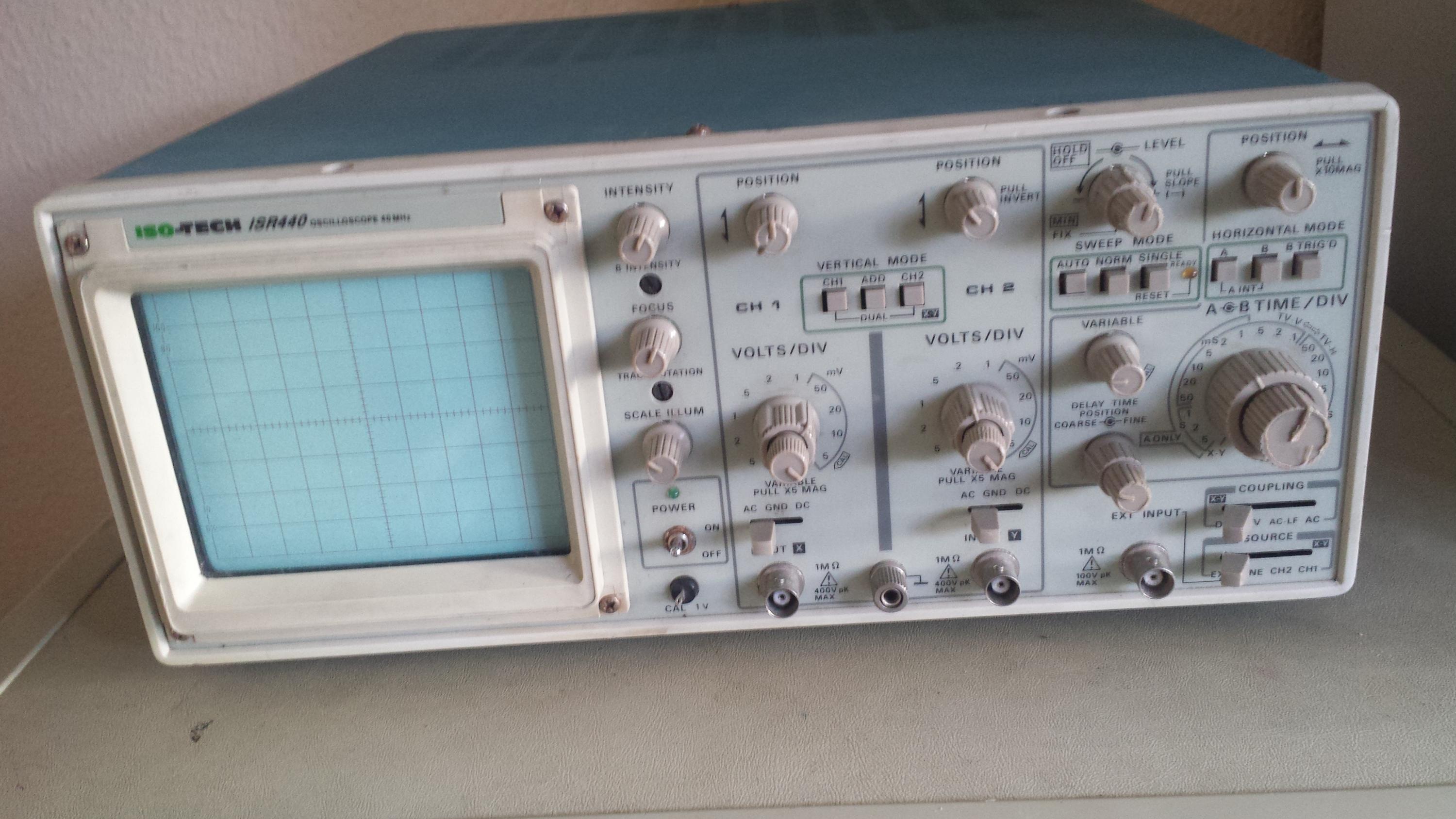

Viglen CRT monitor intermittent jumping
    replied
    Re: Viglen CRT monitor intermittent jumping
    this is on my list
    https://www.aliexpress.com/store/pro...350679999.html
    Leave a comment:
    replied
    Re: Viglen CRT monitor intermittent jumping
    Originally posted by roadrash
    But what if you just remove the mains earth connection to any equipment while you are probing. Wouldn't that isolate it from mains referenced earth making it isolated?
    It would, most of the time (if the equipment uses isolated transformers inside for its power supplies).
    But them using this piece of equipment can become dangerous, because it's no longer earthed, whereas you still are. Even if you put on thick shoes and think you are otherwise isolated, you could still get a minor shock when you touch something live, because of body capacitance. I've experienced that on 220/230V mains and it still hurts a bit. On 110/120V, you probably won't feel it.
    In any case, this IS still dangerous, regardless of line voltage. One wrong move (touching something earthed/grounded while also touching live equipment/lines) and you will get shocked quite badly.
    Last edited by momaka; 10-25-2018, 10:17 AM.
    Leave a comment:
  • roadrash
    replied
    Re: Viglen CRT monitor intermittent jumping
    Please watch this eevblog video before going anywhere near a CRT monitor or Switch mode power supply with the scope.
    It is very very important to know about the dangers of an oscilloscope before using it.
    https://youtu.be/xaELqAo4kkQ
    That was very interesting and I must admit i never thought about the earth and mains referebced earth being differnt. But what if you just remove the mains earth connection to any equipment while you are probing. Wouldn't that isolate it from mains referenced earth making it isolated?
    Leave a comment:
  • R_J
    replied
    Re: Viglen CRT monitor intermittent jumping
    Thats why you need an isolation transformer when working on the hot side of a smps, on the cold side of this monitor you will be fine.
    Even some of the early crt tv's had a completely hot chassis, so you had to be carefull and not have any ground touch the chassis when the set was open. touch a grounded cable and bang out went the bridge and fuse at a minimum. the cable input was actually isolated.
    Leave a comment:
  • Per Hansson
    replied
    Re: Viglen CRT monitor intermittent jumping
    Please watch this eevblog video before going anywhere near a CRT monitor or Switch mode power supply with the scope.
    It is very very important to know about the dangers of an oscilloscope before using it.
    https://youtu.be/xaELqAo4kkQ
    Leave a comment:
    replied
    Re: Viglen CRT monitor intermittent jumping
    probe frequency de-rates as the voltage rises - so higher is better.
    Leave a comment:
  • vinceroger69
    replied
    Re: Viglen CRT monitor intermittent jumping
    i wasnt sure what probes too get for mine as my scope is only 20mhz i got these like you I had no info on what the input resistance or capacitance of this scope was mine was about £6.00 delivered
    https://www.ebay.co.uk/itm/P6020-Hig...item41df7233d4
    Leave a comment:
    replied
    Re: Viglen CRT monitor intermittent jumping
    those are o.k.
    you paid maybe a £ more than you needed, but they should be good.
    i have a pair of 6100's somewhere.
    Leave a comment:
  • roadrash
    replied
    Re: Viglen CRT monitor intermittent jumping
    Thanks for that info Stj. I didnt get any probes with it and may have just ordered the wrong ones. I bought these ones as they looked like the best fit for this scope buty from what ive read I may be wrong. I have no info on what the input resistance or capacitance of this scope is. Ive seen on manuals for other ISO-TECH models of this scope that the input impedances are 1mΩ - 20Pf if that makes sense.
    Anyway hope these ones i ordered will do for now
    https://www.ebay.co.uk/itm/2x-100MHz...frcectupt=true
    Last edited by roadrash; 10-23-2018, 11:45 AM.
    Leave a comment:
    replied
    Re: Viglen CRT monitor intermittent jumping
    http://www.ionpool.net/arcade/tech/s...les/scope.html
    Leave a comment:
  • R_J
    replied
    Re: Viglen CRT monitor intermittent jumping
    That scope looks like it will work just fine, I would'nt worry too much about the deposits on the high voltage leads, clean it off of you like, It looks like this scope was used in a humid/salty environment. That would not deposit on the leads unless it was in use.
    Leave a comment:
  • vinceroger69
    replied
    Re: Viglen CRT monitor intermittent jumping
    That looks a like a nice scope, ive got a trio 20mhz i really need too learn how to use one first though, i only got it to check lvds signals etc.
    Leave a comment:
    replied
    Re: Viglen CRT monitor intermittent jumping
    dont go over the rated voltage on the probes - just saying.
    and keep the probes set to x10 if they have a switch.
    Leave a comment:
  • roadrash
    replied
    Re: Viglen CRT monitor intermittent jumping
    I just had to lift the cover & take a peek inside. Its prety clean except for a kind of white soft almost chalky coating over the HT lead. It might be from damp where it was kept in his garage. I didnt want to remove it in case it was a special anti-static coating that meant to be there. I am sure its not conductive. Take a look.. As soon as those probes arrive I can get back onto fuixing my monitor which I tried again yesterday and it definitely has no picture. Its a EGA monitor and I think its the only computer and monitor that I have here that uses EGA so cant test it on anything else. I cant see the PC being at fault so sure its the monitor.
    Hopefully this Scope wil now give us an answer.
    Leave a comment:
  • roadrash
    replied
    Re: Viglen CRT monitor intermittent jumping
    Ive got it but have to wait until friday to use it a no probes. Is a isotech iSR440. Nice bright display. Attachef some pictures. What do you think?
    Leave a comment:
  • R_J
    replied
    Re: Viglen CRT monitor intermittent jumping
    Now remember if you are going to use it to repair a smps or when connecting to the hot side of any chassis an isolation transformer must be used.
    Leave a comment:
    replied
    Re: Viglen CRT monitor intermittent jumping
    looks familiar - similar to a telequipment d83.
    what is it?
    Leave a comment:
  • roadrash
    replied
    Re: Viglen CRT monitor intermittent jumping
    Just bought this beauty. Collecting it tomorrow.
    Leave a comment:
  • roadrash
    replied
    Re: Viglen CRT monitor intermittent jumping
    Re the scope.. I have a choice of 3 that I can get.
    I prefer ths one (a tekronix) but depends on what it sells for;
    https://www.ebay.co.uk/itm/tektronix...z/273511259703
    Next one is this one a GOULD ADVANCE:
    https://www.ebay.co.uk/itm/GOULD-Adv...y/153227035640
    and finaly this ISO-TECH but is a 20mhz bandwidth ok?:
    https://www.ebay.co.uk/itm/ISO-TECH-...g/153226078874
    are all of these useful to help repair CRT monitors etc?
    Last edited by roadrash; 10-22-2018, 11:12 AM.
    Leave a comment:
  • petehall347
    replied
    Re: Viglen CRT monitor intermittent jumping
    just remembered my neon screwdriver was my friend with crt .
    Leave a comment:
    by momaka
    03-15-2023, 10:17 PM
  • wattage
    AOC AG493UCX 49-inch monitor - Firmware request
    by wattage
    Hello Badcaps Community,
    I purchased a preowned AOC monitor that is not working and out of warranty. It was sold as not working. I am looking for guidance on self-repair. In particular, I am after the firmware for the monitor. At the end, I have included monitor model information and links to pics and vids of the issue.
    The problem is that it will not display a picture on any of its inputs. And the on-screen menu does not appear. The power button works properly. It powers on with the remote as well. But the on-screen menu does not appear, even when not connected to any...
    07-13-2025, 04:41 PM
  • ant3202
    by ant3202
    Hi Everyone
    03-20-2025, 07:30 PM
    Wise Wing F199 19'' LCD monitor - recapped
    by momaka
    Looking through my repair pictures and notes, it's been a long time since I posted anything in the LCD monitors section. So here goes that.
    I'm dedicating this thread to one of the very first LCD monitors I repaired (if not the first one), which was more than 10 years ago now. The monitor is a Wise Wing, model F199. It's a 19” CFL-backlit LCD. I got it for free off of Craigslist in 2009 from a guy, who said he bought it for cheap from Wallmart and the monitor worked only for a little less than 2 years before quitting.
    When I saw the Craigslist post, I wasn't...
    08-24-2020, 10:58 AM
  • sew333
    Pc shutdown, monitor flickered with no signal after 10 seconds
    by sew333
    My pc:
    10850K stock 4800mhz stock Kraken X73 good temps
    2x16 GB DDR4 GSKILL 3000mhz XMP
    Seasonic Tx-850 Ultra Titanium
    Gigabyte Rtx 3090 Gaming OC
    Aorus Z490 Pro Gaming
    1 TB SSD
    4 weeks ago i launched Metro Exodus Enhanced and during cinematic advertisement part ( 30 fps ), pc just shutdown.
    Also monitor flickered with NO SIGNAL 10 seconds after shutdown. So only monitor and pc was affected.
    Next i pressed only power button, rebooted again and its fine again. Happened once and i cant reproduce.
    Power...
    02-22-2022, 10:27 AM
