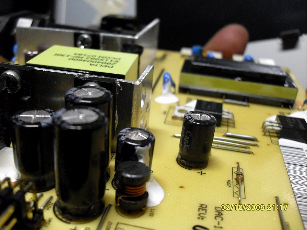

                I've just received the Acer 19" version of this monitor. So far I've seen 2 bad (vented) caps, a shorted FET, and a blown fuse. Interestingly, my new esr meter says that one of the bad caps still has a low esr.
                What is the value of F200. According to the only chart I could find, that is a 7 amp fuse?
                PlainBill
                  PlainBill
                  I've seen that unit too. It's an Acer AL1916W. Same PSU as the unit on this thread and on the L2046NV of a thread I opened. In my case, it was a blown fuse (F200) and two caps (see attached pic). The fuse was replaced by another "F200" from a dead (and almost empty) same model PSU, but I have no data on the fuse's specs.

                    Crapxon strikes again.
                    I'm seeing this more and more two of the inverter transformers in one assembly. As in the board pic above.
                    Is it cheaper to produce them that way or is it just quicker on the assembly line when inserting parts?
                      I'd say both. The downside is that you have a slightly higher chance of a manufacturing failure because of the extra winding.
                      Boy, that picture looks familiar!! Right down to the same two caps popping their tops.
                      Has anybody analyzed this circuit? Is this just a case of the caps failing, the high ripple causes the FETs to overheat, and when they short the fuse blows?
                      PlainBill

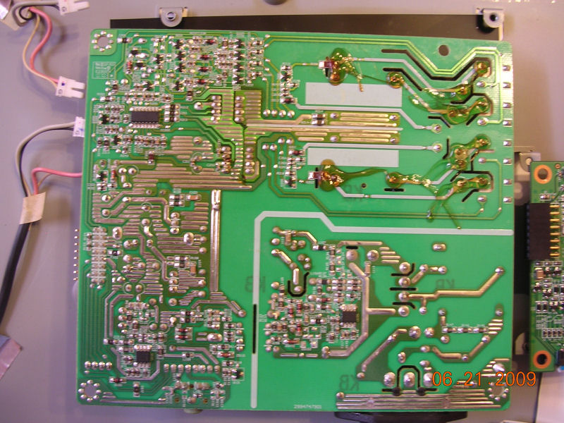

                                      I am new here and to repairing LCD's. I have tinkered with a lot of other things though. Great info here. Thanks in advance!!
                                      I too have a Westinghouse L1975NW with no backlight. But mine has a different board that the original one in this thread. It has two dual Mosfets parts number P605. Also about half of the caps are Capxon and the other half are Taicon. Only 4 of the Capxon are bulged. Should I replace the Taicon caps also or are they okay? Where is the fuse on the solder side you guys are talking about? The main fuse is good as the LCD panel works. I'll replace the mosfet's along with the caps as they look pretty overheated.
                                      I'll try to attach a couple of pics.
                                      Thanks,
                                      Bob
                                        Thanks,
                                        Bob
                                        Welcome
                                        Replace all the caps while you are there. For the fuse, post a bigger picture of the underside to see if we can see if any fuse is there.
