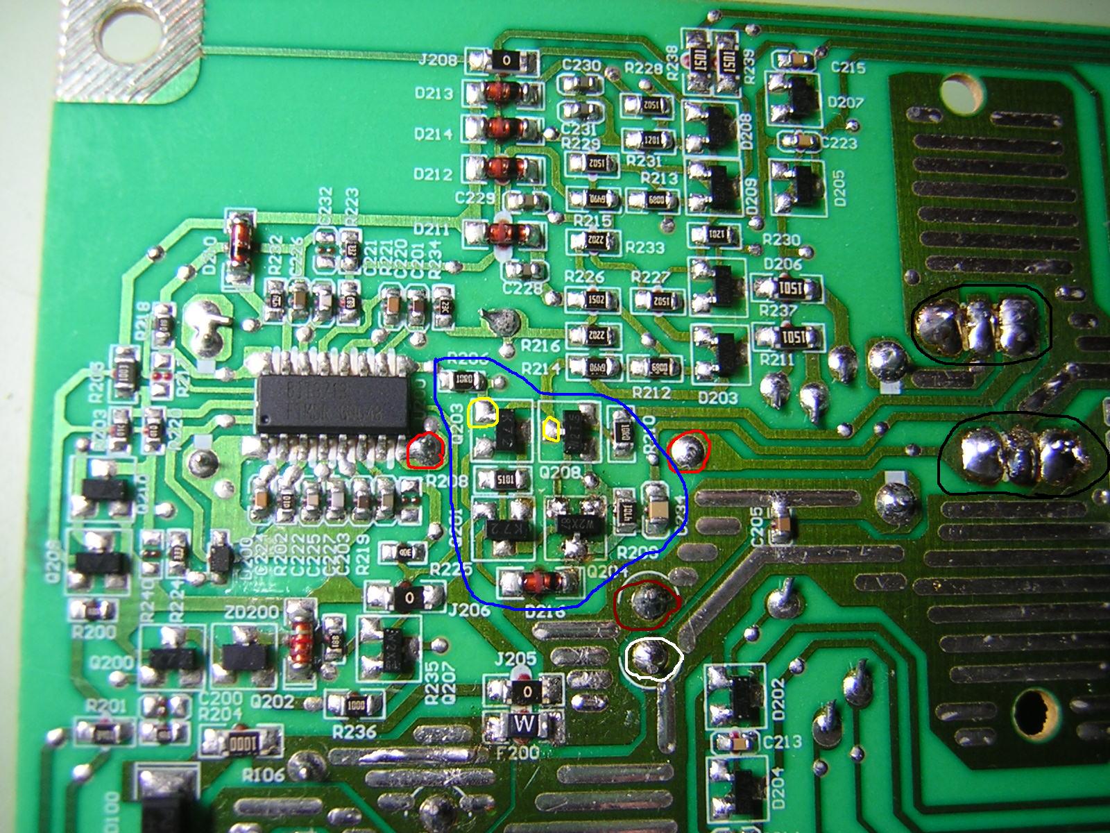

    Re: Issue with Westinghouse 19" LCD Monitor (large pics)
    Originally posted by Welchs101
    What cap did you mean? I looked at the circuit but i did not see a cap connected to that transistor.
    Your questions seems very plausible but i just dont know the answer......wish my electronics was better.
    Look at the attached picture. The controller IC (U200), everything within the blue outline, and the two power FETs (solder points circled in black) are the driver circuit for the inverter transformer. Pin 8 of U200 drives the gate of the lower transistor directly. The gate of the other transistor is driven by Q208, driving through R210. The drive to the transformer is coupled back through C234. Without a schematic (or maybe even with one ), I'm having trouble figuring out just what is happening in this circuit.

      I still haven't tried to generate a schematic, but I notice there is a capacitor in that circuit. Could it be that it is holding enough charge to turn the FET on?

        Question: Regardless of if a cap is in the circuit........should there be a low resistance of several kilo-ohm between gate and drain?

          Maybe. Notice there are a number of resistors in the circuit. Now if the resistance is there OUT of circuit, that's a problem.
          I'm hoping you can find a problem with a component, because the alternatives are to pull the transformer and try powering up the inverter to see if anything blows, or to map the interconnections between 30+ points so it is possible to create a schematic.

            Do you think i should take the transistor out of circuit and measure it out of circuit?
            What do you think of this: What if i were to replace fuse F200 with a "wire" and then power up monitor and try and find device that gets "hot" ........ i am afraid that by doing this something else will "blow" but i am really not sure what to look at to fix this problem.

              Well, I'm not stumped. The problem is there are several tests that you don't have the equipment for. Unless you have been holding out on me, and have a variable power supply, a ring tester, and an oscilloscope hidden in a closet?
              The short summary of the dilemma is there are two likely causes of the problem. Cause 1 is a defective component is causing both power FETs to be on at the same time. Presto!!! Shorted FETs, blown fuse. Cause 2 is the inverter transformer has a short - possibly in the primary. Same result- the FETs overheat, short, and the fuse blows.
              If you had a variable power supply, using the jumper wire would be a viable approach. The problem with hitting it with full power is that the part that smokes is probably NOT the defective part.
              Here is an idea that should keep you out of my hair until after I get back from Hawaii. Hie thee off to ye friendly electronics store and buy a light bulb. Something rated for 12 volts and 1 amp or less. Maybe an automotive indicator light would work. One of the dash bulbs that always liked to burn out would be perfect. (No, I don't know the part number, look up the dash light for a 1969 Dodge Charger with the 426 Hemi). Hook that (the light, not the car) up in place of the fuse, then power it up. If the light bulb glows brightly for a few seconds, then goes out you are probably looking at a problem with the inverter transformer.
              Next, remove the inverter transformer. Power up the circuit (using the light bulb instead of the fuse.) If the light bulb glows brightly, the problem certainly isn't the transformer.

                        It has been sometime since i was working on this monitor but a friend of mine gave me a monitor that has the same (almost same board) as this one. I am hoping that between the two i can figure out what is going on with this one.
                        I took the transformer out of this board. Put a new fuse in. With just the power supply board, i plugged in the power.....fuse DID NOT BLOW! When i was taking the transformer out i did find that one of the blue caps had a cold solder joint. So i resoldered all the connection points of the blue caps near the transformer. Also, i put the transformer back in and power up the supply board. The fuse DID NOT BLOW!
                        So i decided to connect the supply board to the main board and connect the ccfls as well. This time however when i powered up the fuse DID BLOW.
                        Any ideas? I know its been a long time since my last post but i would really like to fix this monitor now that i have another monitor with a similar board which may not be working but at least it is not shorting.

                          Which transformer, and which fuse?

                            The transformer that is just before the ccfl lamps.
                            The fuse is on the back of the board and it kept blowing. It has a "W" on it. i can send pics again if you like.

                              I'm not going to go over the thread to get history of this board, but off the top of my head there are two possibilities. Shorted transistor, or shorted transformer.
                              As I indicated, this board is notorious for shorted transistors. With the logic card disconnected the inverter controller would not get the BL_ON signal. If both transistors were shorted, the fuse would still have blown. If only one transistor or the transformer was shorted the fuse would not blow. Then you added the logic board, which sent the BL_ON signal.
