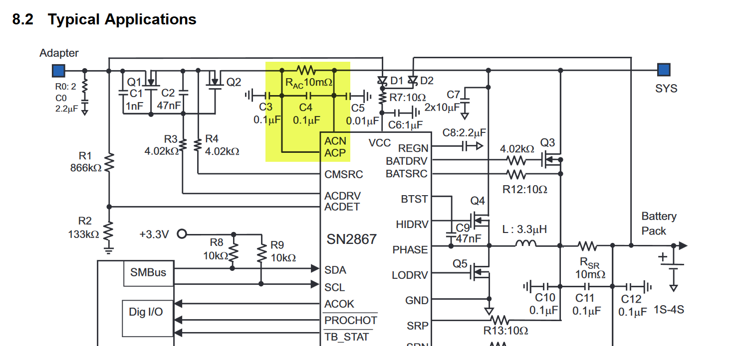

              bq24780s ?
              This chip is well documented. Suggest to download the datasheet for this component for a deeper study.
              https://cdn.badcaps-static.com/pdfs/...2a8abce3d9.pdf
              Focus on the region with the current loop resistor. Suspecting that there is no fault in the 2*DCin mosfets nor the boost voltage required to enable each of the 2*DCin mosfets. That is, you have ~25v on the gate pin till both of the mosfets are soldered in place.
              Also, you know from the bypass method with an external DC power supply, the logic board works normally. The difference is that the charger IC is no longer involved in the decision making process.
              Respectively, the charger IC is involved once you restore the mosfets to be both onboard. It is very possible that the fault is in the current sense resistor circuit that follows these 2*DCin mosfets.
              Remove all power.
              Meter in resistance mode.
              Measure the resistance between the pins of the charger IC, pins #1 & #2 (ACP & ACN).
              Post the measurement. Be sure to measure directly at the charger IC and again, with NO power to the logic board / no battery attached.
              PS: Is this the IDEAPAD 330S ? If yes, found the schematic in my paid service.

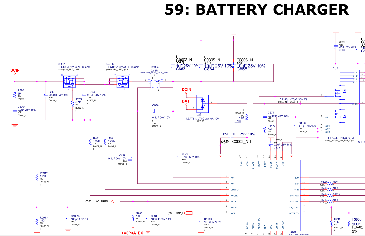

                  Ah thank you so much for the schematic. I only have the board with me right now but I will 100% sure if it is the right model.

                        Ok. To me, the path between ACN & ACP is too high.
                        Measure the resistance from ACP to the mosfet Q5902 - should be 0R3.
                        Then measure the resistance from ACN to the main power rail (C879) - should be 0R3.
                        This is to confirm that the traces BEFORE and AFTER the current sense resistor are ok.
                        The current sense resistor between ACN & ACP should be 10mohms = 10 milli-ohms. Respectively, with your meter, it should appear like 0R3. Only a very high quality milli-ohm meter can measure the true 10mohm value.
                        Perhaps wait on others to comment but consider, if available, to replace the current sense resistor @ R5903.

                          Re: Lenovo IdeaPad 330 laptop mosfet issue
                          Originally posted by ebyte64
                          I wish I had a schematic for this board but unfortunately I do not.
                          Schematic ---> https://www.badcaps.net/forum/showth...26#post1215826

                            mon2, thank you so much for your help. It was the current sense resistor.
