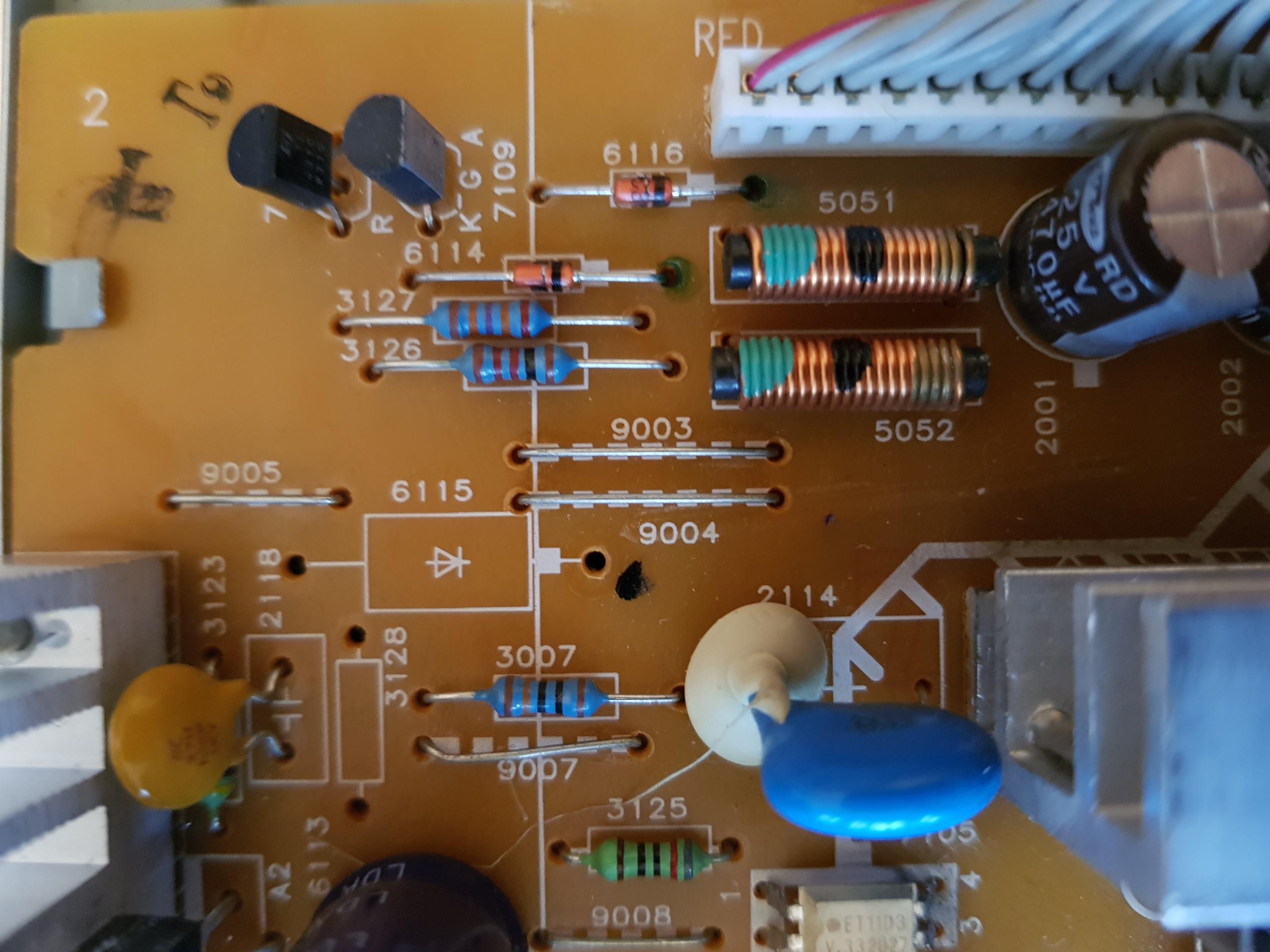

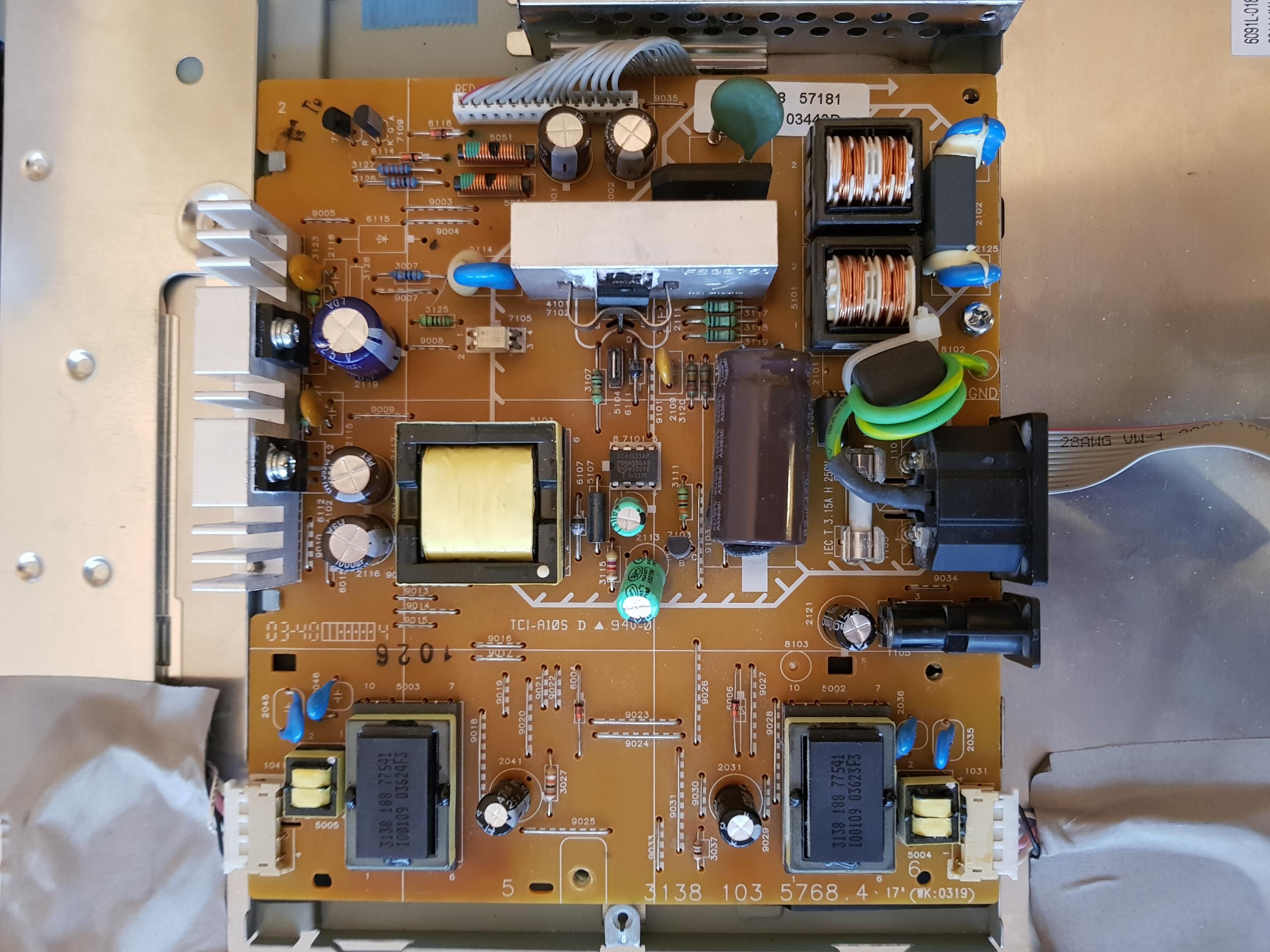

    I have been trying to fix a Philips/LG 170B4 BB/02 monitor and I need your help. Initially, it just wouldn't stay on with the power light off. I took it apart and changed all the electrolytic caps (some were bulging and some were leaking). Now when I turn on the monitor it flashes the display for a split second before going black. The power light now stays on now.
    I found a circuit diagram on the internet but although it's mostly the same, some areas are different. The circuit diagram shows three voltages 3.3, 5 and 12v but on measuring, my monitor only seems to have two (3.8v and 12.7v). Should the 3.8v on my monitor be 5v? There are some markings on the circuit board where components should be but there are none so there has obviously been a design change.
    If I hold the screen up to a bright light, I can see the image on the screen so the lcd circuitry seems to be working. I bought a backlight tester and all the back lights light up to the same degree (there are 4). The two output transformers for the four backlights have equal resistance on the primary and secondary coils. There is 12v power at various places on the backlight circuitry.
    What should I check next?

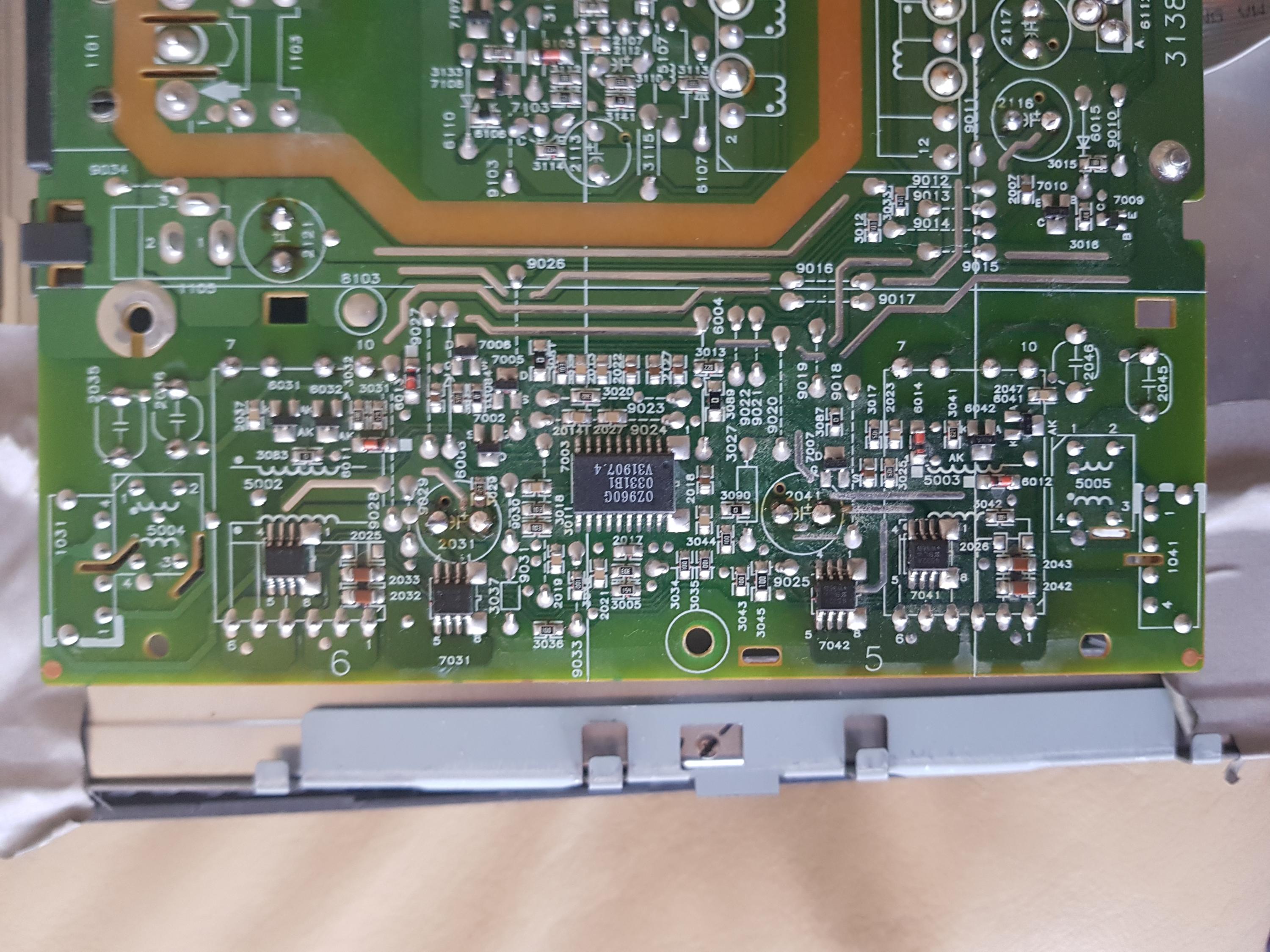

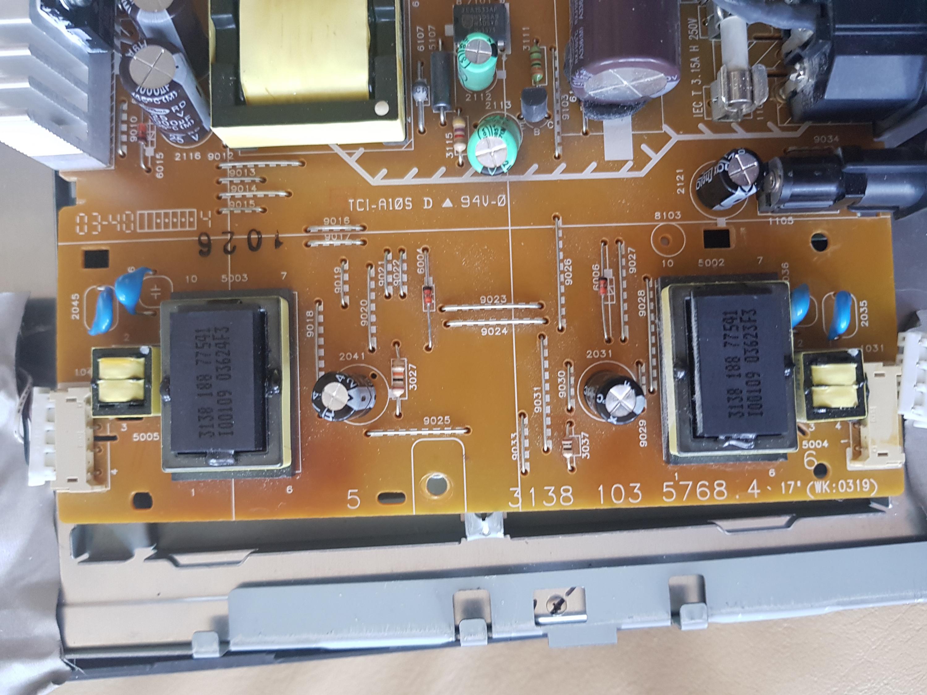

                  Re: Philips 170B4 BB/02 flashes on for a split second
                  To be sure you should now check the inverter with different lamps.
                  Ccfls may work but draining too much power.
                  Look carefully at the corners of the screen if the light is different, pinkysh or fluctuating. That indicates wear of the lamp.
                  In the inverter section check the winding resistance of the two transformers and reflow all the solder points in the case some are cracked.
                  Post a photo of the other side of the board.

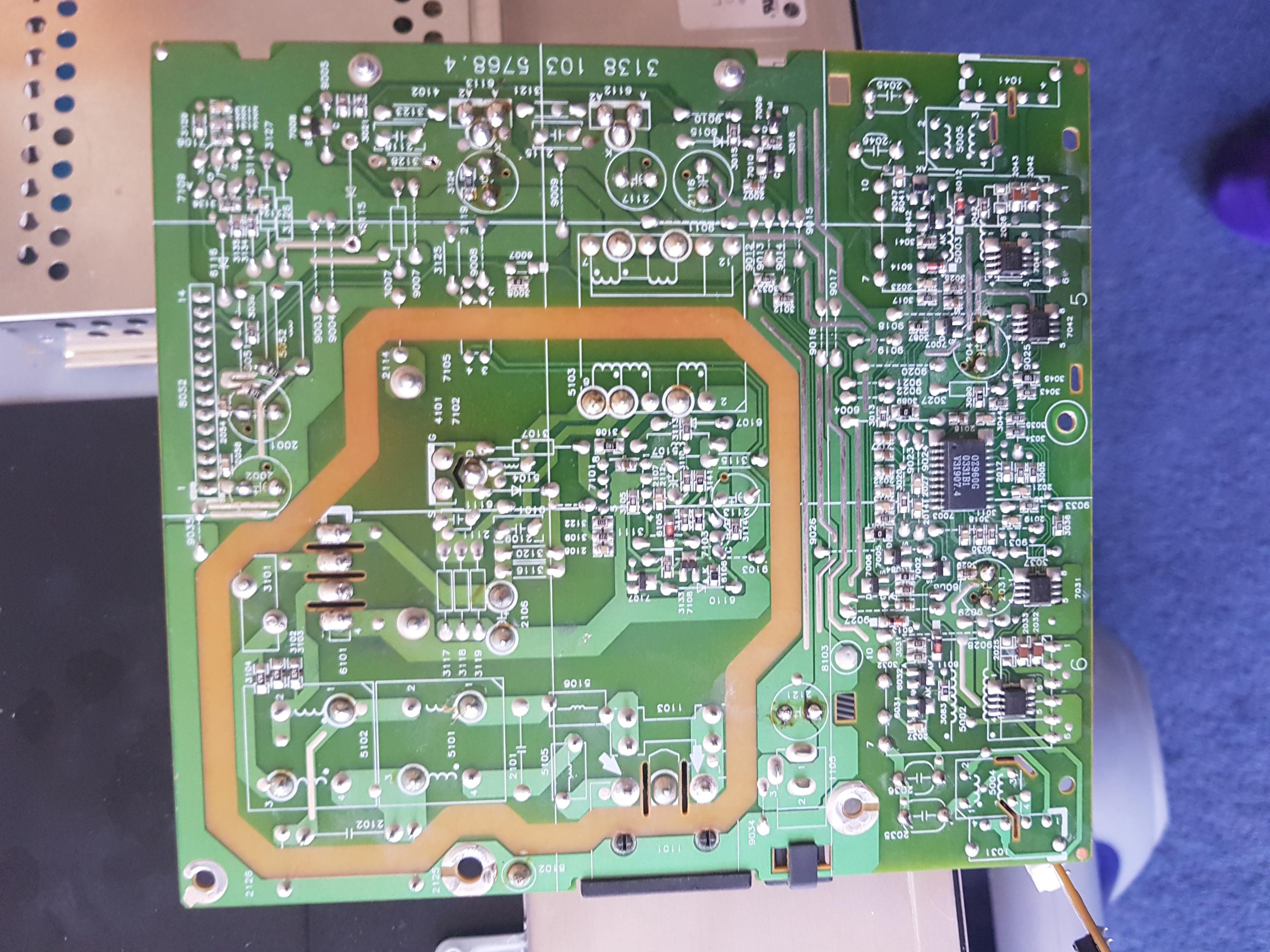

                    Here's the service manual for you rmonitor. Are those photos of your actual board or some you found with google?
                    Also, I think you should have 5V on pin 10 and 11. When you say you have 3.3V on pin 1 & 2 I think you are looking at the connector backwards, that should be pins 13 & 14.

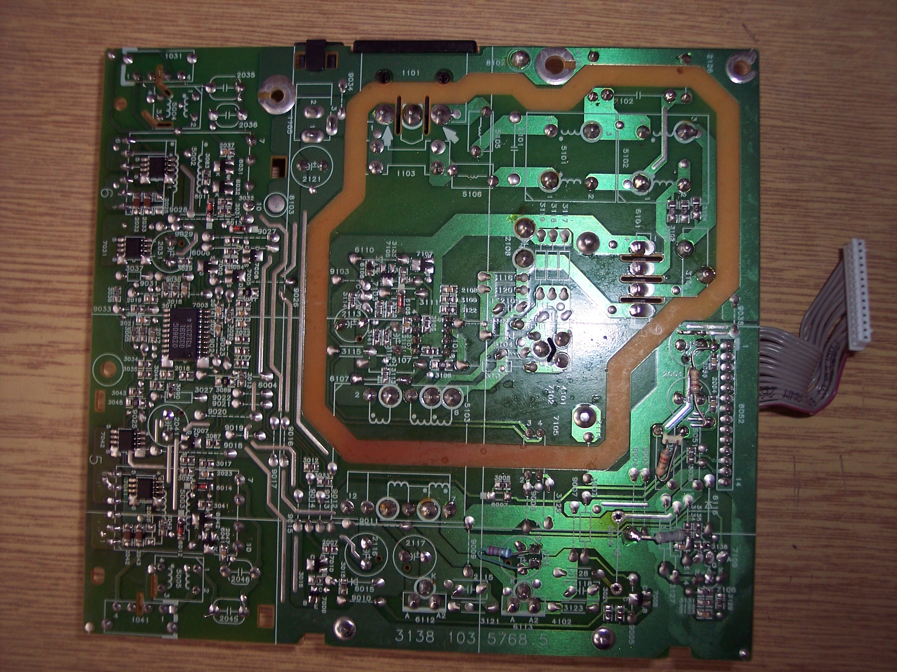

                      this one might be closer to your board, but still no schematic of the inverter section.
                      Here is a picture of the bottom of a 3138 103 5768.5 board for reference
                        Thank you all for your advice and suggestions.
                        Rddube, The circuit diagram RJ has posted looks like mine. It shows 3.3v on pins 1&2 and 12v on pin 7. There is no 5v. The pictures I posted earlier are of my actual board.
                        Dumah Brazorf: As far as I can tell, all four ccfls look the same when they light up. I got this tester on ebay.
                        http://www.ebay.co.uk/itm/132427753417
                        The winding resistance of the two inverter transformers is the same. I reheated the solder points on the pins of the transformers as you suggested. I don't understand why if there are two inverter circuits for four ccfls, why don't they work independently. If there is a faulty ccfl and I unplug it why doesn't the other come on.
                        RJ: Yes the photo you posted looks like my board as and the circuit diagram looks correct. Now that the voltages check out I guess the problem must be with the inverters or the ccfls. The ccfls seem to work with my tester so I guess it must be the inverter. Where do I go from here?
