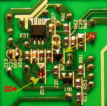

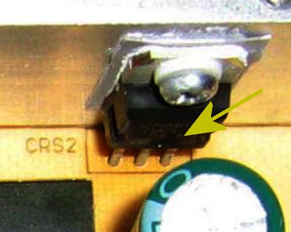

    Please check device CRS2. The device mounted on the heatsink in the upper right of the top down picture of the entire board you posted. I've posted a zoomed pic of that device.
    The front surface appears to be damaged. But, it might just be the lighting. Please verify whether it is surface glue/epoxy or is it a crack/hole in the casing?
    You questioned the location of Q7 & ZD4. The other pic shows you their location.

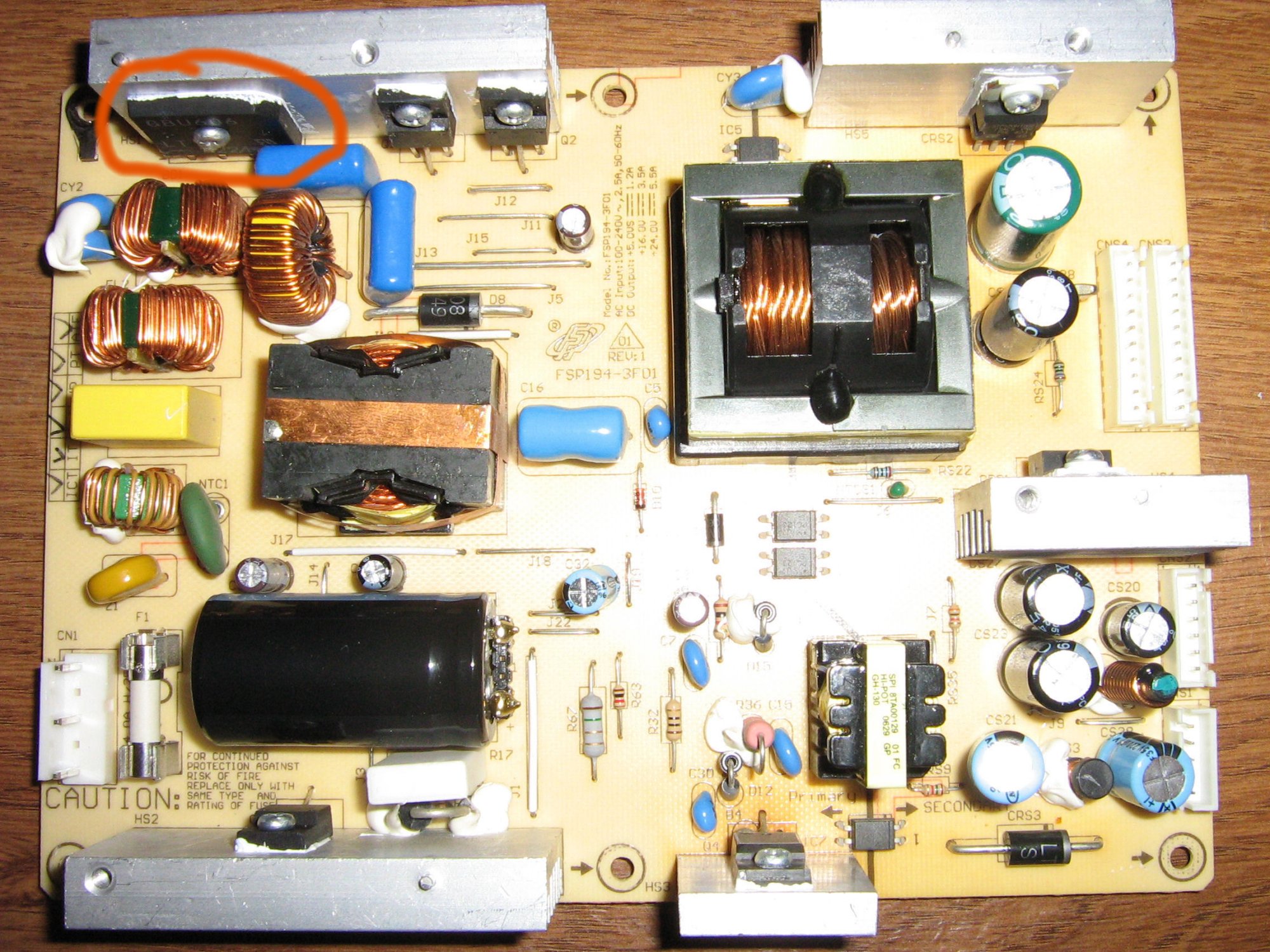

        Hello all... I'm afraid My inexperience has caused a major back-pedal I foolishly flipped the board upside down with the power supply ON and ZAP (blue light flashed and heard a small static-pop) DAMN ! ! I rechecked the LARGE cap for voltage and sure enough it was at 80... 79... 78.... etc... think if I replace that large capacitor it will be good to go again ?

          You probably blew the line rectifier (or a few diodes in it) measure the diodes in the package with the diode checker function of the DMM.
          Suprised that the fuse didn't blow.

              The large device mounted on the heatsink it's about 2 transistor widths.
              It's 4 diodes in a bridge rectifier arrangement in one package. Measure each of the diodes in the package just google bridge rectifiers to see the layout on the 4 pins.

                Is this the Bridge Rectifier ? ? ? ? I have it circled in red.

                  Bridge Rectifier ? in RED ?

                    Measured the "Bridge Rectifier" it registered at .08 volts... i think I measured it right, flipped the board over and hooked the leads of my DMM to the "-" and "+" sides. Anyways I will replace the Bridge Rectifier and see if that brings that Large capacitor back to life

                      Look at this diagram:
                      That is how to isolate and test each diode in the package you should only get a reading with the probes in one orientation if you don't get a ready flip them around if you read a short on any diode (in both directions) the rectifier is toast.

                                I am having the same problem (no power). Do you know the part number for Q7?

                                  Z-diodes like D4 do either protect the gate of the switching mosfet or are for over voltage protection. I would not recommend to use any SMPS w/o it. In the best case, you just simply blow the mosfet or anything powered from the psu. In the worst case, it will cause a fire.

                                          Thanks for you information how to Troughble shooting FSP194-3F01 power supply for 32 inch Protron (model PLTV-3250) LCDTV
                                          1/ I changer 3 capasitors is bad I can see is check On/Off socket had 0VDC
                                          2/ Replace new (transistor)Q7 is still not working check DC volt get 5VDC at (transistor) Q7
                                          3/ Replace new ZD4 (zener diode) close (transistor)Q7, now I had 12 VDC after replace ZD4 (zener diode) & 5VDC at On/Off socket
                                          Finally after changer 3 capacitors + (transistor)Q7 & (zener diode) ZD4 my Tv work again
