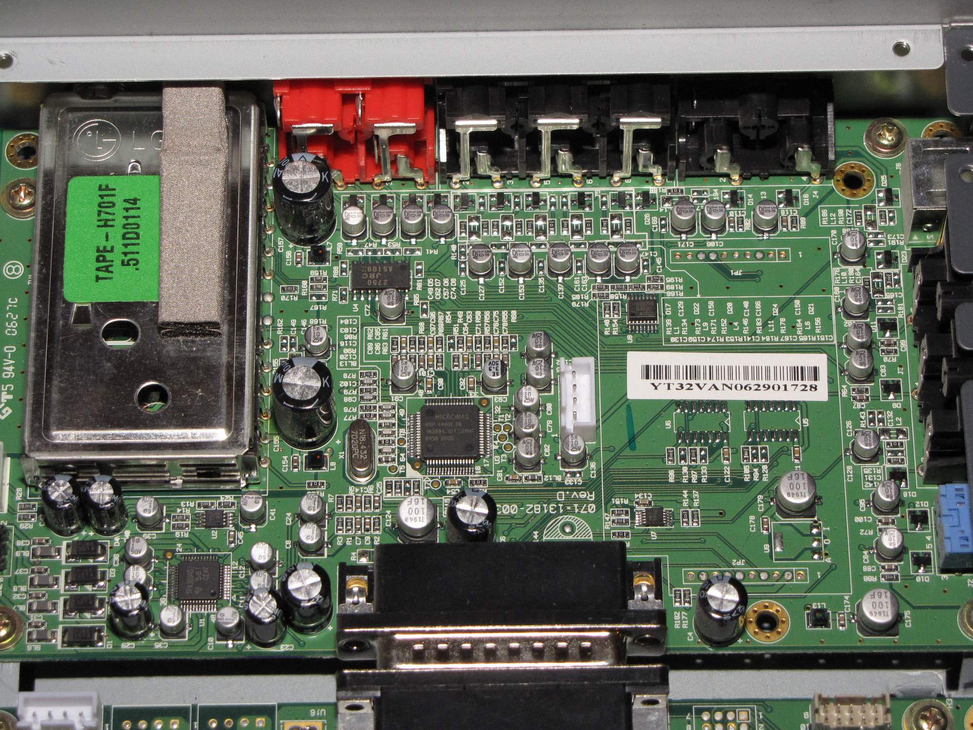

                  So got some parts in and replaced caps and Q7. I now have my 5V standby, but unit is still dead...
                  My understanding is that the 3.3VDC signal voltage is a brief voltage sent back to the power supply when the power button is pressed enabling the turn on of the 16 snd 24vdc section; correct?
                  So whether using the power button or remote, I should be able to meter the signal voltage. If it does appear, I need to check things like Q11.
                  Anyone have any idea what to look for if I have the 5VDC standby, but can't get it to send back the 3.3VDC for turn on?
                  Thanks!!

                    #89
                    Re: Spectroniq PLTV-3250 wont start
                    Thanks!!
                    There is a small error in your description. When you press the power button an input to the controller on the signal board changes level as long as the button is pressed. The controller reacts by 'flipping' the state of the PS_ON (or some equivalent name) signal to the power supply. That line stays in it's new state until the power button is pressed again. It's a steady state - the main power supply is on as long as the PS_ON signal is high.
                    There are a number of things that can be checked if the PS_ON signal does not change state. The first is obvious - the cable from the control panel to the signal board.
                    The next is the LDO regulators on the signal board - there are usually at least two of them.
                    The third is the input connector for the cable from the control panel - make sure signal from the power button is making it's way to the controller.

                      Ok, so while I did measure that the 5VDC standby is there, I did so before reconnecting everything.
                      With all connections reattached, the 5VDC is NOT a constant 5V but rather is constantly fluctuating (on my DMM)! Best as my digital meter is telling me, it is going up to nearly 5 then down to about 1.4 or so...
                      I cannot get any 3.3v reading. I do not see a standby led or anything so really don't think the controls are even working.
                      Any help???? Ideas???
                      Thank you!!!!!!

                        • pacmanretro
                          • Jan 2012
                          • 7
                          #92

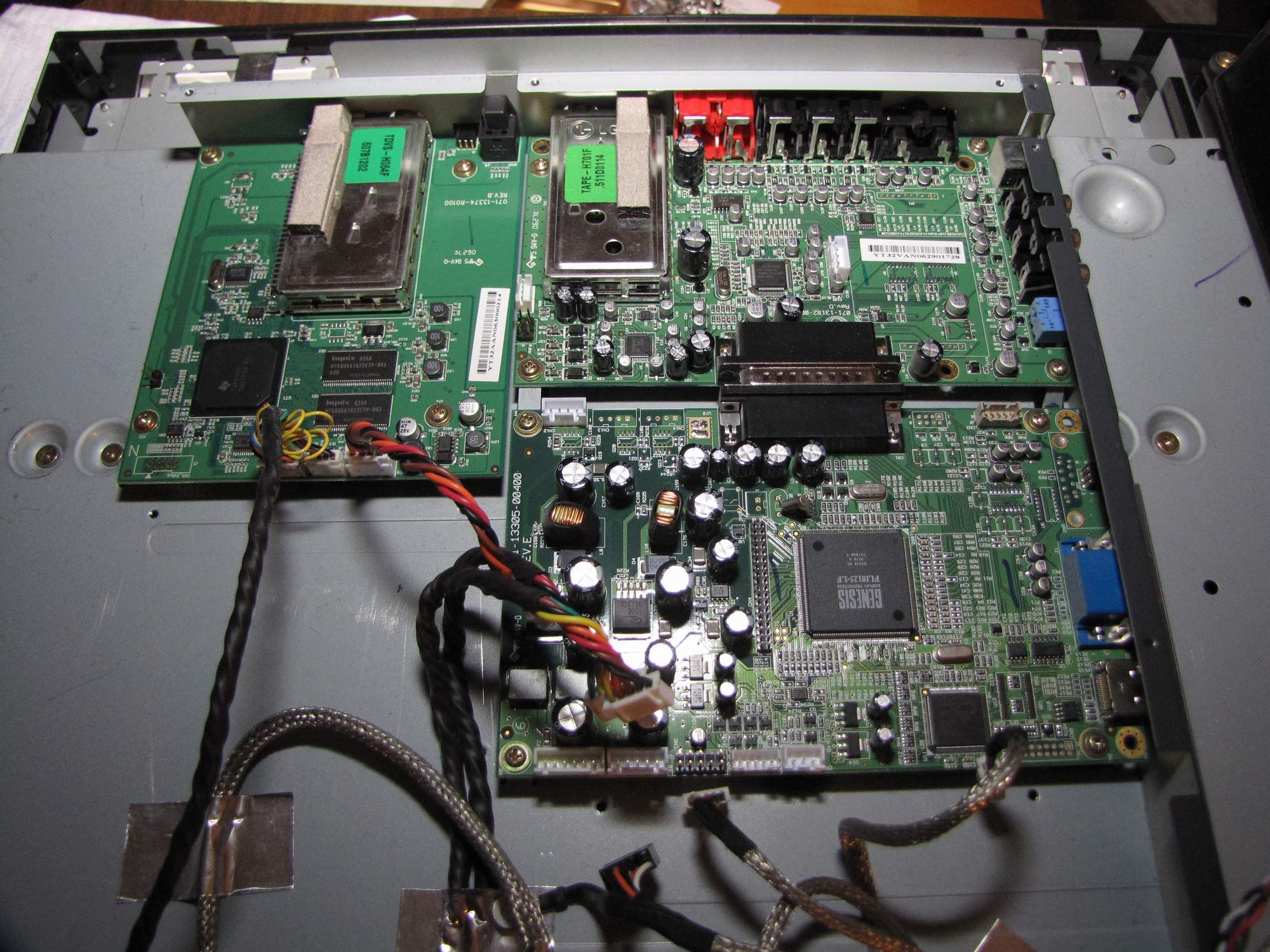

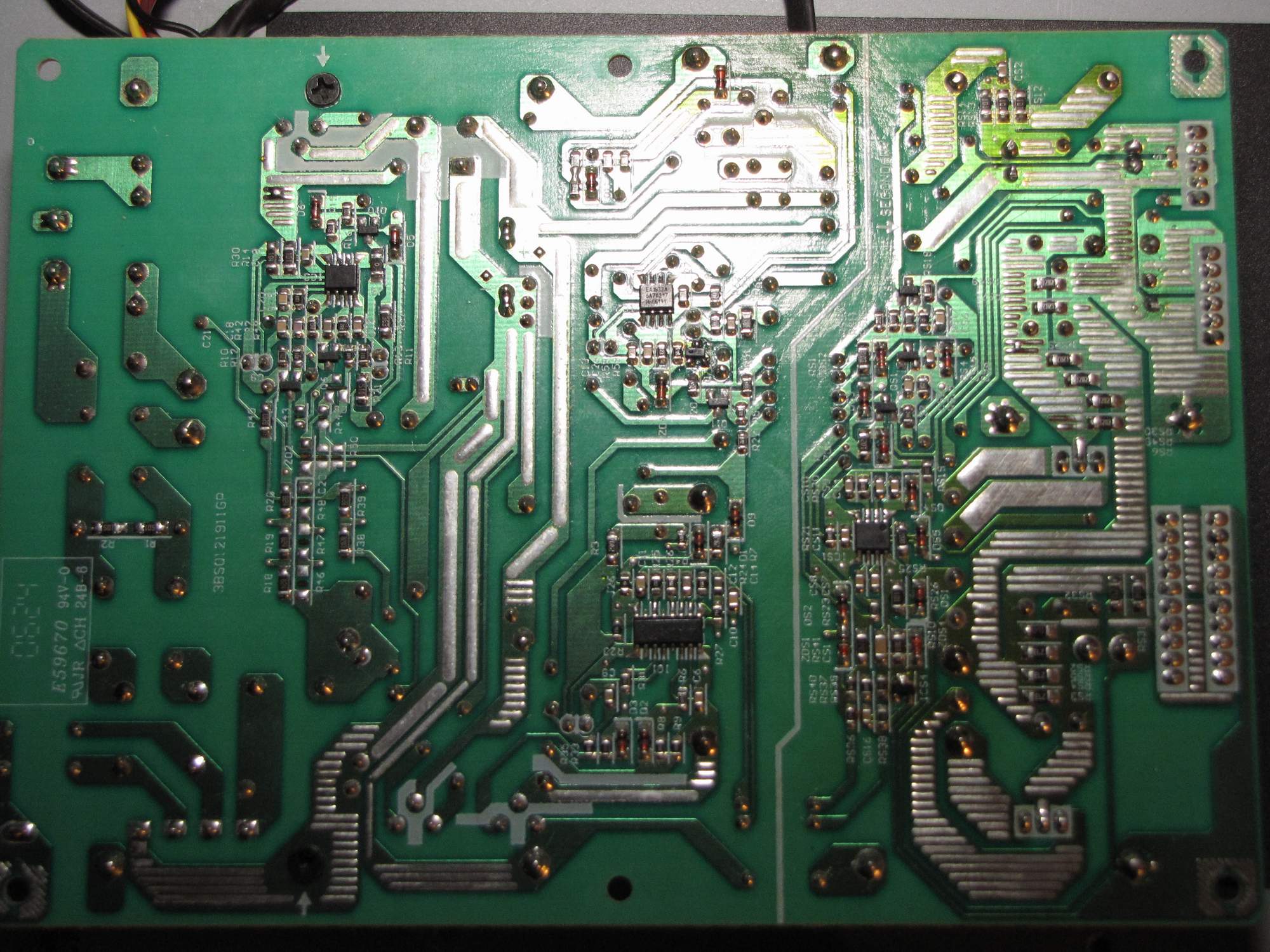

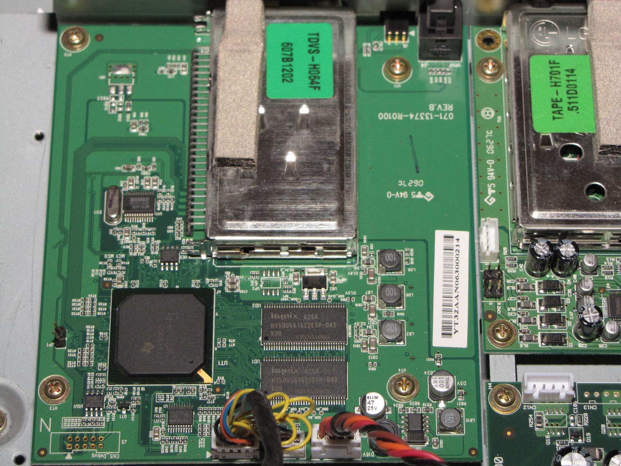

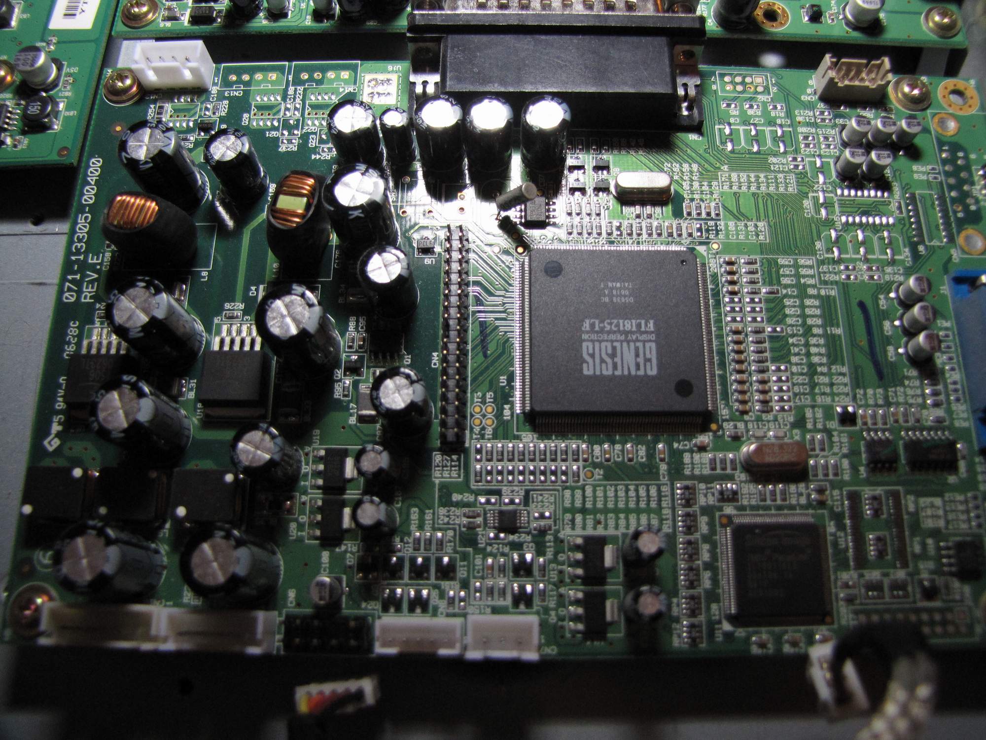

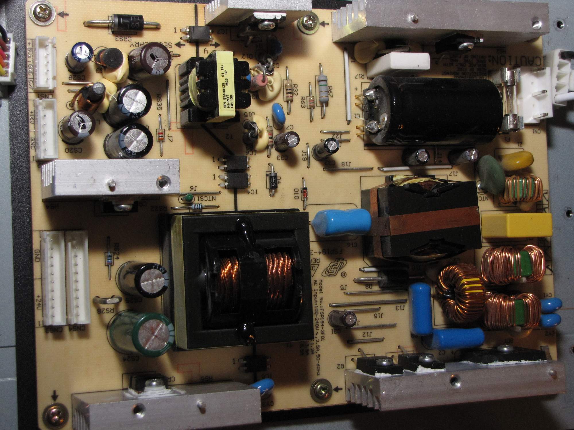

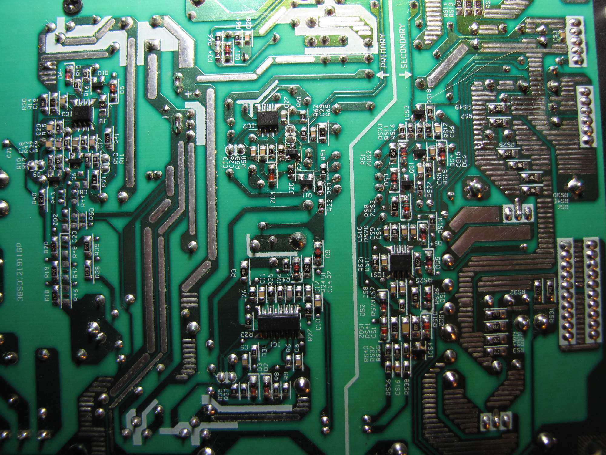

                          Ok, I tried to take a few pics. Top and bottom side of P.S. board (2 of bottom), one of the three other boards. and one each of the three up close.
                          Hope these help a little...please lmk if I need to take pics of other items.
                          Thank you very much!
                          • PlainBill
                            • Feb 2009
                            • 7034
                            #93
                            Very good pictures. The erratic output from the Standby supply while the main board is hooked up indicates either a problem with the main board, or a problem with that portion of the power supply. Please indicate which caps you replaced on the power supply (loading the picture into Paint and placing a dot on each new cap is sufficient), and also what brand and series of caps you used.
                            PlainBill
                            • pacmanretro
                              • Jan 2012
                              • 7
                              #94
                              the 3 on the top left of the first pic that have the black dot on them are the only ones I replaced. They were physically broken open at the top. I used a Tenma cap meter on the rest and they seemed ok, so hadn't messed with them.
                              IDK the brands - top left little blue guy says 28IVGN (brand - product? IDK).
                              Other two say KME.
                              These were some caps I just happen to have with my monitor parts. I honestly don't know their ESR...
                              • pacmanretro
                                • Jan 2012
                                • 7
                                #95
                                Could the no-name (Newark or digikey I'm sure) caps I used cause this sort of problem? What else should I really look for?...
                                Thought I would ask.
                                Thanks guys!
                                • PlainBill
                                  • Feb 2009
                                  • 7034
                                  #96
                                  Thanks guys!
                                  All capacitors are not created equal. A capacitor that is suitable for use in a radio is probably unsuitable for a monitor. The caps in the power supply are under unusual stress, they require low ESR caps. I personally prefer Panasonic FM, FR, and FC, series but will cheerfully use Nichicon, United Chemicon, or Rubycon if they provide the performance required.
                                  I would say yes, using general purpose caps might cause this problem, but there are also other causes. One I would suspect is the largest (typically 450 volt, 100uF). There is a small cap (typically under 100uF, 50 V) near the SMPS controller that can cause all sort of weird problems as it fails.
                                  PlainBill
