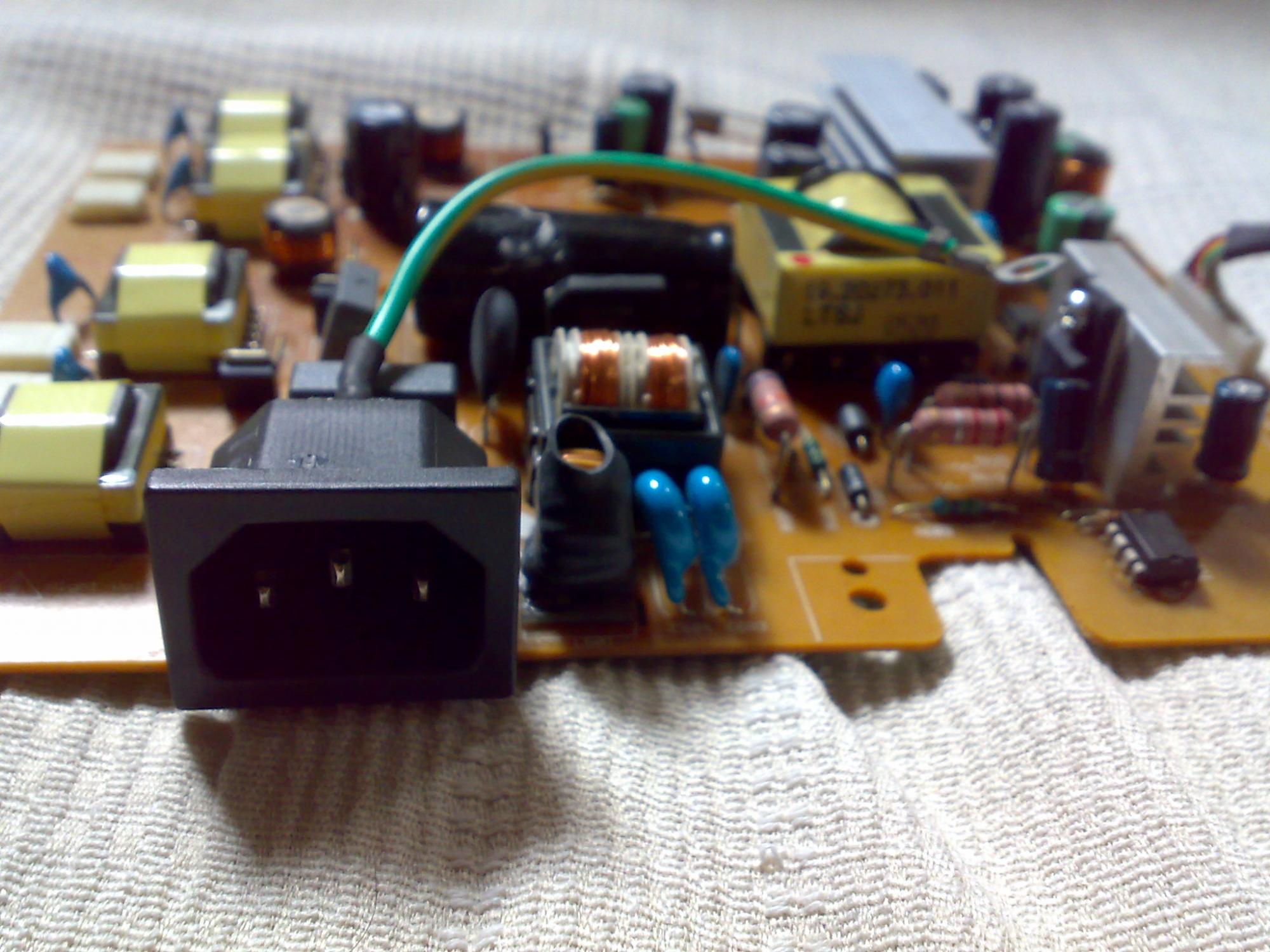

LCD 19" BENQ T905 problems
  • Grav
    replied
    Re: LCD 19" BENQ T905 problems
    ok.
    My bad: the caliber is 2000 ohms. No decimal display, the lowest number i can get is 0001 - if we except 0000.
    For a set of transistor, i have 1 ohm on each B/C/E junctions.
    For the other set, i have around 660 ohms for BC/CE/BE/CB junctions, 900 ohms for EB, and 100 ohms for EC. I assume they are ok
    For the picofuse, 1 ohm, same as failed transistors. I think this is the rounding.
    For 9024, i have junctions BCE going from 800 to 1200 ohms base values, always increasing (i assume they are corrects and coupled in some way with a capacitor).
    I unsoldered the polyester caps, inductances, the transformers, and reflow them. grrr... one track half removed on a transformer leg, but it seems ok (i have 40w iron). I quickly resolder the c5707 to see if i have identical troubles - display for 1s then shutdown - so assuming the transformers are powering the neons and are not badly soldered.
    Bought on ebay a set of 4x C5707 2x 9024 1x picofuse for 4 bucks. Next time for the real repairing
    (btw, i have not replaced the caps except the bad shape - slightly growth - 1000uF / 10v)
    Last edited by Grav; 11-03-2010, 09:33 AM. Reason: typo
    Leave a comment:
  • retiredcaps
    replied
    Re: LCD 19" BENQ T905 problems
    Originally posted by Grav
    Just to confirm, i have to unsold c5707, 9024 and picofuse to test them; i have to simply check if they are not shorted in anyway (except the picofuse which must be short).
    You can test everything "in circuit". If the components test bad "in circuit" then unsolder them and retest them "out of circuit".
    Leave a comment:
  • Grav
    replied
    Re: LCD 19" BENQ T905 problems
    Thank you retiredcaps, this is exactly i was aiming to do.
    Just to confirm, i have to unsold c5707, 9024 and picofuse to test them; i have to simply check if they are not shorted in anyway (except the picofuse which must be short).
    Thank you for your advices !
    Leave a comment:
  • retiredcaps
    replied
    Re: LCD 19" BENQ T905 problems
    Originally posted by Grav
    I have a low cost multimeter i bought at least 15 years ago. 2 calibers (2000kohm, 200ohms with 2 digits), max 200 V DC so i can't even check the transformer output.
    All you need to test the 1 picofuse, 4 c5707 transistors, and 2 fn9024 fets is the 200 ohm scale. Test the transistors and fets to see if they are shorted (i.e. less than 20 ohms). It should take about 5 minutes to test these 7 components.
    On Benq boards, it is rare to have the inverter transformer be bad. More likely, it just needs to be resoldered with new solder.
    I plan to replace the picofuse in all ways, because i guess i'd not be able to precisely measure its state.
    A good fuse should measure less than 1.0 ohms. You don't need anything more precise than that.
    Leave a comment:
  • Grav
    replied
    Re: LCD 19" BENQ T905 problems
    Hi retiredcaps,
    I have a low cost multimeter i bought at least 15 years ago. 2 calibers (2000kohm, 200ohms with 2 digits), max 200 V DC so i can't even check the transformer output.
    I plan to replace the picofuse in all ways, because i guess i'd not be able to precisely measure its state.
    I 'd really appreciate an oscilloscope, but i clearly can't afford
    Leave a comment:
  • retiredcaps
    replied
    Re: LCD 19" BENQ T905 problems
    Originally posted by Grav
    I'm now in the mood of trying the big step:
    - resolder the transformers
    - change the picofuse
    - change the FET
    - change the c5707 transistor
    (post #21 strict compliance)
    Do you think i should replace some caps, too, or my failure seems to be transistor-related ?
    Before changing anything, do you have a multimeter to do the tests mentioned in this thread?
    Leave a comment:
  • Grav
    replied
    Re: LCD 19" BENQ T905 problems
    Hello.
    I'm new too. I have the first failure described in this thread:
    - Power on - Led stay green
    - BenQ logo stays for 500ms
    - auto power off
    I can reproduce the problem.
    I have read numerous threads about it. I have replaced 2 bad-shape 1000uF 10v caps.
    I'm now in the mood of trying the big step:
    - resolder the transformers
    - change the picofuse
    - change the FET
    - change the c5707 transistor
    (post #21 strict compliance)
    Do you think i should replace some caps, too, or my failure seems to be transistor-related ?
    How it could work a tiny moment, then power off ? It means the backlight is ok, so could it not mean the c5707 and FETs are ok , or exactly point they are not ? The part remains a mystery for my own comprehension
    Leave a comment:
  • retiredcaps
    replied
    Re: LCD 19" BENQ T905 problems
    Originally posted by capullaco
    So im at the same point as the 1st time
    Right now, I can't think of anything obvious.
    Maybe someone else will have some suggestions.
    Leave a comment:
  • capullaco
    replied
    Re: LCD 19" BENQ T905 problems
    So I replaced the jumper wire with an insulated one.
    Rechecked the bridges I mentioned in posts before, and they seem fine. Sucked the tin and the points bridged were very,very near,almost touching, so I guess its ok.
    Then added tin on some solders that had little (2 pins from my solders) and the rest seemed ok.
    But I tried and... BenQ logo, but its a bit dark and the display was making a sound.
    Turned off and on again, same BenQ logo with artifacts. Turned it off and unplugged it.
    The fuse is gone, and one of the problematic transistors too. One combination of pin reading shows 7 ohms.
    And both trans have low (or I think theyre low) resistance (135~ ohm) on some of their pins.
    So im at the same point as the 1st time
    Leave a comment:
  • capullaco
    replied
    Re: LCD 19" BENQ T905 problems
    Yeah,it was insulated. But I got a very short cut to made it as tiny asd possible,but at the end the plastic melted and was loose.
    I think it doesnt make contact.But I will replace it.
    Leave a comment:
  • retiredcaps
    replied
    Re: LCD 19" BENQ T905 problems
    Just noticed that for your jumper wire, it is not insulated. I normally see insulated wire, not bare wire.
    When you put the board back in, that bare wire could be touching something and causing a short?
    Leave a comment:
  • retiredcaps
    replied
    Re: LCD 19" BENQ T905 problems
    Originally posted by capullaco
    What should I do now that I replaced the picofuse?
    Put it away for a day. Take another look at it tomorrow when there is good sunlight and recheck the soldering.
    If it looks good and transistors and fets are not shorted, try it again.
    Leave a comment:
  • capullaco
    replied
    Re: LCD 19" BENQ T905 problems
    Ok,so only the picofuse is blown. The transistors that blown twice are also ok, and so the FU9024
    The bridge I did to one of the pins from the lifted pads seems also ok, giving continuity.
    So only the picofuse is blown, luckily I bought today a 125v one. (Already replaced it, thought havent assembled the board yet)
    I attached some pics.
    1- The transistors and the irfus.Theyre all ok.
    2- Just now I noticed this soldering with the daylight.Its more golden. I just sucked it and replaced with new tin.
    3- This golden tin is from one of the pins of the TR601
    And the rest is the PCB in general (you can notice my fuse pins improvisement :p)
    What should I do now that I replaced the picofuse? Maybe it blown cause it was 220v instead of 125v? That wouldnt make sense,would it? Btw, it has the same amp (3A).
    Or maybe the 220v protected the transistors (they arent blown) caused by something?
    Last edited by capullaco; 09-09-2010, 08:53 AM.
    Leave a comment:
  • retiredcaps
    replied
    Re: LCD 19" BENQ T905 problems
    Originally posted by capullaco
    But the last time I checked all the 3 legged components,
    If your board looks anything like the OP, this is the backside
    https://www.badcaps.net/forum/attach...0&d=1226067862
    showing where the FU9024 are in relation to the c5707.
    Leave a comment:
  • capullaco
    replied
    Re: LCD 19" BENQ T905 problems
    Ok, tomorrow im gonna check all the componentes again.
    But the last time I checked all the 3 legged components, they were ok except for the 2 transistors (I made a mistake in some post above saying there were 4 blown transistors, the other 2 were double diodes and they were also ok)
    nice night guys, uni class starting tomorrow
    Leave a comment:
  • retiredcaps
    replied
    Re: LCD 19" BENQ T905 problems
    Originally posted by capullaco
    Diferent voltaje but same amp, the guy told me that the amp is the important stuff and it should work with a 220V fuse.
    Amp is the most important. It should be the same.
    The FET is most likely FU9024. It is a 3 legged component and looks like a transistor. If you find, test to see if it is shorted (same procedure as testing a transistor).
    Leave a comment:
  • capullaco
    replied
    Re: LCD 19" BENQ T905 problems
    Diferent voltaje but same amp, the guy told me that the amp is the important stuff and it should work with a 220V fuse.
    Leave a comment:
  • retiredcaps
    replied
    Re: LCD 19" BENQ T905 problems
    Originally posted by capullaco
    Yeah, I changed all the blown things, the picofuse (actually used a normal fuse) and 4 transistors.
    Normal fuse? Is this fuse rated the same amp and voltage as the picofuse?
    Leave a comment:
  • retiredcaps
    replied
    Re: LCD 19" BENQ T905 problems
    Originally posted by capullaco
    Im gonna test all the things again,and try to make a better pic, but cant do miracles with the mobile phone (a relative has my cam and he will be out for a long time)
    The FETs could be on the backside on the board.
    Take the boards to a window on a sunny day. Turn off flash. If your phone has macro mode, use that. Look at your pics on the computer to make sure everything is legible. Some of us don't have PlainBill's 20/20 vision.
    Leave a comment:
  • capullaco
    replied
    Re: LCD 19" BENQ T905 problems
    Yeah, I changed all the blown things, the picofuse (actually used a normal fuse) and 4 transistors.
    BTW, the caps are orientated right, Im 100% sure. (white painted side with the negative side, the shorter pin)
    Which ones are the fets? When I checked the transistors ,only 4 were blown, the rest were ok.
    Im gonna test all the things again,and try to make a better pic, but cant do miracles with the mobile phone (a relative has my cam and he will be out for a long time)
    Last edited by capullaco; 09-08-2010, 04:30 PM.
    Leave a comment:
  • Caspar
    BENQ GW2780-T power board blown
    by Caspar
    Hi all, I am looking for some help in ID'ing some parts in an attempt to fix a power supply from a GW2780-T monitor. The power supply PN is 715G7300-P02-006-0V3R. I have been looking around for the PN and it appear the board was used by other OEMs as well (ASUS, Viewsonic). If anyone has a schematic, it would be helpful.
    Quick look on the underside of the board, I can see:
    -D905 is blown - ? value
    -R920 is open - 1Ω ?W
    -R927 is open - 20Ω ?W
    On top side, I see:
    -R931 open - 0.68Ω ?W
    Metered short:
    -P9NK65ZFP...
    06-01-2022, 05:16 PM
  • jean luc ferre
    laptop hp g72 b52sf screen problems
    by jean luc ferre
    on this laptop hp g72 b52sf i have screen problems as you can see with the photo joined in attachments.
    the used graphic card is "intel hd graphics" and the id of the integrated screen is : "monitor/SEC3354".
    i verified the driver of the péripherals and they are ok. i verified the definition and settings of the graphic card and of the screen : definition 1600x900 and refreshment frequency :60hz. (they are the sames for the graphic card and the screen).
    i don't understand the reasons of the white stripe at the bottom of the screen below the task...
    06-07-2025, 03:27 PM
  • drscoot
    HP X360 convertible battery blown fuse error, not charging
    by drscoot
    HP Modelnumber: 14-dh0061nb​
    This laptop had a shorted cap on a Vcore section. After replacement is works again. But there is still a battery issue.
    The battery is HT03XL and with the built-in component test from HP, in the Power section, I get an error: Logic State: Calibration required (20), Charge state: Blown Fuse (42)
    I have another same battery, also with error: Logic State: Very Weak (70), Charge state: Blown Fuse (42)
    And a third battery TF03XL (looks identical) with error: Logic State: OK (0), Charge state: Blown Fuse (42)
    All these 3 batteries are charging...
    12-15-2023, 05:54 AM
  • Hondaman
    USB problems?
    by Hondaman
    Recently I discovered my SSD died (OCZ/Toshiba 240 GB). It was in a USB enclosure, attached to the Linksys WRT-AC1200 router. Since then I removed the USB enclosure and attached it to my Win7 PC (AMD 8150 CPU, 970 chipset, 64 GB RAM). I also gathered one or two other USB enclosures to figure out what is going on.
    (I suspect that I lost quite a few MP3 and FLAC files I recently ripped from my audio CDs, I think I lost very little un-replaceable stuff.)
    I think it is IMPOSSIBLE for Win7 to have any problems with a USB enclosure as long as Win7 knows how to speak to the...
    08-12-2024, 03:26 PM
  • swerg
    Part selection for possible blown inductor on ASUS GX531-GW-AB76 laptop mobo
    by swerg
    Hey everyone,
    I'm a novice trying to repair my laptop. The LCD screen has an image, but no LED backlight for the image. It also produces an image when connected to an external monitor.
    I have found what I believe to be a blown inductor labeled "L4502" and "120 Ohm" in the schematics (zoomed in image, blue arrow to blown component). I have included an image of the general area of the mobo and an excerpt from the schematics as well.
    I am having trouble selecting a replacement component, which I believe to be a 120 Ohm ferrite bead, from the components...
    06-06-2024, 03:39 PM
