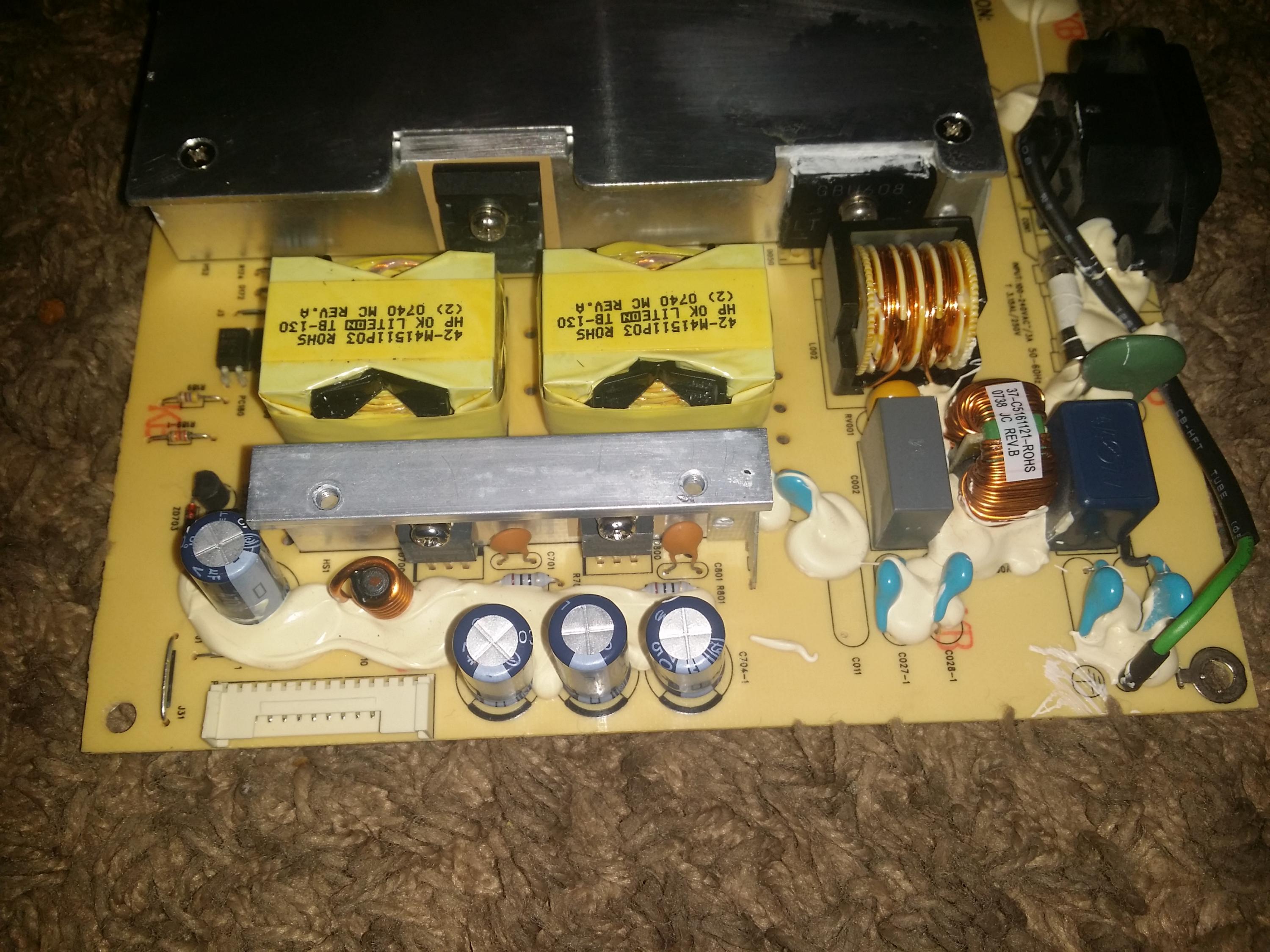

    I've found out that the 24V rail isn't working on my brother's 3007. The panel itself works, and I get an image; the issue is that the backlight doesn't work.
    Poking with a multimeter, I was able to confirm the other voltages were correct, but the 24V rail was outputting 0V, and it was neither a short nor a break.
    I'm just not completely sure where to look next.

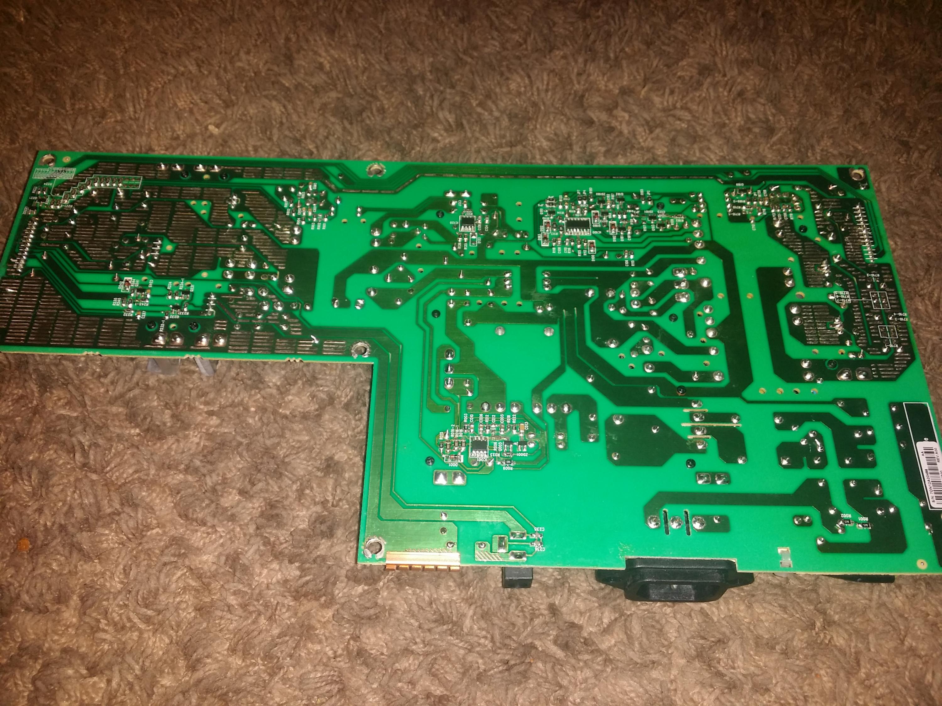

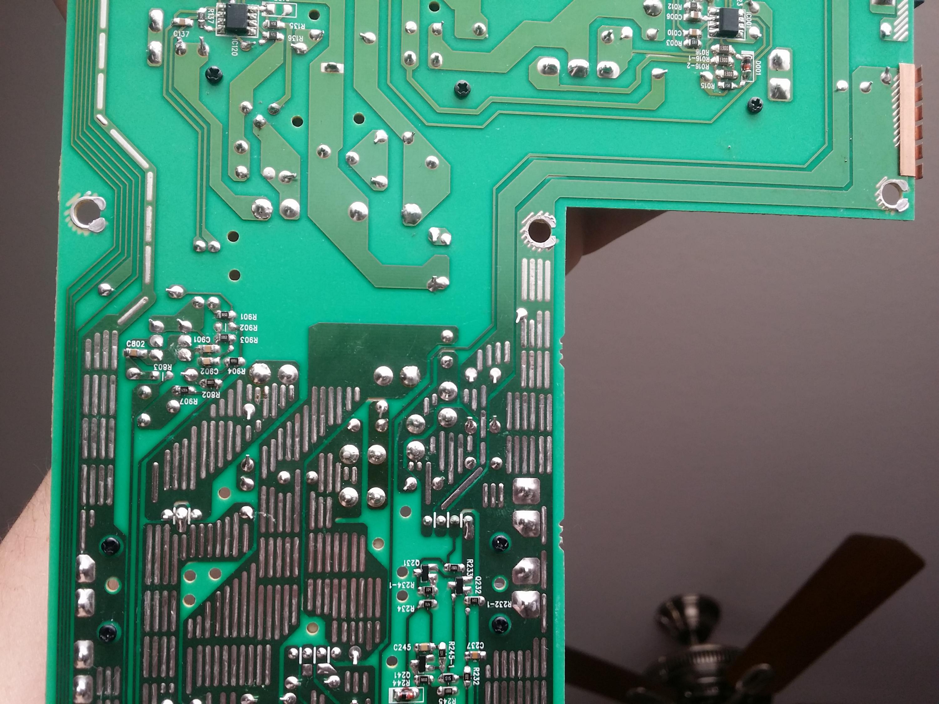

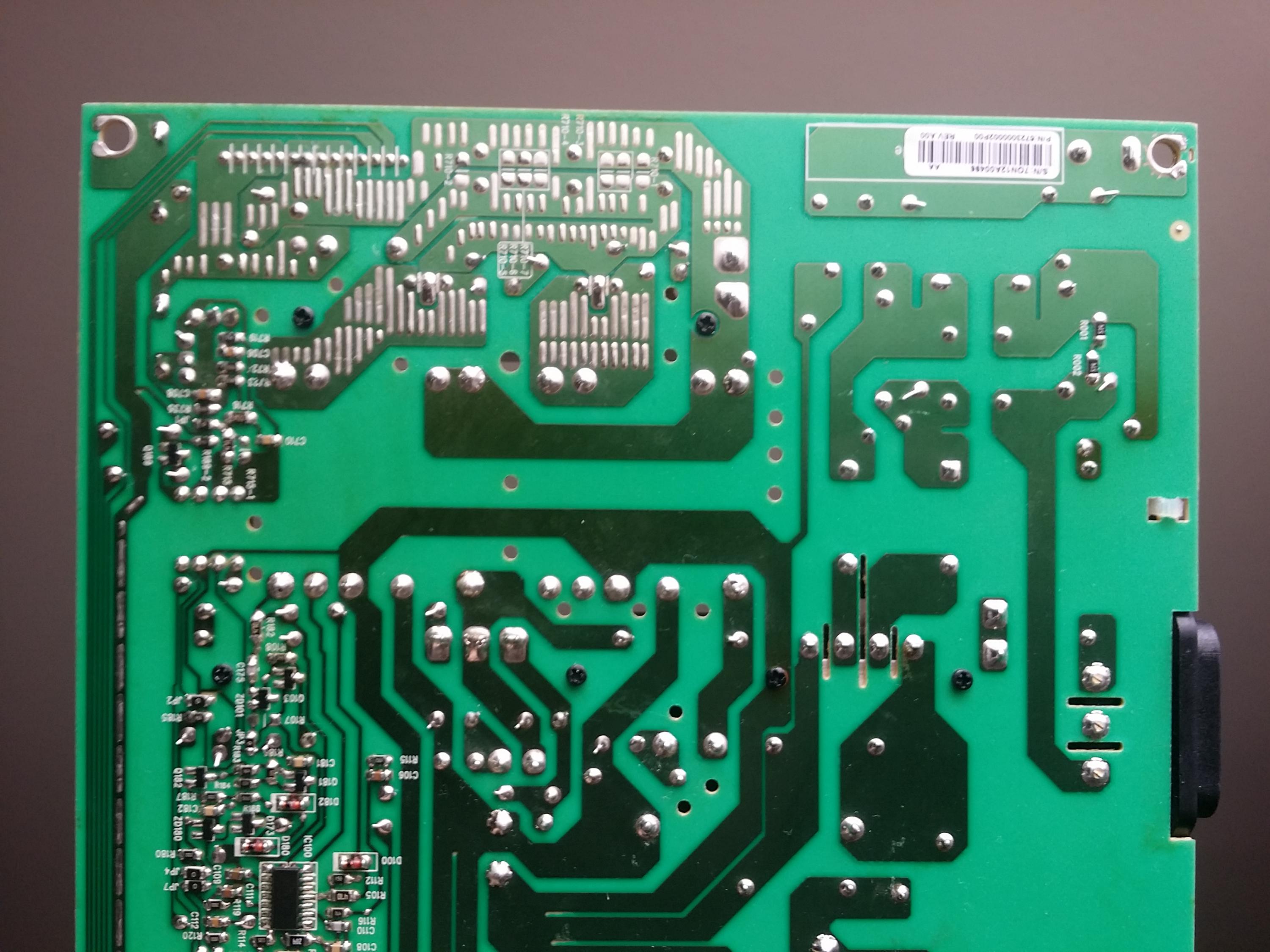

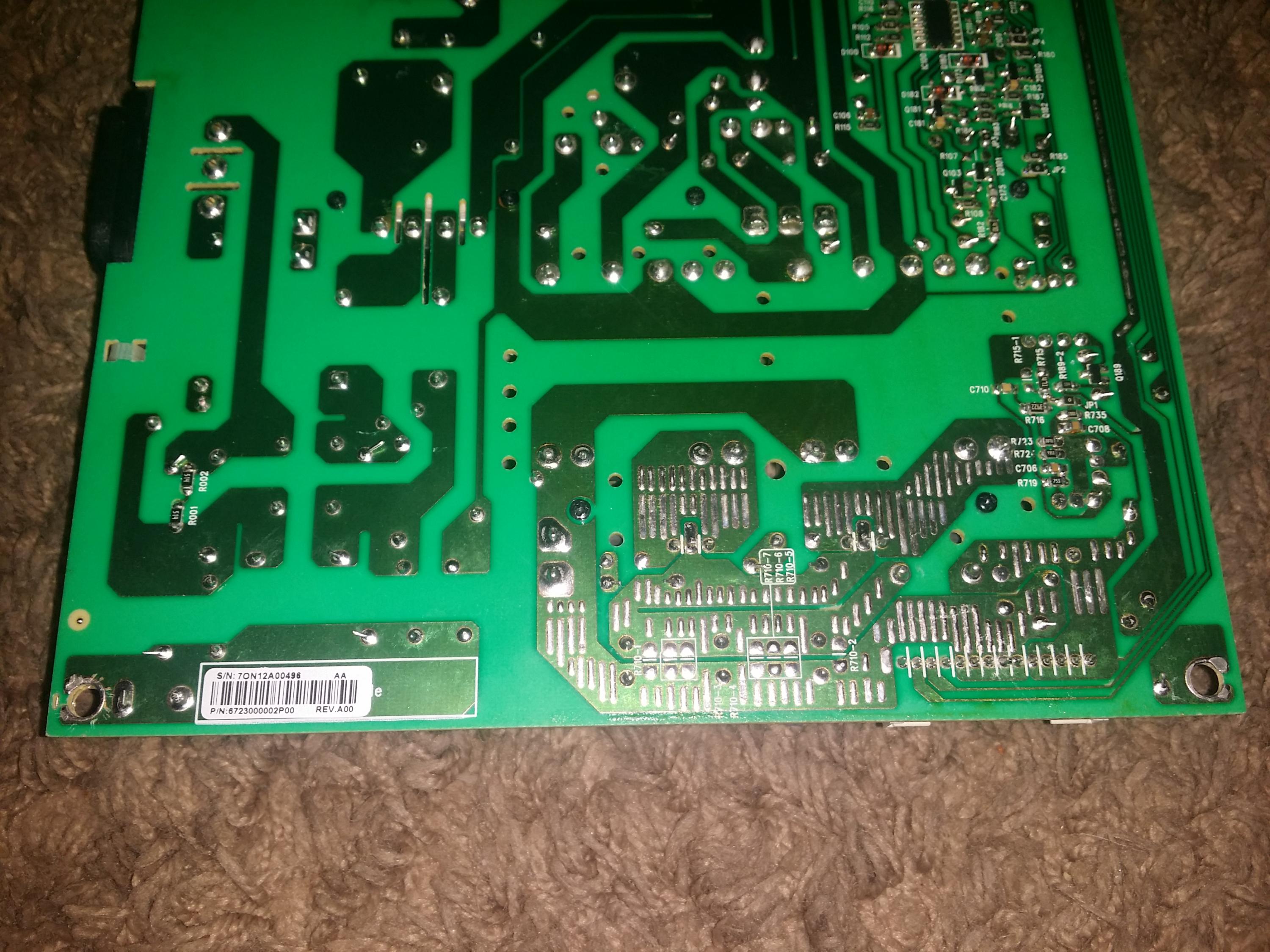

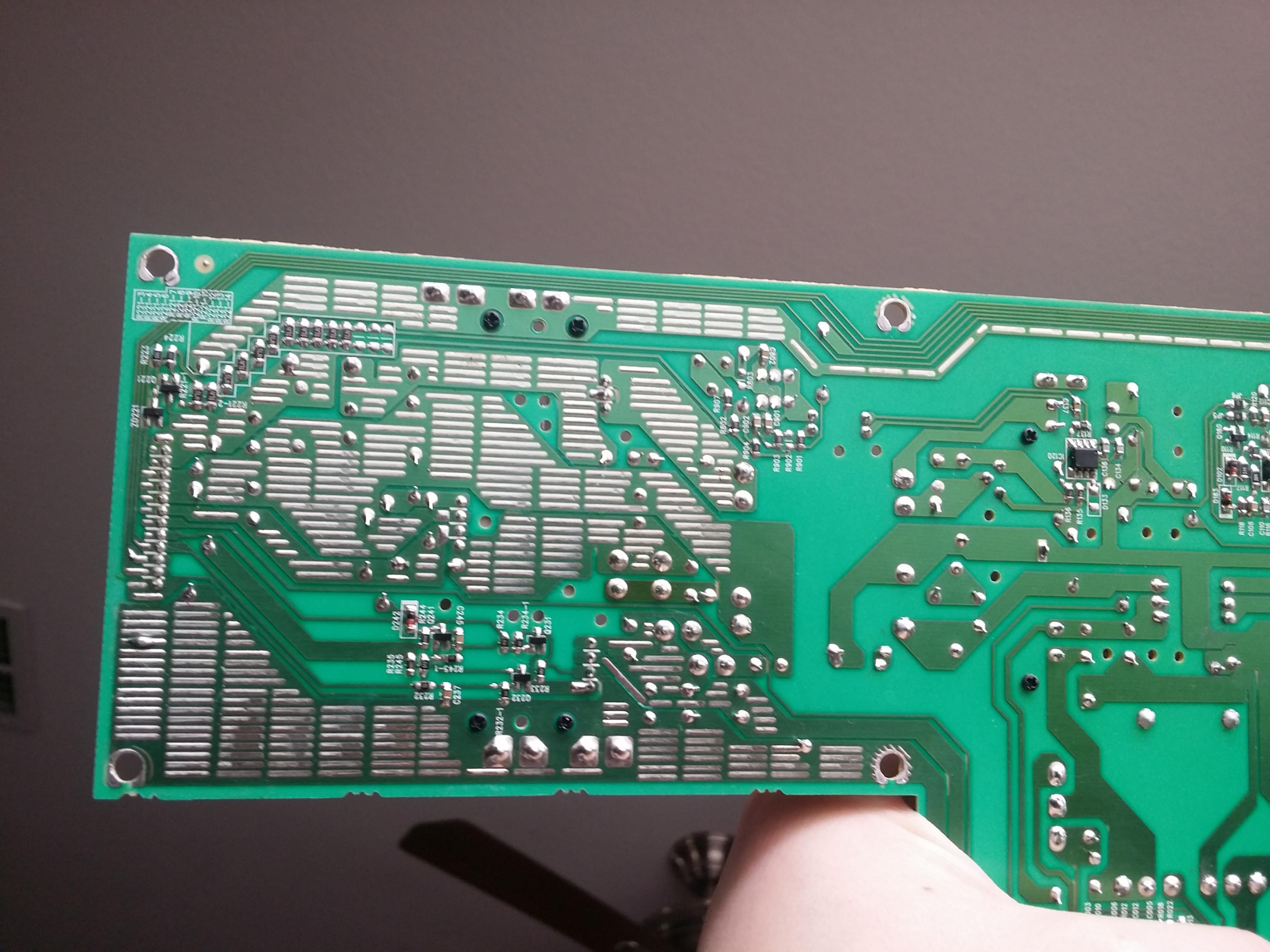

            We still need good clear straight shot pictures of the top and bottom side of the board so we trace out the circuit.
              Re: Dell 3007WFP - 24V rail not working
              I went through my HD and found pictures and how I tested the board.
              https://www.badcaps.net/forum/showth...d=1#post720156
              LITEON PA-4151-1-LF

                      There's any of the many images that explains how the 24v psu starts or work, i've marked with RED box the area that have to be photographed, and with YELLOW the area that i think it must be checked first, all components. Bye.
                      especially, 1 of the 2 optocouplers is made to transport to primary the enable signal, it must check around 5v on diode when monitor is on, on the primary (phototransistor) it must have 0v.
