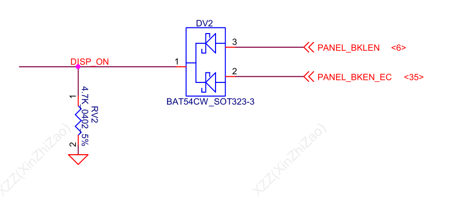

    I have dell 5490 la-f401p problem: no display ( in HDMI out working )
    changed working bios ,working screen ,cable
    Please help me to resolve the issue
    i have more then 7 laptop's having the issue

    Since video output is present in HDMI,focus on edp pin voltages.
      thanks for replay
      i checked pin voltage
      display on voltage missing IN DV2

        Continue to trace this signal.
        Locate the dual common cathode diode @ DV2.
        Measure the voltage to ground on each leg of this dual diode. Post each measurement.
