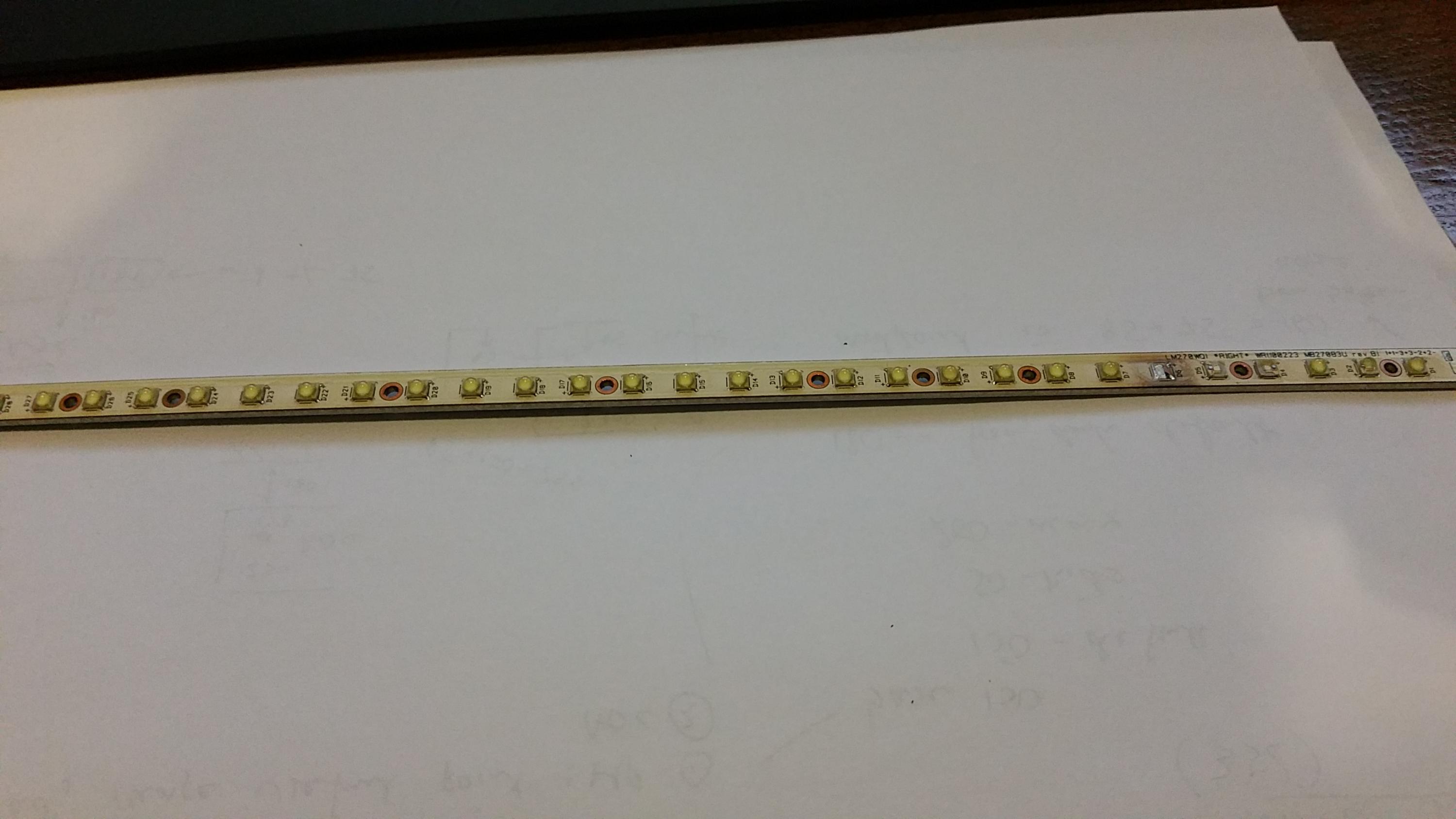

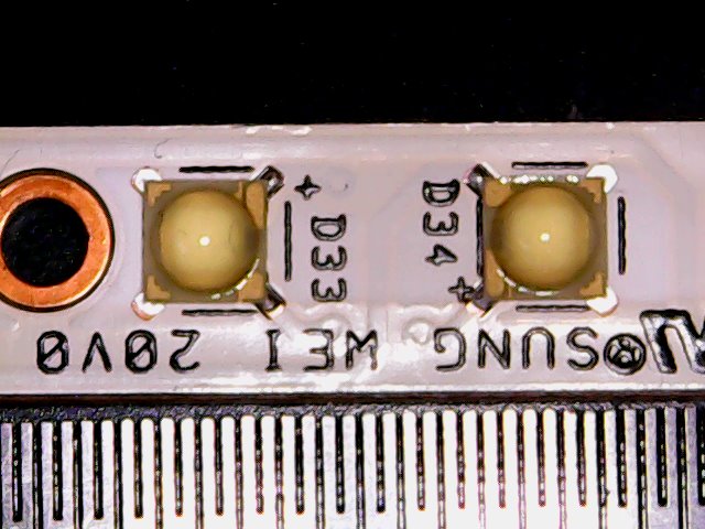

    Hi. I would like to gather advice about sourcing replacement SMD LEDs and/or LED backlight strip PCBs. As this is a general issue I thought we can have have a new thread.

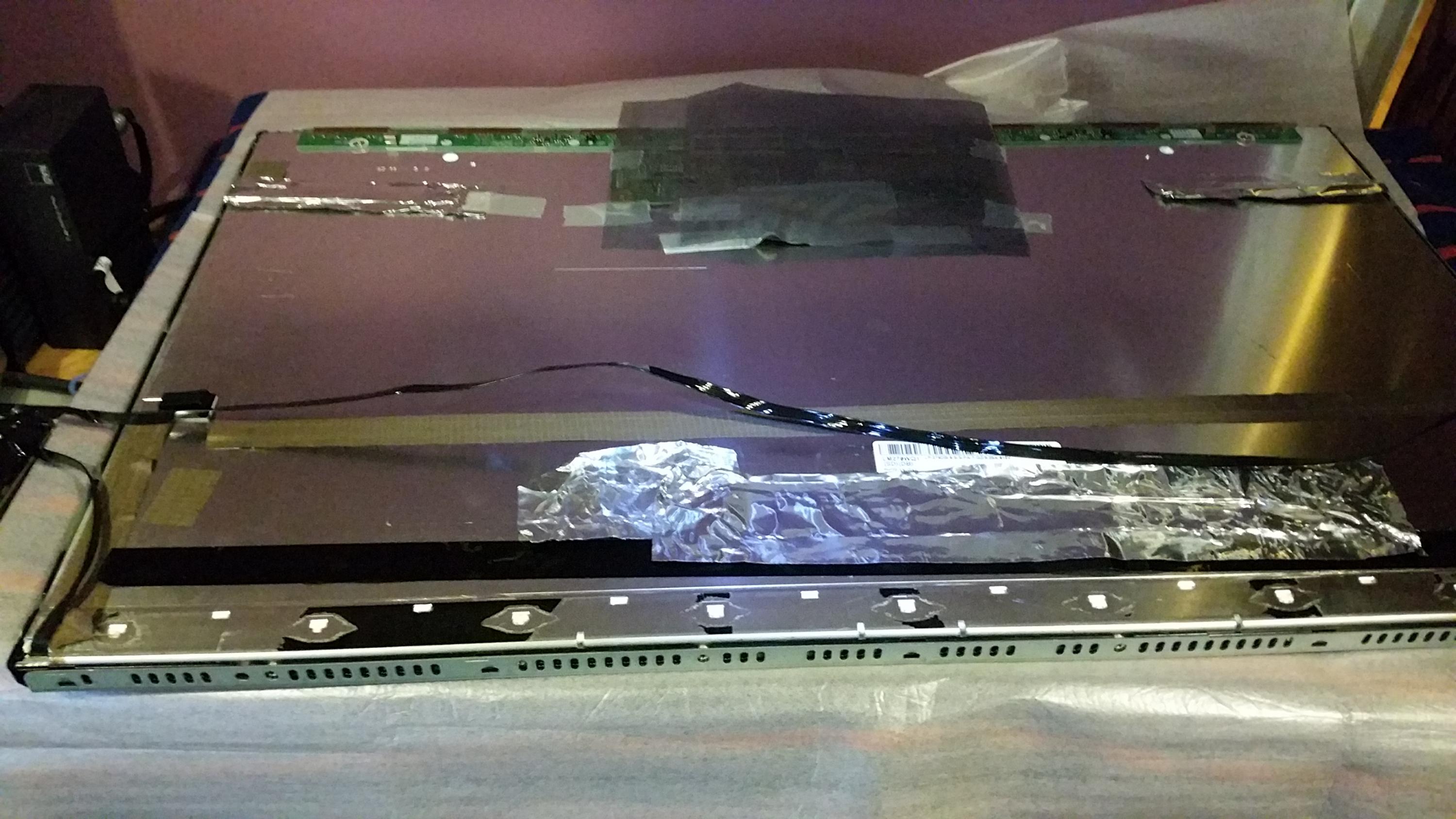

    As you will see here, I have an HP ZR2740W 27" IPS monitor for which I need to repair or replace one of the backlight strips. The panel is made by LG. I cannot work out how to find replacements.
    I know the electrical characteristics, physical dimensions and details of the panel. I need to identify the correct replacements and find a supplier who will sell in a low qty (say 10) and ship to UK.
    The specs for the LEDs I need to find:
    Panel:
    Mfr: LG
    Panel Model: LM270WQ1-SDDA
    Backlight:

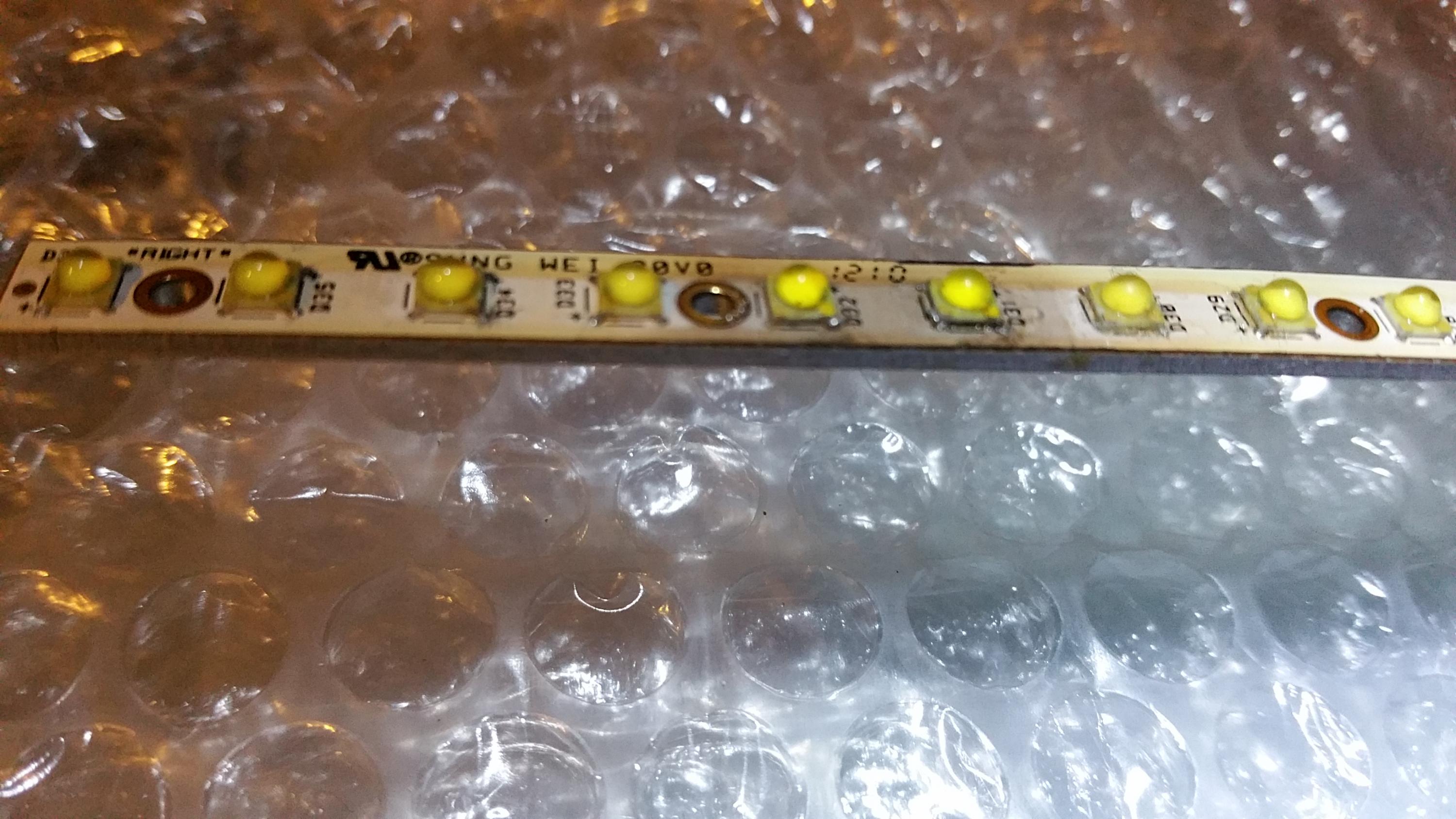

    Configuration: 2 strip PCBs each with 3 electrical strips of 12 LEDs. 35.5V each.
    Part number on PCB "SUNG WEI 20V0", "LM270WQ1 *RIGHT* WR (100223 MB27083U rev B)"
    LED chips:
    Fwd Current: 310-330mA
    Voltage: 3V
    Power: Approx 1W
    Lens: hemispherical domed yellow lens
    Package: 4 pin SMD, only 2 pins used.
    Obviously they also need to be the same colour and luminosity but I can't see specs for these. Is there at least a standard colour temp used?

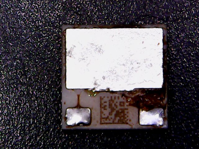

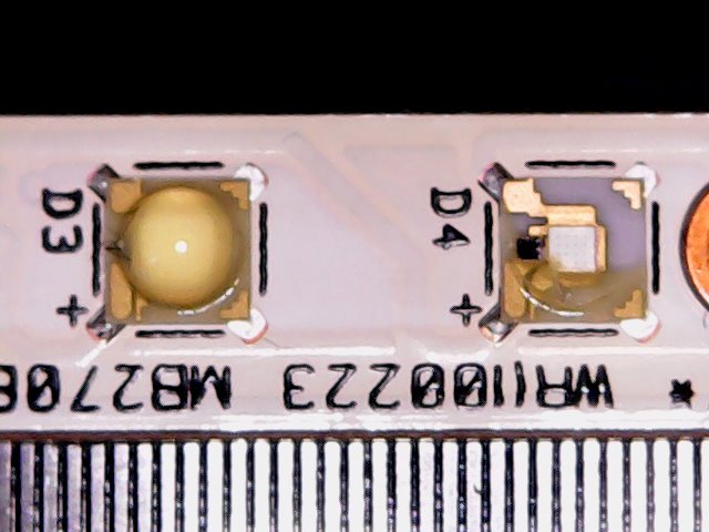

    I have attached pics showing the LEDs next to a ruler. The one I have damaged (during disassembly) shows the electrical pinout.
    thanks in advance!

    So I found the LEDs are coded with a 4 digit number which represents the x,y dimensions in tenths of mm. For instance there is 3528 which is 3.5mm x 2.8mm.
    Mine are 3.0mm square so I'm looking for 3030 SMD. This doesn't seem very common and none of these parts have the domed lenses that the original strip has.
    I guess the LEDs for the LG panel would have been manufactured by "LG Innotek" so I will see if there is a parts division I can email.
    These are the most similar I found so far.
    Any ideas anyone? I'd also be interested to know how much it is likely to matter to get the exact same brightness and colour.
    HP's spec for the monitor says "Default color temperature 6500 K". Could I assume this is the correct colour for the LEDs?
    thanks!

            Hi. Thanks for the help. I think i've got the right parts on order now thanks to Mr 'lelos2' on eBay.
            I had seen the Osram ones looked similar but they were not the same. The parts he found were Lumileds LXML-PWD9N, 3W 3V 3030. They certainly are the same voltage, have the same type of lens and have the same solder pad pattern. I'm awaiting the order, so will be able to try in a couple of weeks.
            My advice is that it is really hard to find the exact correct LED, and that I found someone who was able to help locate the right part in the end!
            I realised that the other 3V 3mmx3mm ones i found simply would not fit due to the different solder pad patterns. I just looked at the data sheet for the Osram ones on RS which you posted (thanks PeteHall). These have 3 parallel strips as pads. See attached for the pads on these LEDs which seem pretty unique.
            I'm hoping these turn out to be exactly the same as the originals, and hoping i can solder them on with the hot air station OK. Both things harder than anticipated

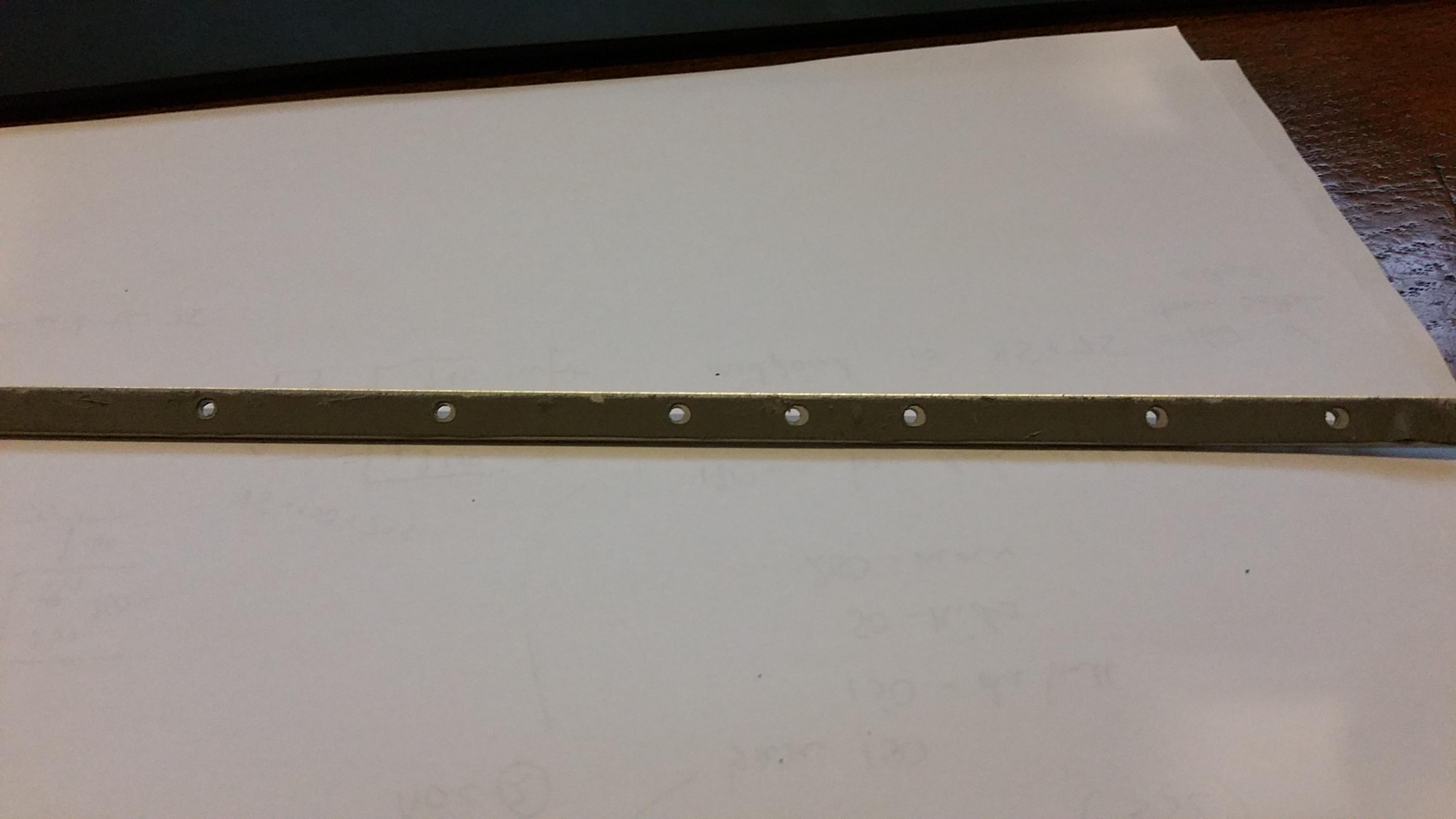

                Well, Google hasn't shown me any hits at all that point to being able to find a replacement strip so that is not an option anyway. It is definitely special for this panel as the PCB has the panel model # on it.
                When i was trying to remove it i was focusing on the side with the A, K pins and didn't think of the huge heat pad underneath the other side. Maybe better next time as there are a handful i need to replace. I cracked the lenses off when removing the strip. I think the original fault was a dry joint on the connector (which is really weedy and fell off the PCB whist removing). All but one of the LEDs worked and the strip that was causing the PSU to shutdown was not the one with the shorted LED in.

                    Thanks for the videos - that was interesting. The strip i have is small and narrow (see pics). I think I'll continue to try heating from above with the rework gun. I was using the narrowest nozzle (<2mm dia); perhaps I should use a larger one and turn up the flow and/or temp. The specs for such LEDs seem to say the reflow temp should be 260C but this wouldnt budge until the station was set to about 350C.

                                  OK.. I fixed it now! This was thanks to the seller mentioned above finding the right LEDs.
                                  Soldering the new ones on was very tricky indeed. The first few i did look pretty awful and eventually the don't look too far off the original ones.
                                  The LEDs were closely spaced so heating the whole strip seemed like a bad idea. The most successful method i had was to tin the pads and the underside of the LED with an iron, then melt the solder on the pads with the hot air set at 315C. Then i'd slowly lower the LED over it, keep heating for a few seconds and remove the hot air. Then go round adding solder paste and either reflowing or using the iron until the A and K were soldered well. I couldnt manage to just sit the LED there with paste and apply hot air. The LEDs got melted and/or flew off the board.
                                    Re: Sourcing replacement backlight SMD LEDs or Strips (LG panel)

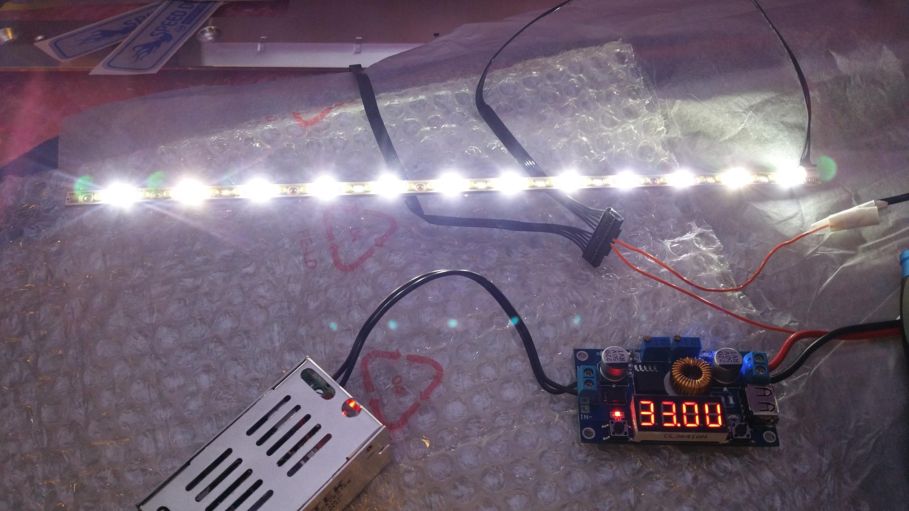

                                    Updating this due to comments on the other thread.
                                    Pic shows the strip fixed, then tested using a little constant current source PCB (showing 33V). Finally i tested it in situ. This WAS necessary because the connector is very dodgy and once I didn't solder it very well, finding it failed again when I had reassembled the panel.
