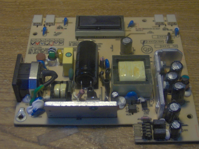

    VeiwSonic VA912b
    Flashing green light. No picture. All the caps were CapXon.
    The three bulging caps were 470uf 25v reading between 3 and 7 ohms esr. The big 100uf 400v cap had a slight bulge but was open.
    Cap list
    KF series: mfr spec qty
    470uf 25v 10mm x 16mm ripple=1200 imp= .076 5
    470uf 10v 8mm x 12mm ripple=580 imp= .25 1
    KM series:
    100uf 400v 18mm x 35.5mm ripple=550
    I replaced the KF series with Nichicon PW, same sizes and spec.
    The KM series I used a Nichicon PB that was 18mm x 40mm.
    There was a small cap that looked like a 22uf 25v that was covered in glue that I left in.

    Wow thats a beefy HV transformer.
    Does it have both inverter circuits in one package?
