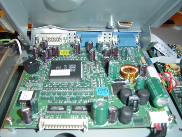

    Hello all,
    I've got a LCD from ViewSonic. The model is VP171b. It shows the right image for 1 second when I turn it on and then goes black. Powering it off and on again makes the same.
    If I direct a flash light on it, I can see what I should see. It's very dark though. From what I've read, it seems to be an inverter problem, am I wrong ?
    and reading the posts, it seems that this is usually related to a dead caps.
    The caps of my LCD are (according to another post in badcaps)
    PSU:
    Li-Shin AREX 94V-0
    2 Panasonic 16V 1000uF 105oC HFA
    1 Panasonic (unknown value because epoxy covered that side, but it is about 1inhc in round, and what I can see says Ce GH)
    1 Rubycon XYG 50V 22uF
    Backlight Inverter:
    Emax 44.61101.001
    2 HERMEI 25V 100uF
    1 SSA 50V 2.2uF (M)P1 CE 105oC
    4 3kV 22J Ceramic caps
    2 250V PMS124J Ceramic Caps
    Video Board:
    Coretronic Corp
    Genesis gm5120 chip
    13 Taicon 16V 180uF 0304(M) 105oC (VT)
    2 Taicon 10V 1000uF 0304(M) 105oC (HF)
    2 Taicon 25V 10uF 0302(M) 105oC (PW)
    1 Taicon 16V 2200uF 0238(M) 105oC (PW)
    1 Taicon 16V 470uF 0246(M) 105oC (VZ)
    I'de like to know what would be the most pragmatic solution for trying to identify bad caps and replacing them as I've never tried to repair a LCD. I put some picture of the LCD boards in attachments.
    Can you help me ? Thanks a lot in advance, I'd really like to make this screen works again

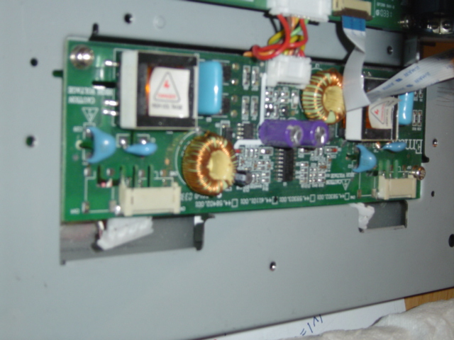

    Re: Backlight problem on viewSonic VP171b
    Yes your inverter is shot.
    You are lucky enough to have a separate inverter module (the little board with the purple probably Hermei crap caps on it).
    I would check the SMT driver transistors near the blue caps for shorts with a DMM. If they check out good.
    Replace the 2 Hermeiphrodite caps with good Low ESR caps and try to monitor again also check for any cracked solder joints.
    KC stated in another post that the yellow adhesive used on the torroid inductors on that board breaks down and eats at the traces so check that too. Remove the inductors remove all of that yellow crap and repair any broken traces.
    Check out this thread:
    https://www.badcaps.net/forum/showthread.php?t=5043
    In a worse case scenario you could always just buy a new inverter module just replace any bad caps on it off the bat so the your new inverter has a long life.

                With a factory assembly line partially down because of a failed Planar
                touchscreen backlight, and no other staff or spare touchscreens available
                since everyone was off for the holidays, I was forced to dig into
                troubleshooting the EMAX LCD backlight driver board. The board on this bad
                monitor is identical to the one cited in this thread.
                Thanks to some initial leads from this thread, I was able to eliminate the caps
                and also get confirmation on the key symptom of this board's particular failure
                mode: The monitor does light up for about 1 second after power up, and
                then it will go dark. This turned out to be key to verifying the root cause.
                From other searches around the web, it would seem this is a common failure
                mode for these Emax LCD backlight driver boards that have two or more
                outputs. Here's why.
                As it turns out, U1 (BA9741) is a dual switch-mode power supply chip that
                drives the primary sides of two high-voltage step-up transformers. The
                datasheet is readily accessible online. It has two outputs, each that drive
                the two separate high voltage supplies on opposite sides of the board. In
                short, the reason why the monitor is lighting up for 1 second is because one
                stage is working, but the other stage is not. Because the dead stage has
                zero volts at its ultimate output, the short circuit detection feature of the
                BA9741 shuts down the entire chip (both stages) in about 1 second. You
                may notice when the monitor backlight comes on, it's only at about half
                brightness anyway.
                I dug deeper and found that the root cause had nothing to do with the
                capacitors. Having dual, identical circuits to compare against each obviously
                made what could have been a difficult job much easier. The problem was due
                to a failed U8 (SDM9435A), the main P-channel MOSFET in an SO-8 package
                that is used to switch 12V to the primary of one of the high voltage
                transformers. I ordered up some replacements from Mouser for $0.80 each
                and will receive them tomorrow. Should be a piece of cake from here, but I
                will post another reply confirming that the fix worked.

                    Update and declaration of success: I received the replacement MOSFETs on
                    time via FedEx, soldered them in, and reassembled the monitor. It is up and
                    running and functioning properly.
                    My conclusion is that perhaps the design of the circuit is a bit marginal. The
                    MOSFETs only have a maximum VDS of -30Vdc and the body/flyback diode
                    can only handle 1.7A vs. the 5A that the FET can conduct. It's possible that
                    over time the diode will fail because of this under rating, and then leave the
                    FET unprotected resulting in its ultimate destruction. Perhaps adding an
                    external flyback diode might help. I have 5 more new MOSFETS and about a
                    dozen more Planar monitors of identical model type throughout my factory.
                    I'm ready if and when the next one does the same thing, which won't surprise
                    me.

                                    the feedback is actually coming from primary (low voltage) or the secondary
                                    (high voltage) side of the transformer. It would be best to check if there is
                                    output voltage on the primary side at the output of the MOSFET (for each
                                    power supply circuit) and go from there. It will be there and be measurable
                                    for the 2 seconds before U1 shutsdown. If there is voltage all the way to
                                    the primary of the transformers, then something may be wrong with the
                                    transformers themselves and/or their soldering, or with the feedback circuits
                                    thereafter (if that is where they are located). Since you can't effectively
                                    measure the secondary voltage without an attenuating/high-voltage probe,
                                    you'll have to check for problems there using continuity and ohm readings
                                    when the power is off. If voltage does not exist at one or both of the
                                    primaries, you need to probe on the gate side of the MOSFETs and
                                    trace back from there. There's not much more than a resistor or two before
                                    you reach U1, so if the gate signal is dead, it could be due to a faulty
                                    switcher chip.
                                    The good news is that since there are two identical circuits, you can go back
                                    and forth in order to determine where the difference lies.
