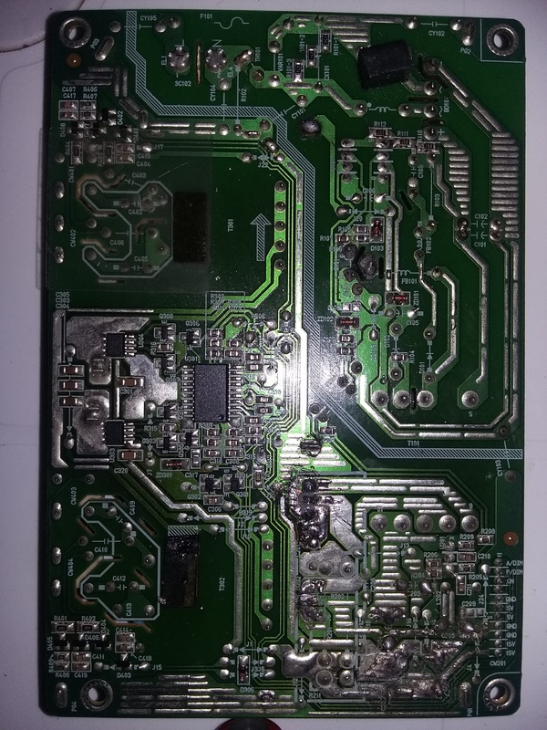

    I had this LG flatron M1717S monitor for a quite some time now. Couple of days ago it stopped working, it is completely dead and even the LED is not working.
    I have some experience in fixing boards but when it comes to SMPS I am not very good.. But in this particular case it is a challenge for me to fix this.
    I found the output caps leaking and I replaced them all, but still no success.
    The bridge is producing 319 VDC.
    I took the power FET and test it out (using dirty test), and it seems to have no problem
    The voltage between the 5v pin and the gnd pin is 1.4-1.12.
    The 15v pins and the gnd pins are all shorted!!.
    In one of the Schottky diodes I found that all pins are connected together!!.
    Here's the board after replacing the caps
    Please advise.

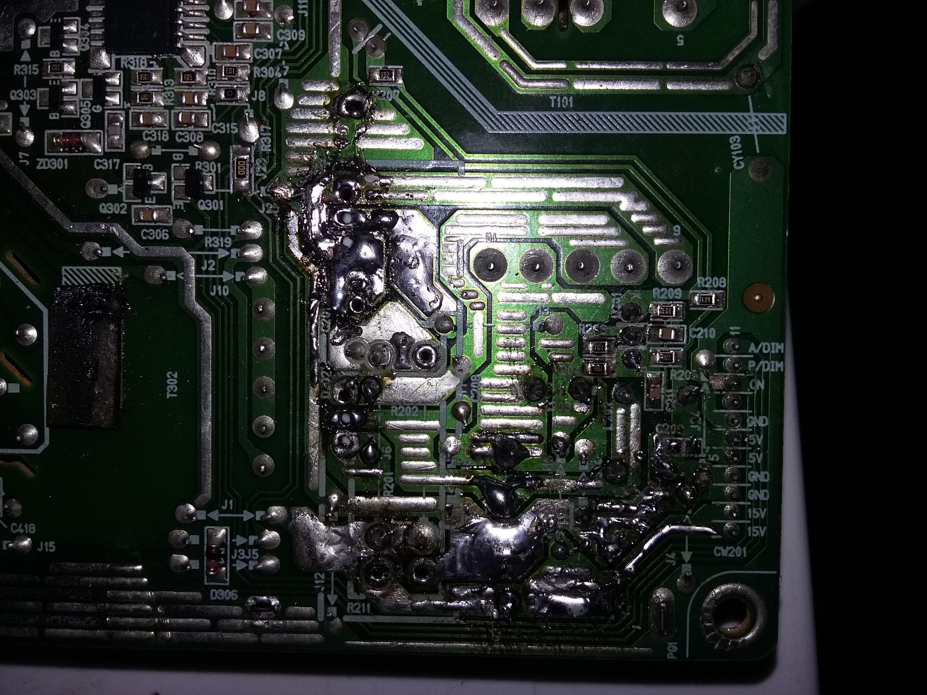

        I removed the Schottky diodes, and I found pins place on board are all shortened!!. While Following on board connections, only two of them should!.
        I also removed a 980ohm resistance on the output, and found pins place on the board also shortened!.
        All the components on this side seems good (not shortened).
        Is this normal?

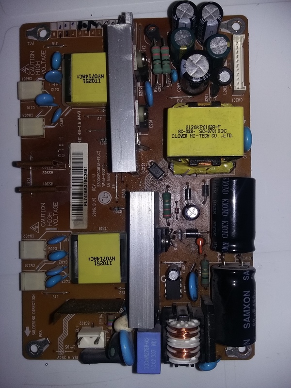

              So the two 8-PIN SMD power MOSFETs in the inverter sections are OK?
              The two TO-220 rectifier diodes tested good off the board?
              "I removed the Schottky diodes, and I found pins place on board are all shortened!!. While Following on board connections, only two of them should!." Can you please mark the location where it shows shorted?
              BTW, the picture are too dark for me to see the connections and traces clearly.

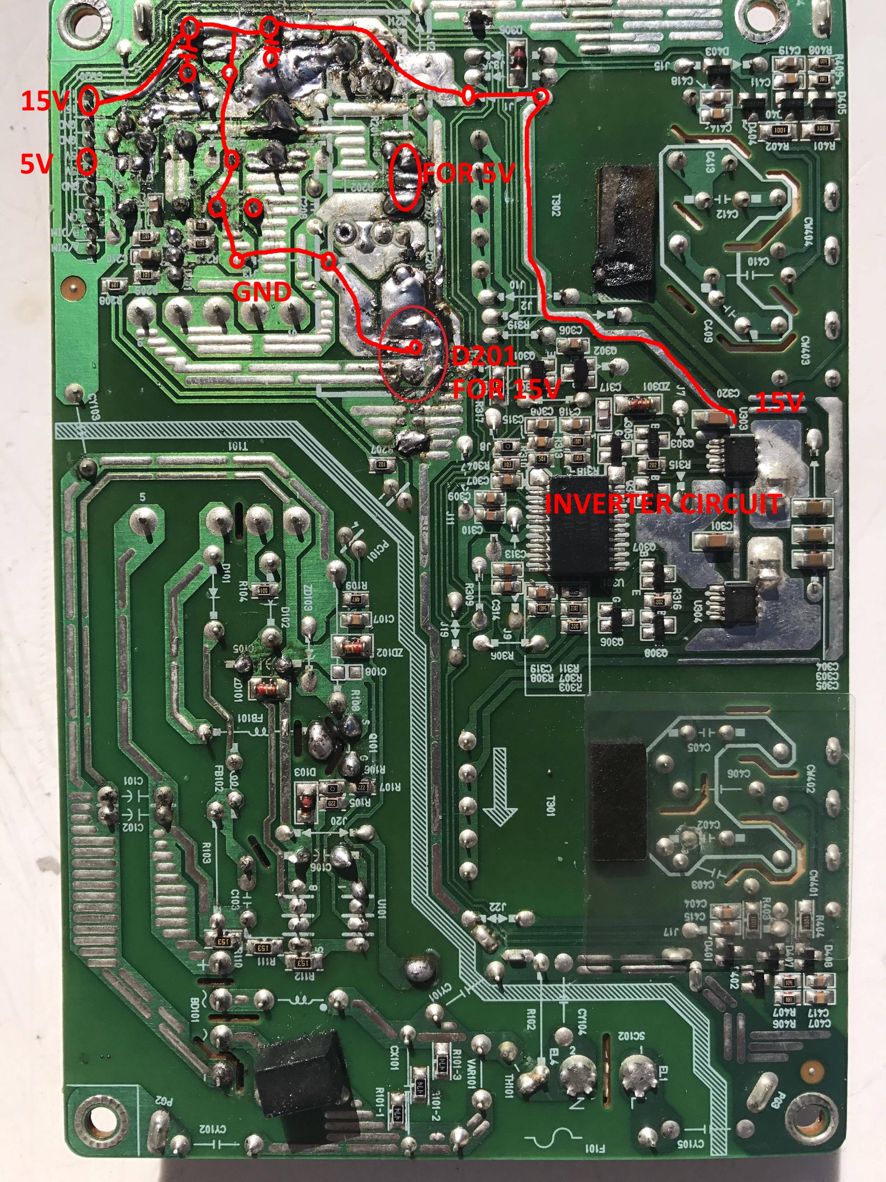

                Dear budm
                Thanks for answering, and sorry for the late reply. I just started to loose hope with the forum.
                I have taken a better pics for the board, I also marked the shortened place. Please note that the Schottky diode itself is tested fine off board!!.
                Someone proposed that it is obviously the transformer, but I am not convinced as I heard these are very hard to break down. Is there a way to test it using the DMM?.
                I can reach and test the board with load and power connected.
                  Re: Dead LG flatron M1717S monitor

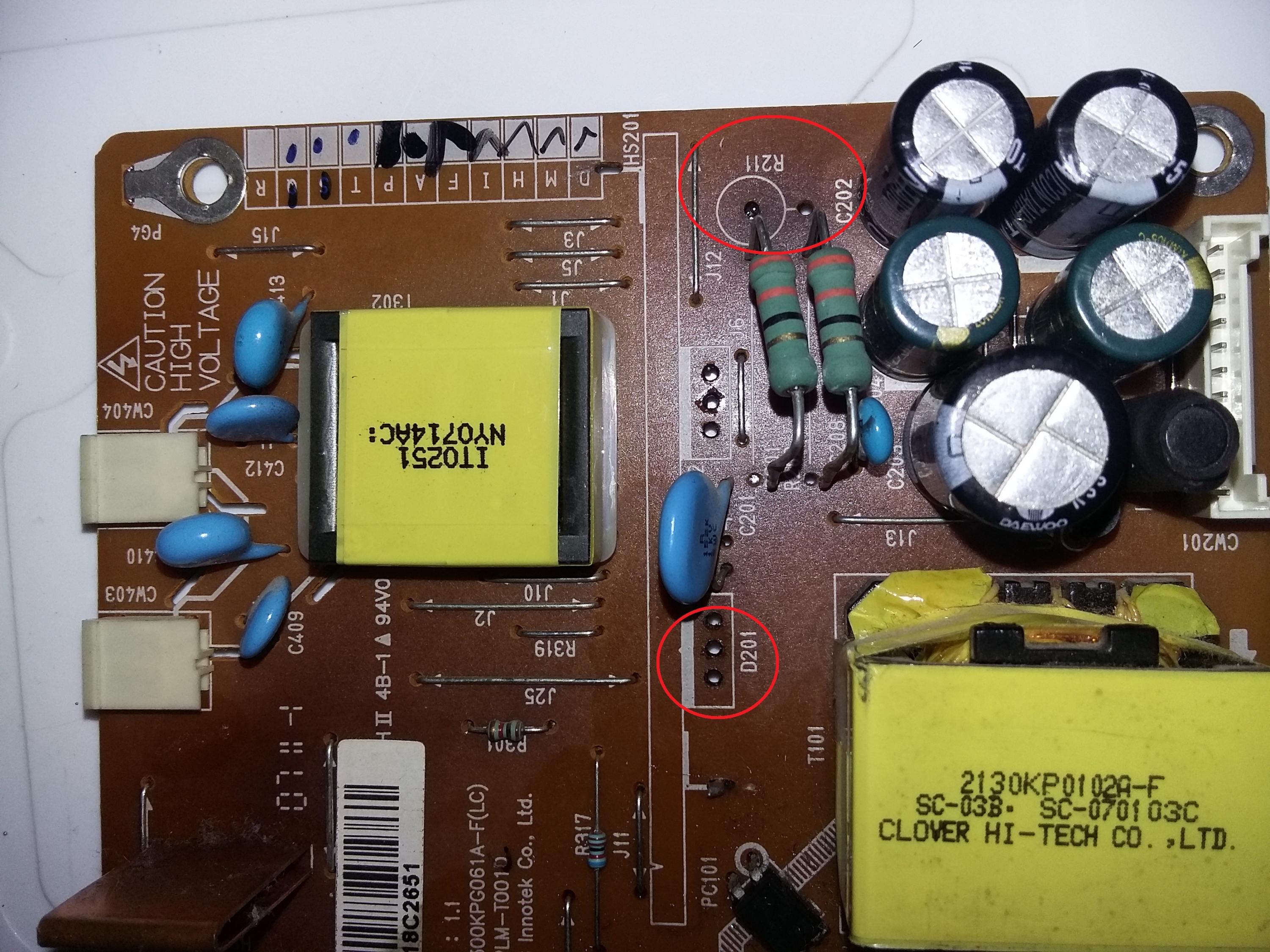

                  So when you check the resistance between the GND and the center pin of that marked diode it shows very low resistance and the diode tested OK off the board, right? Then the loads may be shorted it that is why i asked you to tested those two MOSFETS.
                  BTW, the soldering works look bad.
                    BTW, that diode (D201) in question is for the power supply for the Inverter circuit.
                      Dear Budm
                      Regarding to your first question, all the marked pins are shortened together and at the same time shortened to the ground (on the output connection).
                      This short is not resulted from the output as I test the board with the output not connected.
                      The soldering is bad yes, but I am sure it is not the problem, and these two Schottky diodes are tested fine off board.
                      And the D201 I don't believe it is related to the inverter circuit!.

                        "This short is not resulted from the output as I test the board with the output not connected." Well the output of that power supply section is CONNECTED to the inverter circuit, so you can disconnect the connector but if there is shorted circuit in the inverter section then it will short will still be present.
                        "And the D201 I don't believe it is related to the inverter circuit!."
                        How did you figure that?
                        I suggest you to at least trace out the connections to see it for yourself where the output of that D201 is connected to.
                        You can also lift up one end of the JUMPER for the 15V that feeds the inverter circuit to see of the short will go away.
                        That soldering works need to be cleaned up to make sure there is no solder bridge.
                        I try to help but if you insist then that D201 is not related to the inverter circuit and not going to test the MOSFETs then I cannot help you, good luck.
