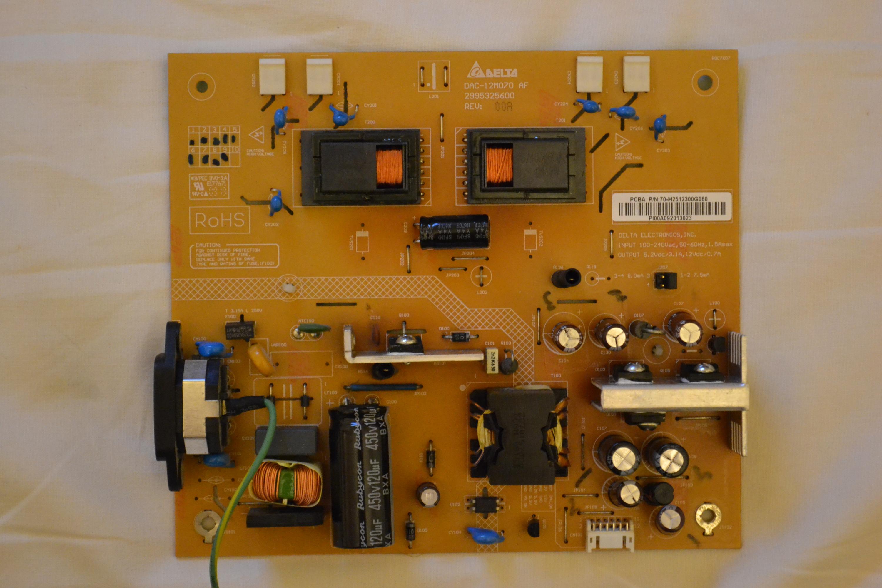

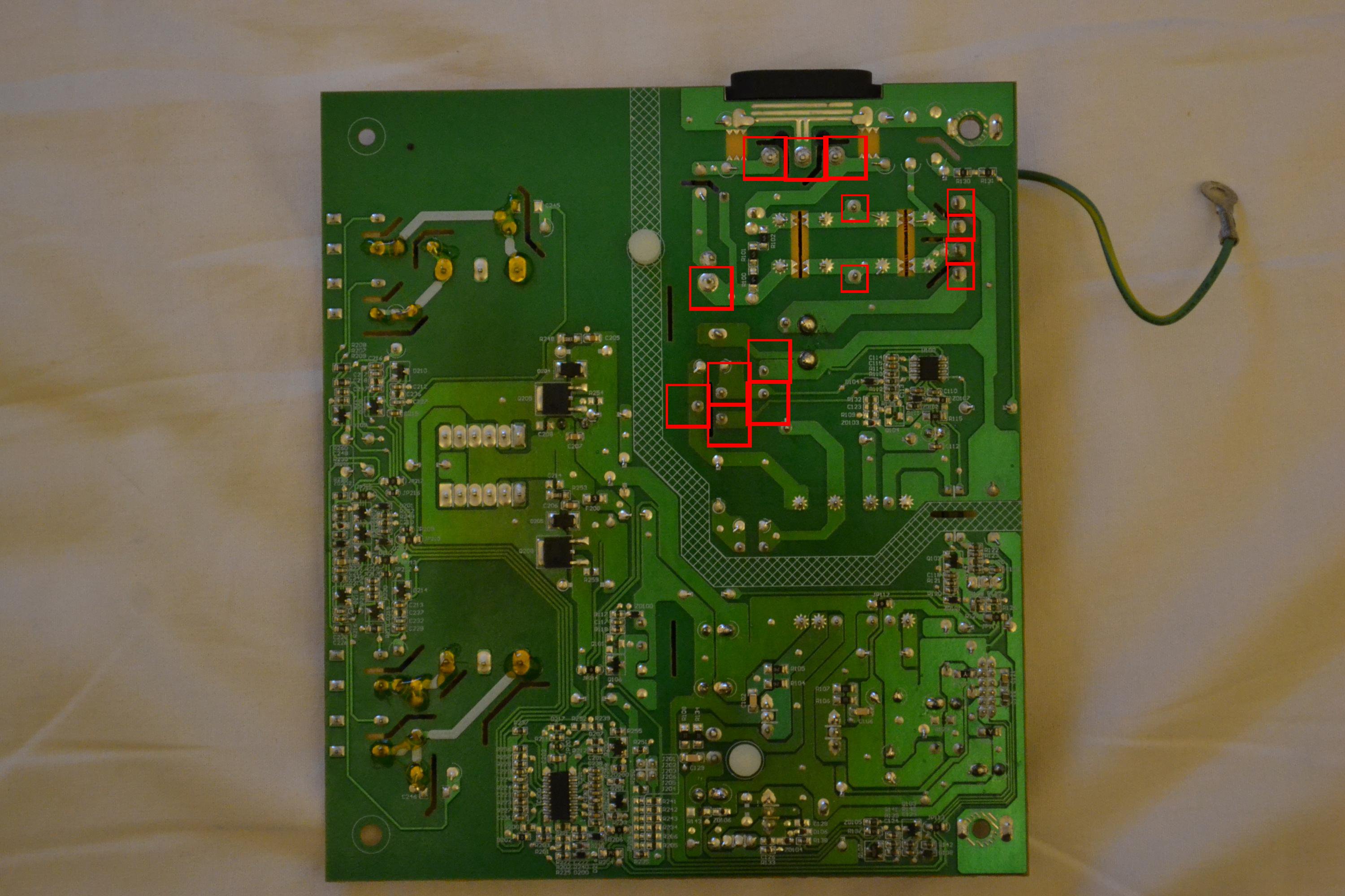

    Hello there,
    A coupla days ago I got the 2 seconds to black issue, and after troubleshooting for a while, I found out that the issue is a bad CCFL. When removed and powered up, the tube glows a bright red before cutting out.
    Correct me if I'm wrong but I could not find any financially viable CCFL replacements, and have decided that the little CCFL to LED upgrade kits are the way to go. However, upon looking at the board, I see that the inverter is actually integrated into the power board (see pictures). Is there any way to perform the backlight change process without the handy 6 pin header that the LED drivers plug into? I would be happy soldering into the board if I needed to solder into specific places.
    Please help, I would rather not fork out for a new monitor.
    Thanks in advance,
    Sam
    • 30977

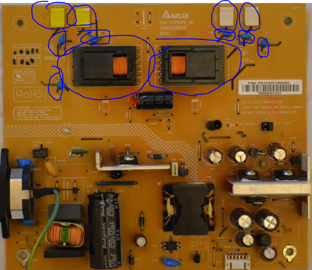

    Re: CCFL to LED conversion where inverter is integrated into the power board
    you remove the cfl connectors, blue caps and 2 transformers,
    use that area to mount the led driver.
    on the underside you will find the gnd, 12-18v and the lamp & dim signals.
    they are often labeled for servicing.
    i think i see the lamp-on signal on the white connector - lower right.
    you can get the supply power from the cap below the invertor transformers.
    one thing i see, you need to resolder the mains inlet connector and stuff mounted on heatsinks.

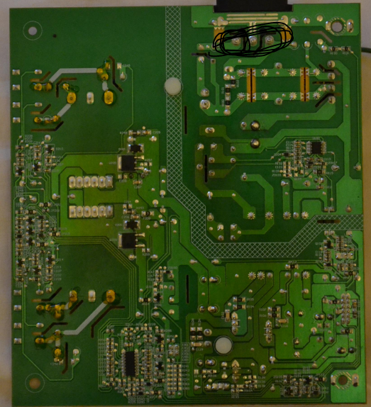

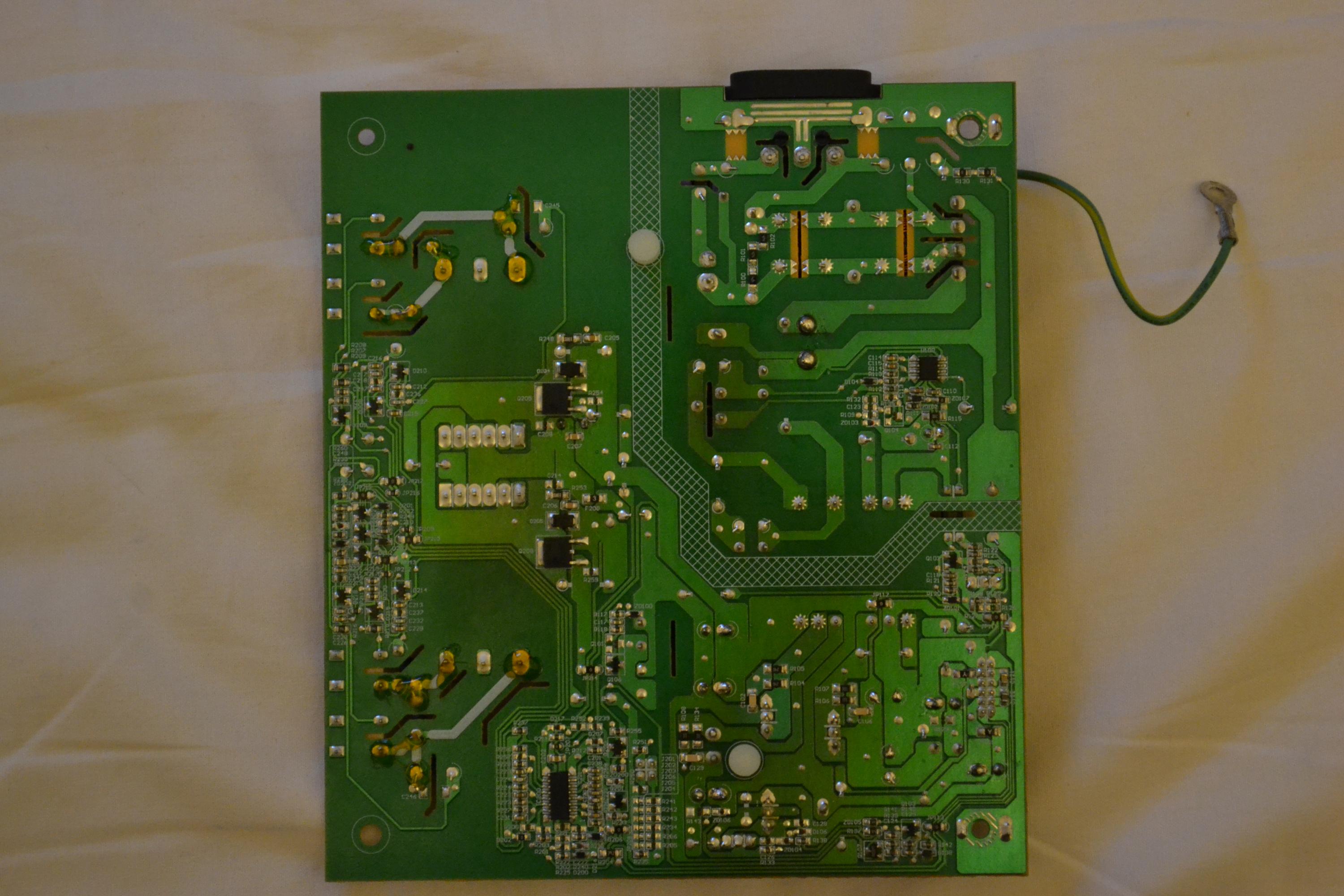

        Sorry if I'm being slow but I would just like to check.
        So unsolder all the components I've circled in blue,
        Solder the power to the positive side of the capacitor (circled red)
        Solder the ground to any contact marked ground?
        I cant see any lamp or dim labels on the board at all. Are these 100% necessary and if so is there any way I can find the contacts?
        And I should resolder the three connectors to the mains inlet (circled black). What do you mean the stuff mounted to the heatsinks?
        Sorry for all the questions and thanks for your quick reply!
          • 30977
          your diagram is correct.
          and you dont need the diming signal.
          i marked the other stuff.
          on the lower foto, those joints dont look good - but the picture is not great either.
          on the upper foto, can you take another of just that area where i can read the writing?

                                • Snood McGuinness
                                  • Oct 2016
                                  • 6

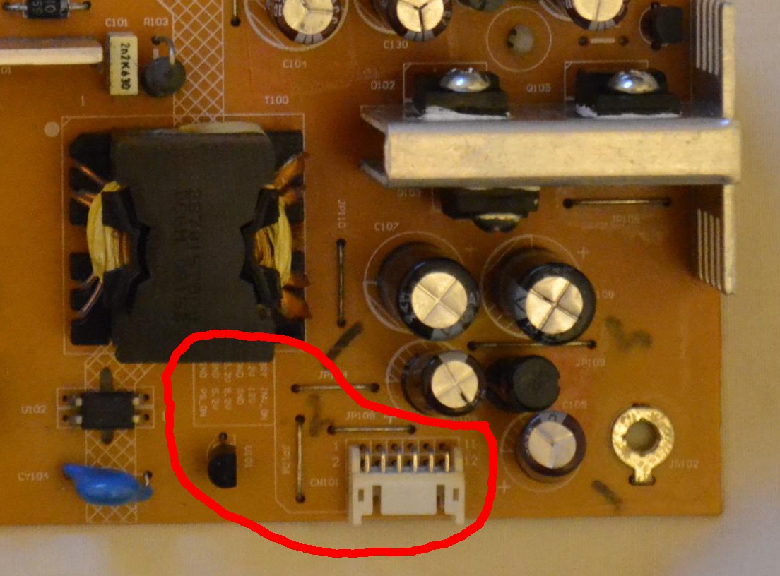

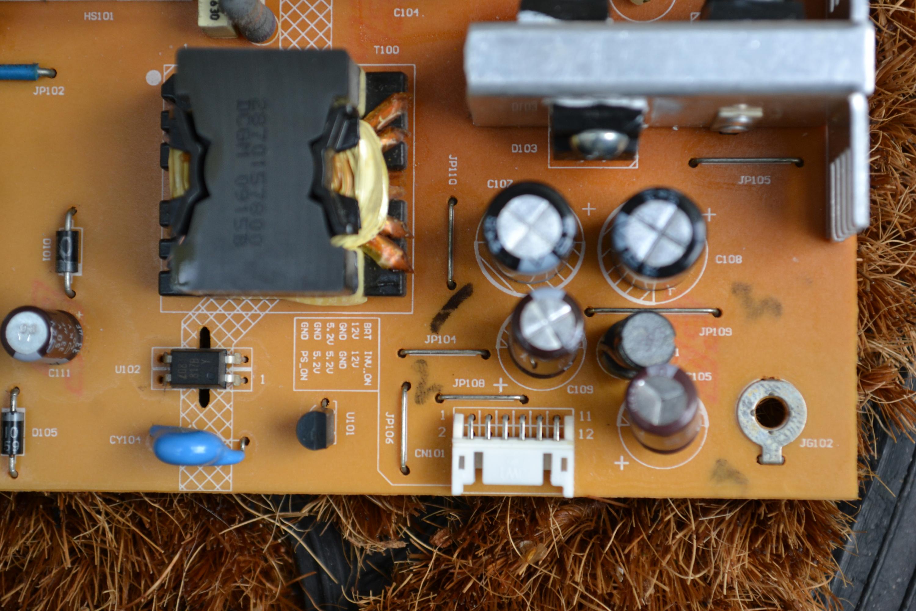

                                  Yeah, sure, I've attached it. Do you think it would be the inv_on for the lamp signal?
                                    • 30977
                                    inv_on is definatly the lamp control
                                    12v is probably linked to the big cap,
                                    brt may be the dimming signal.
                                    but that often wont work because there are several ways to ajust brightness.
