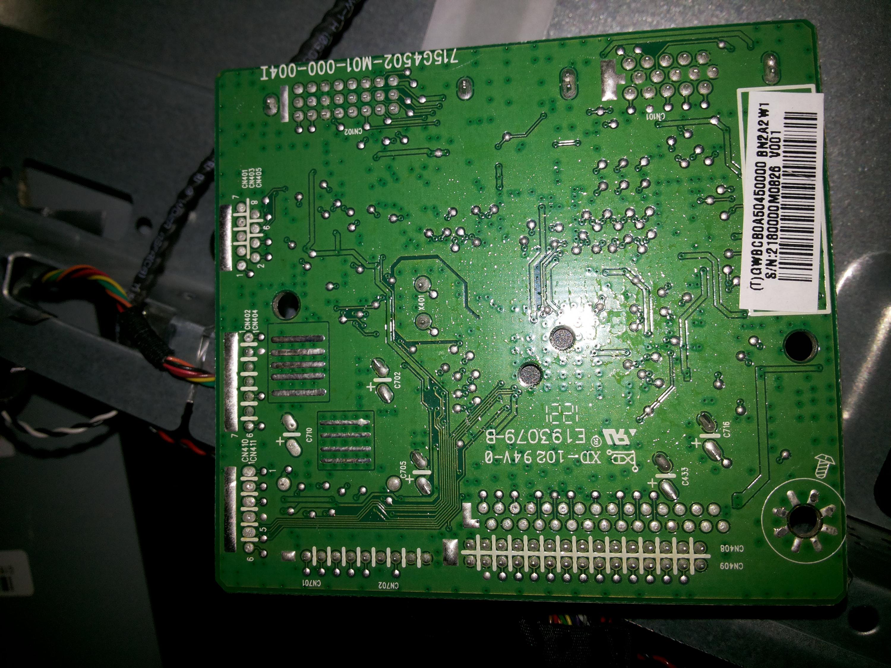

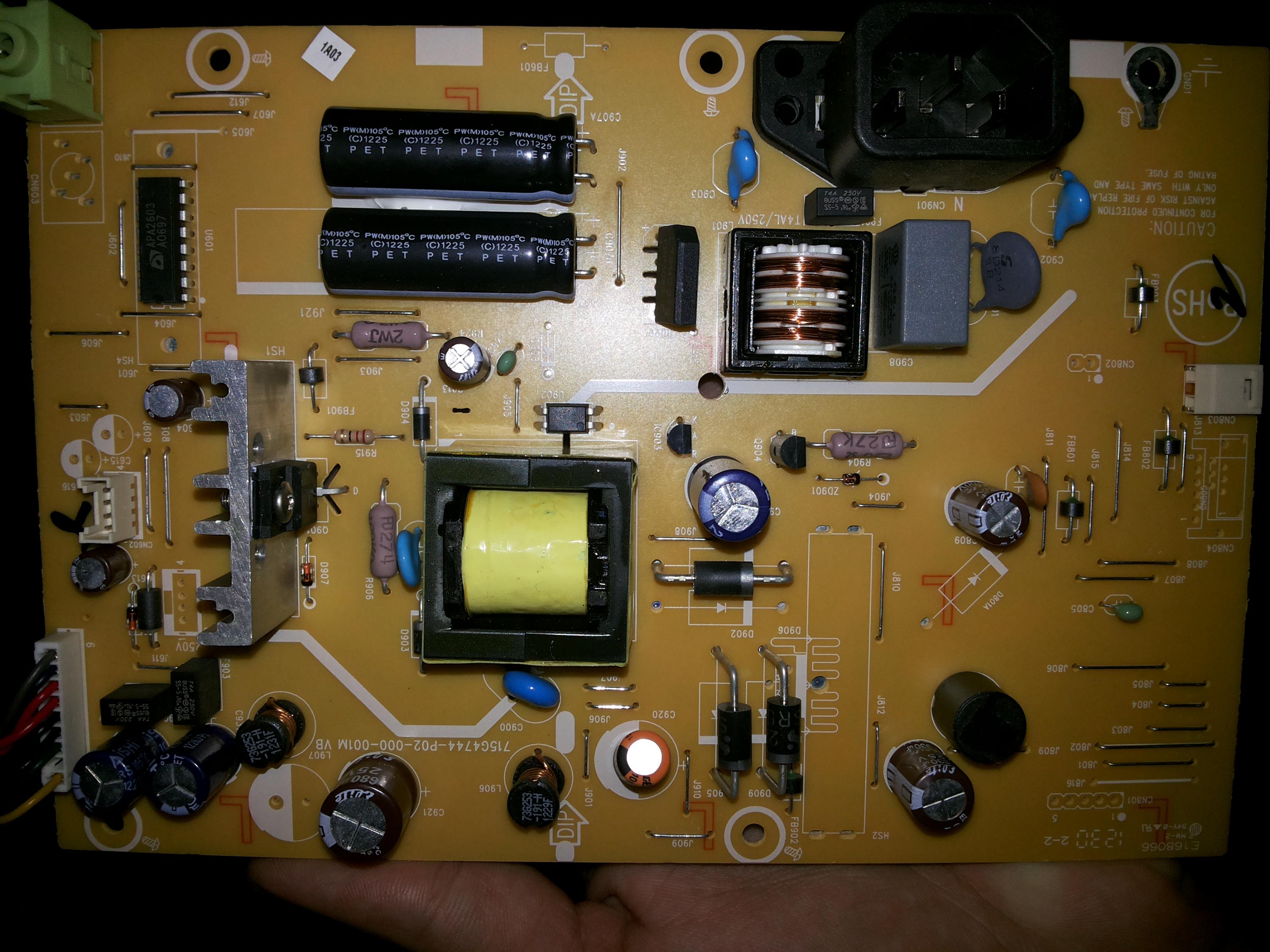

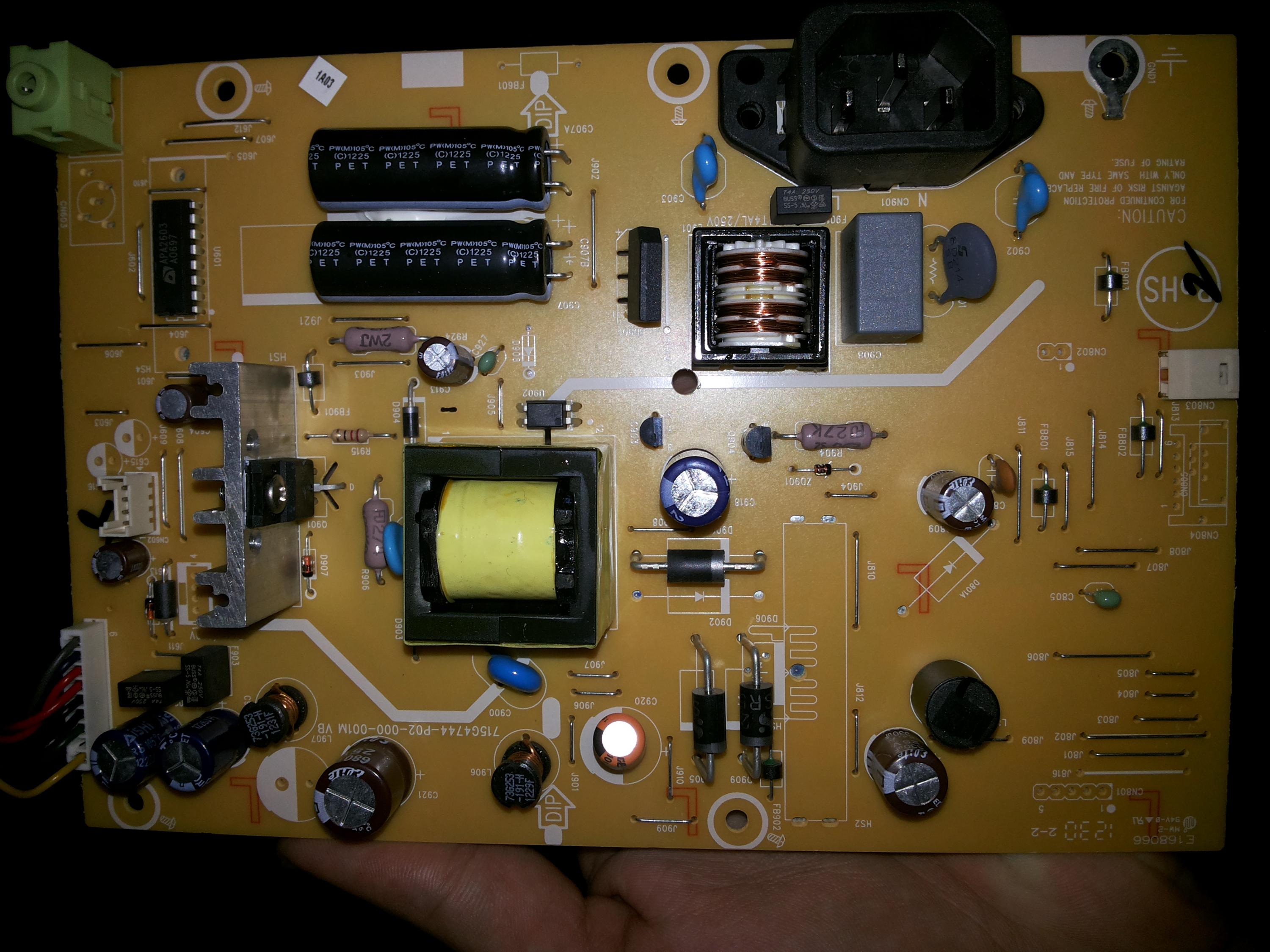

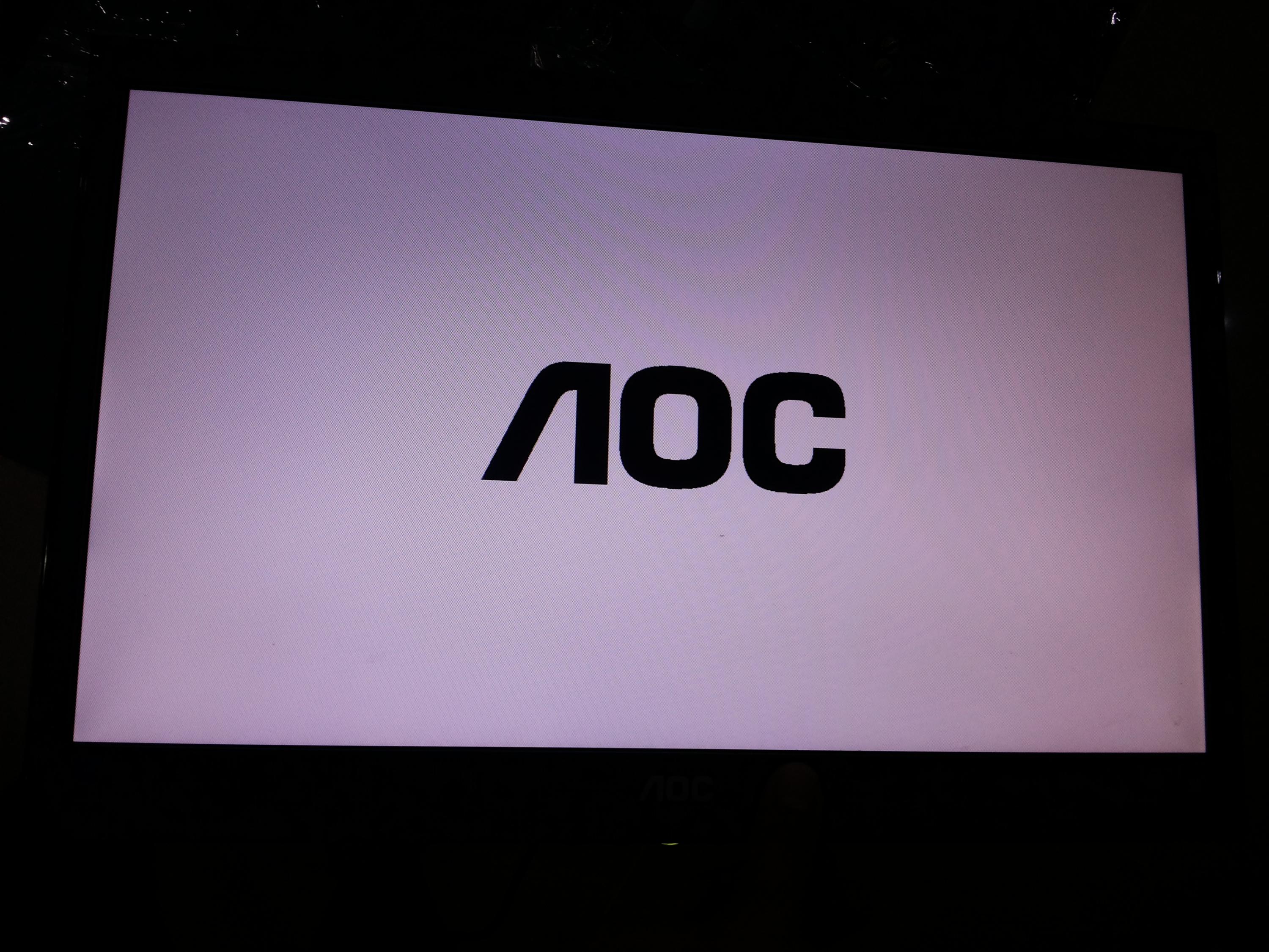

    I have an AOC e905Swdak which has a strange display color all of a sudden. It starts showing whitish, greenish and also pinkish display and other strange colors.
    I tried to look for bulged caps but there aren't any. I connected another CCFL bulb and it turned on fine.
    Kindly find attached photos of the boards.
    Any help is appreciated.
    Regards,
    Matt

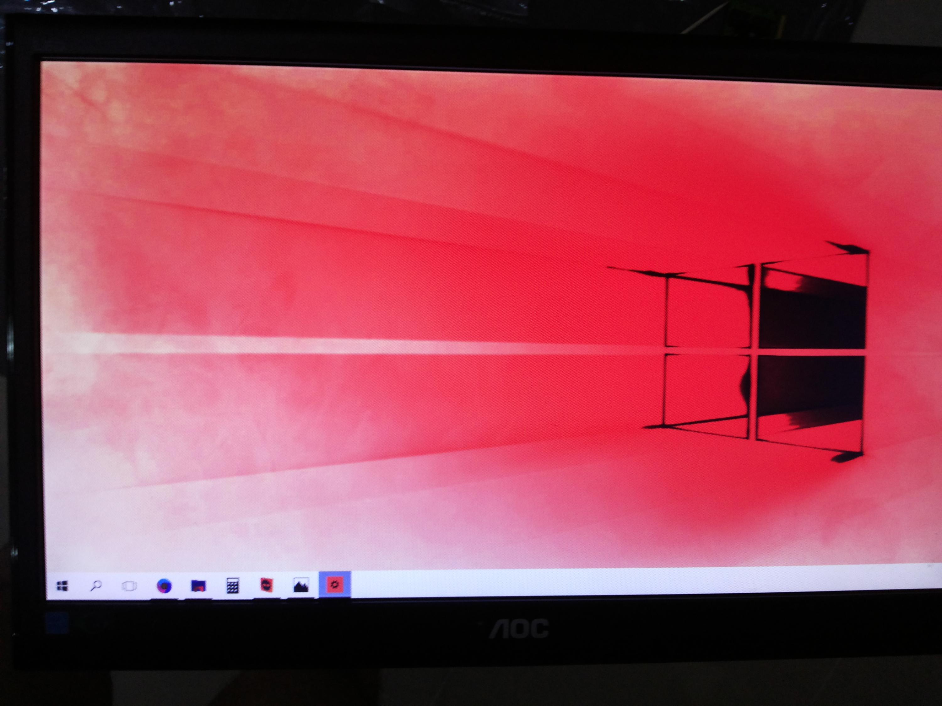

    I assumed you are check the Video cable between the PC and the this monitor? Already try this monitor with another PC?
    Any screen shot of the images as shown on the screen.

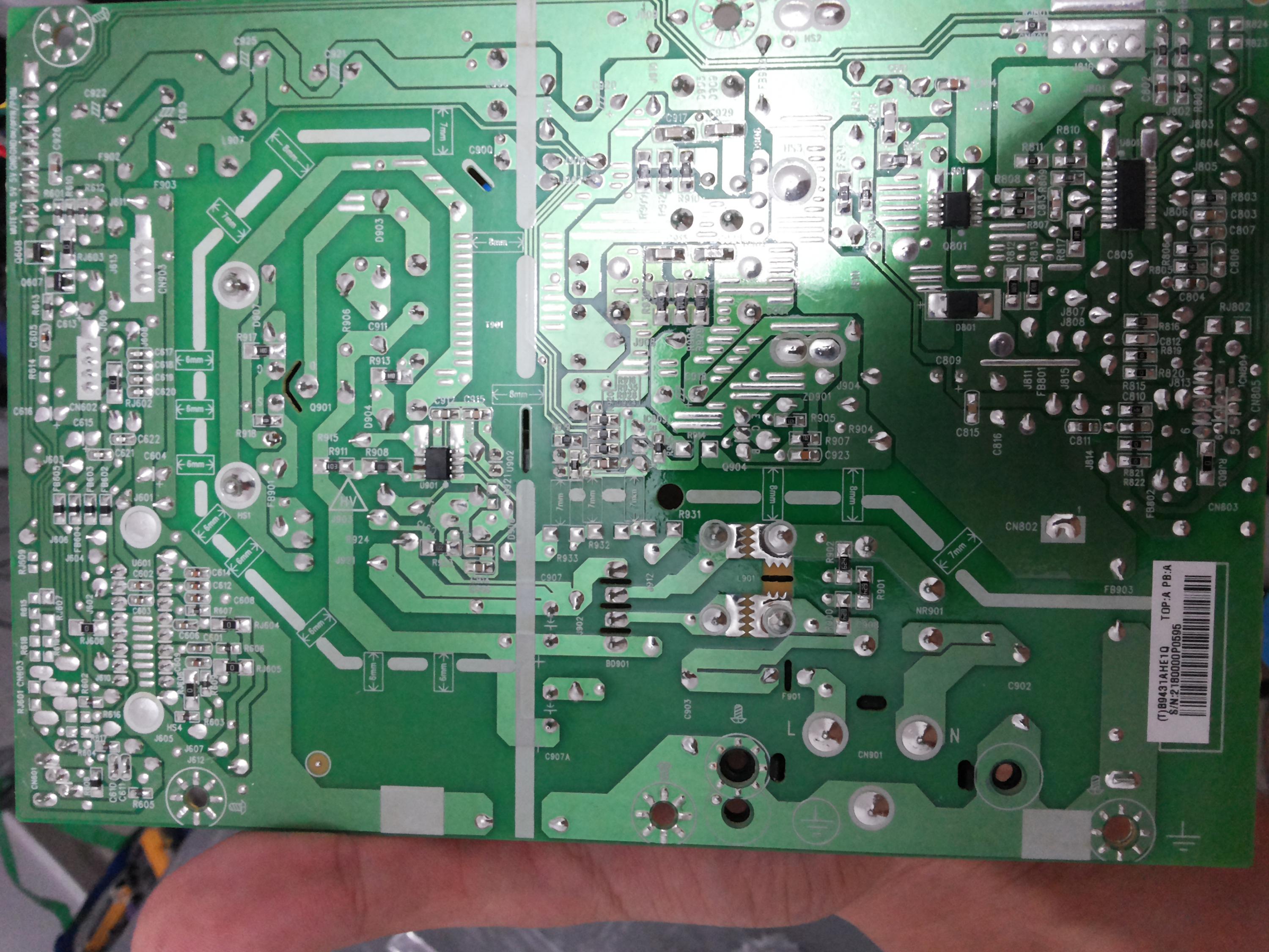

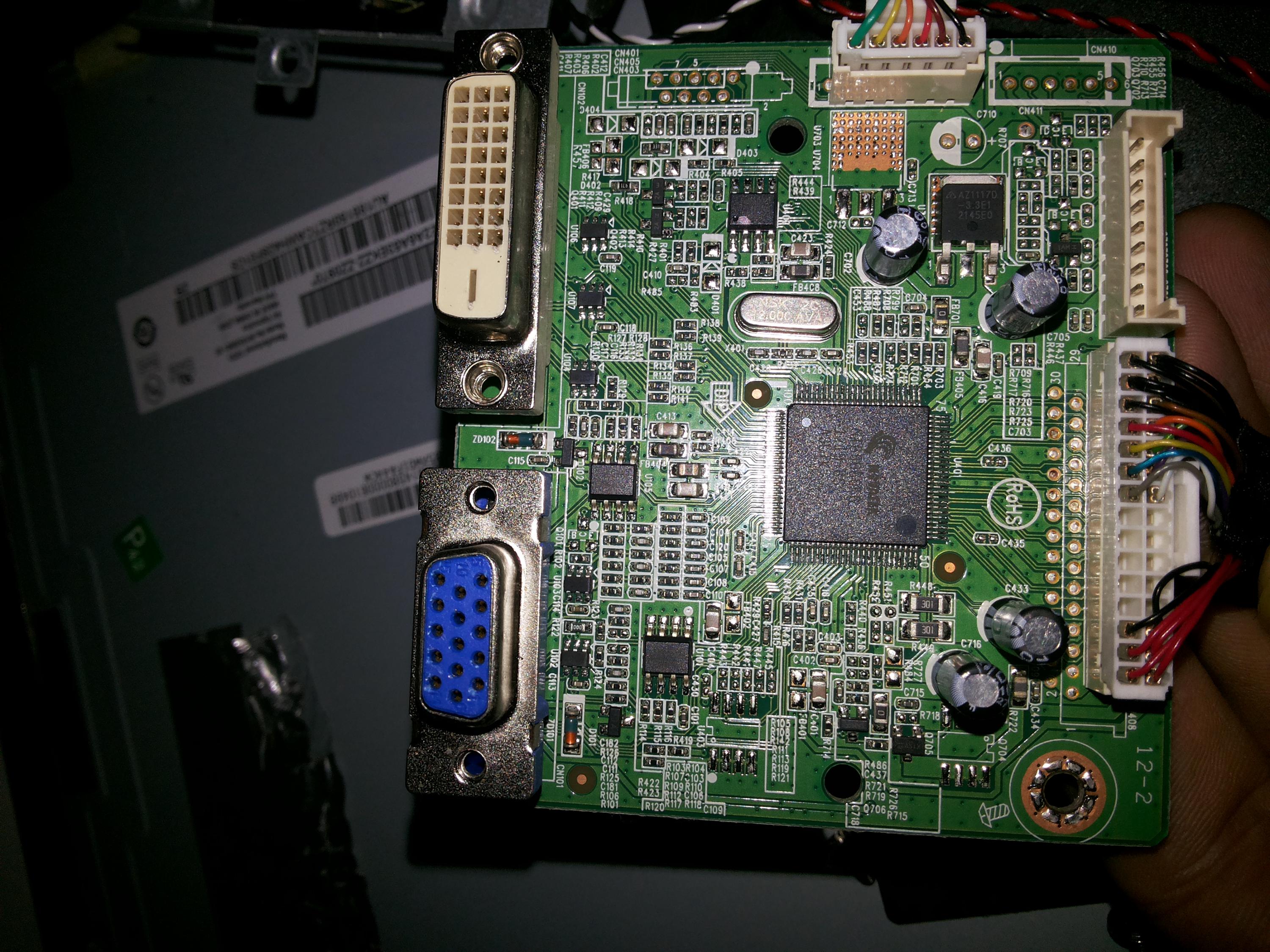

      i changed several vga cables and also tried it with a PC and 2 laptops but the same result.
      please see attachments

        Likely a faulty AS15 chip.

          From a quick look I dont think this has a separate Tcon.
          Chip may be on the panel board attached the panel.
