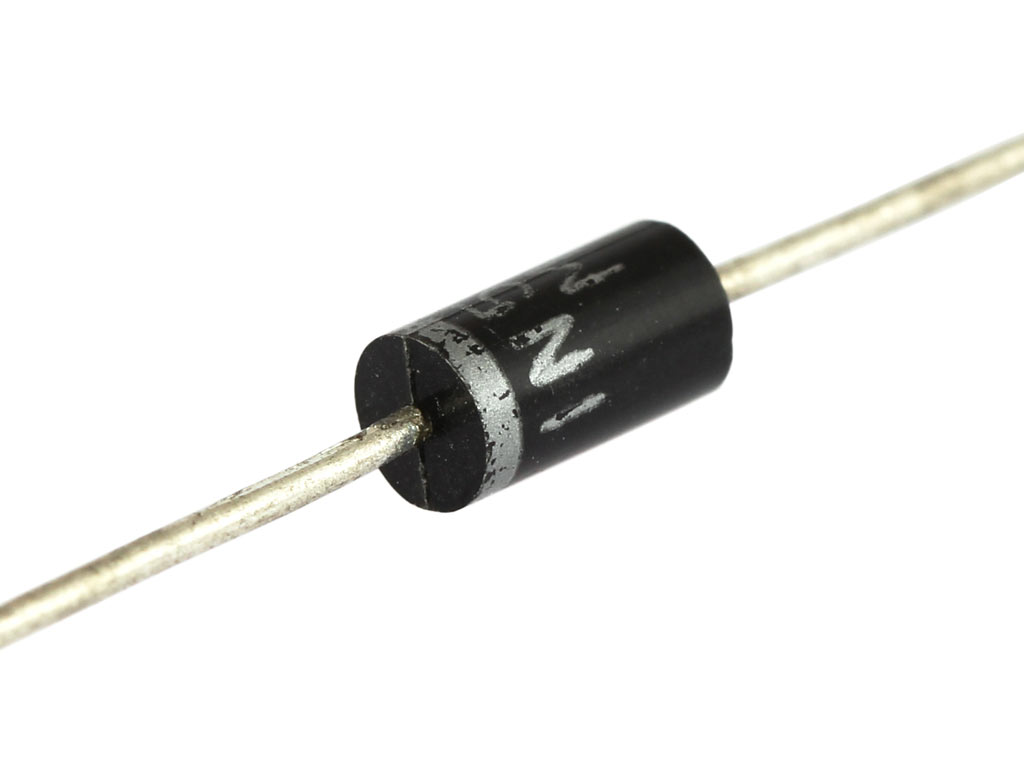

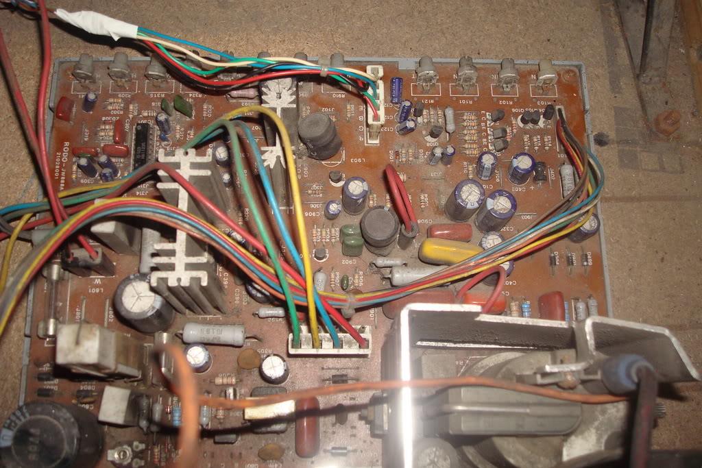

    Not sure where to post this but I need some help fining info or the actual part number for a diode I found to be bad. I'm working on an arcade monitor chassis and the board is a JW-RODO-888A and I found a bad diode in this cluster of 4 but I would like to replace all 4 and the only numbers on it are 20D then under that is a "4" then under that is "3B" I can't find anything and even went on live help at digikey. Any help is appreciated!

        Originally posted by SteveNielsen
        You got a pic?
        It's just your standard looking one like this"stock" picture.

                • 30952
                Re: Diode help needed
                pentranic - thought so.
                like this?
                does this schematic match up with the parts?
                  circle them on the pic.
                  4 in a group near the ac input are just common diodes.i would use 1n5408 as i stock those.
                  thats a 3a 1kv gp.
                  replace all 4.
