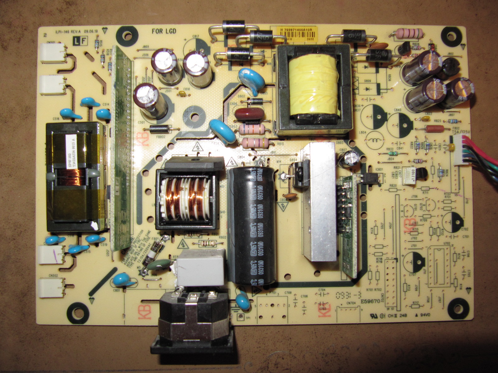

    We need good clear pictures of the boards (top and bottom sides of the board)

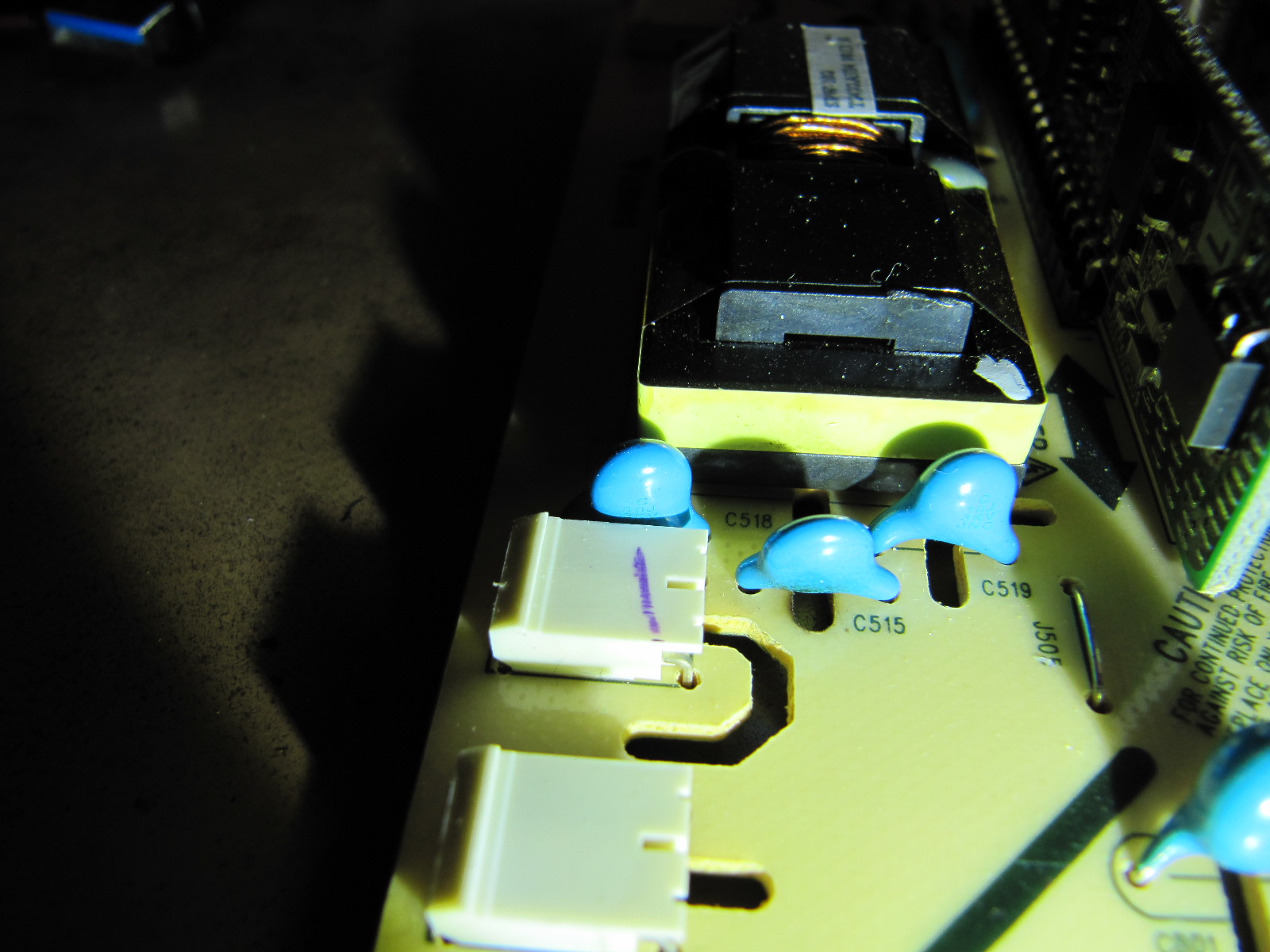

      I'll make a closeup picture of the smoking capacitor C515 ("N3 3KV SEC") although there isn't much to see. I will add the top and bottom side of the power supply board. I don't believe that the tiny data processing board has anything to do with the problem.

        Here are my pictures. I'll keep you informed of the progression...

          N3 3KV is a 3pf 3kv ceramic capacitor. Try measuring the resistance across it to see if it's shorted.

                If the capacitor has smoked then it is damaged. It may have shorted, then burnt, and is now open circuit.
                You still need to replace it. Good components don't emit smoke.

                  Did you actually see C515 smoke? If yes, then replace it as suggested by Agent24. You'll have a very tough time finding a 3pf 3kv cap. Also, check the two large mosfets mounted on the vertical board (next to the inverter transformer) for shorts.

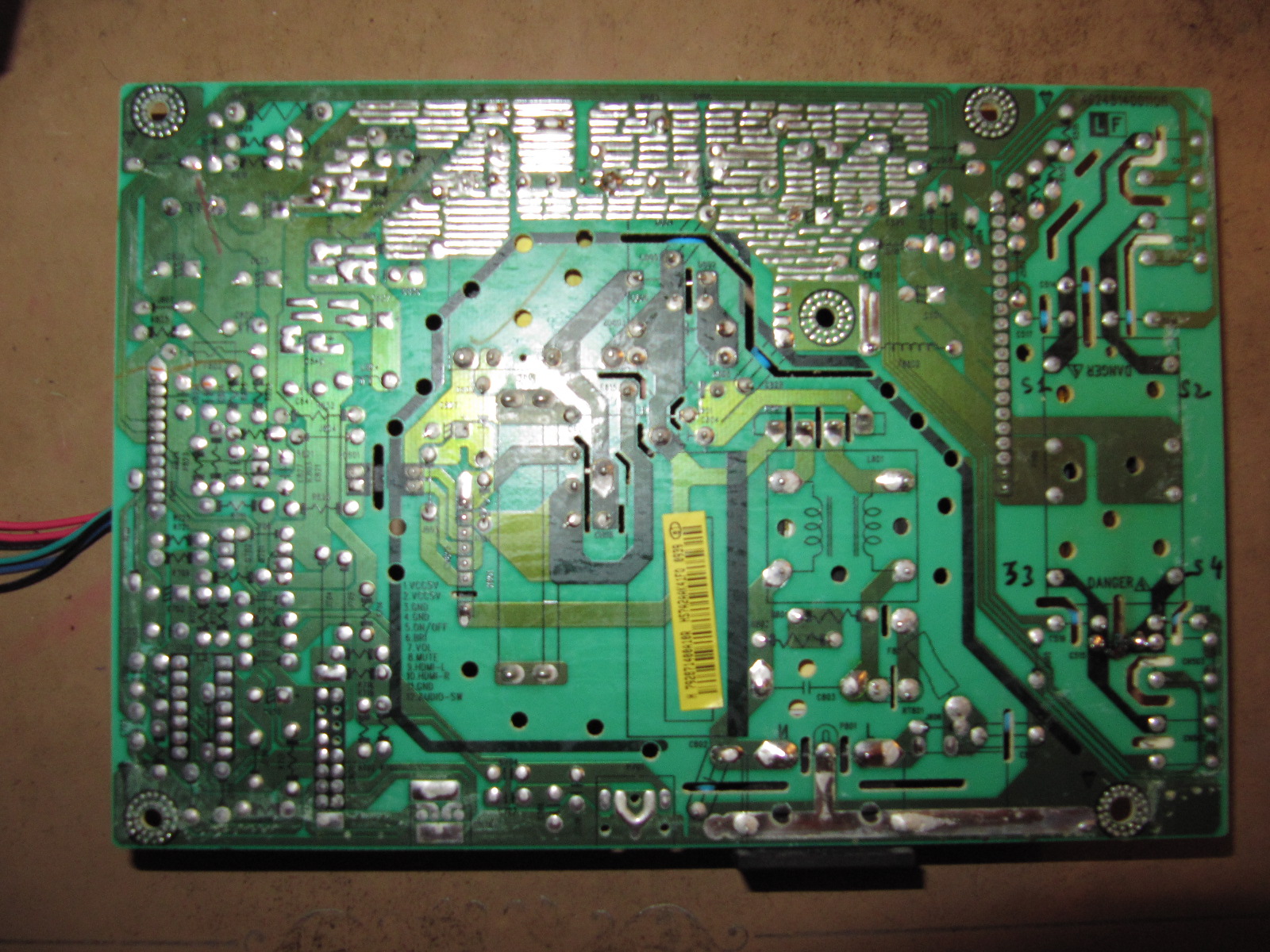

                      Look closely at the underside of the board in the area of the cap (lower left part of the full size pic, near the word "Danger") you can see a burned spot on or near the traces. :
                      There's either some junk on the board that is causing a short, or something leading off that trace which is shorted.

                        @ mxslick: it looks as if you had taken a picture of my board :-) . Actually C515 smoked "gently" not much, but you are right, Agent24, good components don't smoke'. Thus I need to find a replacement. May be I can get one from another "donor" monitor or I'll by one at Conrads as soon as I am back home in Munich. There is very little chance to get one in the place I an now.
                        I guess the MOSFETs on the additional board are U501 and u502. Do you think a shorted C515 killed the MOSFETs?

                          That is your board
                          I did not notice the burnt area that mxslick did, as the attachments were downloading very slowly the other day, and I must have given up.
                          He is right, C515 may be fine, you may just have had burnt glue or some other stuff on the PCB. Scrape the burnt area and clean off any carbon as it's conductive and may be causing the problems.

                            Uhhh Well C515 is to be changed anyway because of his smoking capacity....I will clean indeed the area from possibly conductive (carbon) traces. I have also removed the white glue on the components side as it is known for becoming conductive when aging.

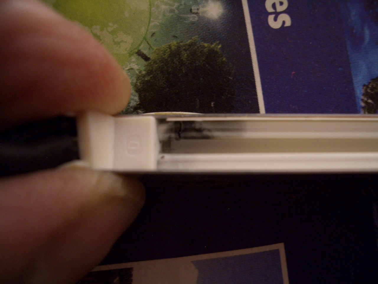

                                  And this is the end of the story: one of the CCFL is dead , one end is black and broken, see attached picture, therefore the 2 seconds to blank. If I find a replacement I'll give it a try. But the CCFLs break just by looking at them....
