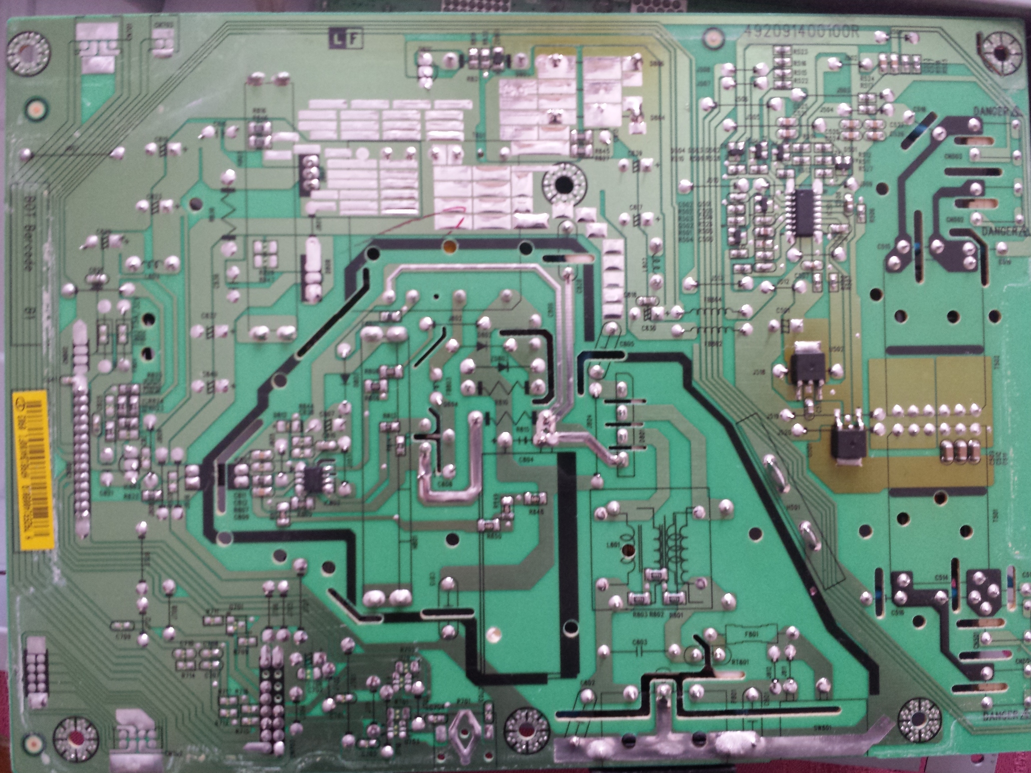

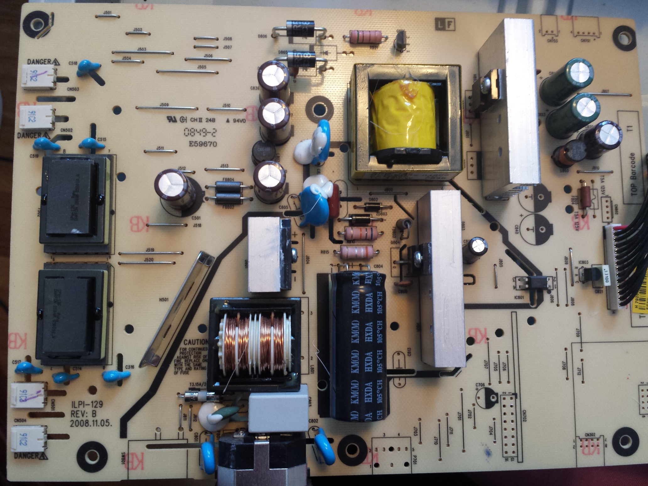

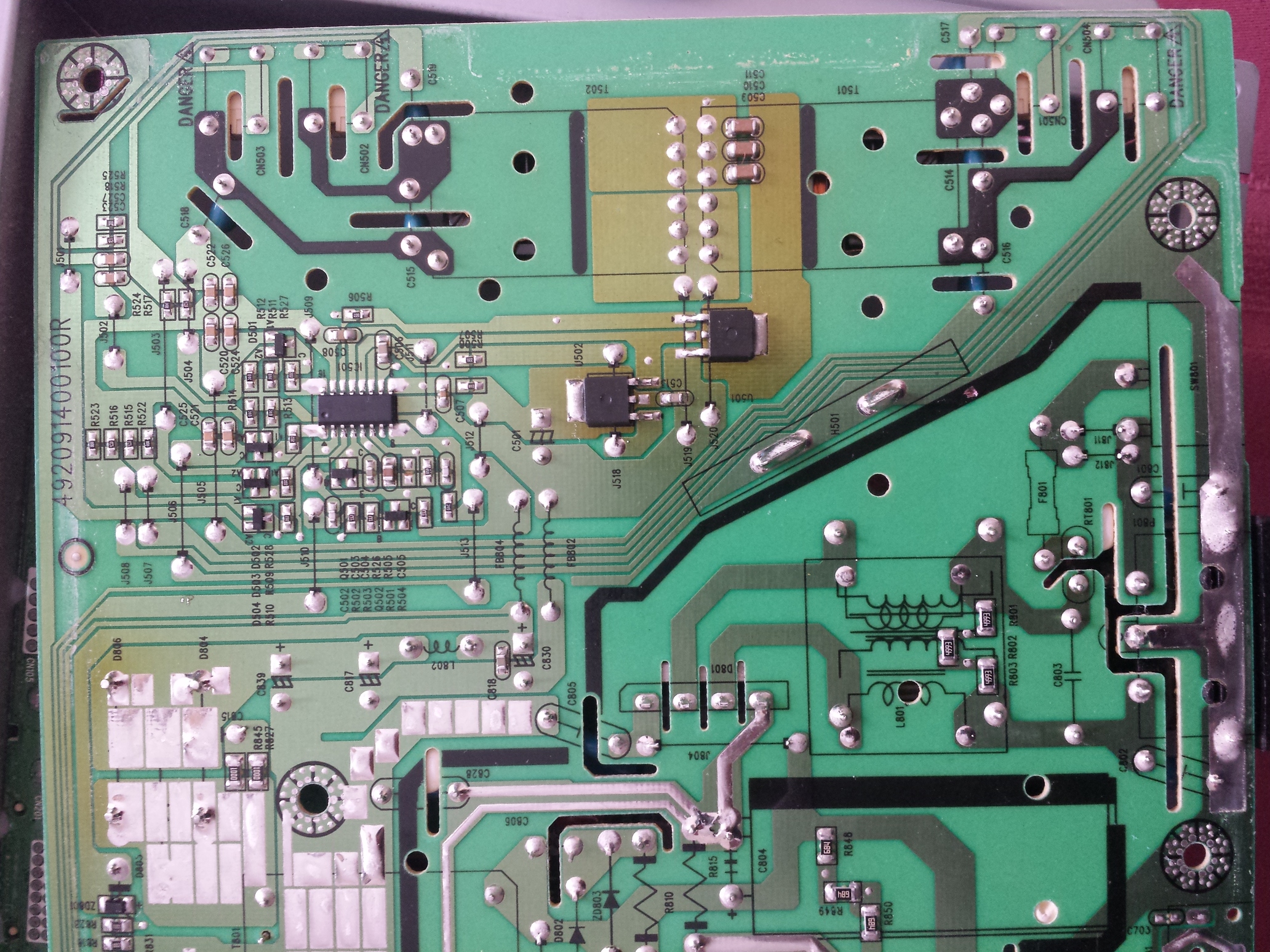

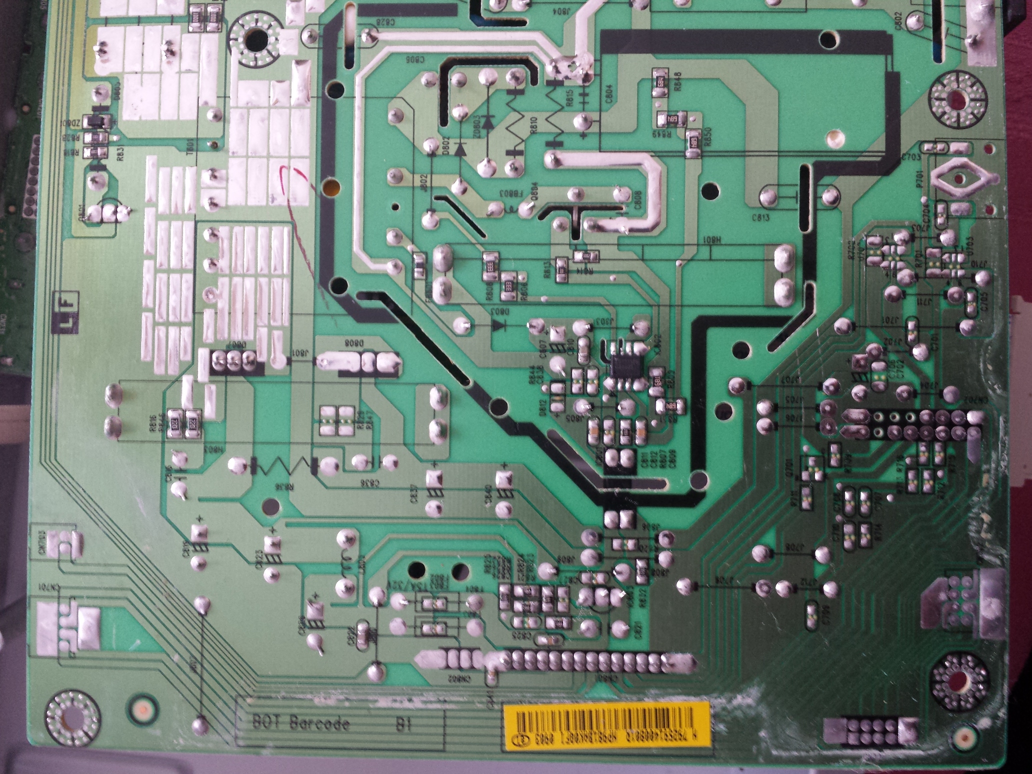

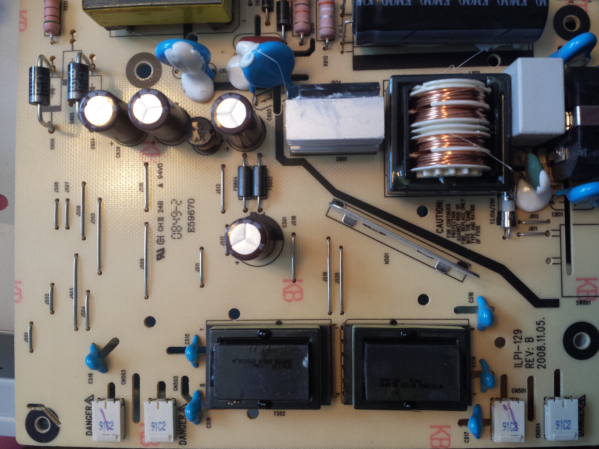

    Yesterday one of my monitors just completely turned off when I was using it. No power, no lights or anything. I tried unplugging it and plugging it back in at first to see if something was wrong with the power cable but still nothing. I then changed cables and changed outlets and nothing as well. I then decided to take it apart and check the boards inside to see if I could see anything wrong. After my own investigation, I couldn't see anything wrong or blown so I decided to come here for help.
    I took some pictures of the board so hopefully someone here can see or help with whats wrong. Thanks!

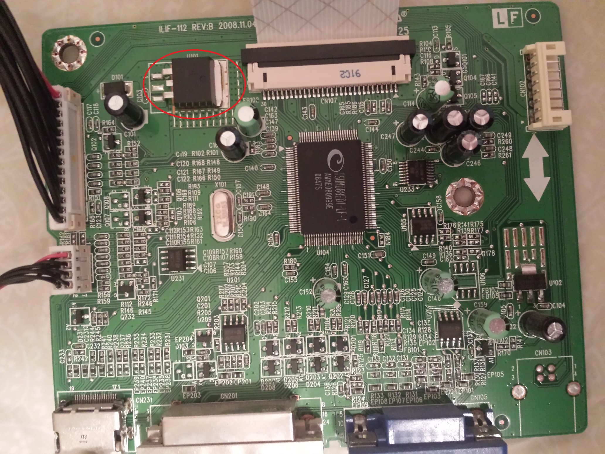

        One of the first things in the manual (Can be found here page 30) says to measure U703 pin 2. When I measure, I get a solid 0V. Does this mean that this is the problem? I've attached a picture of where I have tested.

                Re: Acer X233H LCD no power
                What DCV do have measured at the two legs of that main filter cap?
                • ooober60
                  • Feb 2015
                  • 22
                  Sorry I am not an expert on any of this type of stuff so I am guessing when you say main filter cap you meant the big capacitor right in the middle of the first picture labeled c804?
                  With it plugged in I got a reading of 169V DC.
                    "With it plugged in I got a reading of 169V DC" That is good.
                    OK, check the MOSFETs in the inverter circuit U501, U502 Source and Drain pin to see if the show low RESISTANCE readings.
                    BTW, I can only see two fuses on the power supply board, the white fuse for the AC main, and red fuse by the white connector for the main board power.
                    Also check the power supply board without connection to the main board to see if you do get any DCV on the secondary side filter caps.

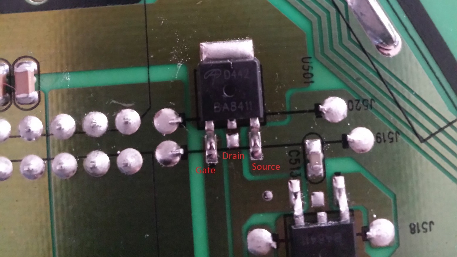

                      Testing u501 and U502, I connected the ground to the left pin which I believe to be ground. On pin 2(Vout) I got 2.6Mohms and on pin 3(Vin) I got for 34.2kohms both u501 and u502
                        They are power MOSFET with GATE, Drain, and Source pin. There is no Vin, Vout, Gnd pins on MOSFET.
                        So check the resistance between Source and Darin pin.
                        Looking at it with big tab up:
                        Left = Gate
                        Middle (same as the tab) = Drain
                        Right = Source
                          Sorry. Like I said, this is all new to me. If I did this correctly, I got 2.473 Mohm on u502 and 2.410Mohm on u501 between source and drain pins resistance.
                          The picture is what I did

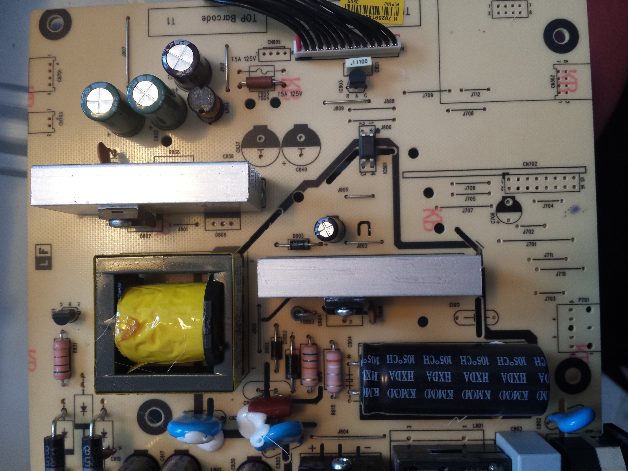

                                Suggest you test Q804 mosfet mounted on heatsink next to large cap C804. Check it for shorts.
                                      OK, check the resistor R815 (Source resistor for Q804) to see if it does show <1 Ohms.
                                      Check clamping Zener diode ZD803.
                                      Check startup cap C807 capacitance and the ESR.
                                      Check the DC Voltage betwen to two leg of that startup cap C807.
                                      Also get the P.N of the SMPS IC802.
                                        Q804 Mosfet seems to be okay testing it with a multimeter
                                        Resistor R815 shows right around .9 ohms
                                        When testing the zener diode ZD803, I am getting 0L resistance in one direction and 2.683Mohms in the other direction. According to this website, http://www.learningaboutelectronics....-a-zener-diode, there is a high resistance in both directions and that is is bad. Could this be the problem?
                                        Edit: after doing some further research, http://www.elexp.com/electrical_measurements_part3.aspx, this says to use the diode function on the multimeter. This way, I am getting exactly what it says I should be getting. An open circuit one way, and a reading around 600 in the other direction. So now I am confused. Which way is correct?
