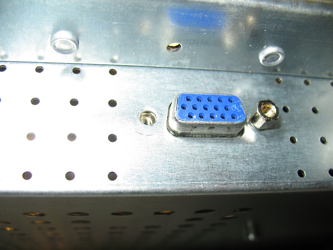

    An old non working HP L1906 monitor was given to me two or three months ago, as crap to be dumped. I have searched the forum and I have found there are at least three versions of this same electronics and no reference to the steps to open the box.
    So now I am writting this post to help others. Firstable I want to copy here the opening steps, as written in an hp forum by an angry user. In no way I am subscribing necessarily his(or her) expressions about hp, the monitor, etc , but I won't change a word because it is his/her work :

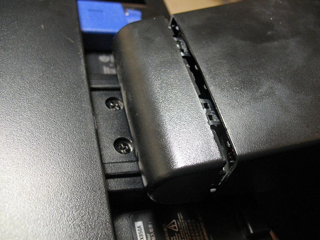

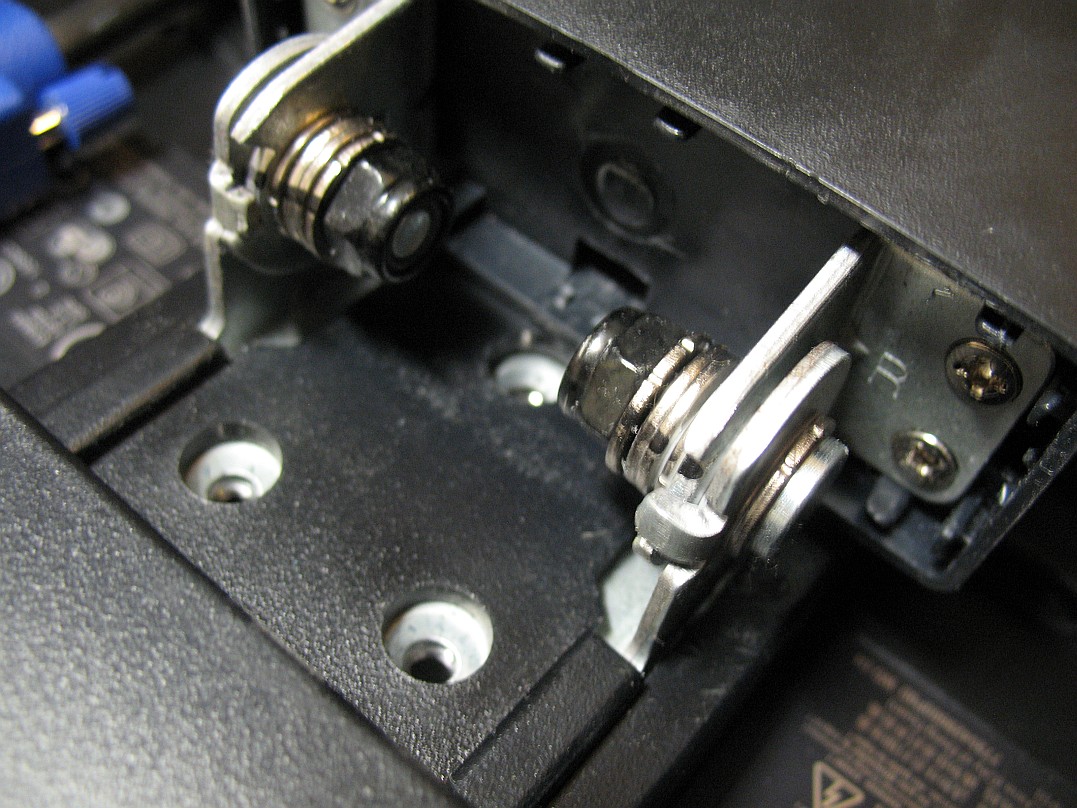

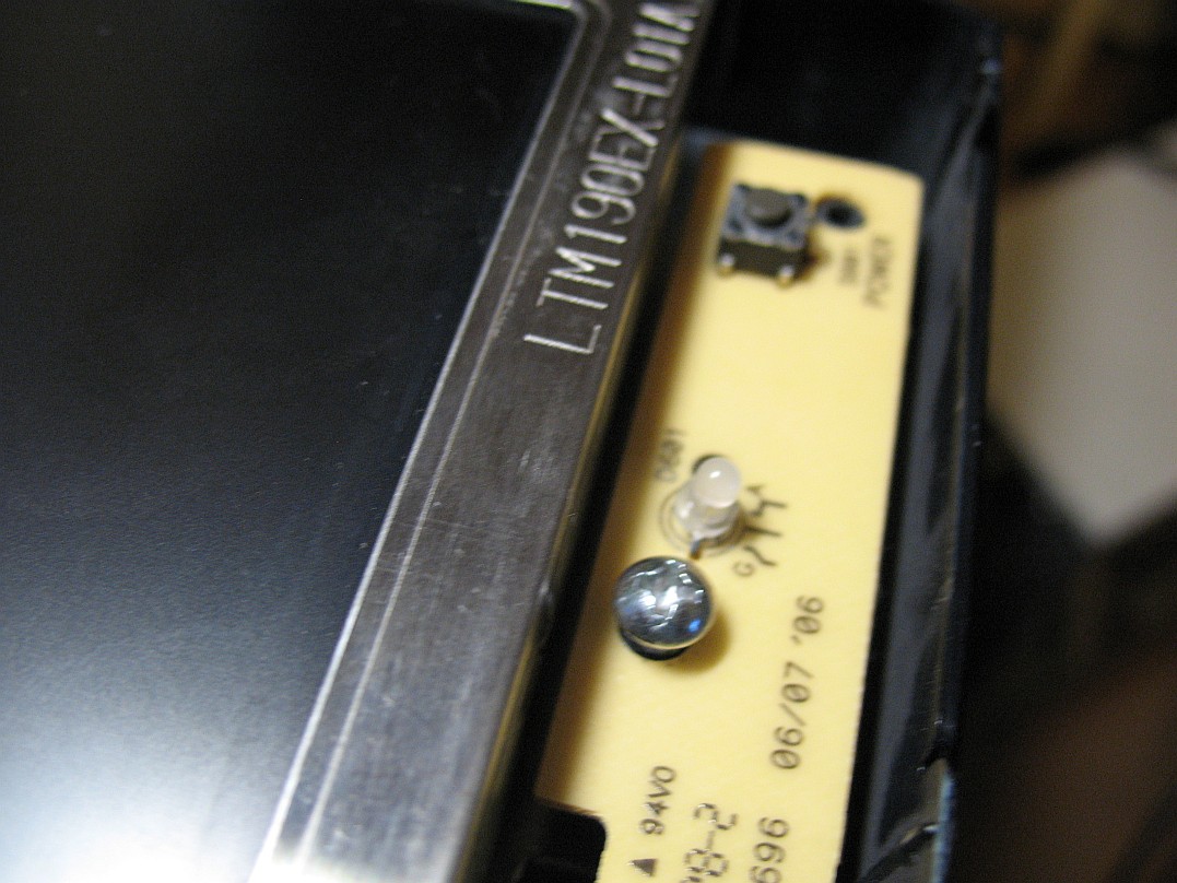

    3) Insert a very small flat bladed screwdriver in the gap between the silver front bezel and the black plastic back (do this at the bottom of the monitor so if you scratch the bezel it will be less noticeable.)
    4) Gently push the black plastic inwards which will deflect the black plastic retaining tabs inwards, and will release the silver bezel.
    5) Once you have the bottom off, work up the sides and release the top. Then remove the bezel completely. Then unscrew the ON/OFF + Menu Button panel and move it aside being careful not damage the wires that attach it to the unit
    6) Place the monitor face down on a towel (or other soft surface, for example a scantily clad super-model will also work)

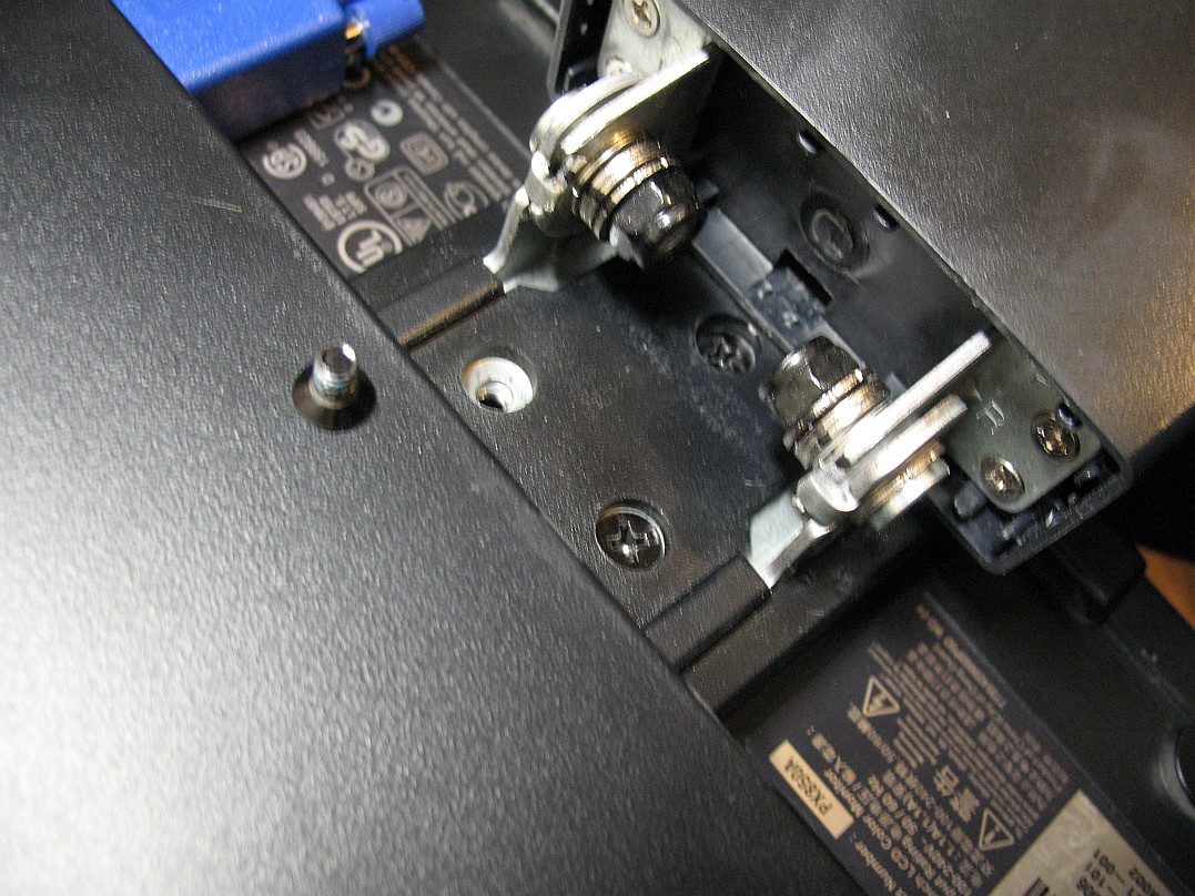

    7) Gently compress the top cap of the tilt stand to disengage the locking tabs that hold it on, and remove it revealing the "third screw" of the tilt mount. (I had to use a lot of 4-letter words to find this, your mileage should be considerably superior)
    8) Unscrew the three screws holding the tilt stand to the monitor back and remove the tilt stand. These screws have loctite, so use a good screwdriver and press hard. If using a super-model, she should be squealing with each torque thrust.

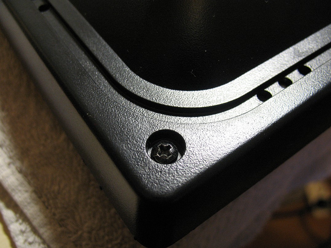

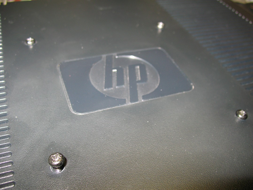

    9) Remove all 8 screws on the rear panel - 4 One in each corner, and four more on each corner of the raised section in the center of the monitor.
    10) Remove the back cover

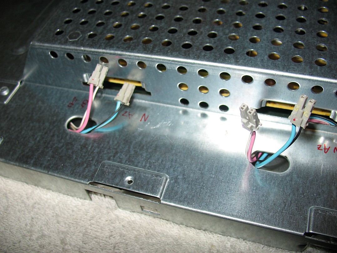

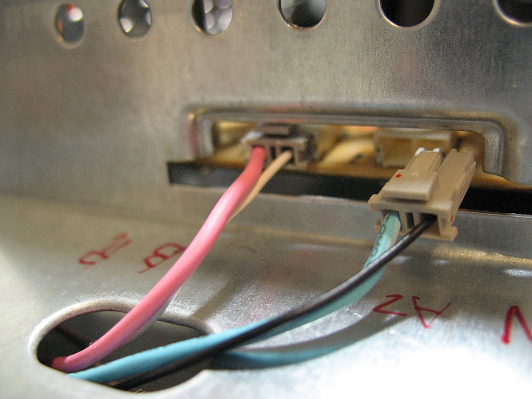

    11) Remove the two screws on either side of the AC power receptacle and the 4 wires that plug into the monitor chassis, noting the order in which they are connected.

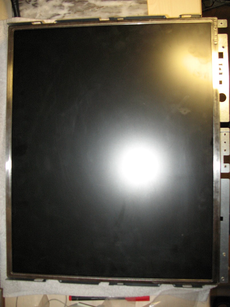

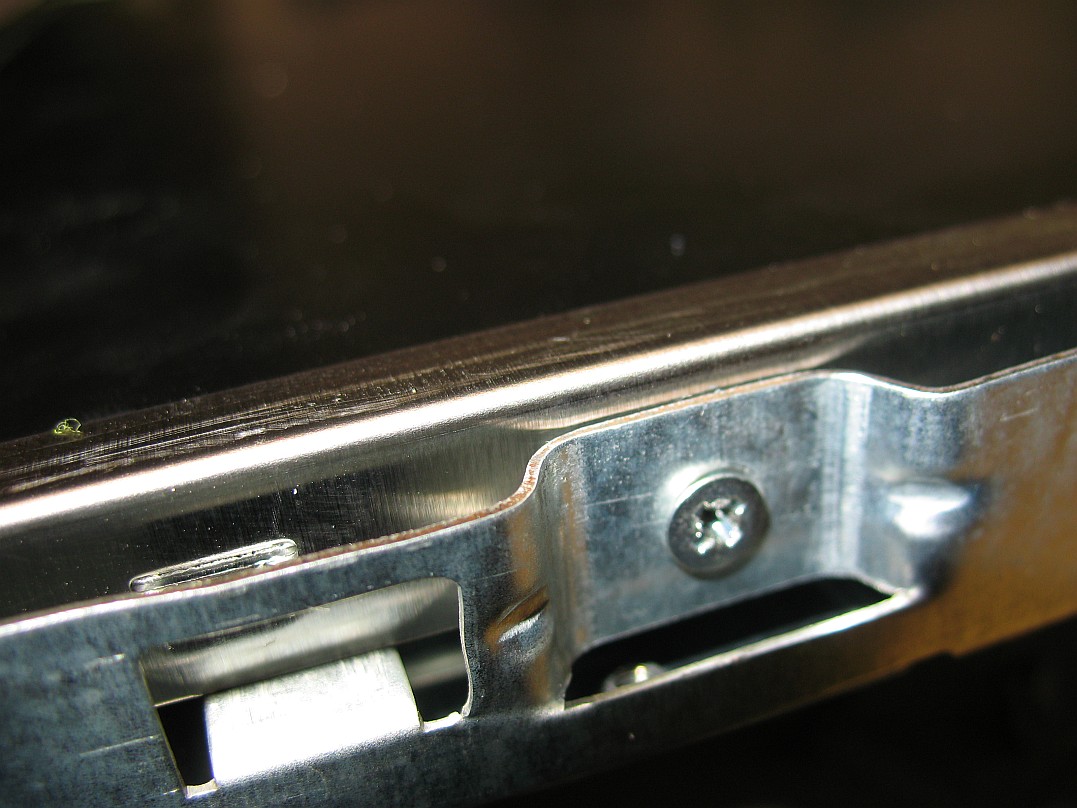

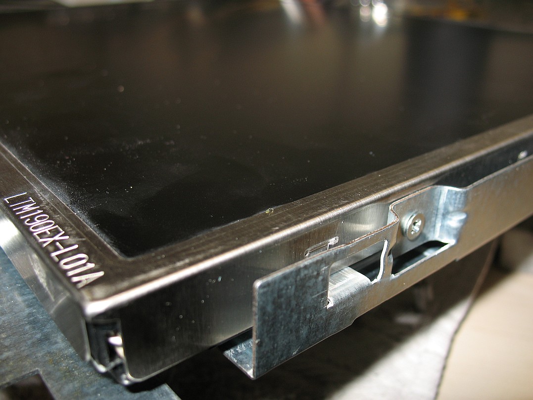

    12) Remove the 4 screws that hold the LCD panel to the chassis

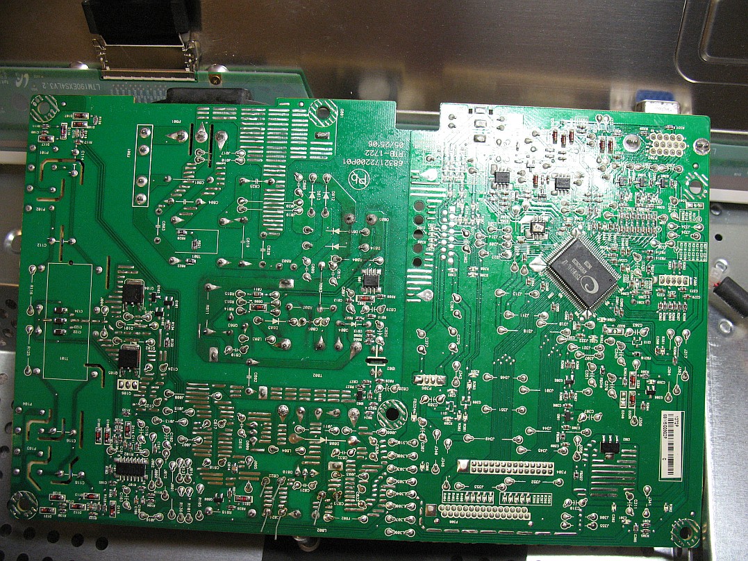

    13) Gently remove the panel enough to get access to the power board, being careful not to damage any wires or their connection points.
    14) Remove the 4 power board mounting screws, note that one is different, and remove the power board.

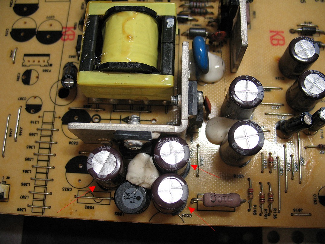

    15) Remove all defective electrolytics (especially 5V 1000uF near the +5V outputs). The defective ones are bulged or have burst.

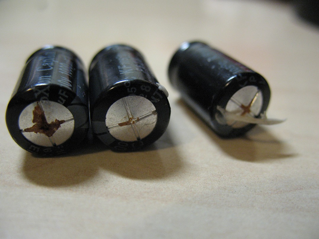

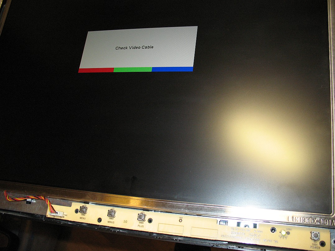

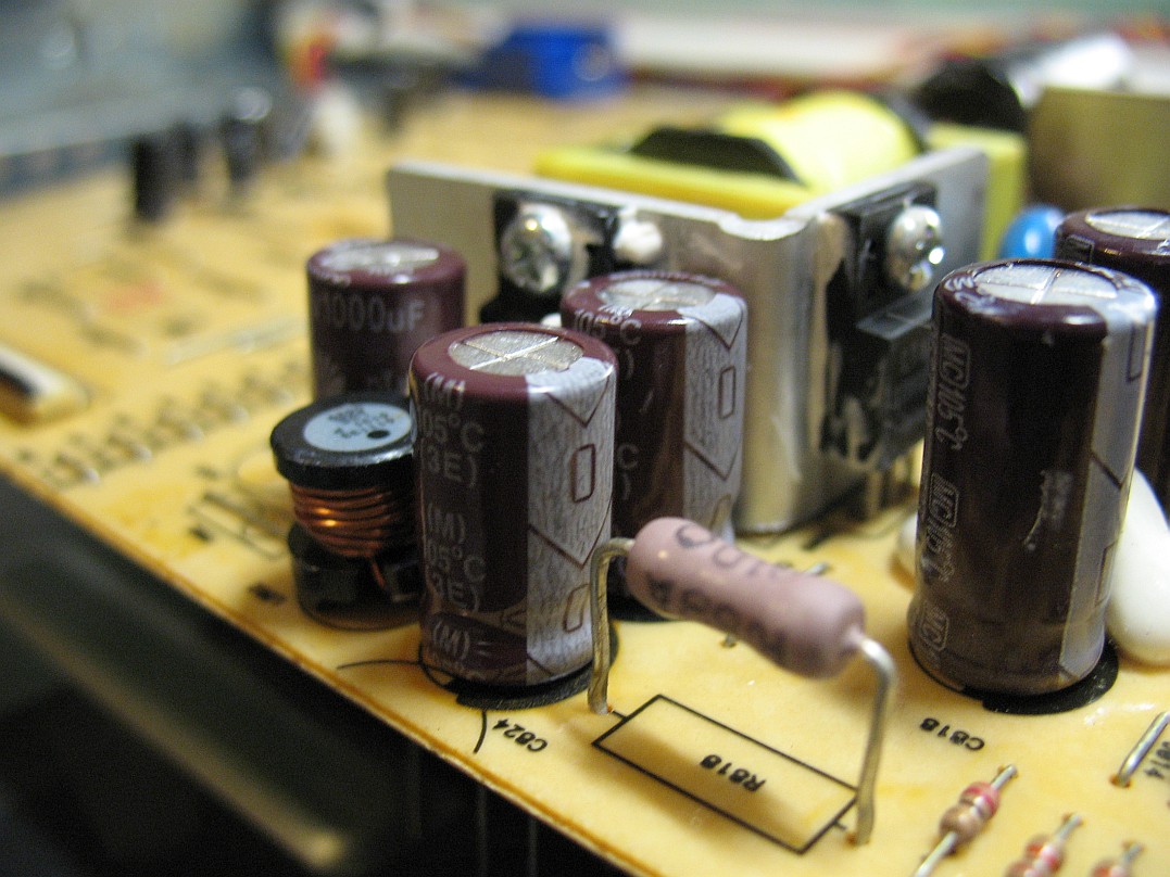

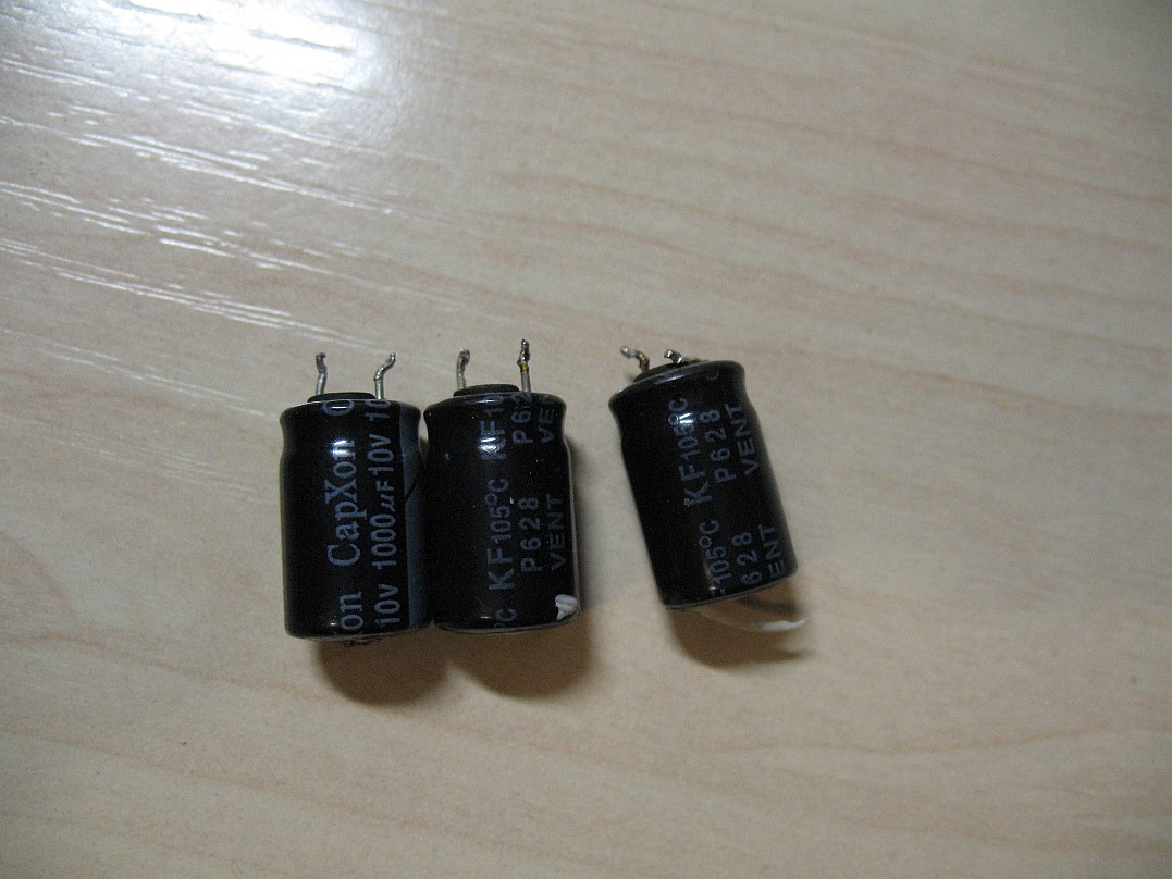

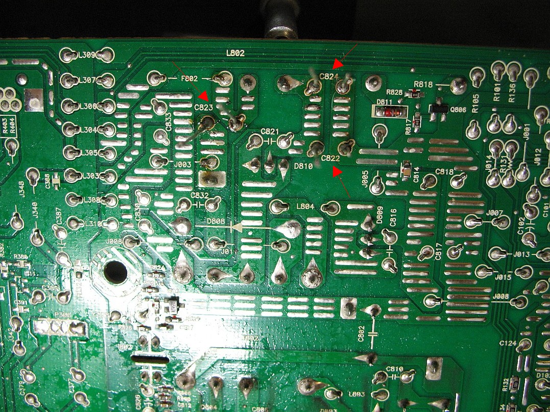

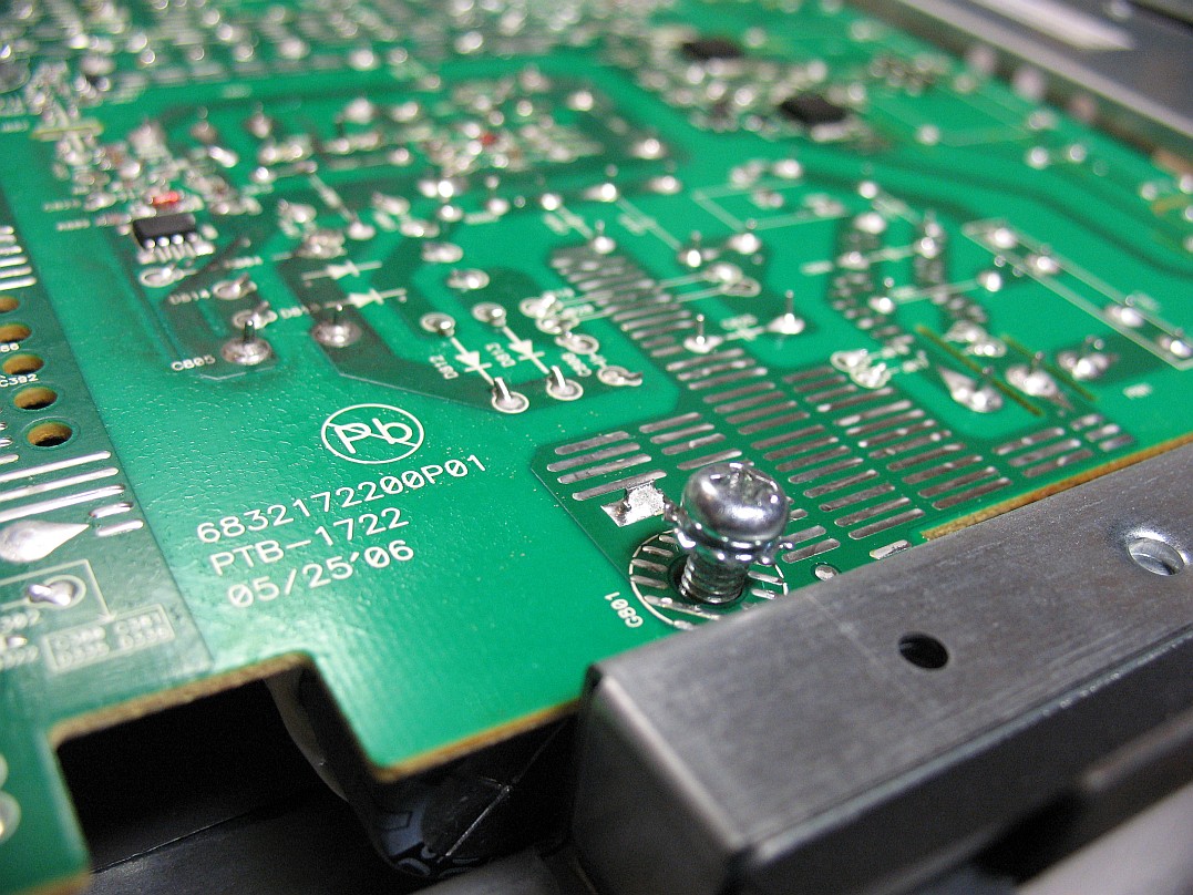

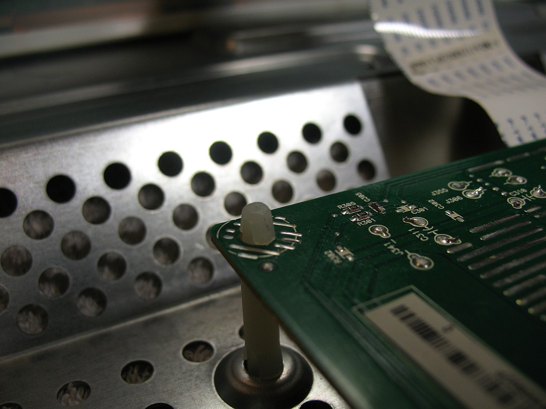

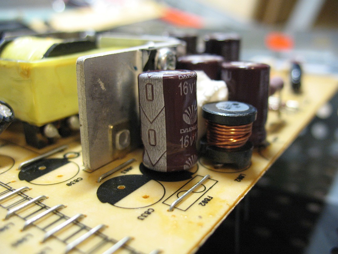

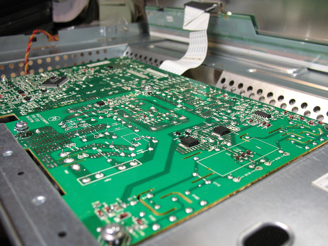

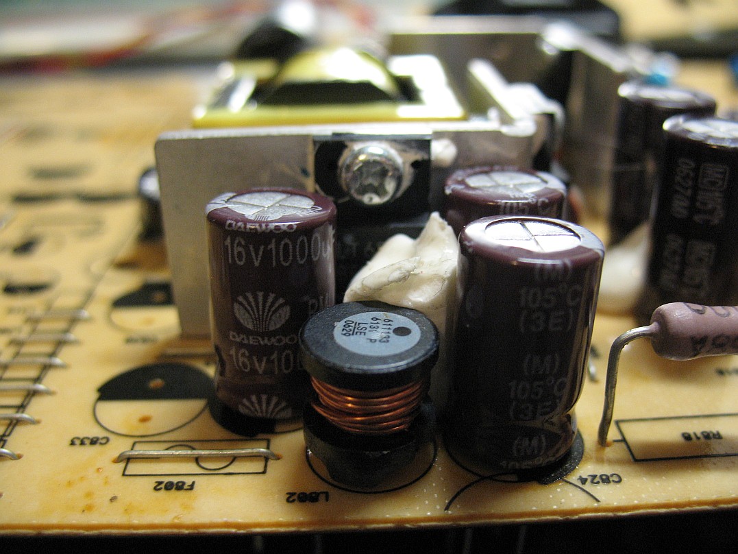

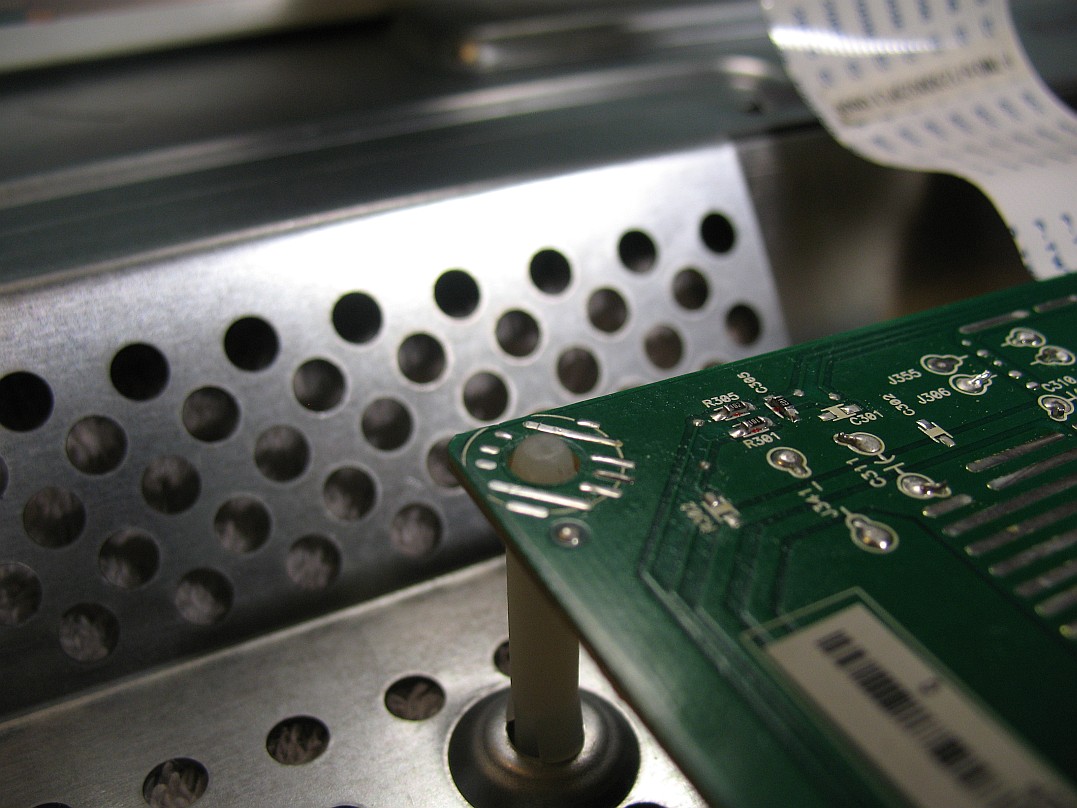

    Mine had exactly 3 caps numbered C822, C823 and C824, 1000 uF 10 V CapXon, vented off and not working. The monitor didn't power on. The fixing consisted in desoldering of the old three and soldering of three new Daewoo same specs but 16V. The monitor started at first try and has worked several hours with no problems.
    Here are the pictures, I expect them to be useful.
    I also am attaching the service manual I have found, although it does not seem to address the problem this monitor had (or at least not in the way I made).

    Please make sure to use LOW ESR type caps not general purpose type otherwise it may last weeks or months since the power supply is running 24/7 even when you turn off the monitor.

        Thank you, budm for your great pictures and wise words. My fix was a quick and dirty (and cheap, 0.39 €) one, my local e-shop did not let me choose the caps. But after reading the datasheets I see that tan delta for CapXon KF 10 V is about 0.19, and for the Daewoo RMU it is about 0.24, not as far a difference as it could be. Obviously, using low ESR Daewoo RUF you meet a tan delta of about 0.10, much better.
        Perhaps a more critical factor is the leaking current, what seems to differ in greater proportion. IDK.
        If it breaks soon, I will change all the electrolitics that you note with some good ones from ebay.
