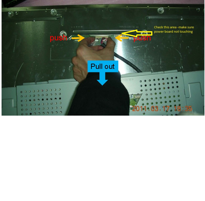

      The link below is the instruction how to take the display apart.

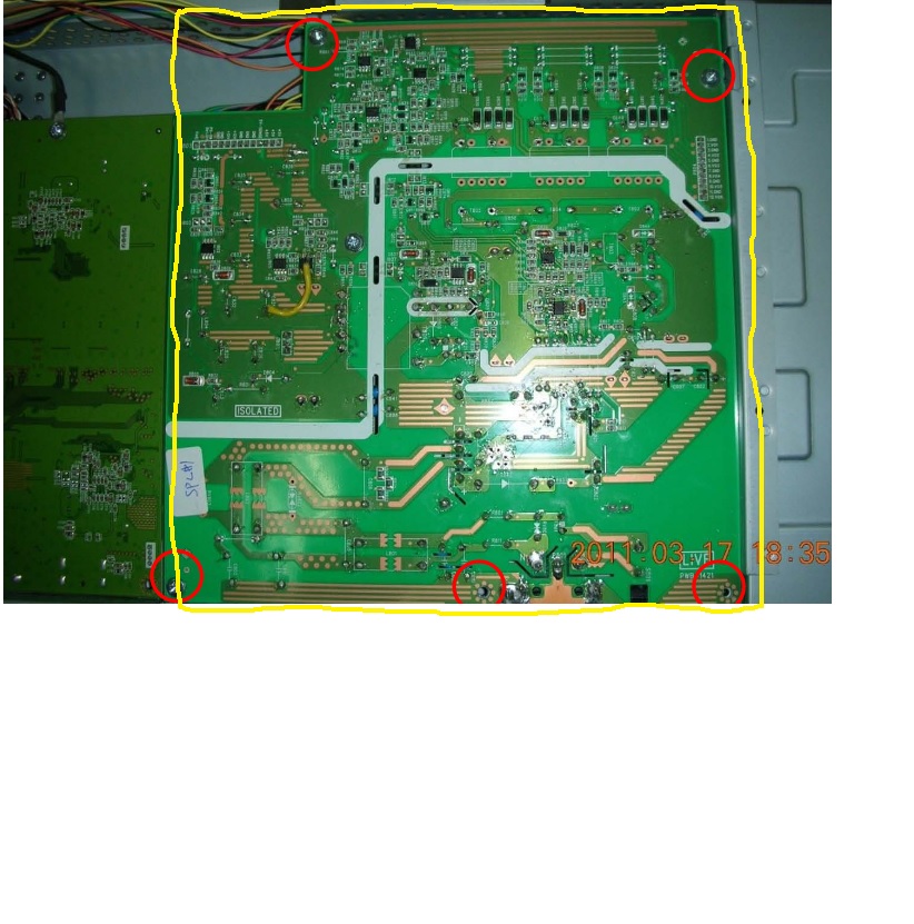

          #64
          Re: HP ZR2740w almost dead
          Hot Dog,
          Please try put insulation under power supply board-make sure it covers the entire board. When you put the board and main bracket down, try tapping on it to see where it touches on back LCD metal.
          I attach the picture highlight below.
          disassembly instruction

              #66
              As i said Teeva, i test it in dissasembled state shown on picture bellow, so there was no possibillity of short circuit in my case. But finaly figured it out and repair LCD succesfully. Problem was badly soldered conector in LED string, which caused its fall. It actually pretty well correspond with voltages i measured on v01 - v06. So if it be helpfull for someone, problem can also be there. Actually, connector had to be pretty badly soldered considering monitor has never been opened before.

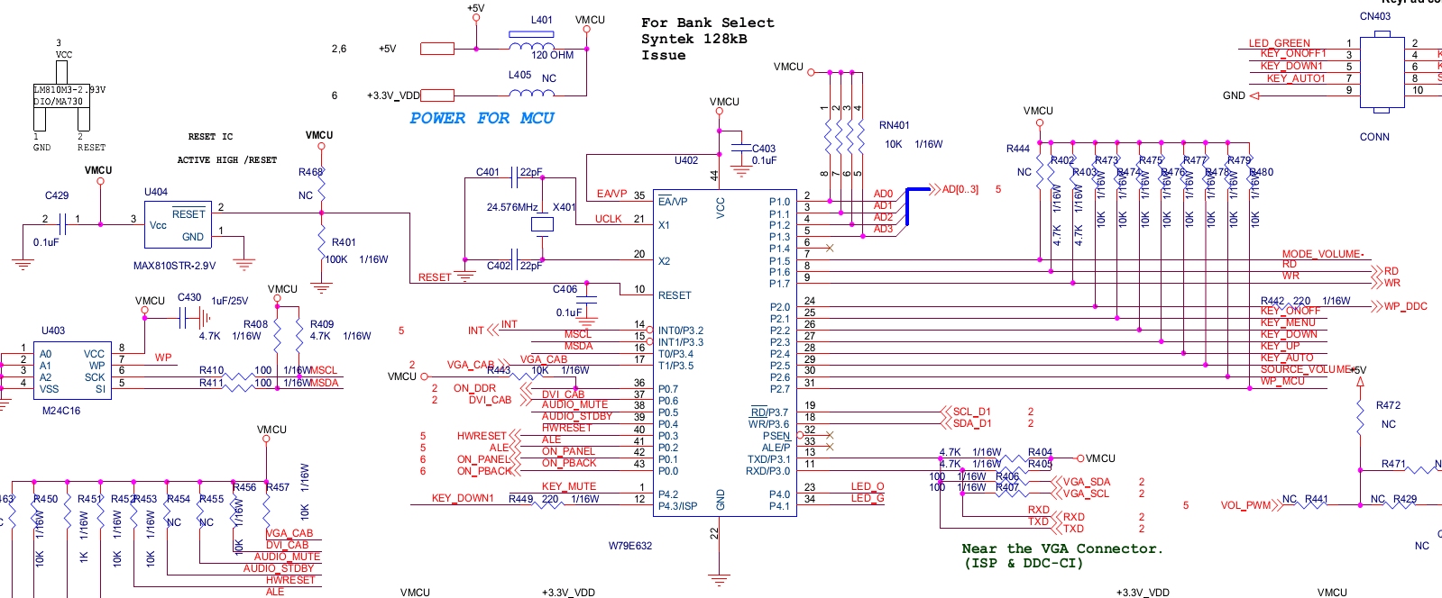

                    Hello. I have got also HP ZR2740W with no background light.
                    When i switch on mains, status LED goes to blue, after a few seconds to amber. It seems all OK, because i have no connection to PC. But i have no background light. I have got on P803 +5V on all 5V pins, 0V an +12V pins, 0V on pins 2,3 and 2,1V on pin 1.
                    According to hints above i pushed up pins 2 and 3 P803 (with 820 ohm resistors) to +5V and background light appears.
                    I found, that signal for pins 2 comes from IC U12 - Myson MTV416GMV, pin 26 and signal for pin 2 from pin 9 IC on T-CON and logic board (IC has supply 3,3V, quartz oscillator is running).
                    Can someone help me? Thanks a lot in advance.

                          Thanks for answer. I found similar circuit diagram with MTV416GMV IC also, (service manual from other brand of monitor), but as you wrote also, there are ports used to others functions.
                          When I switch-on mains without connection to NB, I have no info on screen (NO SIGNAL or NO CABLE CONNECTED or similar message on screen). Display is completely dark, without backlight also. After a few seconds blue status LED is changed to amber..that is all. According to my experiences, there should be any message on screen about missing signal on screen.
                          I tried to connect monitor to NB via Display port and amber LED status has been changed to blue.. and in next 1-2 seconds I had picture :-) .
                          But… after next 30-35 sec (I checked it more times), goes LED status blue to OFF ??? monitor was is still running. Strange is also, that I have no ON-SCREEN info on panel. When I press “+” or “–“ button, brightness is changing, but I have no info about it (brightness string bar is missing on panel). Also button “source” is probably changing the source of the signal. I have picture/no picture on screen – when I am pressing this button twice.
                          Yesterday was monitor running about 30 min, after that - again black screen. I tried to measure capacitors in feeding level +5V, +3,3V and 1,2V today and all seems to be ok (capacity and ESR also).
                          Today is running about 60 min (PCB are “fixed” only temporary and isolated by thick paper).
                          ON SCREEN is not so important, but why is status led switched off after 30 sec. when monitor is running. I think that there is still something wrong (missing communication between ICS responsible for identification of signal and steering processor??? ) and I expect next problems with this HP monitor.
                          Do you have any hint what can I check, measure ?
                          Thanks in advance.

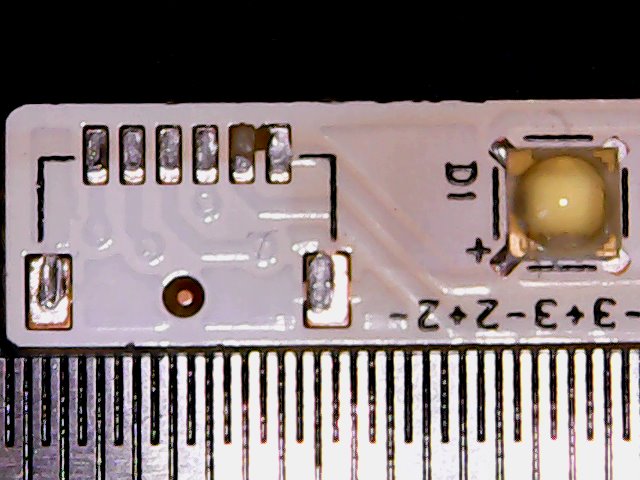

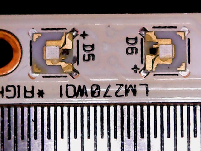

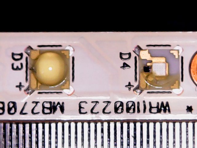

                              Hi. I'd like to revive this thread as I have the same problem as Wash and Darkdead. From the information on this excellent forum I've managed to get to this point without trouble, but I would be grateful for further advice.
                              Specifically I would appreciate any advice on disassembling the LCD panel to get to the LED strips. I see at least Hot_Dog successfully managed this! I have the HP disassembly guide but I'm only at step 3 so far. It seems very delicate and also heavy - not a good combination!
                              I don't see how steps 4-9 work, and I'm not sure if i really need to completely disassemble the panel (i.e. to step 22) in order to remove one of the strips (VO6 was the failed one on mine).
                              Also, does anyone know where to source replacement SMD LEDs for this from and/or what parts they are exactly? I found a couple of ads for similar on eBay.
                              Thanks very much!
                              CMG

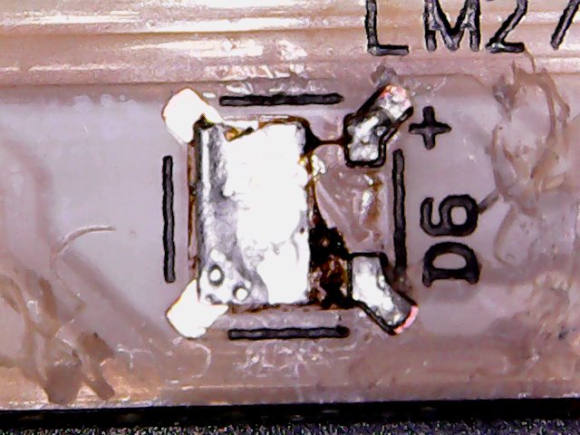

                              Here is what i did so far:
                              1. Observed that the behaviour of the monitor is the same as many others in that the monitor will not display an image and go into standby.
                              2. I noticed that the logic circuits have power. The front panel LEDs (blue/amber) lit and if i plugged in a device into the USB i could see it was powered up. Also the PC recognized the monitor model and resolution.
                              3. Next i checked the output of the PFC boost converter. This was 320V rising to 400V but then after a few seconds after power-up, dropping back to 320V. This matches BudM's explanation of the fault condition.
                              4. Then i checked the LED driver outputs. All of these were 30V when the boost converted was fired up, except one which went up to 60V.
                              5. I proved to myself that the problem was this output being O/C by soldering a 100R resistor from this LED driver output to ground, then the monitor worked! (note a 10W resistor is required otherwise the resistor will burn).
                              Note that to get to this stage I did not need to remove the PSU PCB from the chassis and would suggest others also do not, for safety. In fact, I could have checked the LED driver output first by poking the connector from the outside of the chassis. I'm scared by others' posts showing this 400V non-isolated circuit loose on the floor. You only need to trip or pull one of the cables and ZAP

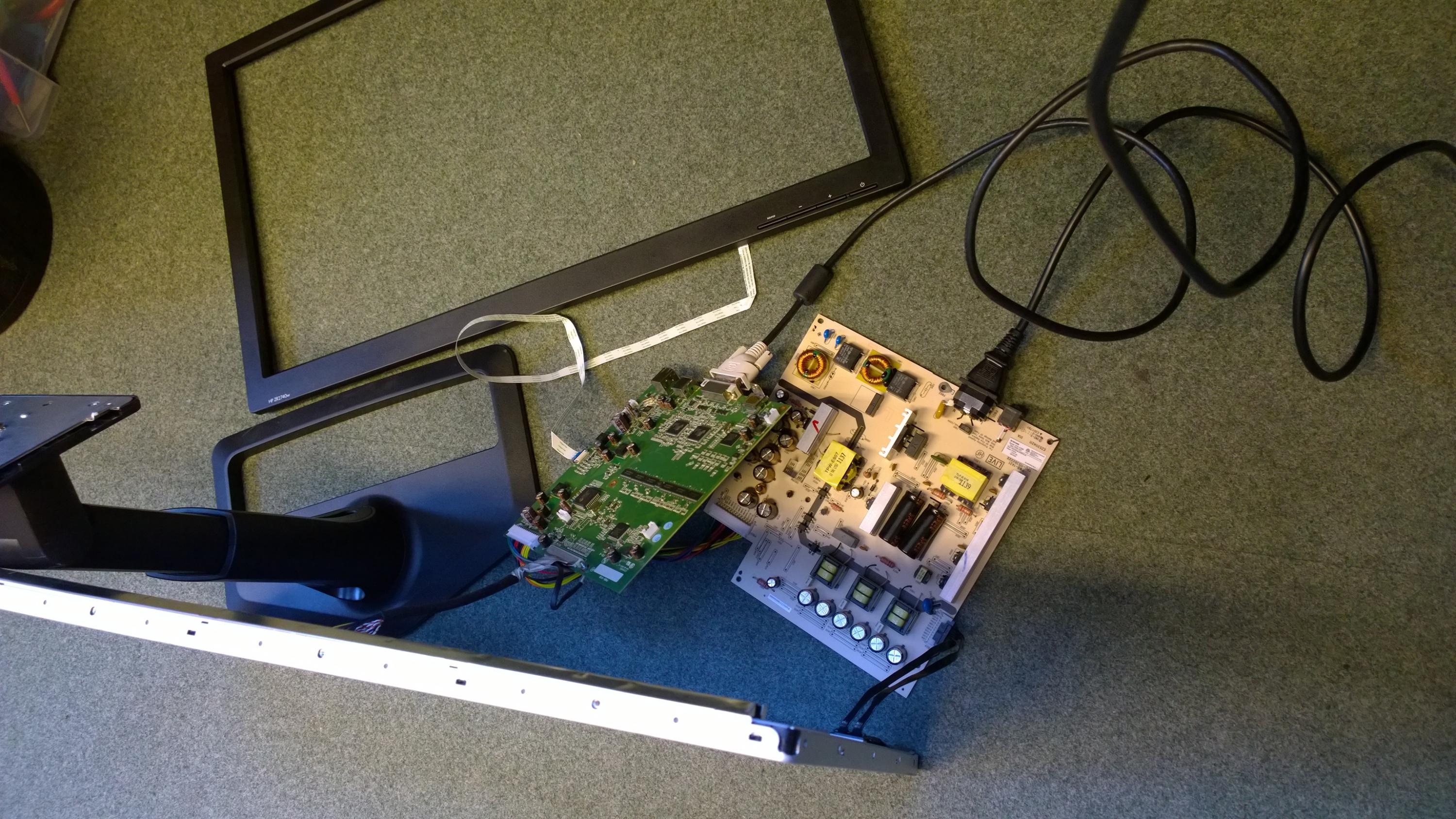

                                  #76
                                  Hi Hot_Dog. Great to hear from you. Thanks for replying.
                                  Thanks very much for the advice about the dust. I am using the manual that you referred to. So now I have proceeded... I have avoided step 10-13, so kept all of the layers together. Hopefully this will avoid the dust problems.
                                  The trouble with the guide is that it is for recycling the parts so they don't care about damage or reassembly. I hinged the panel back open so that I could access the LED strip but I couldn't get it out after taking out the screws. Then i saw step 17-19 where they take out the "light guide". Unfortunately as I had already loosened the LED bar, when i pulled out the white plastic light guide it has damaged 4 of the LEDs Also the connector ripped off the PCB. See attached (ruler shown for scale).
                                  I have checked all the diodes with a DMM. All of them glow (even the damaged ones) apart from one which has a very low forward voltage and is not in the VO_6 section that had failed. So, i reckon the fault was exactly the same as yours - that stupid little connector had dry joints and is just too flimsy.
                                  So now... I need to replace 5 LEDs and reattach the connector. The first problem is I need to get replacement LEDs, or the whole LED bar. I can't find where... Second is that i think this all needs to be done with a hot air reflow station which I don't have.
                                  I think i'll start a separate thread on fixing LED strips as it's not specific to this monitor.
                                  If anyone has any advice on finding replacement LEDs would be well received! (this is an LG panel).
                                  Cheers

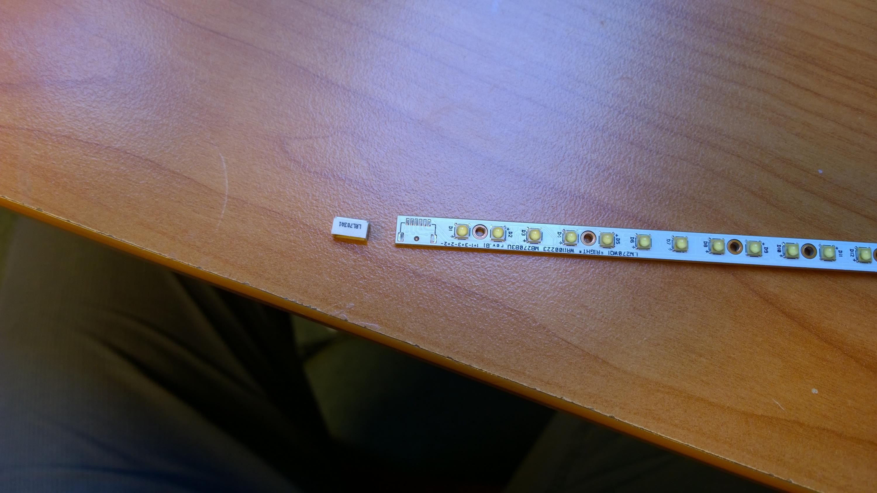

                                      Thanks for the soldering tips. I'm very experienced with through-hole but not much with SMD. I am fairly confident I'll work that out.
                                      However, I'm still drawing a blank trying to find a suitable LED. The dimension seems uncommon and also all the LEDs seem to be flat in profile rather than having the domed lens that these have. I don't know how much difference that will make. I will add to my other thread regarding finding the parts.
                                      I'm also wondering how it will work if i put a new LED which is undoubtedly higher efficiency in series with the old ones as it will be brighter. I suppose i may have to add a resistor in parallel with the new one(s)...
                                      What a pain!!

                                        OK well I now realize the LEDs may be unique to certain panels. These ones are also effectively on a heatsink with a 3rd pad which makes them difficult to get off the PCB as the heat is dissipated. Its not possible to hand solder - see the large pad underneath which is not reachable. It took me quite a long time to get this LED off with a rework station @ 350C. See the PCB is burnt now. Hopefully I can get better at this and solder replacements without damaging them.
                                        • cmg
                                          • Dec 2016
                                          • 32
                                          • United Kingdom
                                          #80

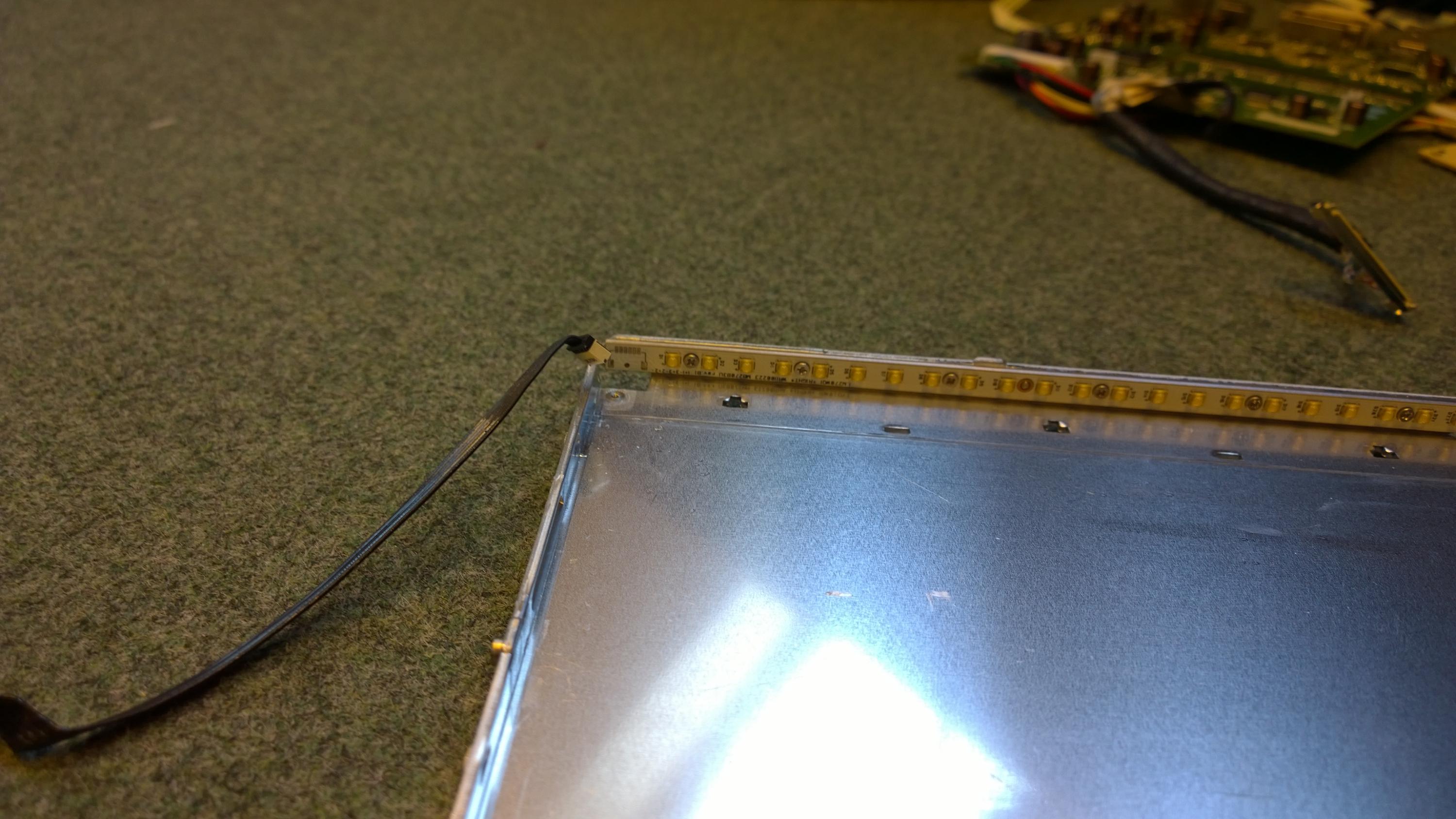

                                          OK i got it done and am posting a little more info in case anyone else has the misfortune to try to fix one of these panels. I wouldn't bother unless you are already very experienced at fixing such devices to component level. This panel was not designed with servicing in mind!!
                                          Here are the important steps
                                          - to diagnose if the LED strips are faulty easily, insert a piece of solid core wire as an extension to your multimeter in order to check the voltages on the connector feeding the LED strip. This can be done without disassembling the chassis at all. If any one of these rises much above 30V then there is an open circuit. Mine went to about 60V. Proceed to repair the panel.
                                          - take note if the open circuit is on the left and/or right side LED strip
                                          - remove chassis taking care with plug to LCD panel
                                          - unplug the LED driver cable at the chassis end. DO NOT ATTEMPT TO UNPLUG THE OTHER ENDS.
                                          - lay panel face down
                                          - remove metal shield to TCON PCBs but do not remove PCBs
                                          - unclip the panel from the steel frame.
                                          - undo the 6 screws from the 2 part plastic frame
                                          - prise apart the plastic frame at the edge with the LEDs (bottom edge)
                                          - carefully hinge the panel open
                                          - remove the small screw on the white plastic 'light guide'. This is in the corner, inside the panel
                                          - with the panel closed again, remove the shiny black tape
                                          - push forward a couple of the white plastic clips found underneath this. Every one i did broke off...
                                          - unscrew the many tiny screws holding the LED strip, from inside the panel.
                                          - try to pull the white plastic light guide away from the edge of the panel and ease out the LEDs. There are 2 metal pins protruding from the case which also anchor the strip - you need to pull it about 1-2mm away to clear these. Try not to force it... each time i did it, i knocked the top off one or more LEDs creating more work...
                                          - fix the PCB. May well just be the connector.
                                          - test the strip using a constant current PSU before reassembling. Set to approx 100ma limit, 30V. The connector on the PCB is really poor and will need retouching. Test from the chassis plug to make sure this connector is checked.
