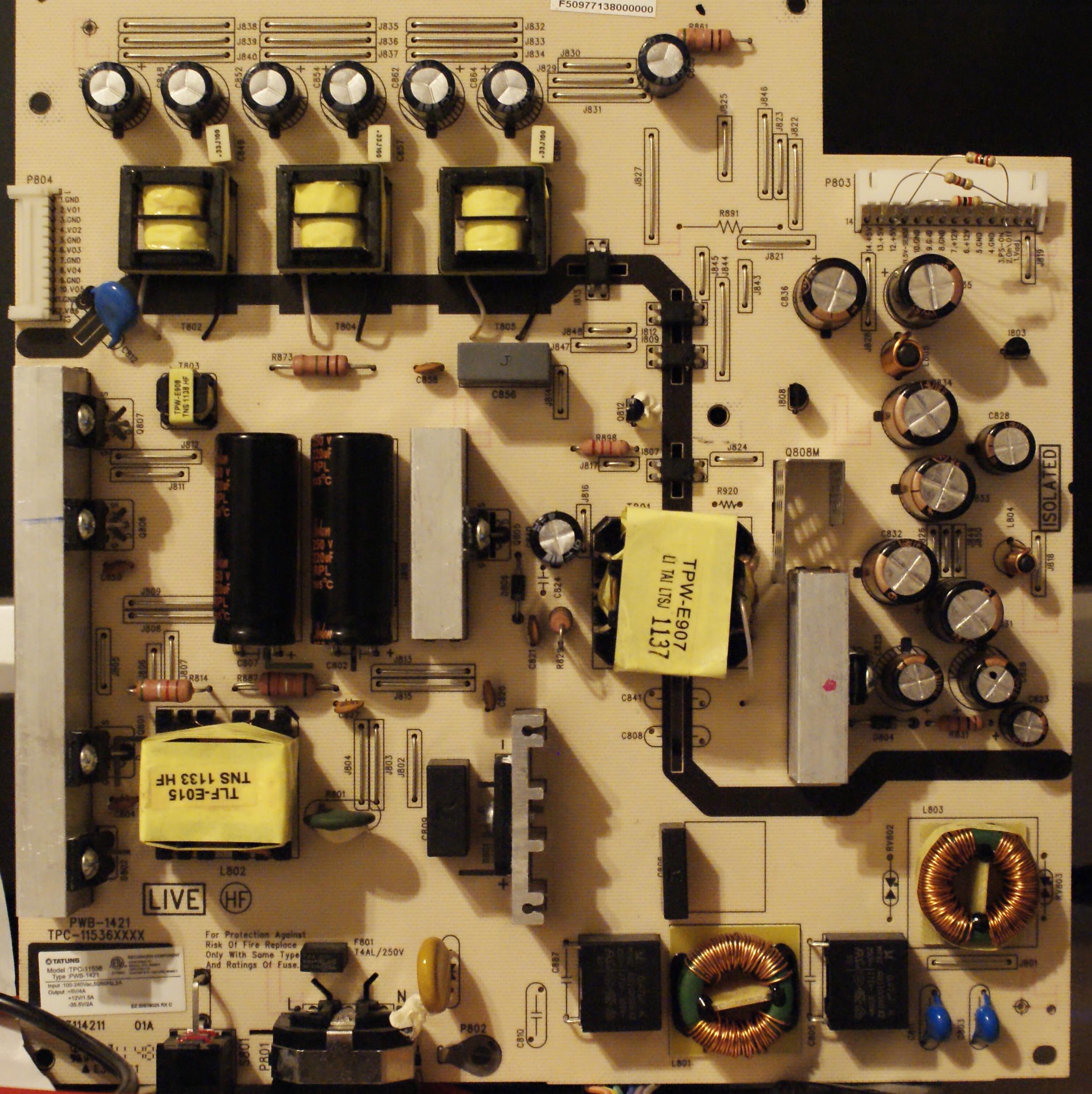

                                • mikolajj
                                  • Nov 2017
                                  • 9
                                  • Polska
                                  #96
                                  Re: HP ZR2740w almost dead
                                  Originally posted by budm
                                  The PFC Voltage booster should boost the Voltage from around 325V (230 ac line x 1.414 = 325V) to >360VDC which is required by LED driver circuit to function.
                                  Helo,
                                  My case stops here.
                                  Everything is disassembled on my desk.
                                  When I turn on main switch S801 LED are On with hight backlight (bright), after few seconds thay dimm to 50% (let's name it like that, but it's not mesured 50%), and after another few seconds thay dimm even more - again let's say 25% of light.
                                  After that, they stay lighten up all the time but very dimmed.
                                  No input signal is given form PC, but there are pull-up resistors to force 3.PS-ON and 2.On/Off - so, turn on power supply and force LEDs to light up.
                                  Force switching power supply and backlight LEDs
                                  3. PS-ON pulled up to 5V (I've mesured 4.7V)
                                  2. On/Off pulled up to 5V (I've mesured 4.7V)
                                  1.V.adj pulled up to 5V (I've mesured 4.7V)
                                  This gives exactly what I wrote at the begining.
                                  Other tests
                                  - fuse F801 has 0.4Ohm resistance
                                  - before turning F801 on I get 5.2V on 5V rail on P803
                                  - before turning F801 on I get 0.1-0.3V on 12V rail on P803
                                  - before turning F801 on I get 1.9V on 3.PS-ON on P803
                                  - before turning F801 on I get 1.9V on 2.On-Off on P803
                                  - before turning F801 on I get 1.9V on 1.V.adj on P803
                                  - after turning F801 on, I get 11.4V on 6 and 7 pins on P803
                                  - testing voltage on P804 (switch on and off every time) gives ~30V on every pair - every time and it stays 30V even after voltage drops from 400 to 300V on big caps (C807 and C802)

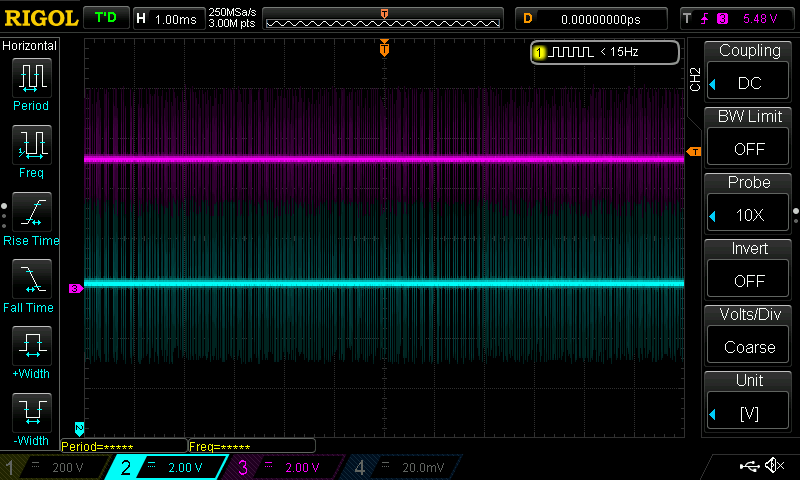

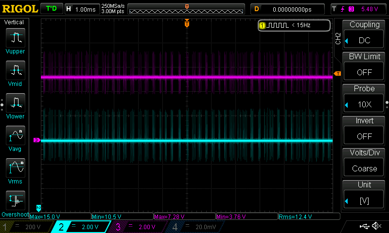

                                  - Mesuring 5V and 12V on P803 I have notice huge ripples - see attachement
                                  This ripple is higher when I read 400V between caps and drops a little after voltage drop to 300V (on caps)

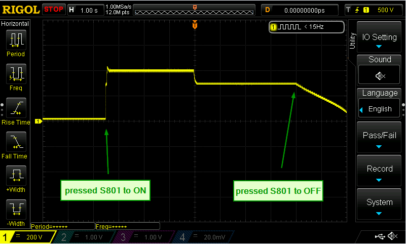

                                  When I switch main power-switch S801 on, I get 400V between C807(-) and C802(+) for about 3.5s and after that it drops to ~300V (see attachement).
                                  Reading other posts about this monitor model I think there's problem with PFC Voltage Booster, but I have no idea how to test it?
                                  How to check if it's I801 or sth arround?
                                  - diode D802 gives 0.48 forward Voltage and OL backwards in diode test mode - so it's fine
                                  - transistor Q801 - soldered out gives:
                                  - S > D 0.53V (red to S to black to D) in diode test mode,
                                  - D > S OL (red to D to black to S) in diode test mode - correct
                                  - diode D803 - forward voltage 0.58 (opposit way OL) - correct
                                  Second issue are ripples on 5V and 12V rail on P803.
                                  While I pulled up 3.PS-ON an 2.On/Off I can see huge ripples during 400V PFC booster work and little bit smaller ripples during 300V PFC Booster work. Should't the ripples be much smaller?
                                  Can you look into attachment and compare it with your knowledge and experience?
                                  What else can I test to find this broken piece of board?
                                  There's one more thing I have noticed looking to other people photos.
                                  Someone have replaced 7 capacitors (LED power): C864, C862, C854, C852, C848, C847 and extra C883 - which is much smaller on other photos.
                                  Capacitors I have now are all 50V 220uF - so question is what values should be there, because I cant find angled photo ;-) and from the top they look like C835 for example?

                                      Originally posted by mikolajj
                                      Helo,
                                      My case stops here.
                                      finally I had enough time to investigate everything again.
                                      The problem was broken LED stripe connector, when it was pressed everything was fine. After a moment everything went wrong. That's why I get 30V per LED power line every time.
                                      I have soldered new connector and everything is fine now. Everything works like a harm.
                                      Good thing is that during replacement of caps I have wrote down their values. I this is what I have found:
                                      Code:
                                       Motherboard
                                      C66	100uF	16V		⌀ 8mm	h 8mm
                                      C67	100uF	16V		⌀ 8mm	h 8mm
                                      C42	100uF	16V		⌀ 8mm	h 8mm
                                      C48	470uF	16V		⌀ 8mm	h 9mm
                                      C45	220uF	25V		⌀ 10mm	h 13mm
                                      C50	220uF	16V		⌀ 8mm	h 8mm
                                      C15	4.7uF	50V		⌀ 5mm	h 12mm
                                      C51	100uF	16V		⌀ 8mm	h 8mm
                                      C52	100uF	16V		⌀ 8mm	h 8mm
                                      C55	100uF	16V		⌀ 8mm	h 8mm
                                      C57	100uF	16V		⌀ 8mm	h 8mm
                                      C60	100uF	16V		⌀ 8mm	h 8mm
                                      C59	100uF	16V		⌀ 8mm	h 8mm
                                      C70	100uF	16V		⌀ 8mm	h 8mm
                                      C71	100uF	16V		⌀ 8mm	h 8mm
                                      C521 	100uF	16V		⌀ 8mm	h 8mm
                                      C529 	220uF	25V		⌀ 8mm	h 8mm
                                      C515 	10uF 	16V		⌀ 4mm	h 8mm
                                      C514 	4.7uF	50V		⌀ 5mm	h 12mm
                                      C530 	220uF	16V		⌀ 8mm	h 8mm
                                      C528 	220uF	16V		⌀ 8mm	h 8mm
                                      C527 	220uF	16V		⌀ 8mm	h 8mm
                                      Power supply board
                                      C840	100uF	100V		⌀ 10mm	h 17mm
                                      C823	100uF	50V		⌀ 8mm	h 12mm
                                      C826	680uF	25V		⌀ 10mm	h 17mm
                                      C831	1000uF	16V		⌀ 13mm	h 17mm
                                      C825	680uF	25V		⌀ 10mm	h 17mm
                                      C832	1000uF	16V		⌀ 13mm	h 17mm
                                      C833	1000uF	16V		⌀ 13mm	h 17mm
                                      C835	1000uF	16V		⌀ 13mm	h 17mm
                                      C834	1000uF	16V		⌀ 13mm	h 17mm
                                      C836	1000uF	16V		⌀ 13mm	h 17mm
                                      C828	400uF	25V		⌀ 10mm	h 17mm
