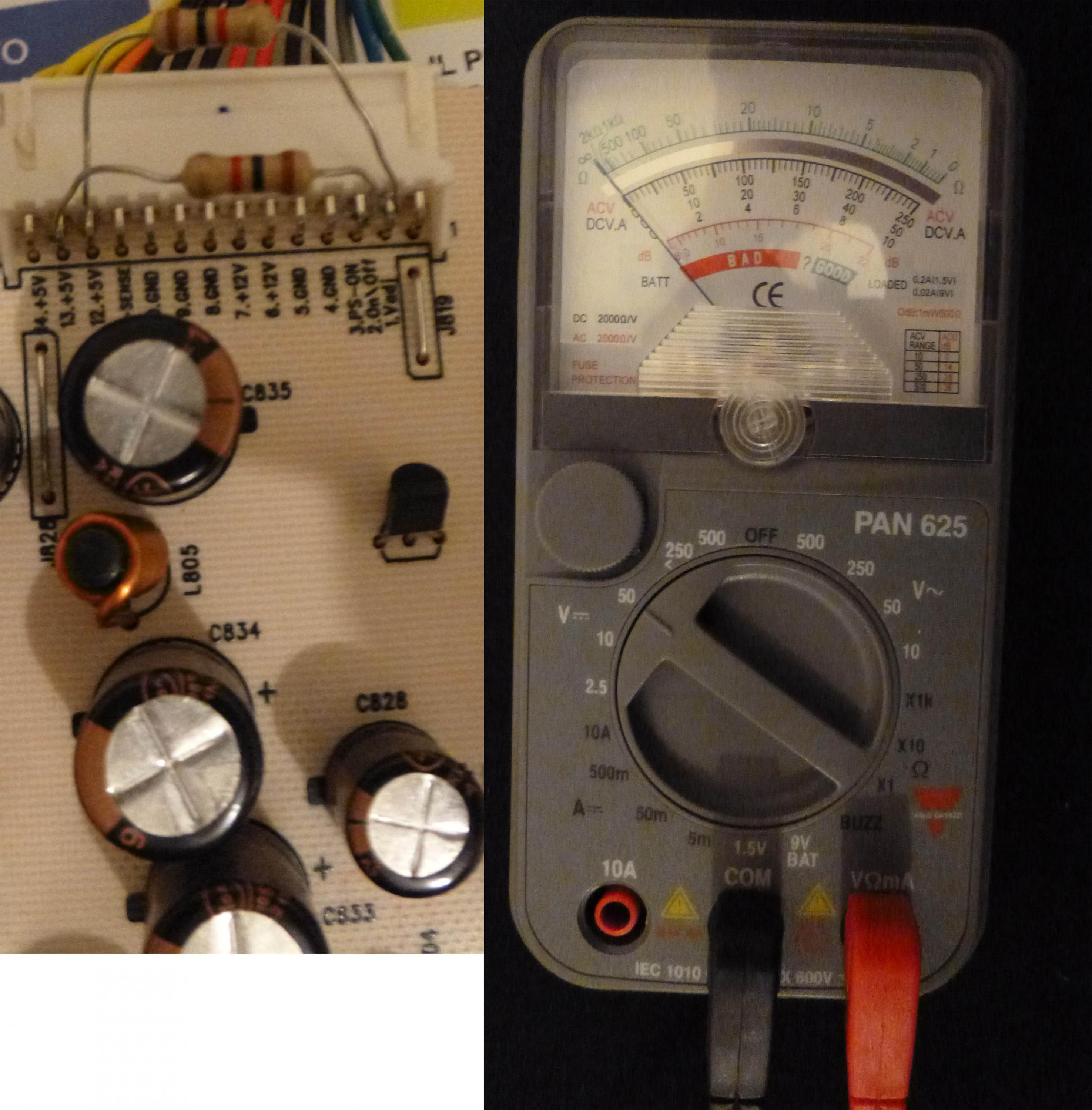

          #44
          Re: HP ZR2740w almost dead
          ok
          with BOTH the resistor i get something around 30V that slowly drops, BUT with the ground of the multimeter on VO1 and the red one on the GND
          if i use the red wire with the positive and the black on the gnd (as it should be used) the indicator goes below 0......

            #45
            OK, leave pin 2 and 3 as is for now then. Black is for negative so put that on the GND pin, Red is positive so put that on VO1 and check the reading, unplug the monitor and then move the red probe to VO2 and the black probe on the next GND, apply power to the monitor and take the reading, repeat the same test on VO3~VO6.
            I am looking to see if all the VO's have the same reading every time the power is applied to the monitor, it is important that you remove the power and then apply the power when you test each VO output.
            I think you should also read the meter user manual.

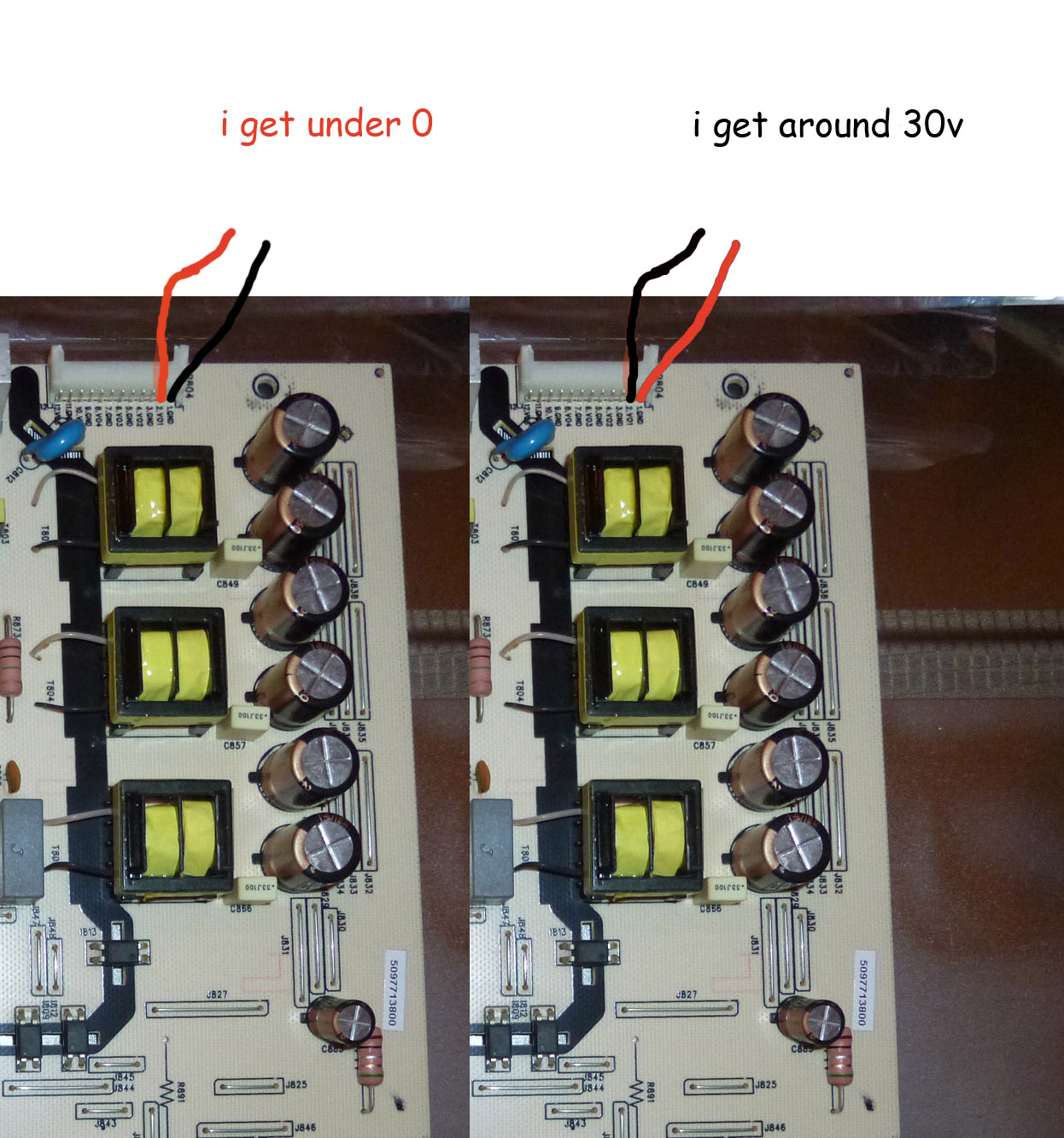

              i did, but if i put the red one on vo1 and the black on the gnd, i get negative results. if i invert the multimiter wire, i get something around 30 that slowly decrease...
                #47
                OK, I look at the bottom side of the board, the VO are negative outputs that is why you had to connect the meter that way, all the GND pins of connector P804 are tied together and connected to the circuit ground and the chassis.
                Then do the same reading on the rest of the VOs, we need to find out if all the VO is putting out 30V, the one with open LED will have higher Voltage.
                " i get something around 30 that slowly decrease" That is because the circuit goes into shutdown.
                BTW, you should get good digital meter.
                I need the readings of ALL SIX VO.

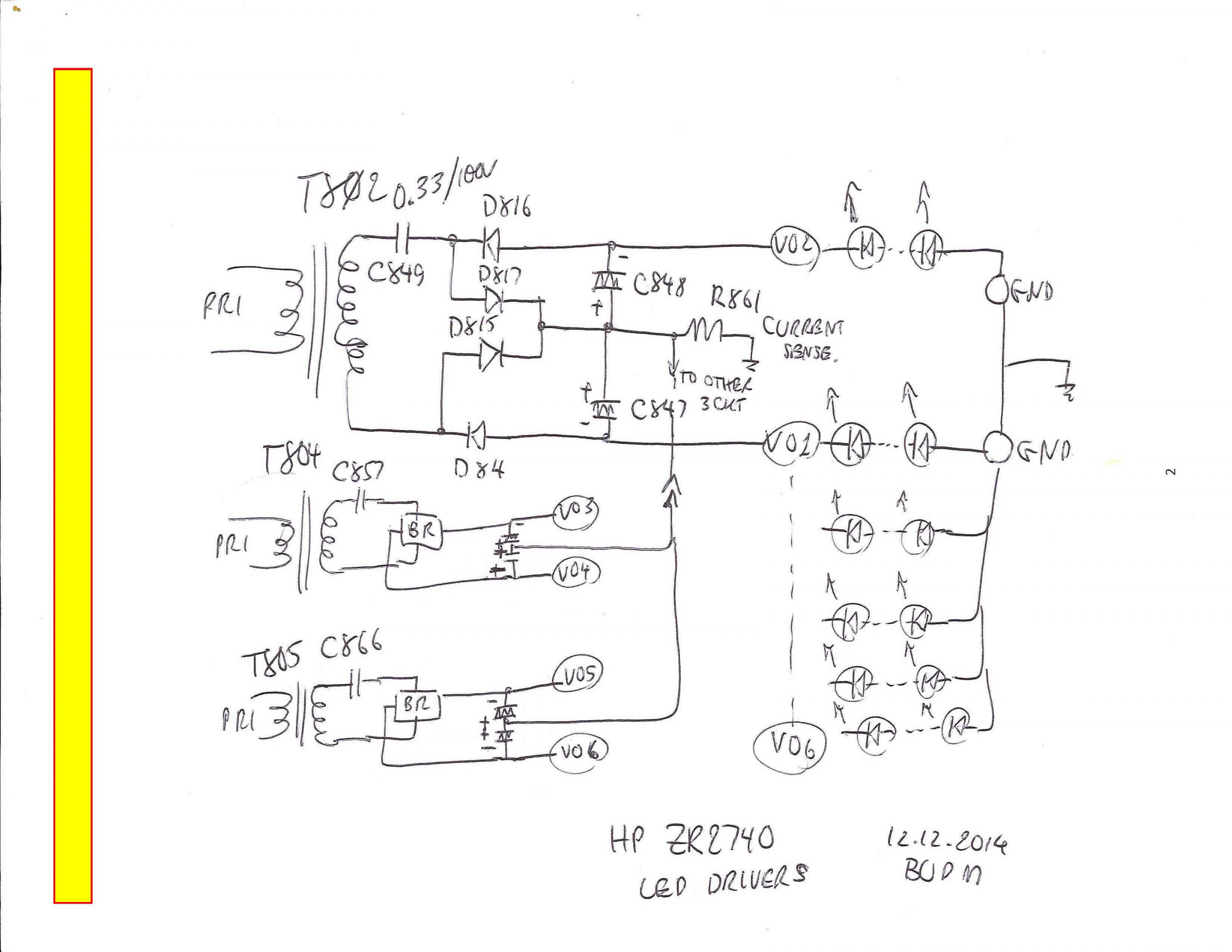

                  #48
                  This is what I come up with based on the pictures you provided.

                      #50
                      Well, the LED string attached to VO4 is the suspect, the Voltage will be higher than the other outputs due to no load connected, open LED or open wire to the LED string, but more likely to be open circuit LED.
                      So you will have to disassemble the panel and test the LED, not going to be easy and you will have to remove the old LED and install a new one or may be able to bypass the bad LED.
                      It looks like each string has 9~10 LEDs.

                          #52
                          You can verify that but removing the other VO wire and see the Voltage will also go up.
                          LED failure are very common in LCD TV and monitor.
                          No body can give you 100% answer, I do not have the unit right in front of me, I base my finding from the results you provided.
                          You can ask for second opinion.
