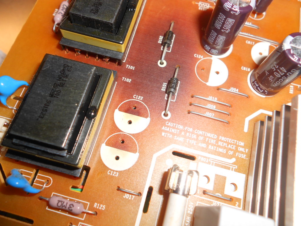

    I found 3 bad capcitors in this monitor and as I removed and was laying them out in order I accidentally knocked them on the ground... so does anyone know if C122 and C123 are both the 680uf 35 v. cap or is one of them a 470 uf 35w? I plan to replace all the caps, but stopped removing them after this mishap... the other cap removed was C124.

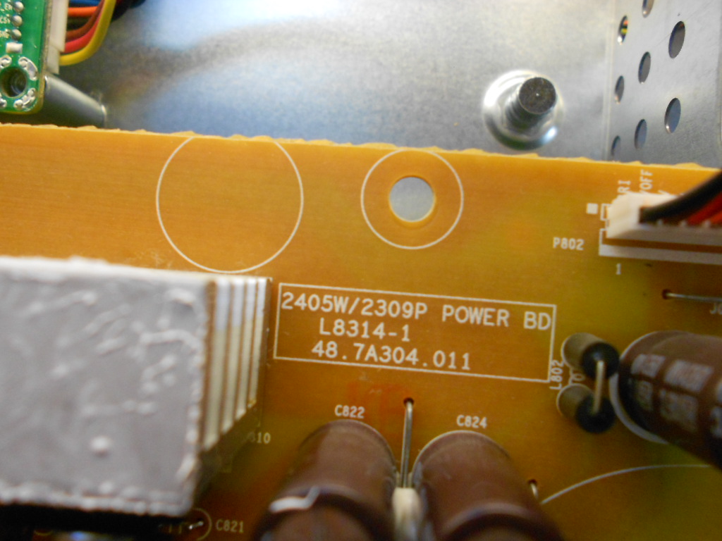

    please update your profile with country and mains voltage,
    post a good clear picture of your board using manage attachements and stte the board number and revision.

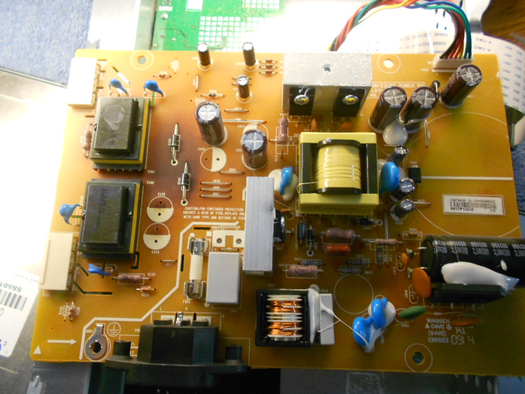

      Here's 3 pics that may help.

        I have the same board (120v)
        C123- 35v 680uf
        C122- 35v 680uf
        C124- 35v 470uf
        C125- 35v 470uf

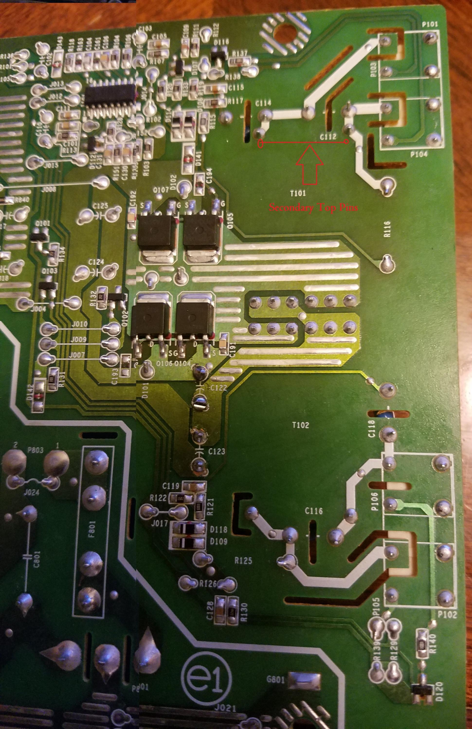

              Yes, the backlight comes on... then off.. cyclical in a sense while buzzing loud. The transformers secondary on the top transformer is 471 Ohm, the bottom is 477 Ohm
              I didn't have exact size caps, so temporarily I replaced the 2 caps in the photo. Didn't make a difference.
              Swapping the top / bottom CCFL cables, I can only do that one at a time. It seem, the buzzing is coming from the CCFL itself and not the board. Could the CCFL be buzzing?

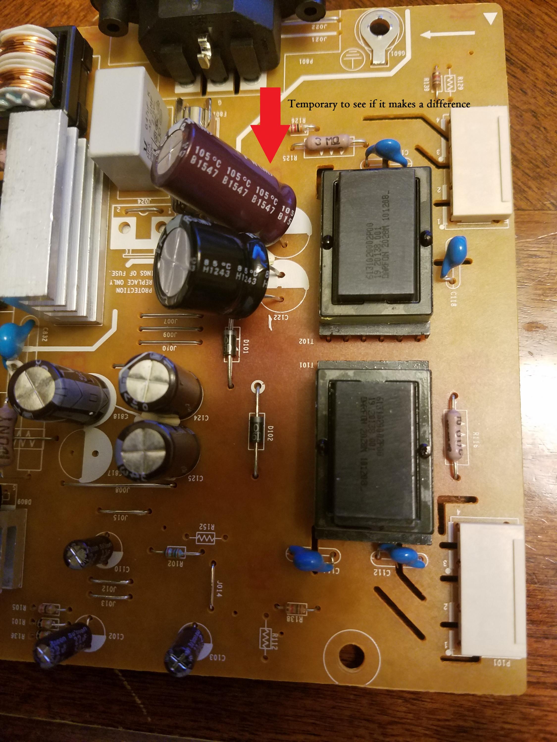

                So I opened up the panel, something I was trying to avoid, and sure enough the lower CCFLs are cracked
                Roughly they're 540 mm. Not sure if it's worth replacing or trashing the monitor. I see there are some CCFL out of China, but there are a lot of LED conversion kits. Has anyone used these? Is this the recommended path? Do I have to replace the 2 Upper CCFL with LED as well?
