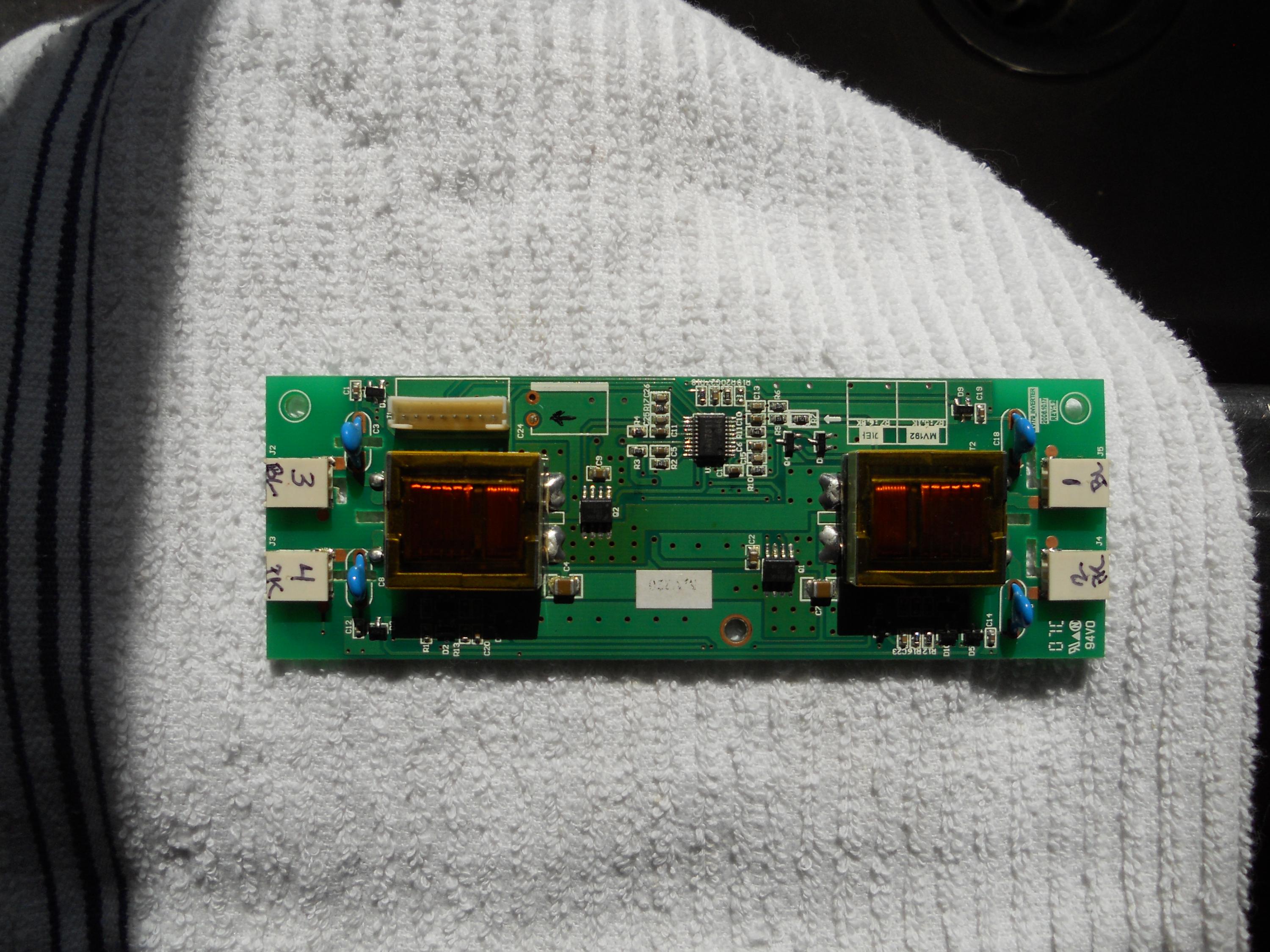

      Re: Hyvision by Megavision MV220 LCD monitor goes blank after 0.5-1 second
      I have already identified the positive & the negative capacitor terminals. On the surface of the inverter board are now two holes from which the old capacitor was desoldered & removed. The interior hole (closest to the ballast/transformer) has a blue ring around it, whereas the exterior ring (closest to the edge of the inverter board) DOES NOT have any colored ring around it. Which of these holes is for positive & which is for negative?
        You put it in the same way as the old one came out?
        The Blue Ceramic caps do not have polarity.
        As you can see in YOUR picture the stripe on the side
        faces the edge of the board so just put the new one in the same way.
        copy off YOUR picture?
          That pic is what the inverter board should look like. That pic was borrowed from a post in January 2014; a member who had an identical problem. My capacitor had burst/exploded and was non-recognizable. I'll take your advice and line it up as in the picture, but from an educational perspective, I'd still like to know the positive/negative relationship with respect to the holes in the inverter board as requested earlier.

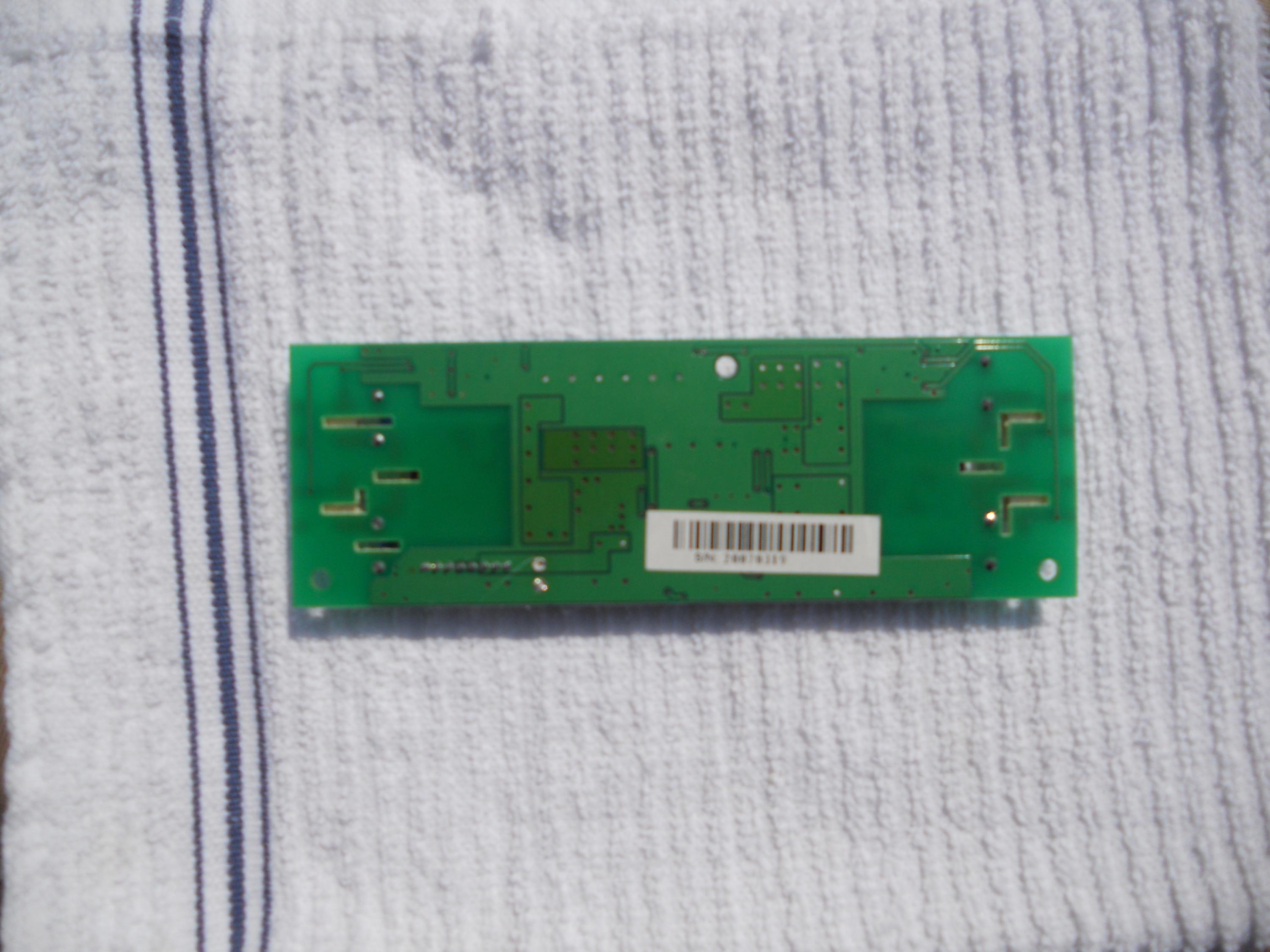

            Post pictures of the top and bottom of your board
            • bobioni
              • Jul 2014
              • 16
              Attached is a pic of my inverter board (top & bottom) with the capacitor removed. The arrow points to the inverter board hole with a blue ring around it. Which capacitor lead goes to the hole with a blue ring, positive or negative?
              Last edited by bobioni; 07-22-2014, 09:18 AM. Reason: member requested top and bottom pic
              • addytzu123
                • Mar 2013
                • 54
                • ROMANIA
                The top hole is for negative lead and the one where your arrow points is positive.
                As you can see, from the bottom, the positive lead of the capacitor is linked to pin 17 of the FAN7311 , wich is Vin.
                In a transistor circuit protected by a fuse, the transistor will always blow to protect the fuse.
                  That is correct - however if you had posted the picture with the query it could have been answered straight away.
                  See the white box where the cap is positioned, it has a broad white line down one side- That line indicates which side is negative.
