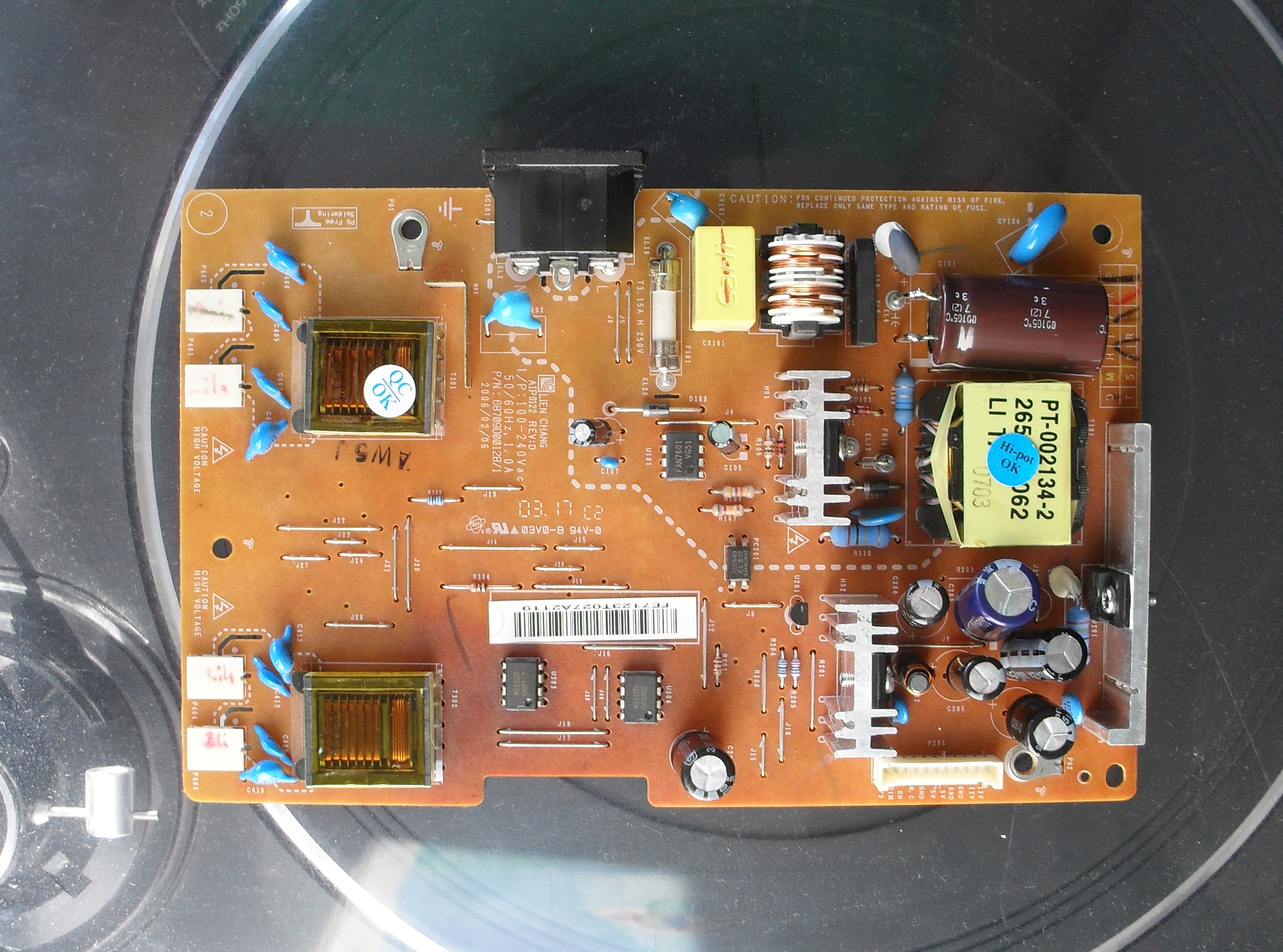

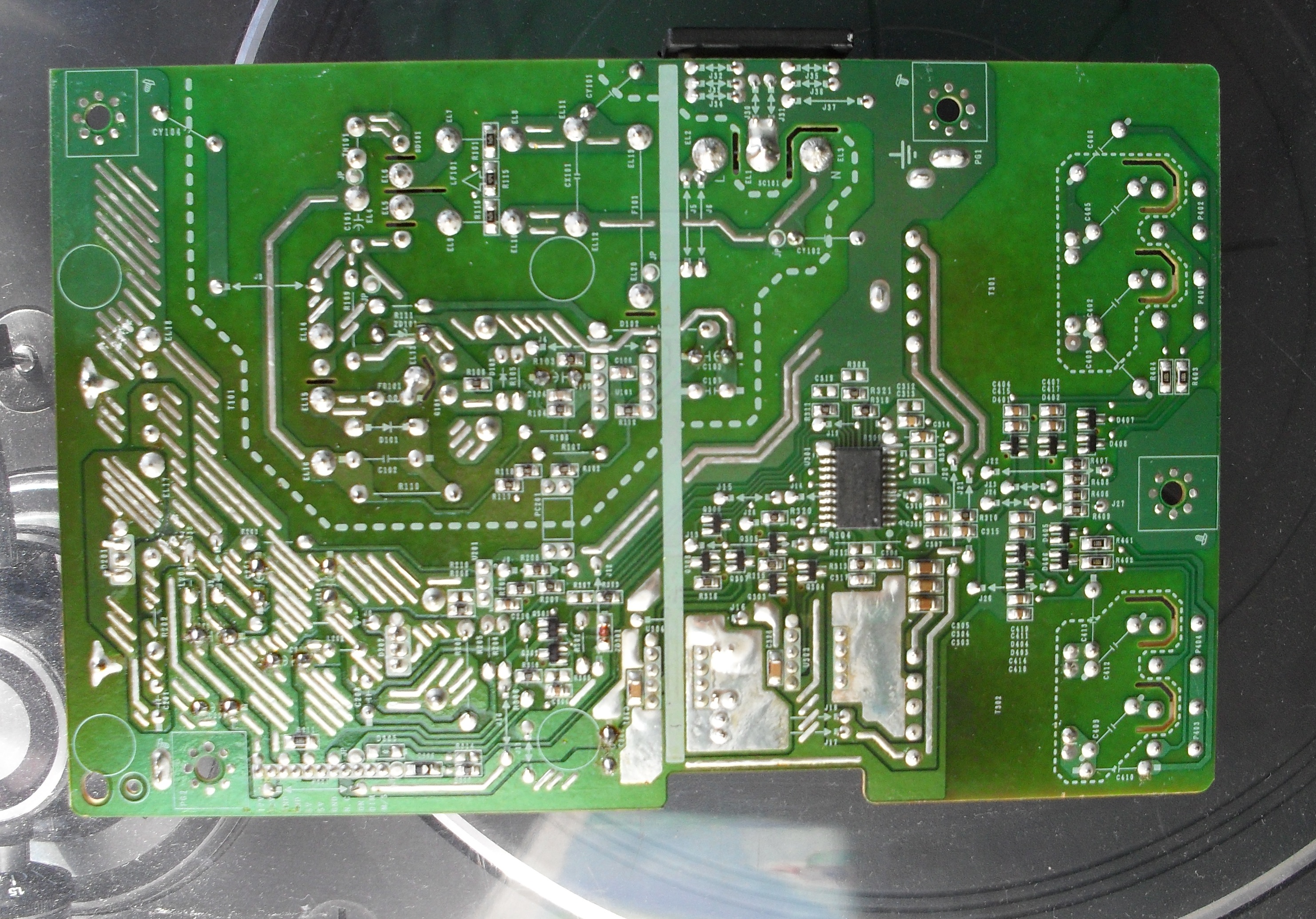

    Pictures:
    Front PSU
    Back PSU
    Any tips on how to progress would be much appreciated.

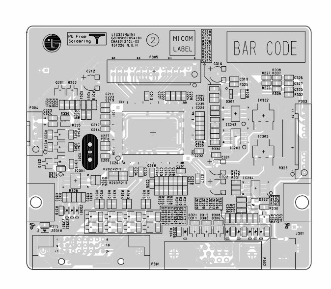

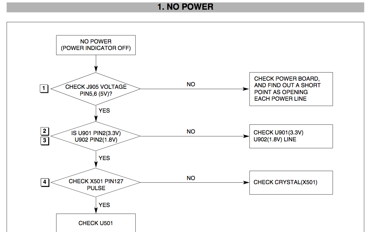

      I googled and found the service manual:
      video controller: http://tejpbit.se/temp/upload/Video_controller.png
      Error checking: http://tejpbit.se/temp/upload/video_...r_no_power.png
      Error checking number 1, 2, 3 checksout fine - But don't know how to test the crystal, just got a multimeter.

        "Still nothing from power on LED" Sinc the 5VDC feeding the logic board is present, so deeper checking on the logic board is next. There should be some 3-pin Voltage regulator ICs on the board that step the 5V down to 3.3V or 1.8V to run the processor.

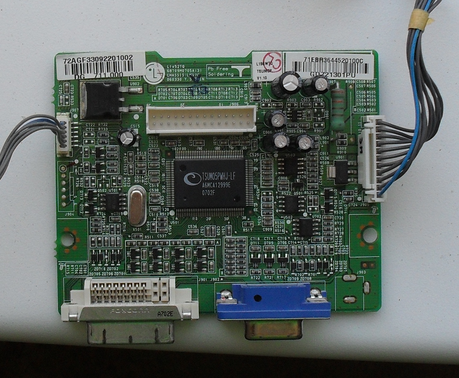

          Re: LG L196WTQ no power

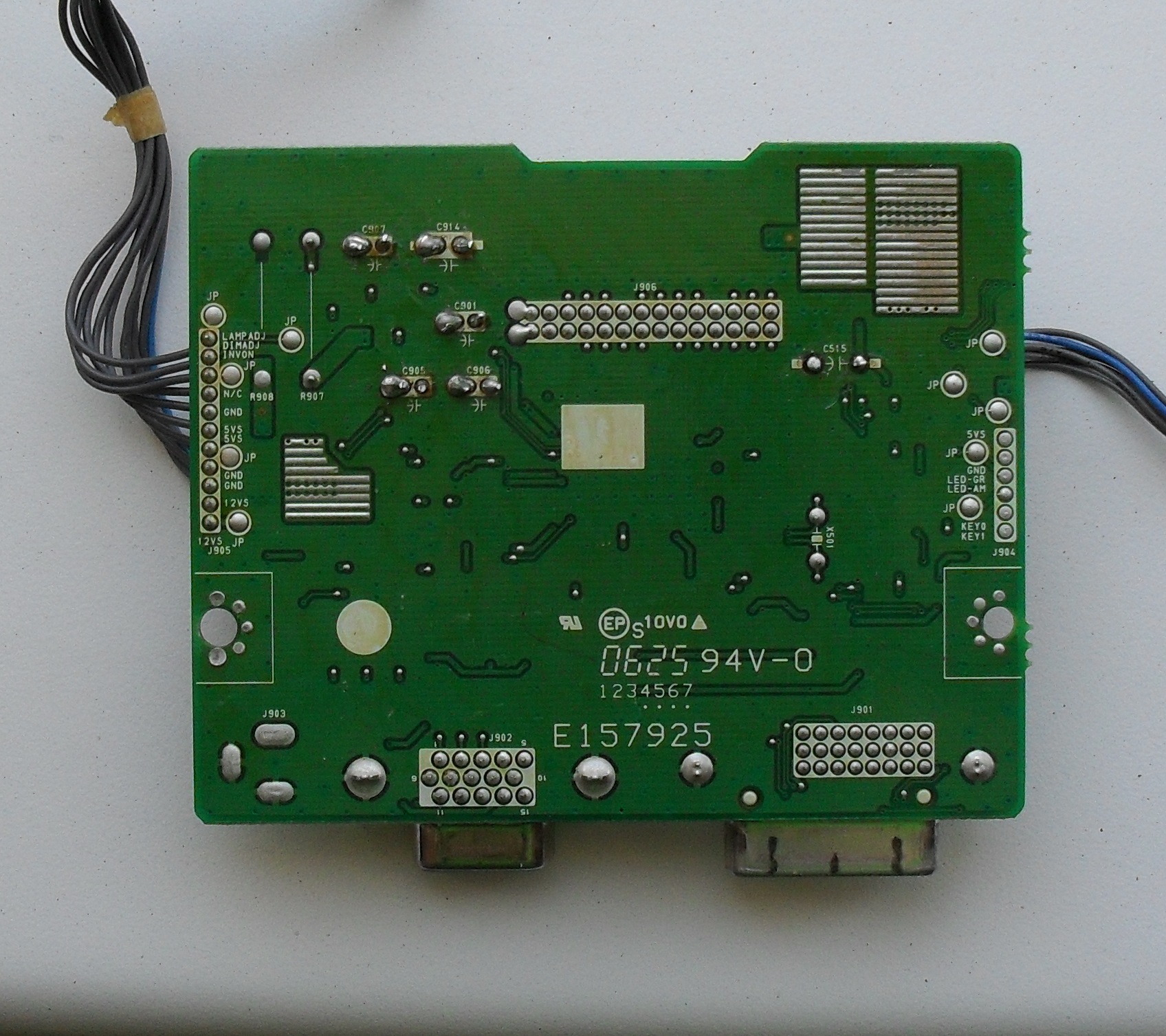

          Let me get a new picture:Logic board (ignore the badly installed cap )
          The schematics from google as posted earlier.
          checked u901 and u902 and get 3.3v and 1.8v on the output pins = ok
          Hmm, do I smell main chip failure
                That is just the PCB lay out, not the the schematic diagram of the logic board.
                  resolder D102
                    D102 on the power supply/Inverter board? That Diode is used for rectifying the aux winding of the SMPS transformer for running the SMPS IC U101 which is filtered by startup/running cap C109. He is getting steady 5V and 12V.
                      Hi.
                      I'm gratefull for every feedback possible. It's a cheap screen, but a good 2ms screen. I really want to keep it.
                      On psu:
                      Resolderd D102
                      Also diod testing gave beep on ZD101, but removing one pin and retesting proved it was alright.
                      I did another test: I took a 3v cell battery and connected it to gnd and the on pin at P201 (pin 9) and sure enough: The lcd backlight goes on perfectly and keeps on as long as the battery is connected. Nothing on screen and the poweron led is still dead even with computer connected.
                      I also rechecked the voltage going to the logicboard on p201, since I recalled I checked with logicboard disconnected.
                      With the logic board disconnected I get the 12v and 5v.
                      If it's connected I get 19v - cause for concern? 5v is still on 5v

                        • 30979
                        regardless,
                        d102 had a really bad joint at one end!

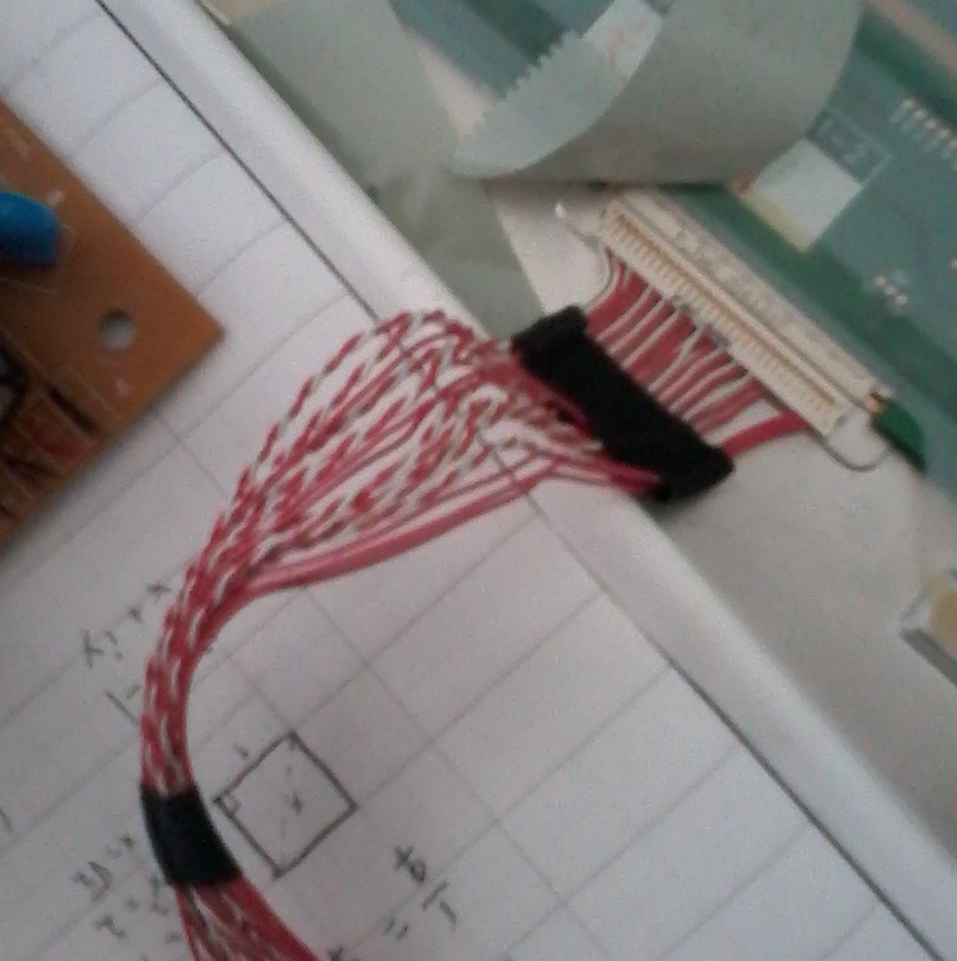

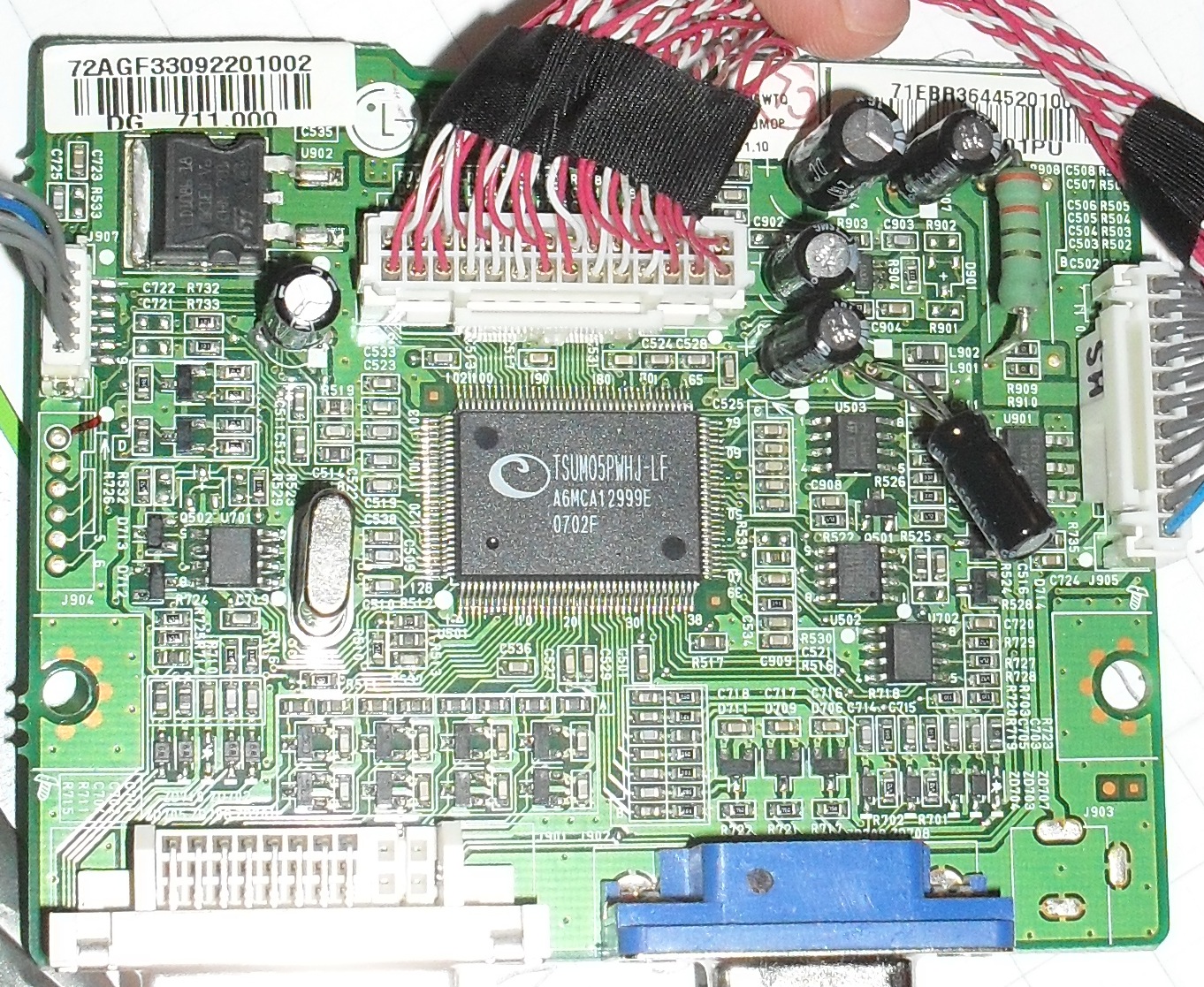

                                Can we have a good picture of the bottom of the logic board to try and trace
                                the blon circuit.
                                Have you tried with it all connected up but with the lvds lead unplugged at the logic board end.
                                Sorry for the multiple posts - I keep getting distracted then think of something else.
                                  Hi.
                                  - The cellbattery test was with the logicboard connected.
                                  - "test with lvds lead unplugged at the logic board end": Don't know the term, but I did test to disconnect the "data cable" to see if I get power then (The big flat one that goes into the lcd - see picture): No difference.
                                  - I tryed to take improved pictures of the logic board as per attachments. (Also somewhat fixed the badly installed cap )
                                    I cant trace anything much on that board - there is mention of the invon from the U501 Main processor in the manual pin 109? but cant see any diagram.
                                    Other think it does mention is 1.8v can you test the power regulator that
                                    produces the 1.8 from 5v U701? or U702?
