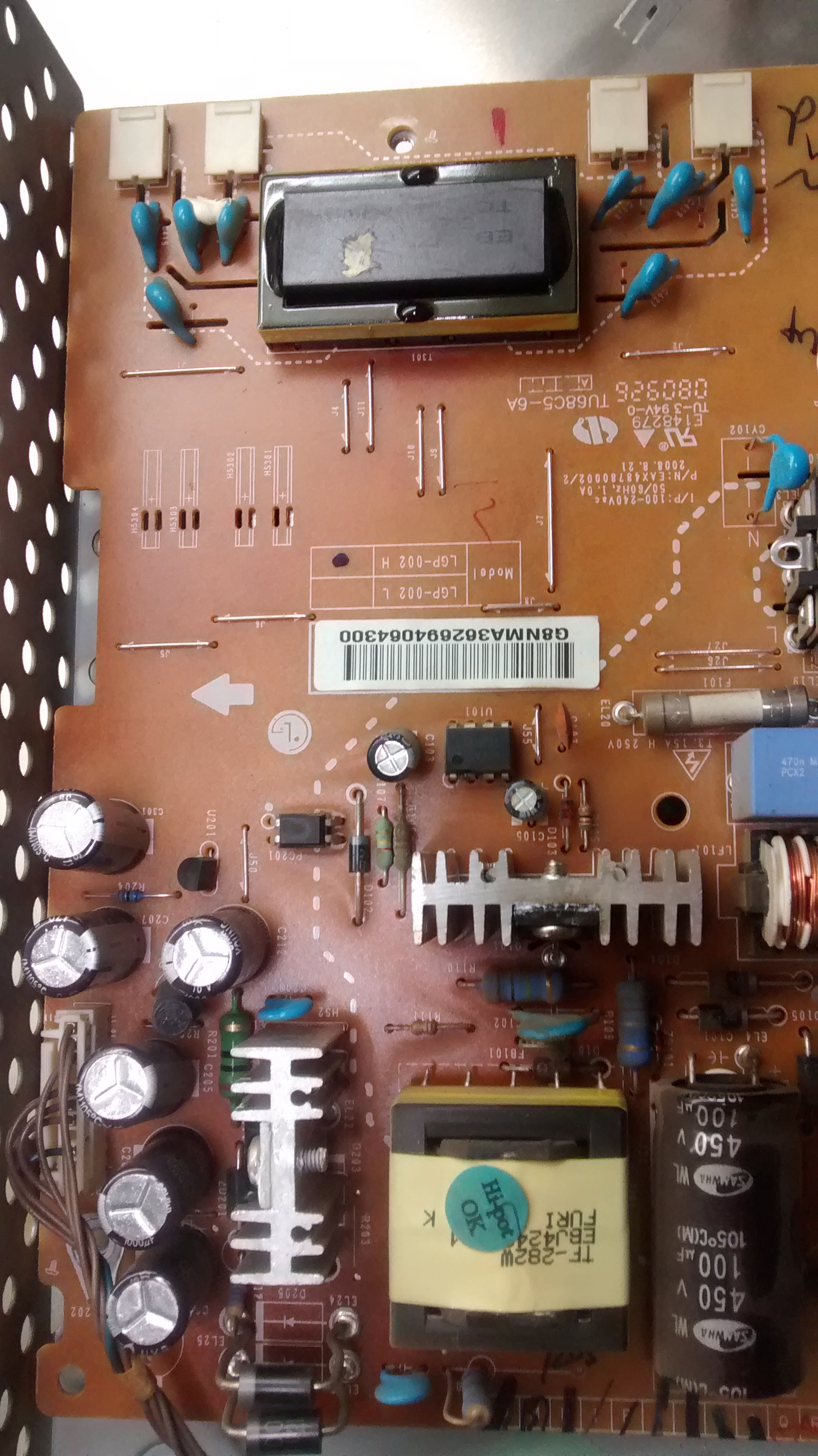

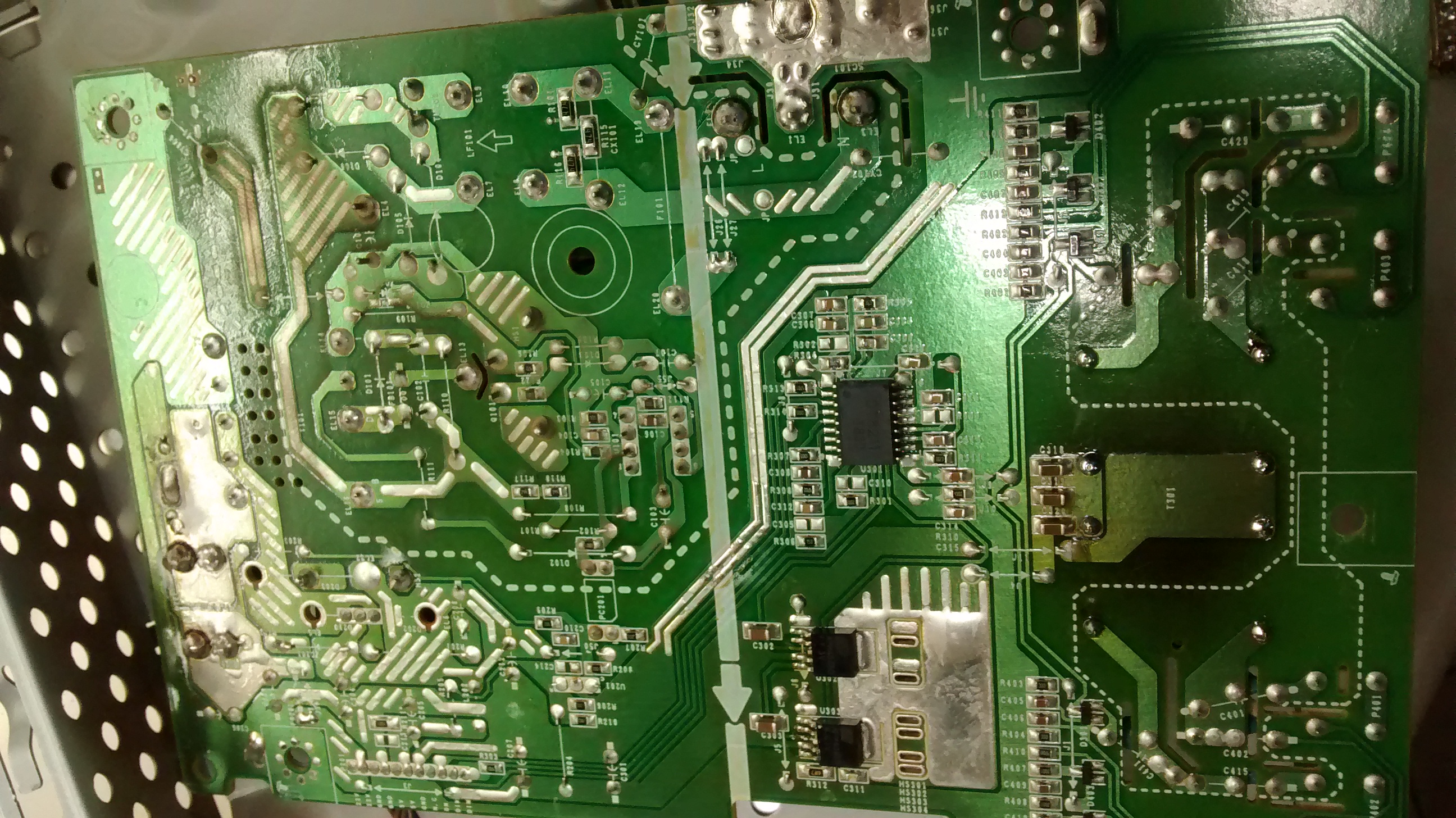

    this is my first post (and repair try) for an lcd screen except bad caps.
    I have an LG W2241S that when I turn it on it stays on for 2-4 seconds and then goes to black.
    I checked for bad caps , all seems fine, I put good lamps it does exactly the same.
    Can someone tell me where to start looking and how and what to measure.
    I am attaching a few pictures from the lcd.
    Thanks in advance.

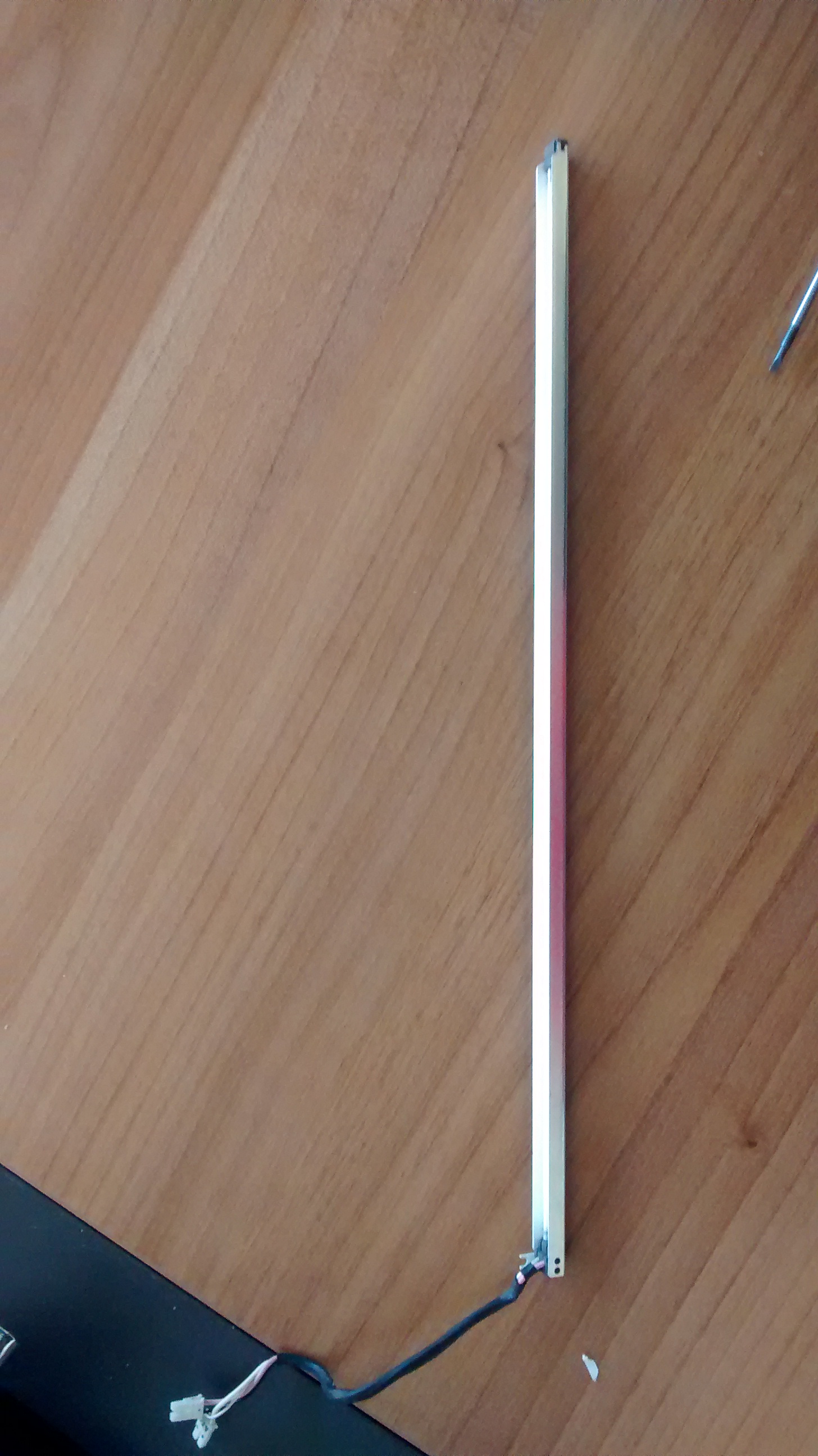

    Re: LG w2241s 2sec and then black
    P.S. I try with one new lamp at a time. Same problem.
    The transformer in the secondary winding has 1011 ohm one one side and 1024 ohm on the other side.
    Primary winding shows 000 ohm ( not open )
        I first try with two new lamps.
        Then I used one good lamp only and no second lamp.
        • bammbammfran
          • Apr 2014
          • 476
          usually not all 4 bulbs will go bad at one time , but ??
          You do need 4 working bulbs for it to stay on
          to try to figure out if it is bad bottom or bad top bulbs:
          you need to use two new lamps on the bottom two plugs and put two old top lamps into the top two plugs and try it.
          and if that does not stay on, install the two new ones into the top two plugs and the 2 used bottom ones into the bottom two plugs
          if your new bulbs do not at least flash on on the top 2 or the bottom 2 , then the transformer might be bad.
              When I say one lamp I mean one pair of lamps
              I have attached a picture.
              So I test it with 4 new lamps (2 pairs) and it does the same problem.
              • selldoor
                Slow Learner
                • Dec 2010
                • 7870

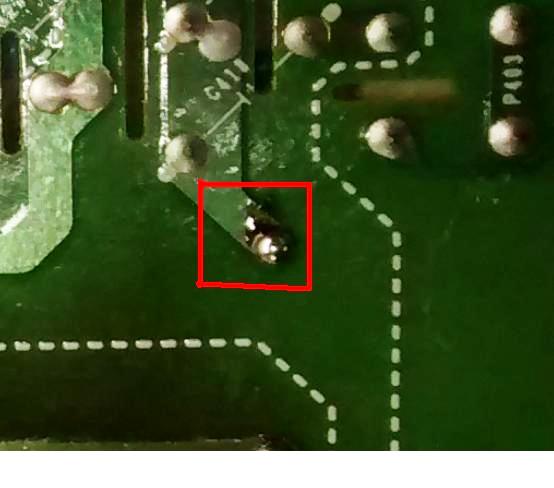

                Looking at the picture of the back of the board the soldering on at least one
                pin of the transformer looks suspect.
                As it seemed to resistance test ok I would reflow all the joints on the inverter transformer,
                and while you are in there reflow all the blue high voltage caps as well.
                  This is just soldering paste. I reflowed all the joints in transformer and in all blue caps but still the same problem

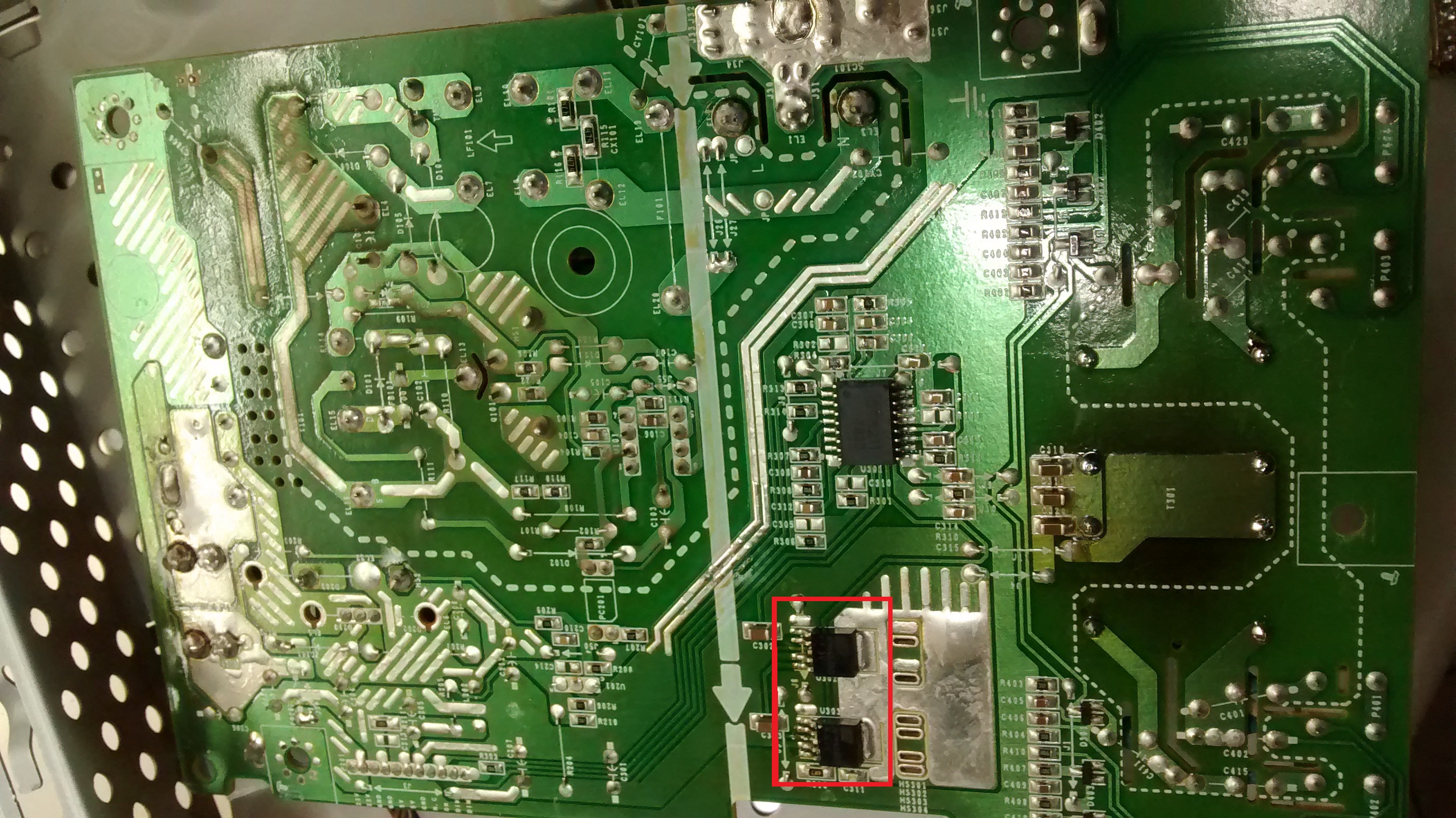

                    OK, there are two SMD Duld MOSFETS (4 legs on the bottom and big tab on top) that drive the inverter transformer, please get the numbers and look up the spec sheet.
                    • rippergr
                      • May 2014
                      • 345
                      • Ελλάδα
                      You mean those 2 MOSFETS?
                      Sorry but I am newbie
                      p.s: those mosfets are APM4048D WJC3V
                      I found that the specs are here http://www.anpec.com.tw/ashx_prod_fi...APM4048DU4.pdf
                      Can you tell me how to check?
                          Can you tell me how to test the MOSFETS?
                          Do I have to unsolder them or I can measure them on circuit?
                          • selldoor
                            Slow Learner
                            • Dec 2010
                            • 7870
                            If you have 2 seconds to black you should read this
                            https://www.badcaps.net/forum/showthread.php?t=10419
                            start at post 19. There is a section on testing mosfets.
                            First you just test them for shorts so you can do that on the board
                            with NO power to the board.
                            If you get stuck ask again - if you understand it, post your results.
                                I think it's the MOSFET.
                                I test it based on selldoor post.
                                With my multimeter on 200 ohms I checked
                                Black S1 - Red G1 = infinitive
                                Black S1 - Red D1 = sometimes increase value to infinitive , sometimes infinitive
                                Black G1 - Red D1 = infinitive
                                Black S2 - Red G2 = infinitive
                                Black S2 - Red D2 = infinitive
                                Black G2 - Red D2 = infinitive
                                The second MOSFET doesnt clearly show values . sometimes show some ohms and go to infinitive
                                • selldoor
                                  Slow Learner
                                  • Dec 2010
                                  • 7870
                                  They actually look ok to me as long as there are no readings less than 30 ohms
                                  it suggests they are ok. I will try and think of some other tests hopefully Budm will look in a again later
                                    whats the part number on the inverter transformer?
                                    • rippergr
                                      • May 2014
                                      • 345
                                      • Ελλάδα
                                      its not very clear. The numbers I see are EBJ5753( some numbers under a sticker)
                                      right under that eel-220
                                      right under TC 0844
                                      • vinceroger69
                                        • Mar 2012
                                        • 6714
                                        • uk
                                        are these numbers off the picture post 1 the black oblong transformer top off picture?
