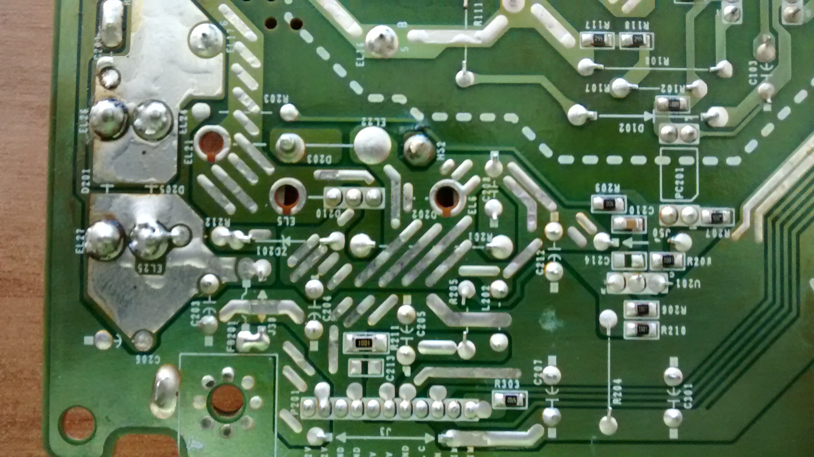

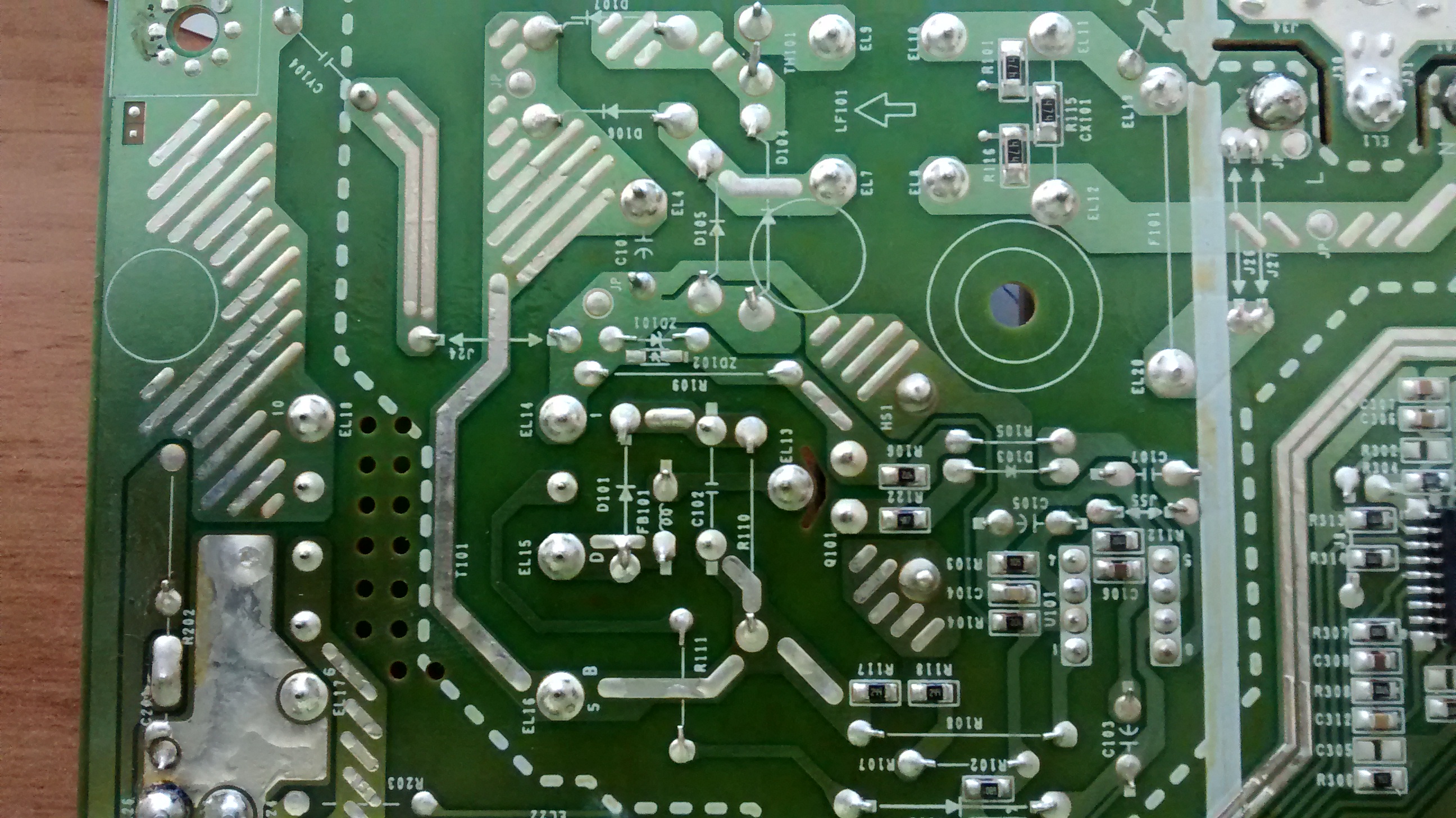

        Please can you post pictures of the bottom of the power supply again.
        Do it in two halves so we can give it a good check.
        Also dust off the top and check it for burnt components its hard to see a lot of them through the dust.
          Re: LG w2241s 2sec and then black

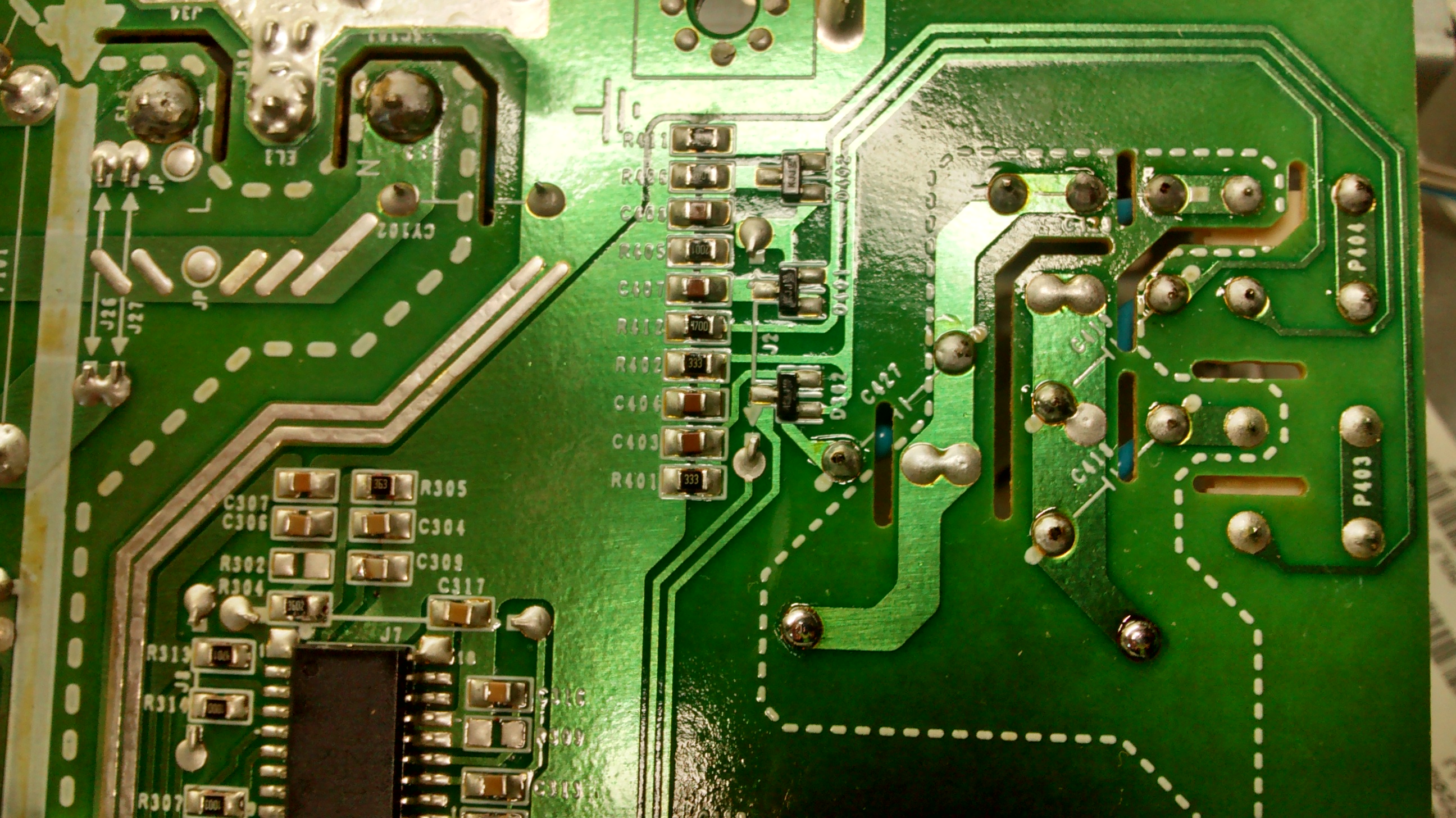

          OK, the MOSFETs seem to look OK. I notice that the board under the inverter transformer looks like it is over heated (picture #3 on post #1). Even though the resistances look OK. May be should pull the transformer and inspect the bottom side. We also need to locate the BL_ON signal line to make sure it is still present when the lamps black out just to be sure it is not control signal problem. We also need to inspect those 8 ballast caps (small blue caps by the inverter transformer).
            I am attaching bottom pictures of board near the transformer and one picture from top of the board with removed transformer.
            budm you said that the MOSFET seem ok. Those readings I have are good? I thought they should give me some readings and not infinitive in all pins.

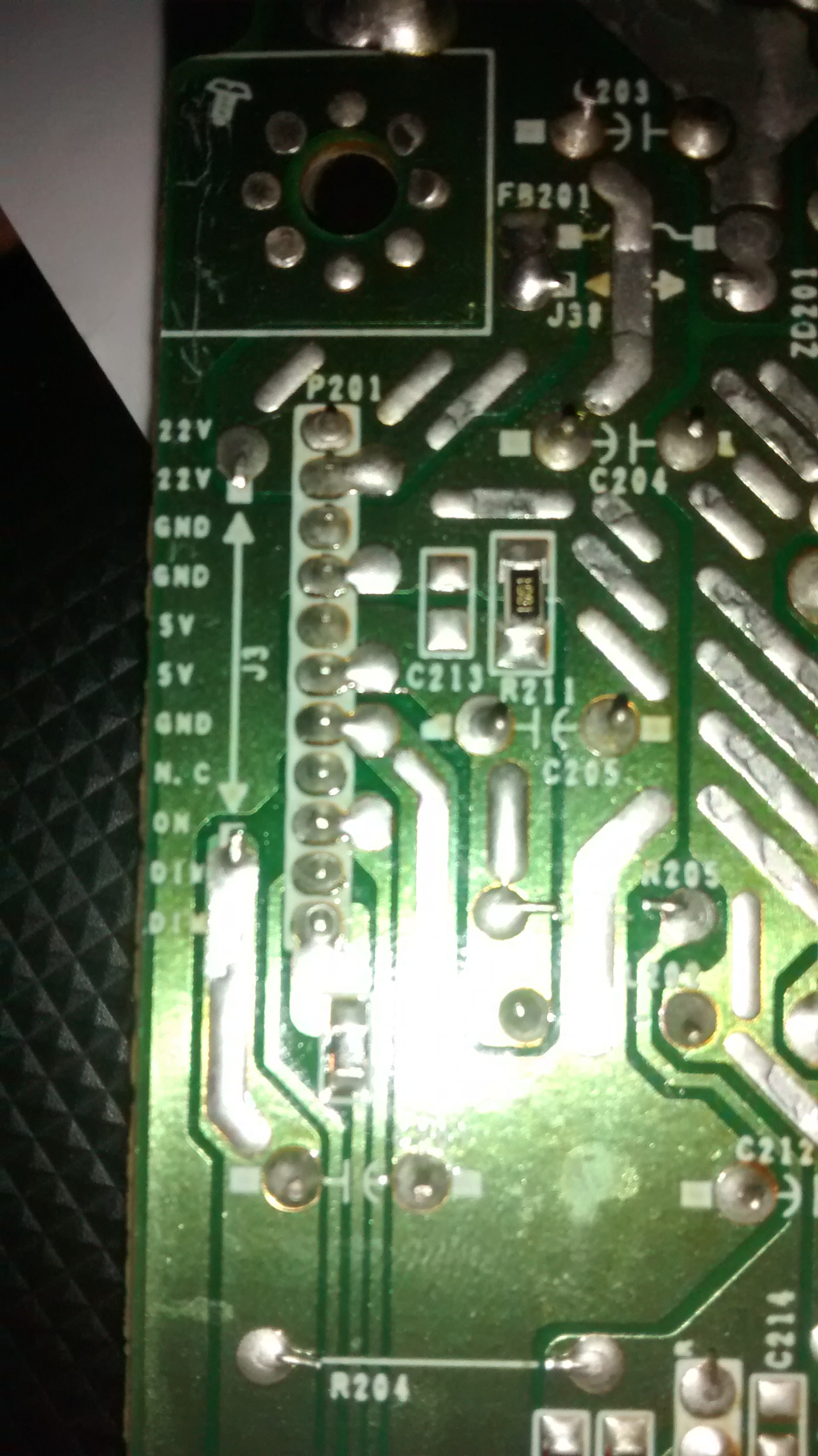

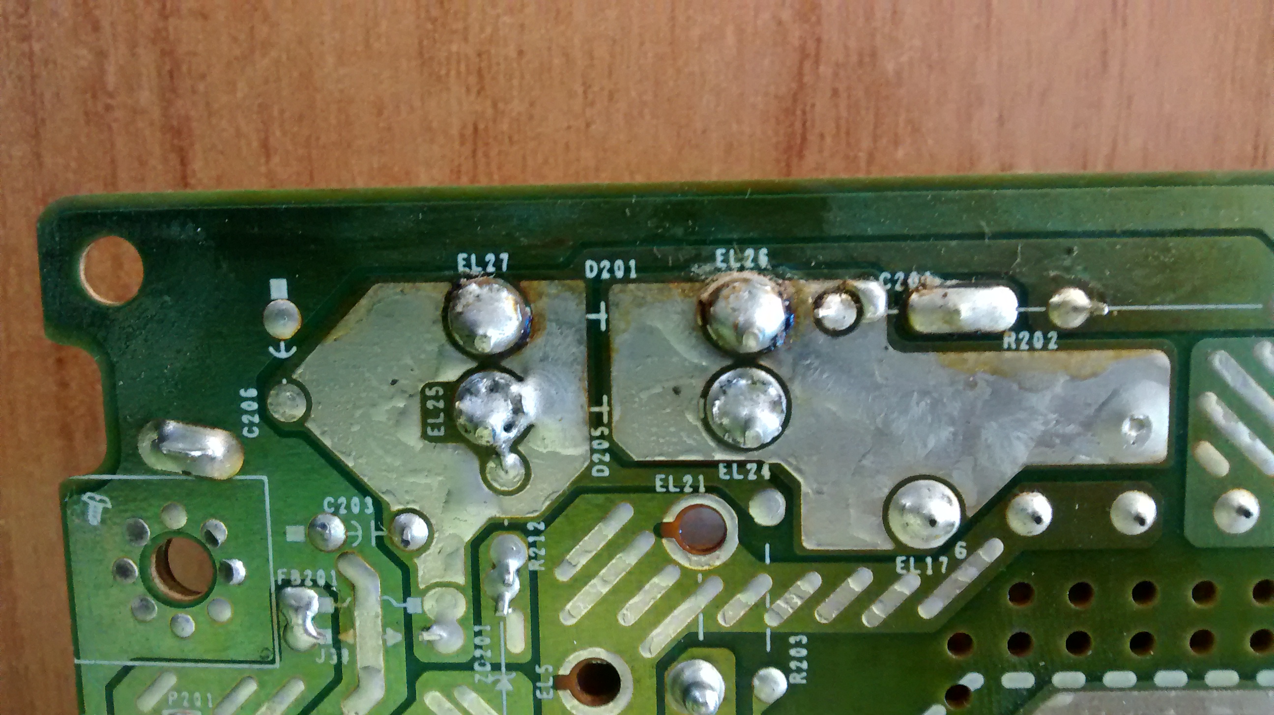

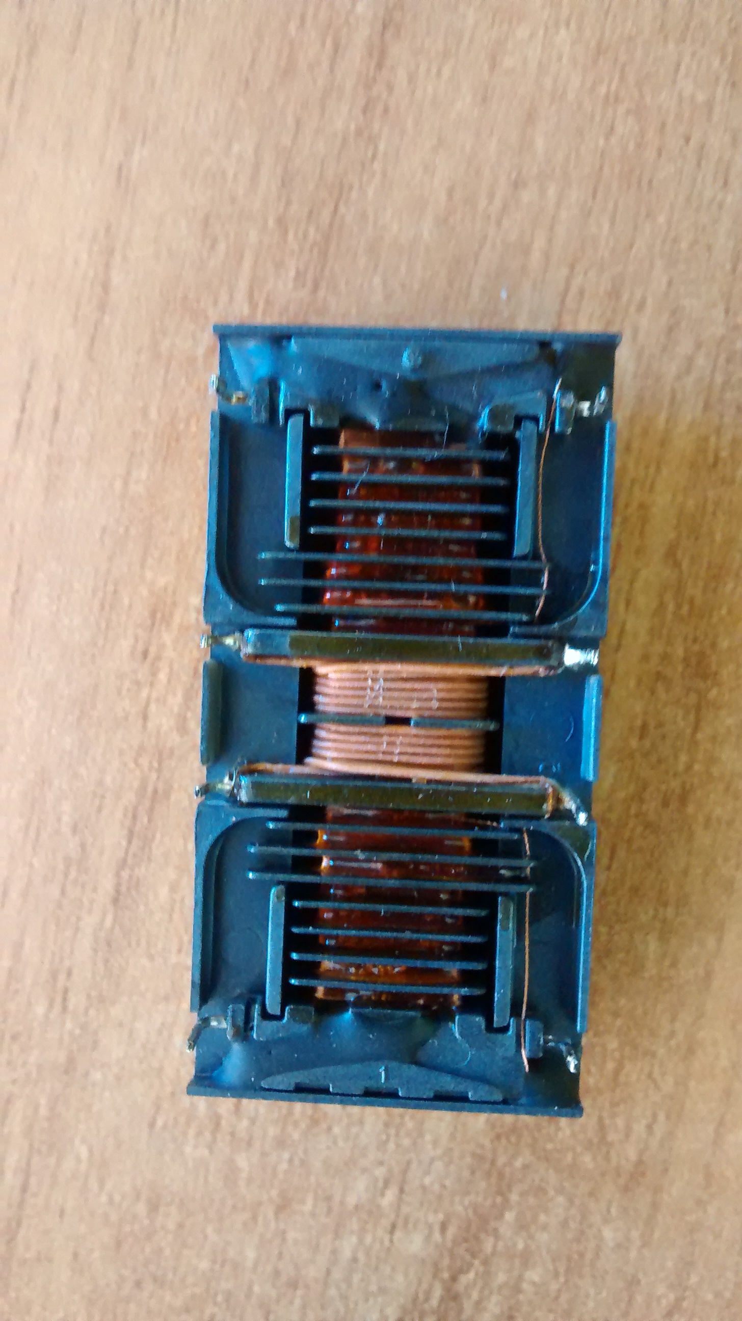

              I think budm wanted a pic of the bottom of the transformer so he could try and see why it is putting out so much heat.

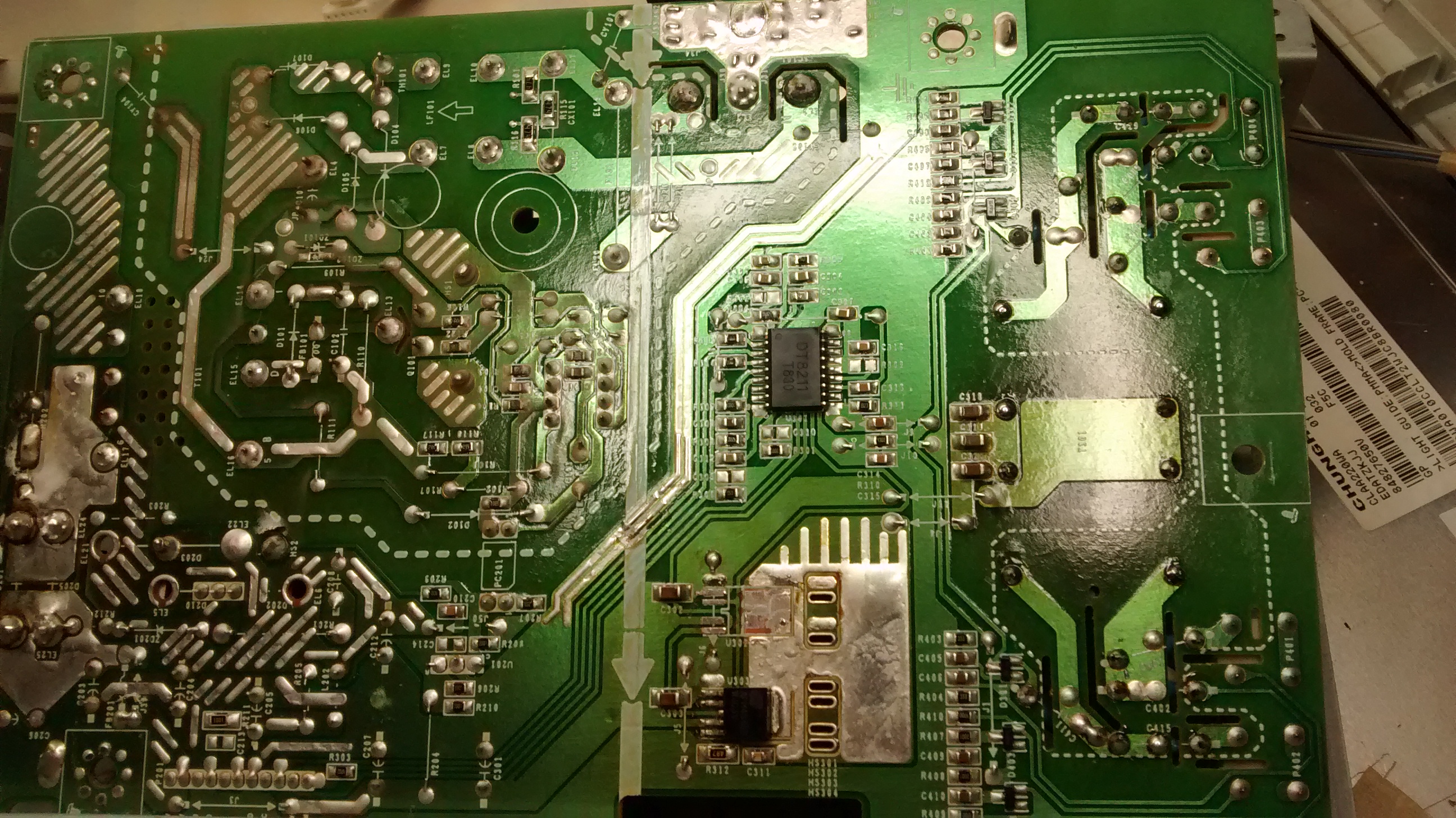

              Also can you post a good clear picture of the bottom of the board at the other end- the
              solder joints on those 2 big diodes doesnt look good. Also when you resolder can you clean off the flux (Old toothbrush and IPA ) so we can see them clearly
              BLON is a pin on that connector from Main board to Power supply. There may be a legend
              front or back on one of the boards - again if you do a close up of the back of both connectors and surrounding area budm may be able to tell you which pin it is
                Ok I am attaching the bottom of the transformer and the other end of the board where the 2 diodes are.
                I tried to clean it although I didnt resolder the diodes this was as it was from the manufacturer.
                I hope I understood correct this time

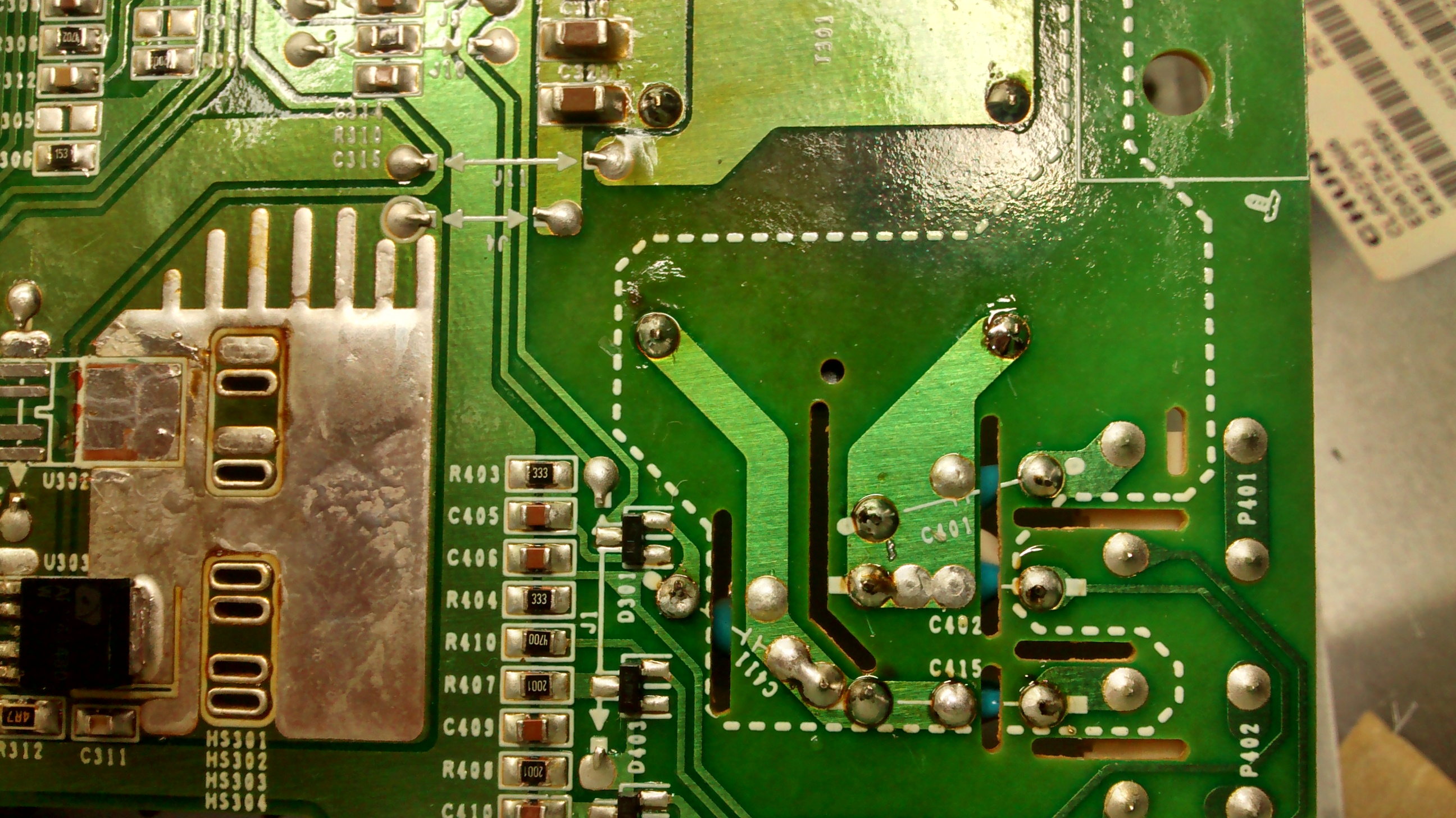

                  Partly right good one of the transformer doesnt look burnt but budm will know better.
                  Pic 2 is nearly ok but the "legend" right at the bottom has been cut off if you can do it again with it on - should say things like gnd 12v 5v and so on.
                  The other picture I wanted was the bottom side of the other board ( Main Board) where the lead from connector P201 goes to. It is on that board that the blon signal will be generated.

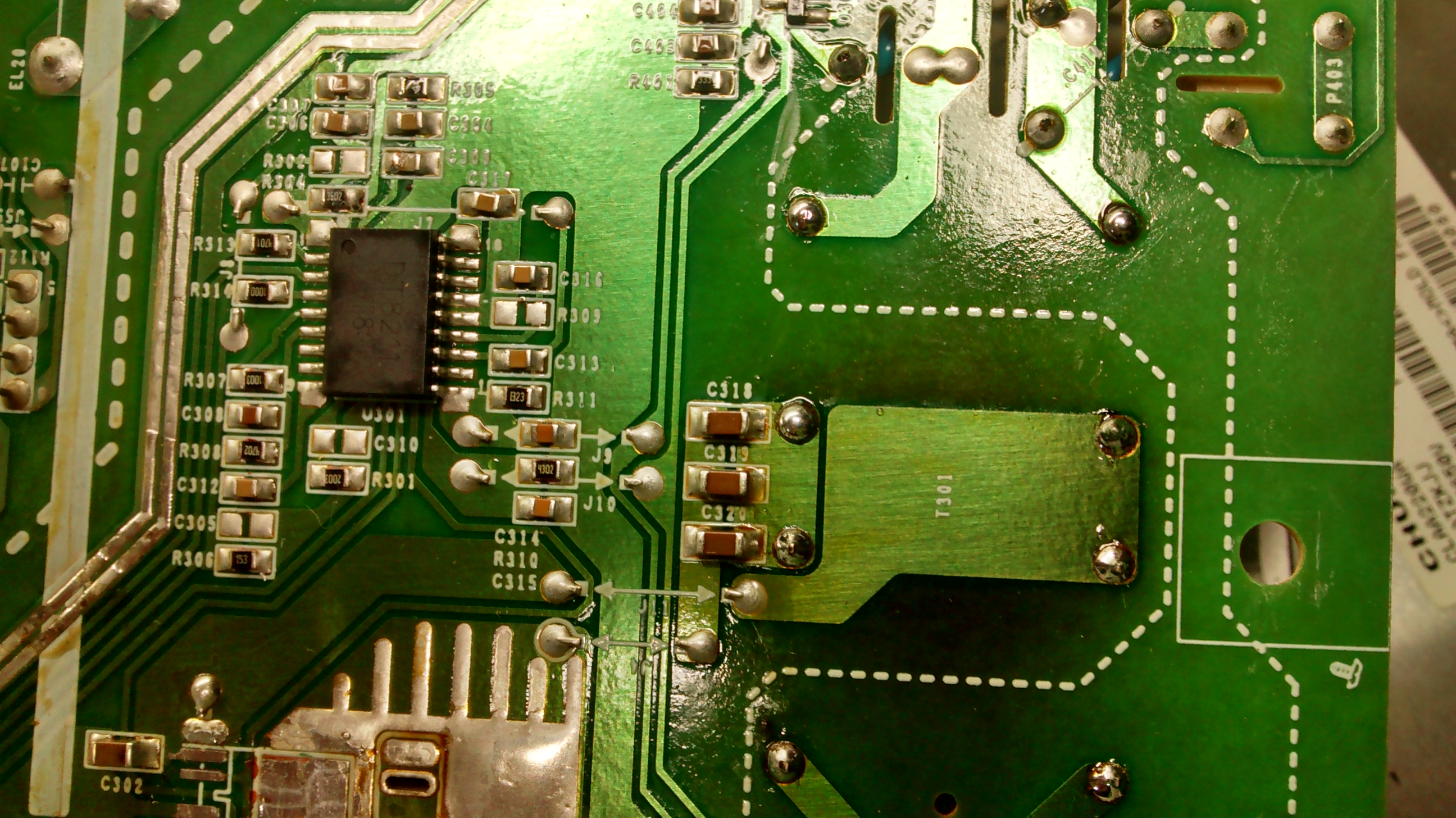

                    #29
                    Ok I think I've got it now.
                    Sending you the new pictures

                      To move on you will need to replace the transformer - pity budm didnt comment yet.

                        OK, I am surprised that the center section where the Primary winding of the transformer is, does not show any sign of over heat (may be the picture does not show well) so I cannot tell if there is problem with primary winding or not. I will wait to see what you get on the INV_ON signal.

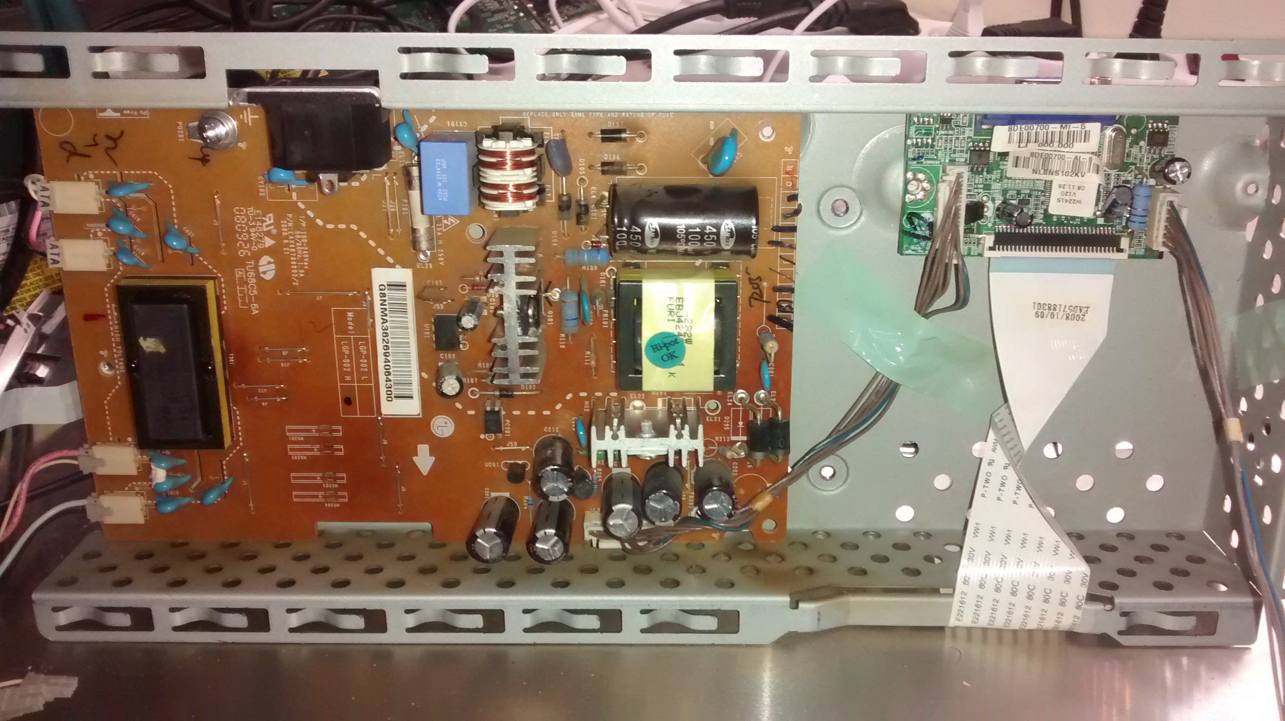

                                Ok so two more tests
                                First if you have all the boards in place can you take a pic of the whole back of the set to show the set up.
                                Test1 is to carefully take the ribbon cable that goes from the main board to the panel
                                off at the main board end. ( Careful those long thin cable clips get brittle)
                                Then try switching on again. Obviously there will be no picture but the lamps might stay on.

                                  #36
                                  Here is the picture of the whole setup.
                                  I removed the cable that goes to screen but the problem is the same. after 2-3 seconds the lamps are off.

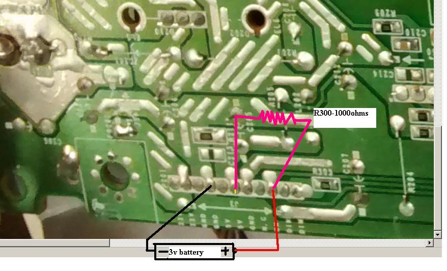

                                        Drat - gone to eat just drew you a nice pic of how to use the battery back in 30 mins
                                        • selldoor
                                          Slow Learner
                                          • Dec 2010
                                          • 7870
                                          #40
                                          OK pic adapted for resistor if lucky the resistor might just reach across the holes in the scket or if not solder a wire to one end.
                                          Nothing to measure connect it all up then disconnect the main board
                                          on the socket on the powersupply/inverter board jump pins 6 and 3 with a
                                          300-1000 ohms resistor then plug in/switch on the power to the board.
                                          Test is to see if the lights come on and stay on for say 20 seconds.
