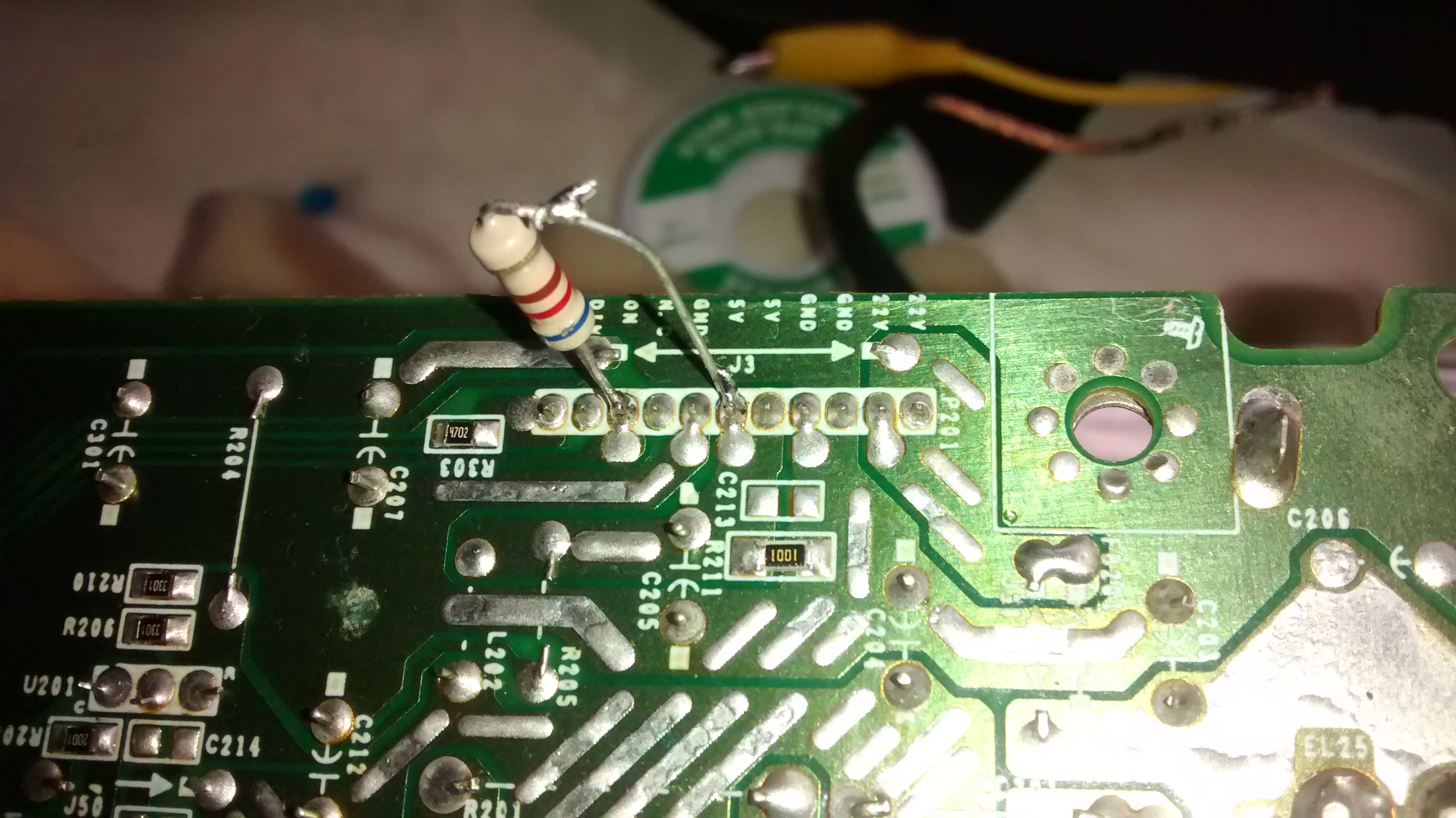

        Re: LG w2241s 2sec and then black
        So you exclude transformer , mosfet and you say that I should change all the blue caps.
        I attached a picture with the resistor just in case I did something wrong.
        I didn't put any battery.
          #44
          That looks ok - some boards also need a similar resistor across from 5v to DIM
          If you want you could move that resistor from pin 3 to DIM (Pin2) and use the battery
          from ground to pin3.
          Budm said to check the blue caps - I am not sure what he meant. Inspect them for
          cracks , bad joints and discoloration. Unless you have cap tester I dont think there
          are more tests- they dont test for resistance - at least not on my meter so I suppose you could do a resistance test to check if any were shorted.

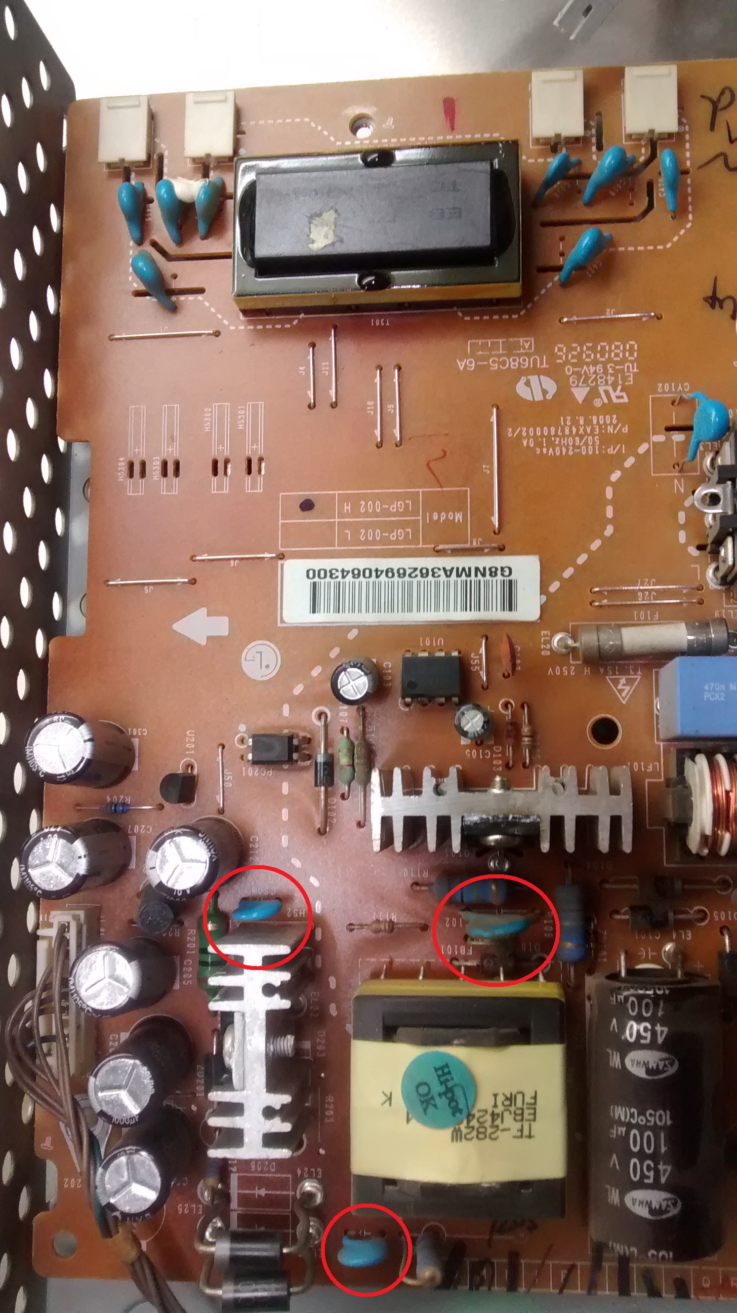

            I think I will go to hange all the blue capacitors just in case. Can you give me a picture of which capacitors should I change (all blue or just the ones near the transformer)

              Those blue ballast cap when they are bad, the body will have light tinted brown or turn black if it is really bad:http://s807.photobucket.com/user/bud...tml?sort=3&o=1
              http://s807.photobucket.com/user/bud...ml?sort=3&o=10
              What I look for is to test and see if it show any resistance reading using the highest Ohm scale, good cap with no resistance leakage will show infinite resistance, but since the meter does not put out 1000 of Volts as the cap is exposed too, this test will not be 100% verification.

                I set my multimeter to 200M ohms.
                All blue caps show infinitive except 3 (c102, c208 and c201) that are near the big capacitor that shows 01.0 and 01.1 .
                the one writes LY HR1KV 222K(C102) and the other two(c201 and c208) write HRR 102K 1KV SHM

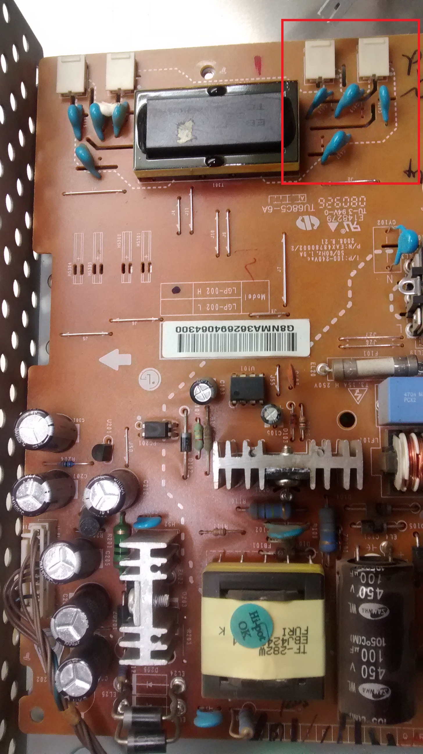

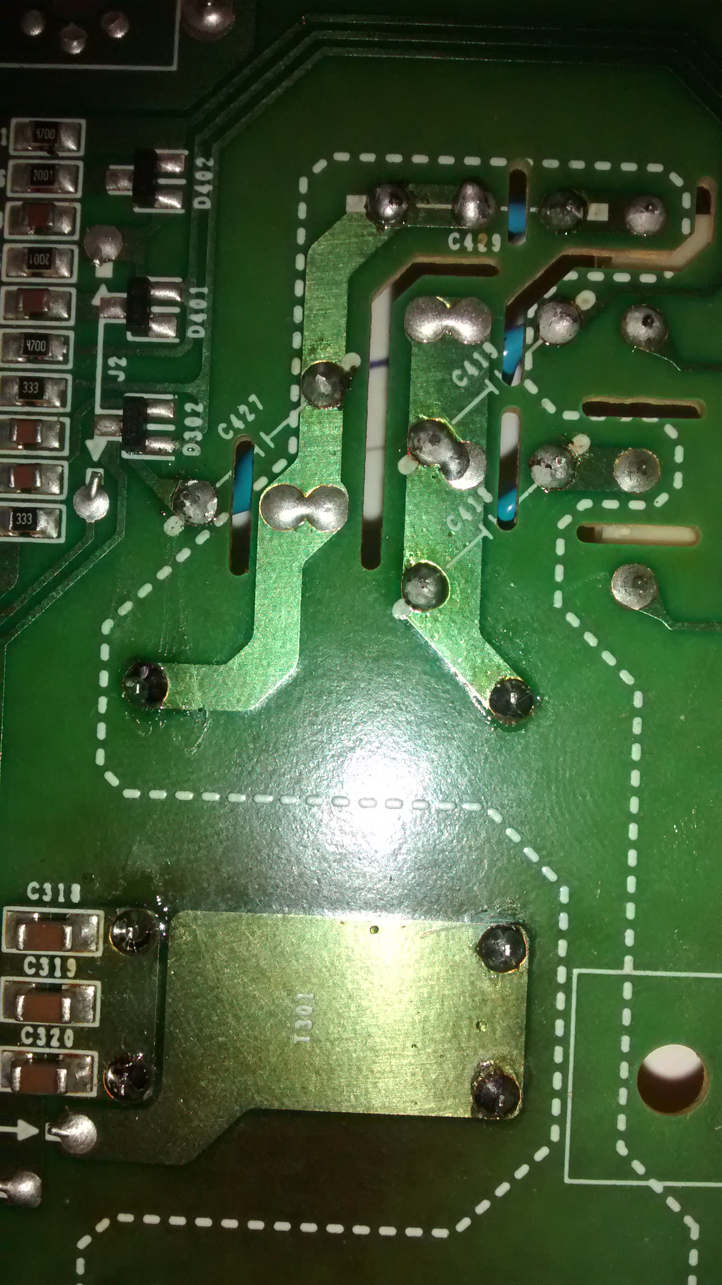

                                      Can you post a new picture of the back of the board close up of that corner

                                        I had all those blue caps resoldered when I test them, maybe some seem with black spots. It's because of the solder wick.
                                          I have been trying to draw a pic but it is too messy.
                                          First can you examine the pins in the sockets. Then do a continuity /ohms test from the actual pin to the next solder joint on the back of the board - on the end pin of the socket the next pin is close by but for the other pin the next joint is around the other side
                                          of the section on D401 and /or resistor R412. Do that for each of the 4pins - more I look at it i am not sure that is going to work - I think you can only do from the 1 and 3 pin to the blue cap joint then from the other side of the blue cap joint to the transformer pin.
                                          If nothing appears wrong then you are going to have to resolder again - perhaps removing all the solder and cleaning up the pads then applying new solder. In which case it may be worth getting some new blue caps and replacing them at the same time.
