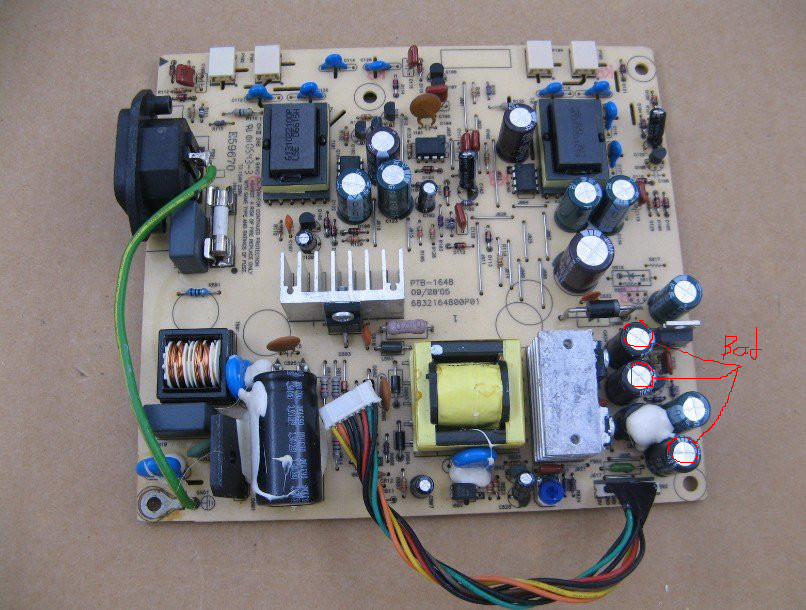

                Took it apart today. It has a PTB-1648 board, dated "9/28'05". No camera at work but found a picture on the web that looks just like the power board, right down to the date and other markings.
                There are 3 swollen caps as marked in red in the lower right quadrant of the picture. They are not fully vented, but there is just a touch of brown crap leaked from the vent seams. The big power supply cap looks OK. C824 and C822 (the two that are together) are both CapXon 1000uF 10V, C823 (the one in the lower right corner) has a big blob of the rubbery gunk on the side that has its specifications, so it is hard to read, but it also seems to be 1000uF, from the few digits sticking out of the blob, but I'm not sure at what voltage. Since it is the same size as the other 2 failed ones most likely it is also 10V. All the other caps on the board look OK. Mostly they are CapXon with a couple of Su'scon.

                  Replace all secondary side caps. Su'scon like to dry out without bloating. Monitor should work fine then.

                    replace the 2 small caps bottom-center and all 5 lower-right.

                      Did that, it works now.
