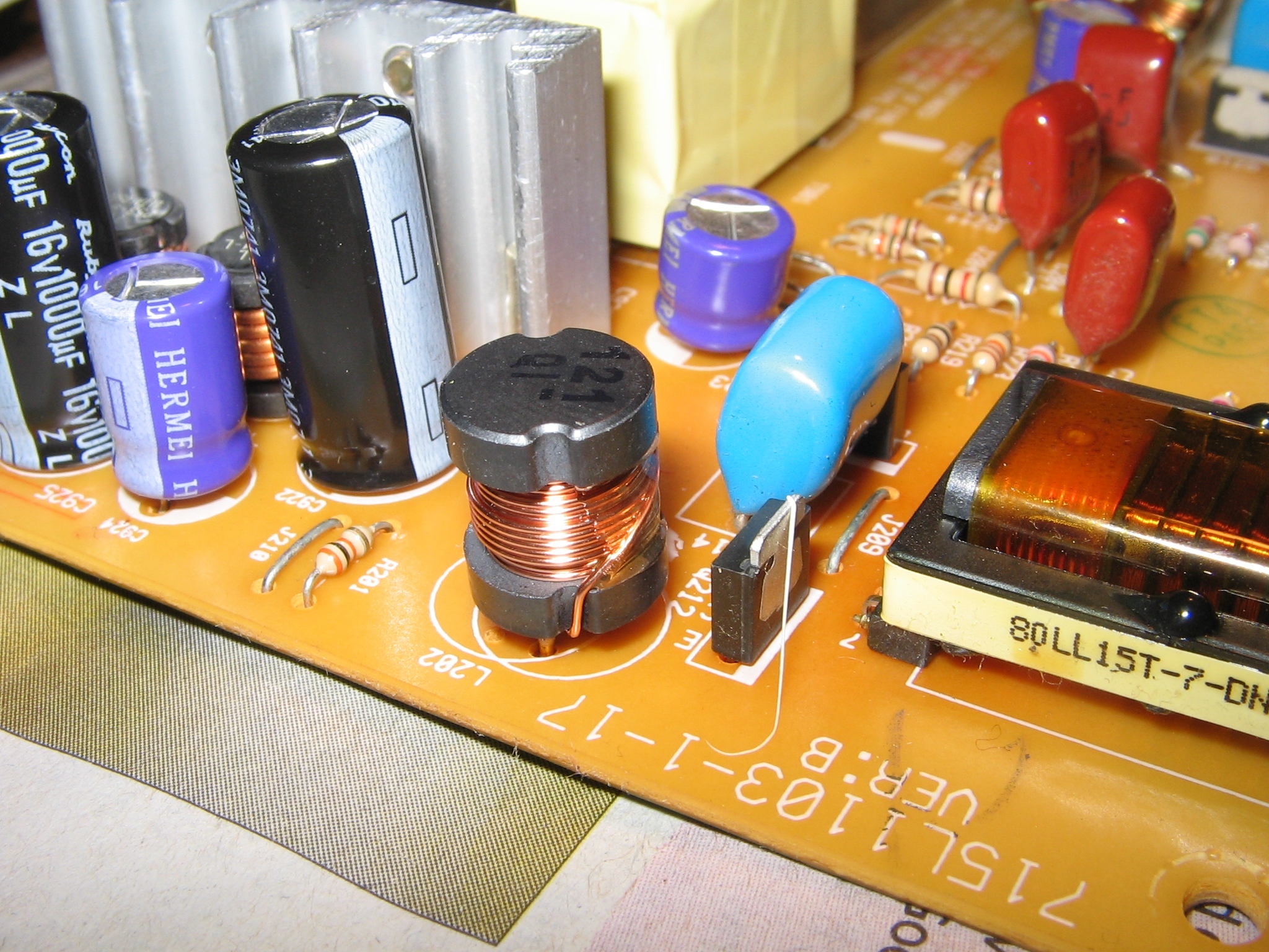

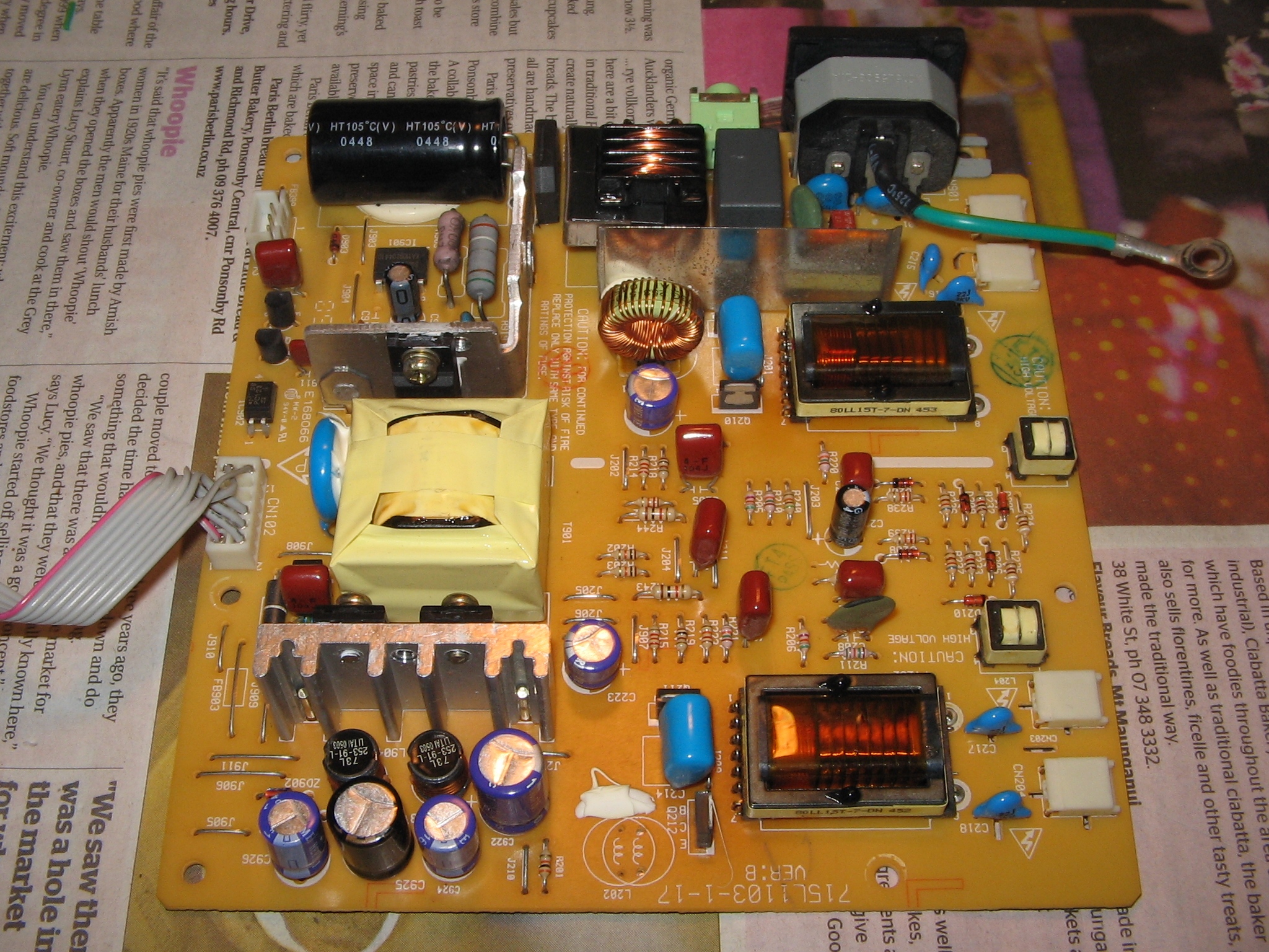

    Got this monitor free, was told it had a bad PSU, no other information.
    I tested it and it would come on then shut down. I have an AOC LM726 (https://www.badcaps.net/forum/showthread.php?t=7414) that did the same thing and it turned out to be bad caps. This one uses almost the exact same PSU (An 715L1103-1-17 Ver.B - the LM726 has 715L1103-1-C and aside from using radial coils in the inverter as opposed to toroids, they look identical) so I figured it would likely be the same thing. Wrong!
    Then I noticed that one of the (boost?) coils - L202 - in the inverter was missing. One lead was still soldered but snapped off in the hole, and the other had been cleanly pulled right out of the solder. I figured that's where I had to start...
    The schematic and BOM doesn't say anything useful but I got lucky when I contacted the coil manufacturer and gave them the part number, they told me 120uH. I measured the other coil and it was around 120uH. They also gave me the spec for DCR\current, and I found the closest matching choke at Farnell. I used a standard radial one as my other AOC also has those, although this one has toroidal ones. Figured it shouldn't make a difference.
    While I was waiting for the coil and some new capacitors (they were all Hermei trash) I checked the capacitors but found them to be all OK.
    When I got my order I put in the new coil and powered up - same problem. Then I changed all the capacitors (just in case) except the 100uF mains capacitor which tested 82uF and 0.5 Ohms and I figure is OK, but still had the same problem. I decided to check the lamps, so I tested them individually but they all came on OK and did not show pink, did not flicker and all seemed OK.
    Now, I had previously fixed a power cycling issue in another PSU by replacing the controller and the symptoms on this one were the same - all rails come up to correct voltage every time but just cycle. I found I could get new controllers (SG6841) from eBay cheaply so I bought a lot of 10. When I got those, I replaced the controller but still had the exact same problem.
    I was still suspicious about the inverter, so I did a good check through that for any obvious problems. Found some lovely dry joints on the transformers and on some resistors etc that I reflowed but again, no difference. Then I had the clever idea of removing it from the circuit entirely. I desoldered J208 which cuts power to the inverter section. But still the problem persists.
    As it stands currently, my theory is that since I get correct voltages (albeit pulsing) from the outputs, the controller, switching transistor, transformer and rectifers are probably OK, so that leaves the feedback circuits. I checked the current sense resistor on the FET and it was OK. I have started checking the secondary side parts too, starting with the through-hole parts.
    I checked ZD902 and it seemed in spec, but ZD903 was low at 4.6v - datasheet says it should be 4.9-5.1v
    I am not sure if this is due to my tester though - it uses about 100v testing voltage and the datasheet says they are tested at 1.5v, although this doesn't make sense since it's a 5v Zener - how do you test a zener at a test voltage lower than the breakdown voltage? - can anyone explain that?
    I would replace it just to see what happens but these diodes are hard to get. Exact number on eBay can be found but for ridiculous prices. Nothing with tight enough specifications is available locally, and I am not so sure the diode is bad anyway.
    I've uploaded some photos (ignore the Hermei capacitors, they were taken before I replaced them) and the service manual. Note that the schematic is not 100% exact. There is no CN902 on pin4 of the controller, and the circled parts with IC904 are replaced with a pair of transistors and some resistors. Some resistors are not the same values as on the schematic.
    EDIT: Just thought to reverse search PSU model and found another AOC SM with schematic that is correct for my monitor. See attached in the manual for model AOC 171S+
    Does anyone have an idea where to look next, and if I should worry about ZD903 or not?

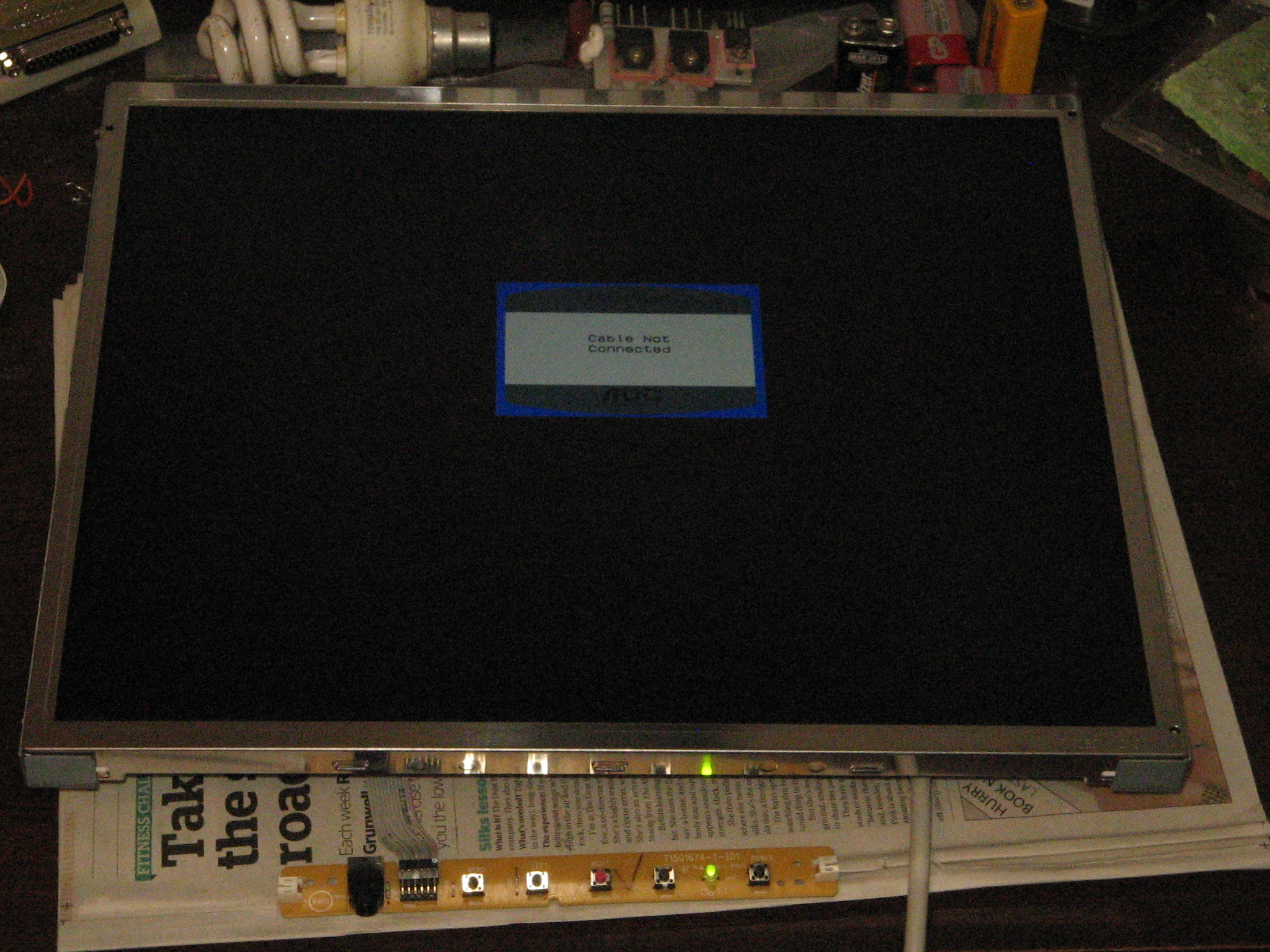

                              You might be wondering: did I try the 'Good' PSU in the 'bad' LM765 - well that's where it gets hairy. I did indeed try it, with mixed results...
                              The first time, it worked fine. The monitor came up and I got a "No signal" message bouncing around the screen. I removed power and went to get a VGA cable to hook it up to something.
                              I couldn't find a cable easily so I figured I could just use the 'no input' message as a test.
                              I powered the monitor back on, and it worked. Then, I hit the power button to try turning it off and on, to check the buttons worked etc. It turned off just fine (not immediately after pressing the button, but it did).
                              The problem is now that it won't come back on again since then.

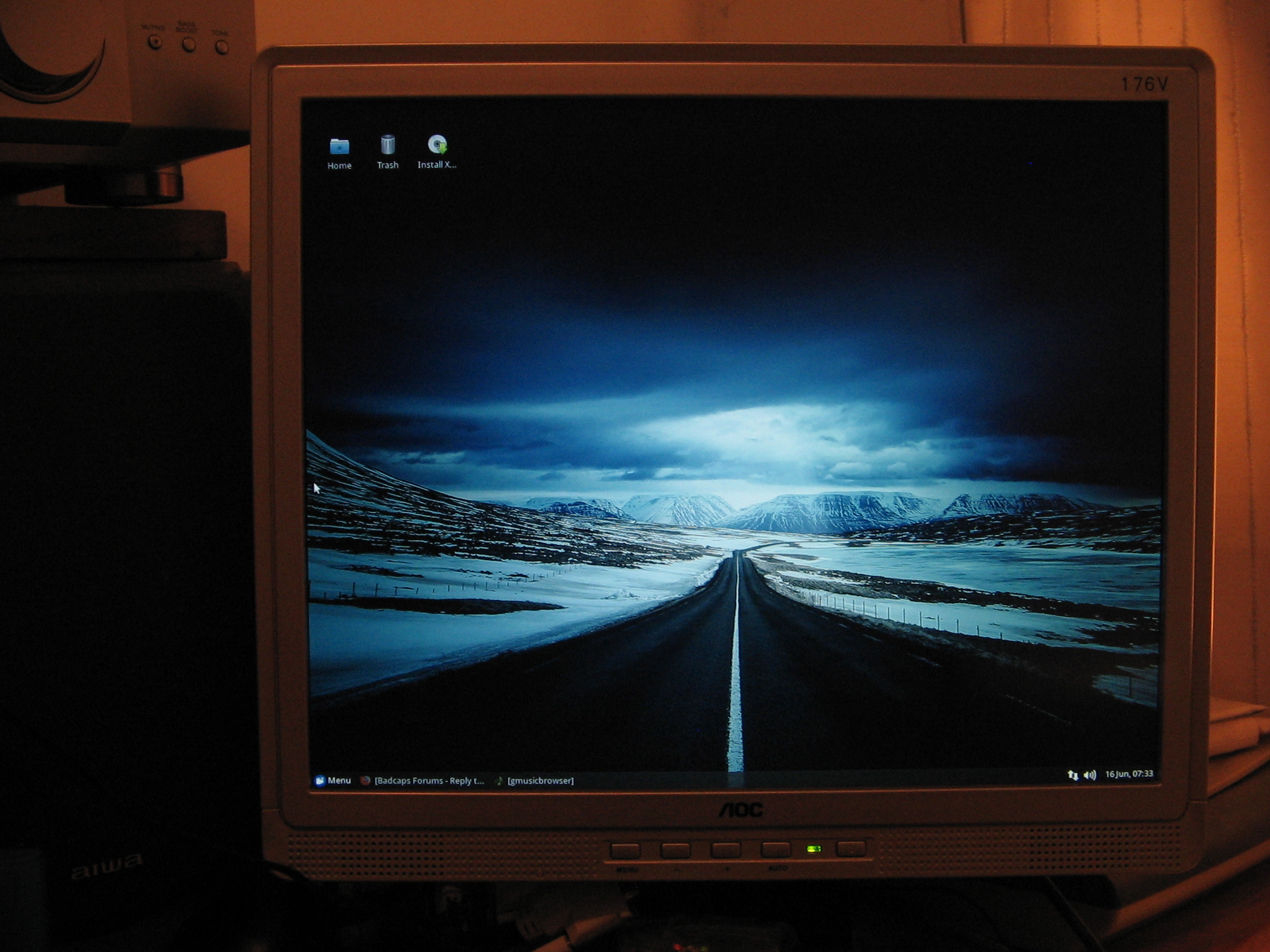

                              EDIT: Logic board is fine. Controller IC appears to have been being confused by a SHORTED(!) button on the front panel. Read 33 Ohms when not pressed!

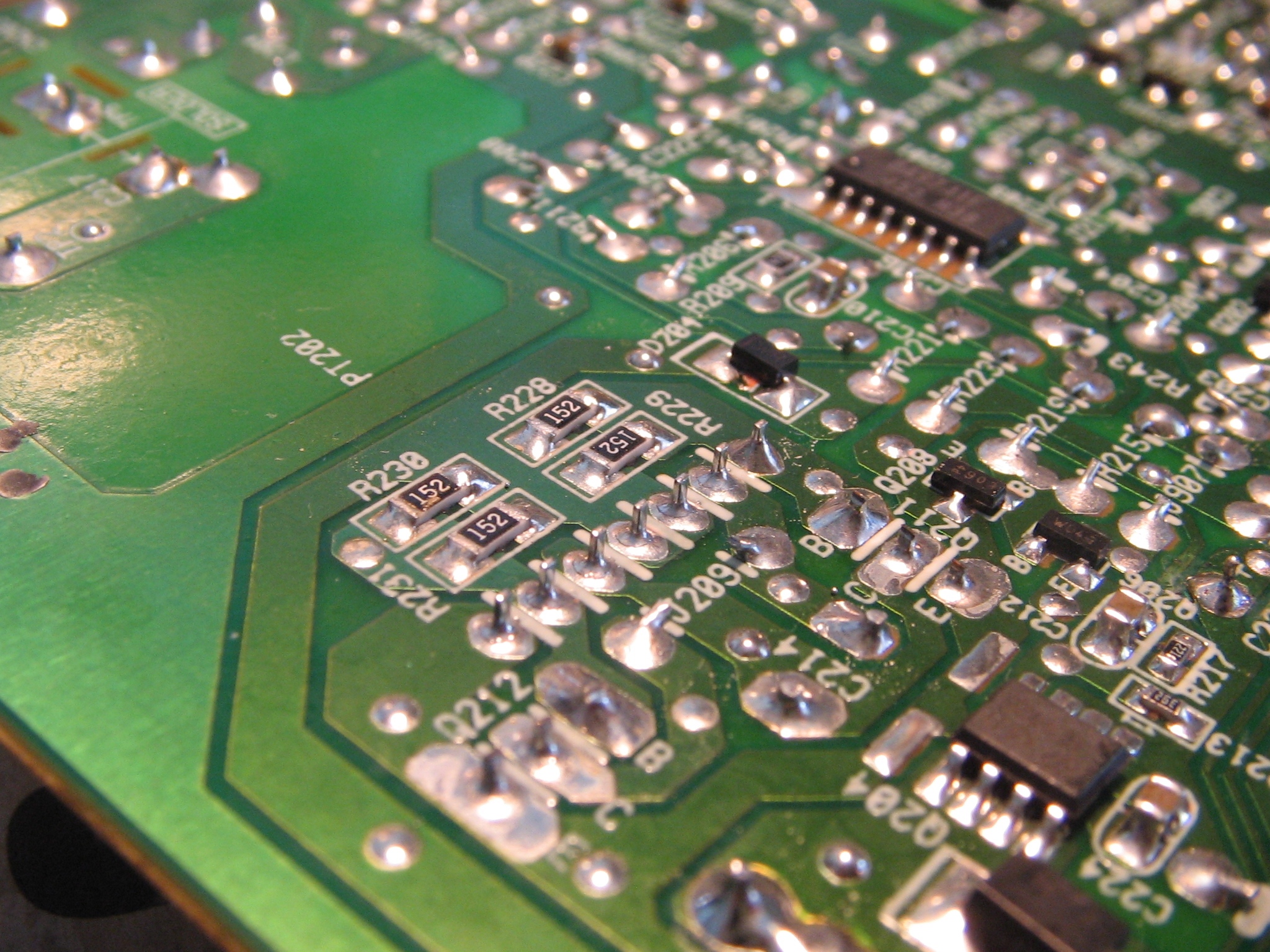

                                    Tonight, on the season finale of Agent24 vs the AOC LM765...
                                    I checked the controller IC on both boards and got the same readings on both between pins so I figured the IC is OK.
                                    Then I moved on and started checking (with diode test) the other semiconductors in the inverter circuits, with everything identical on both boards until I got to channel 1 on the 'bad' board. Q206\208 tested OK but the buck FET Q204 read lower than the other 3. D202 also read shorted, as did Q211. (2SC5706)
                                    I removed Q211 as it was the easiest to do, and found it was shorted base-emitter. I figured Q212 (another 2SC5706) was thus highly likely to be bad too and so I removed that also. It turned out to be shorted base-collector. I checked C214 just in case (as mentioned in other threads) but it was OK at 244nF.
                                    With the shorted transistors removed, I checked the FET and diode again, both now had the same reading as the others so were likely OK.
                                    The 2SC5706 was available at Farnell and RS, but both sell them only in SMD versions, so I ordered some on eBay instead. I decided in the meantime to test the inverter by swapping two transistors from the good board. I also put the substitute inductor back in. Fired up first time and it's still going over an hour later as I write this. Looks like it's a winner!
                                    I think I even have an explanation for why the transistors shorted, too.
                                    You may recall from the first post that when I originally got the monitor, it had a missing a buck inductor, L202. You may also have noticed where I said “One lead was still soldered but snapped off in the hole, and the other had been cleanly pulled right out of the solder.
                                    I think this is the key. L202 must have had a dry joint on one lead. I suspect this intermittent joint upset the circuit and caused Q211\212 to fail, either due to them going out of correct oscillation, or perhaps the controller IC was driving the buck converter badly to compensate for the intermittent inductor, resulting in voltage spikes etc. I’m sure someone else knows what is most likely to have gone wrong but in any case, I’m happy with the result.
