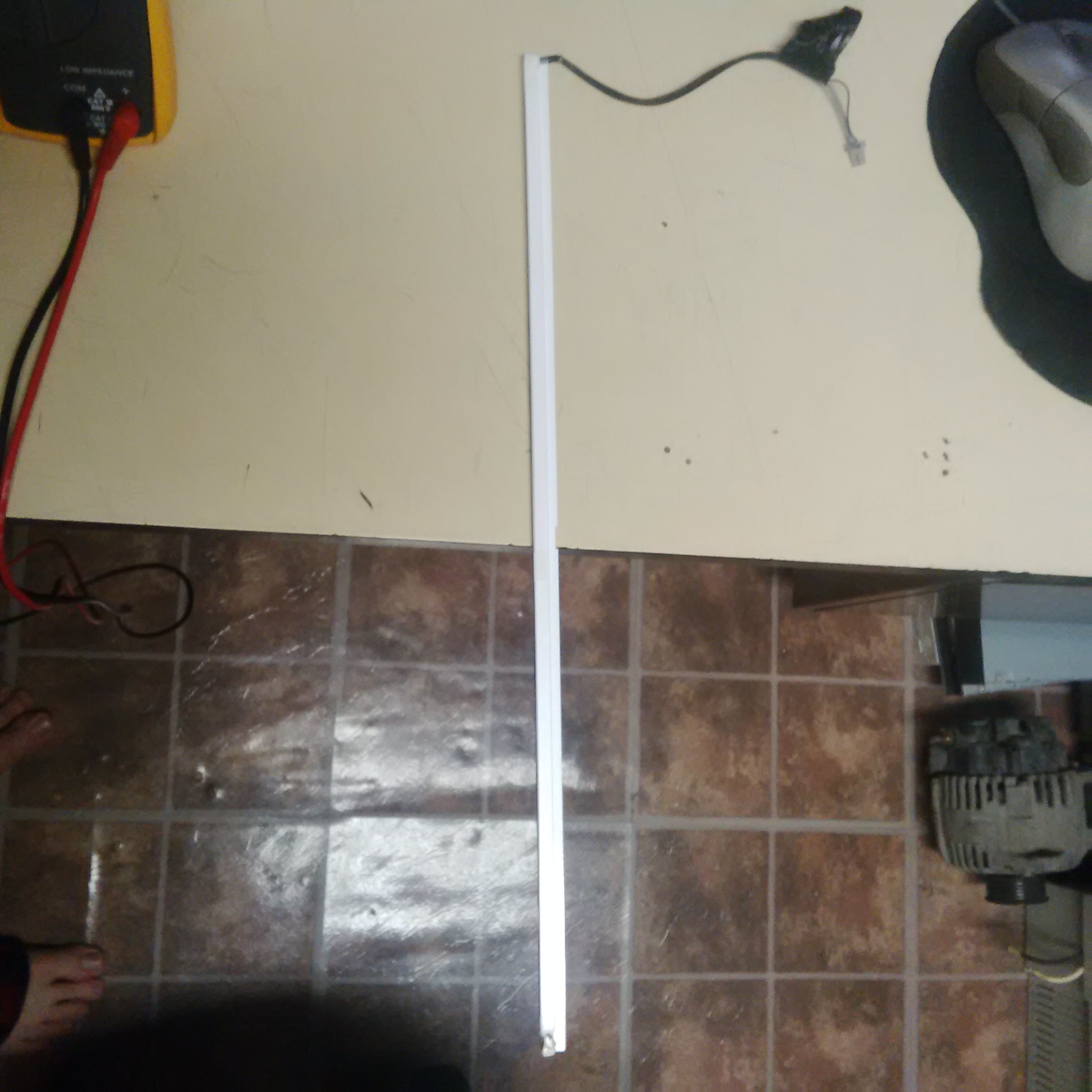

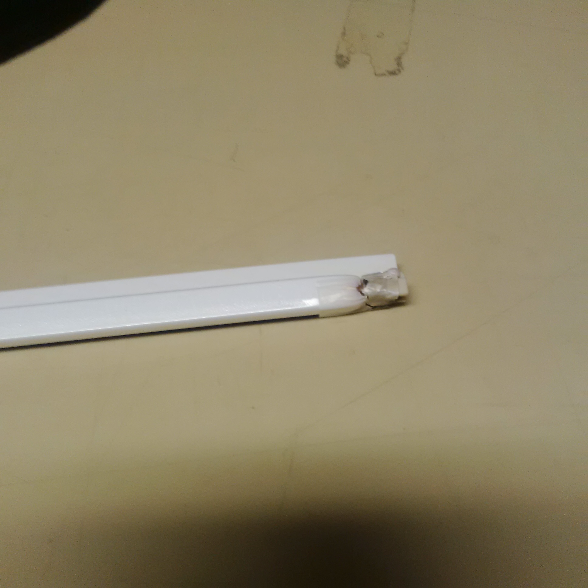

        Well I found my problem. One CCFL is toast. Now how to find a replacement. Can someone help me? It says MKE2 on the plug. Outer edge to outer edge is 16 3/4". I've attached pics.
        EDIT: I removed the melted plastic on the end of the CCFL and soldered the wire directly to the bulb. Will that cause a problem? I turned the screen on and let it run for 10 mins and I get no hissing anymore.

          Well so much for that. I put the bulbs in, dropped the case on it and broke the bulb. Well that sucks.

                I figured it was a bulb
                finding an 18 inch in the landfill might be tough since 18" isn't that popular
                you can get them on ebay on the US side for 6 bucks but ship to Canada will probably be $10
                If buying them, I would get 2 or 3
                it's probably a 2.6mm one

                    Double check your length of the actual glass.
                    that ad says 414mm and I thought that you said yours were 16.75" which would be more like 425
                    a standard format 19" I believe is around 15.5
                    shorter can work in a pinch but you will have to reroute the wires straight off of the bulb instead of 90degrees out of the bulb and you may have to trim the silicone caps

                      Mine's an 18.5. Bulb measures outer edge to outer edge is 16 3/4"

                        an old style 19" wide screen is close to that if you are measuring the screen
                        You should measure the actual bulb

                          I edited it after you posted. The bulb measures outer edge to outer edge is 16 3/4" including connector.

                            ok, so you must have a wide screen and the 19 wide screen should work
                            FYI: when ordering bulbs, you measure the actual glass of the bulb
