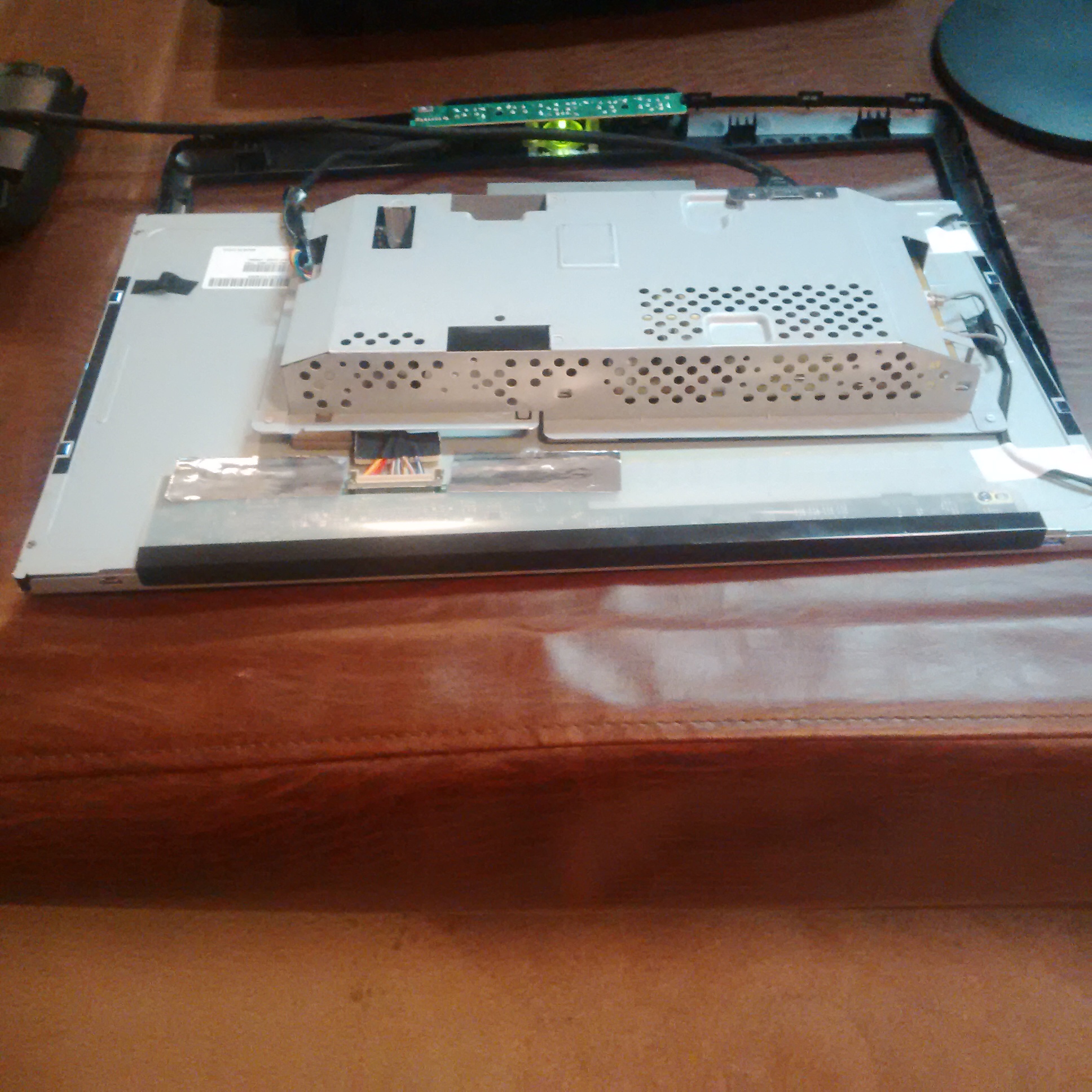

    I have been reading on here about the 2 second then black. I tore this unit apart. Replaced the caps. Resoldered a lot of joints. When I put it back together it seems to be working ok but I get a small hum from the display on the top corner by the T-Con, or at least I think it's a T-Con. This normal or should I be looking at something else.

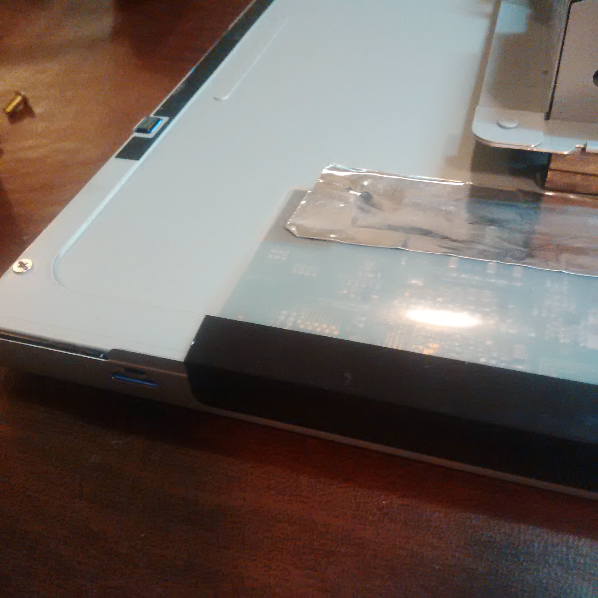

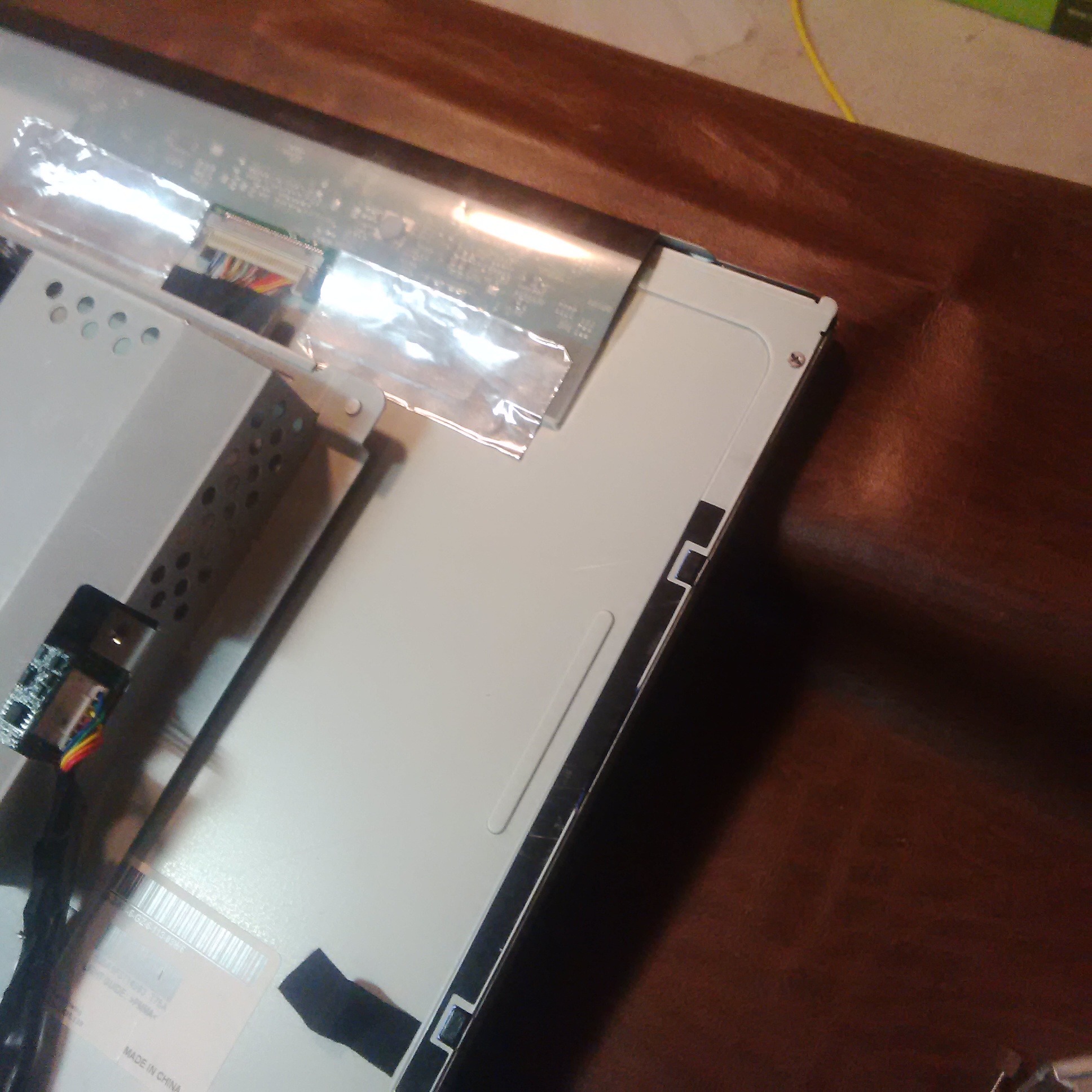

        Re: EMachines E183HV
        Here's the pics I took today. The hissing noise, almost like air coming out of tire, is coming from the panel on the top left (facing the screen). There is only smd caps on the board that connects to the panel but I could replace those if needed. Thanks in advance.
          o.k.
          when it's hissing, can you smell ozone?
          like using an ioniser?
          because hissing is usually high-voltage arcing.
          if it is - you need to inspect the tube ends and wiring on them.
          hissing is not the same as hum - it's a much higher frequency.

              just an idea,
              if it will run with the invertor or tubes unplugged,
              try it - if the hissing stops - you have the answer.
                    When I have the panel apart and smell the hissing area, it does have a small odor. Now when I did connect it back up I might have mixed up CN801 and CN802. The cables to the backlight. When I have it connected one way I get emachines for 2 seconds then black then 2 seconds with cable not connected then black. When I have the CN cables reversed I get constant picture but the hissing noise.
                    I checked all the caps and they are good. It's actually doing the same thing as it was before I changed the caps. I metered the old ones and they were working.
                    The hissing is coming from the backlight no the screen.

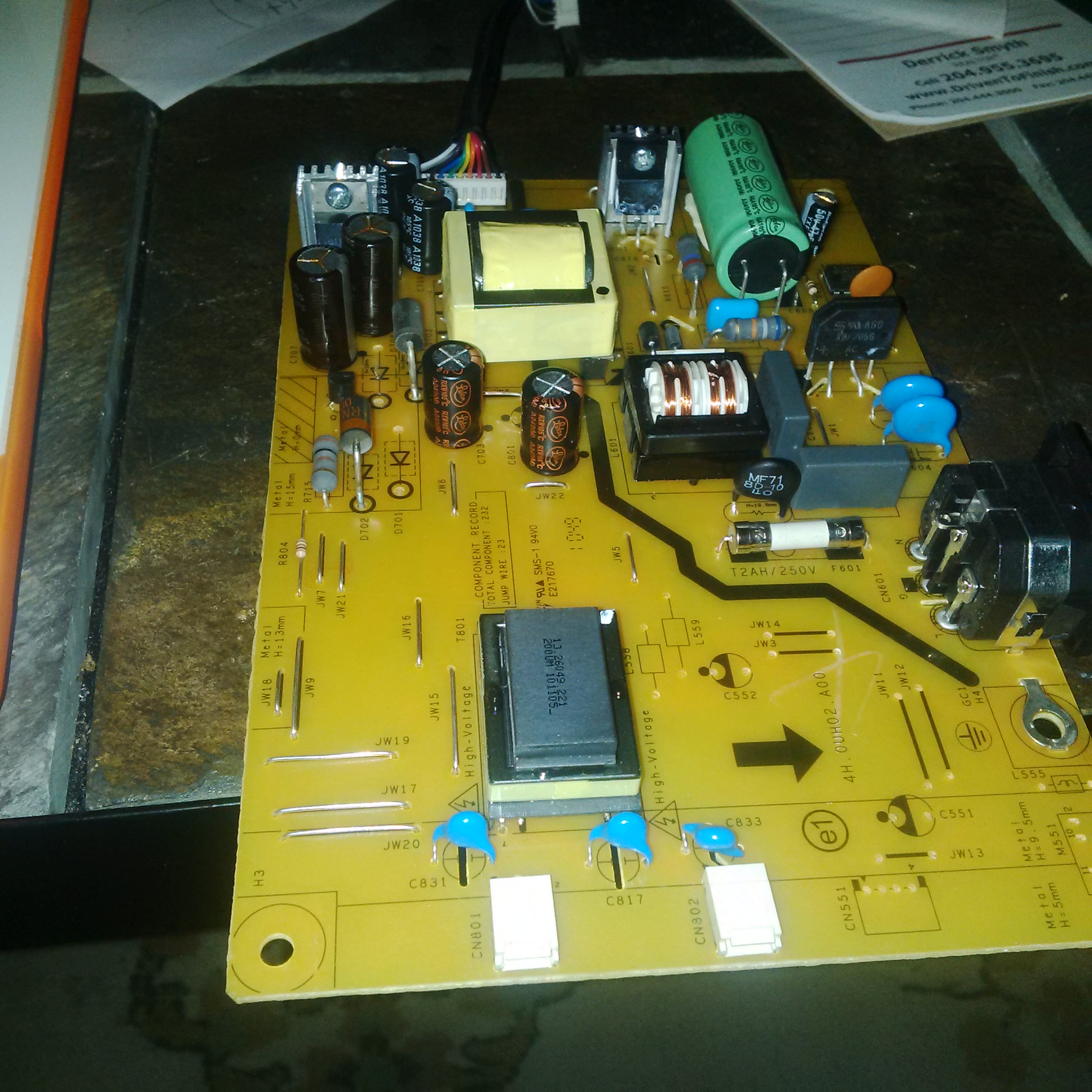

                        I attached a pic of the motherboard. I didn't have the 2 - 330uf 35v caps to change, but I put in 2 - 330uf 25v Rubycon caps I had to test for a few seconds. Same result. Removed the Rubycons and put the originals back in.
                        Question: Why would I have constant picture plugged in one way but not the other?
                          not sure why it works one way but not the other.
                          It may be that the board turns one bulb on just ahead of the other.
                          I expected to see four bulbs but it look like you only have 2 which used to be in the older 12inch and 15inch screens
                          Picture looks like 801 should be the top bulb and 802 should be the bottom one
                            Can you show the bottom side of the board? I still think you do have bad connections at the end of the lamp.
                            The first picture you have on post 4, it shows that both lamps are on the top of the LCD panel edge only and no lamps on the bottom edge of the panel. Is that right?

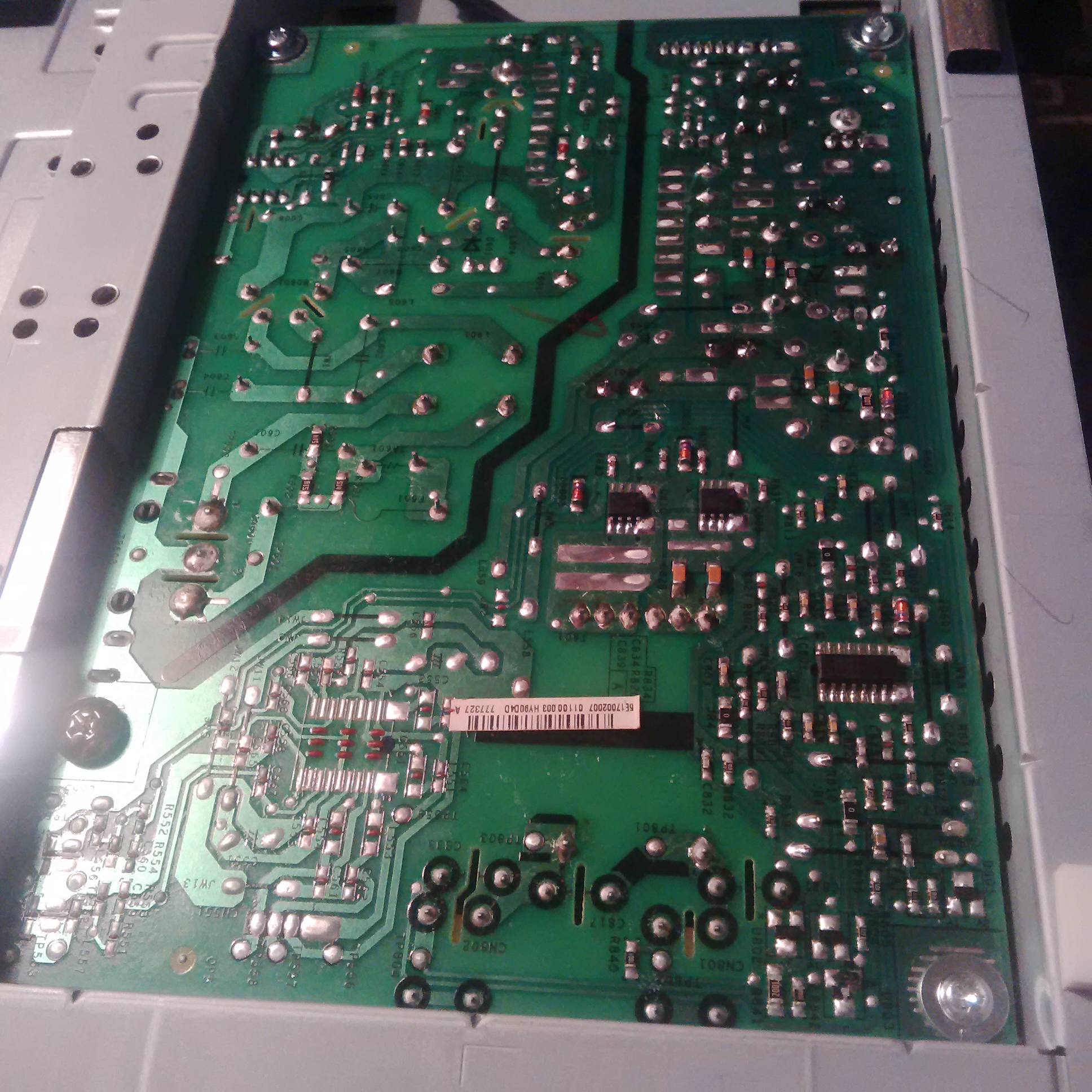

                                Budm, here is the pic. Also I noticed there is some blue caps before the connectors on the mainboard. I haven't metered them yet. I wonder if one for those is faulty. The connections for the backlight are on the side of the panel and the ribbon cable is to the top of the panel.
                                EDIT: I metered the 3 blue caps. 2 are reading 0. That could be my fluke, but one is reading open. I metered the same caps from a working board on a different type of monitor and they are all reading 0 on my cap test. Using a Fluke 113 that has capacitance test.
                                  if you have a shorted cap, the tube will get hit with the full output fron the transformer inc the dc component - that could stress the fuck out of it!
                                  the caps are to block the dc-component so the tubes are just getting the ac pulses.
                                  try desoldering he caps, then check them for resistance.

                                    My meter can't read in pf. Just reads 0. So I am assuming these caps work. But after assessing the board closer, I found a cracked smd transistor. Now to find out what it was. The letter are A4W on it. Crossed to a BAV70. Need to find one off an old board I have laying around.

                                      BAV70 - double diode with a spec just under that of a 1n4148.
                                      well a pair of them!
                                      meter the caps on resistance-test not capacitance.

                                        The blue caps don't show any discoloring signs of having run hot so they may be ok
                                        The a4w is probably sensing current telling the controller chip that the bulb is on.
                                        if one of the bulbs was arcing, it could have caused that a4w to cook ??
                                        Maybe when you swap the bulb plugs you are putting the good bulb on the side that that burned diode was on and for some reason that allows it to stay on ???
