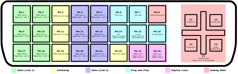

    I have tested it and found out, that on the VGA input works great, but on the DVI input, the DVI logo flashes for a second and it keeps repeating this on and off over and over.
    I have tried different PC, different cable(though the same type from monoprice).
    It could be that the cable is missing some pins maybe?

          The problem with the adapter is, that it has those four pins next to the big flat one and the monitor doesn't have those four holes.

            theres two adaptors? dvi-i and dvi-d one has those 4 pins one doesnt? just a thaught.

              There is one without, but I'm looking around Amazon and reviewers say, that they don't work, I don't understand why.

                        This might help http://nvidia.custhelp.com/app/answe...i-and-dvi-d%3F
                        Looks like the dvi-D on the monitor is digital in only, so as long as the video card outputs the digital signal it should work. thats why most adaptors don't work because they convert the dvi-I analog signal only to vga. or vga to dvi-I.
