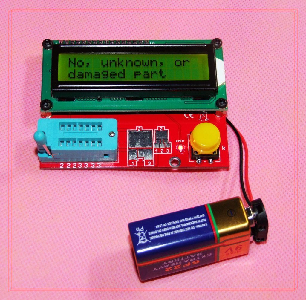

                          normally a transistor will short out or read open on diode test on your meter. on eBay, there are some transistor testers you can buy. This little device work great and it will give you an better idea what going on with the components you are testing.
                          those reading for that transistor maybe OK. I can't say for sure I don't have a one new

                              Re: Testing the c5707 transistors
                              Thank you ecking767 I'll look into that.
                              This is a big jungle out there, here are few I found
                              http://www.ebay.com/itm/Transistor-T...item19e21c8b66
                              http://www.ebay.com/itm/Peak-atlas-D...item3f1f6efb03
                              http://www.ebay.com/itm/Transistor-T...item19e734f236
                              http://www.ebay.com/itm/Mega328-Tran...item1c3f58273d
                              Should I get the MK-168 or the atlas one, they kinda look
                              the nicest but are also the expensive ones.
                                      Originally posted by Davi.p
                                      "Okay thanks, it is quicker and easier to test them in circuit"
                                      This is valid only for this particular board configuration eh!
                                      And you just had to burst my bubble
                                      If I buy the transistor checker I have to unsolder them anyway.
