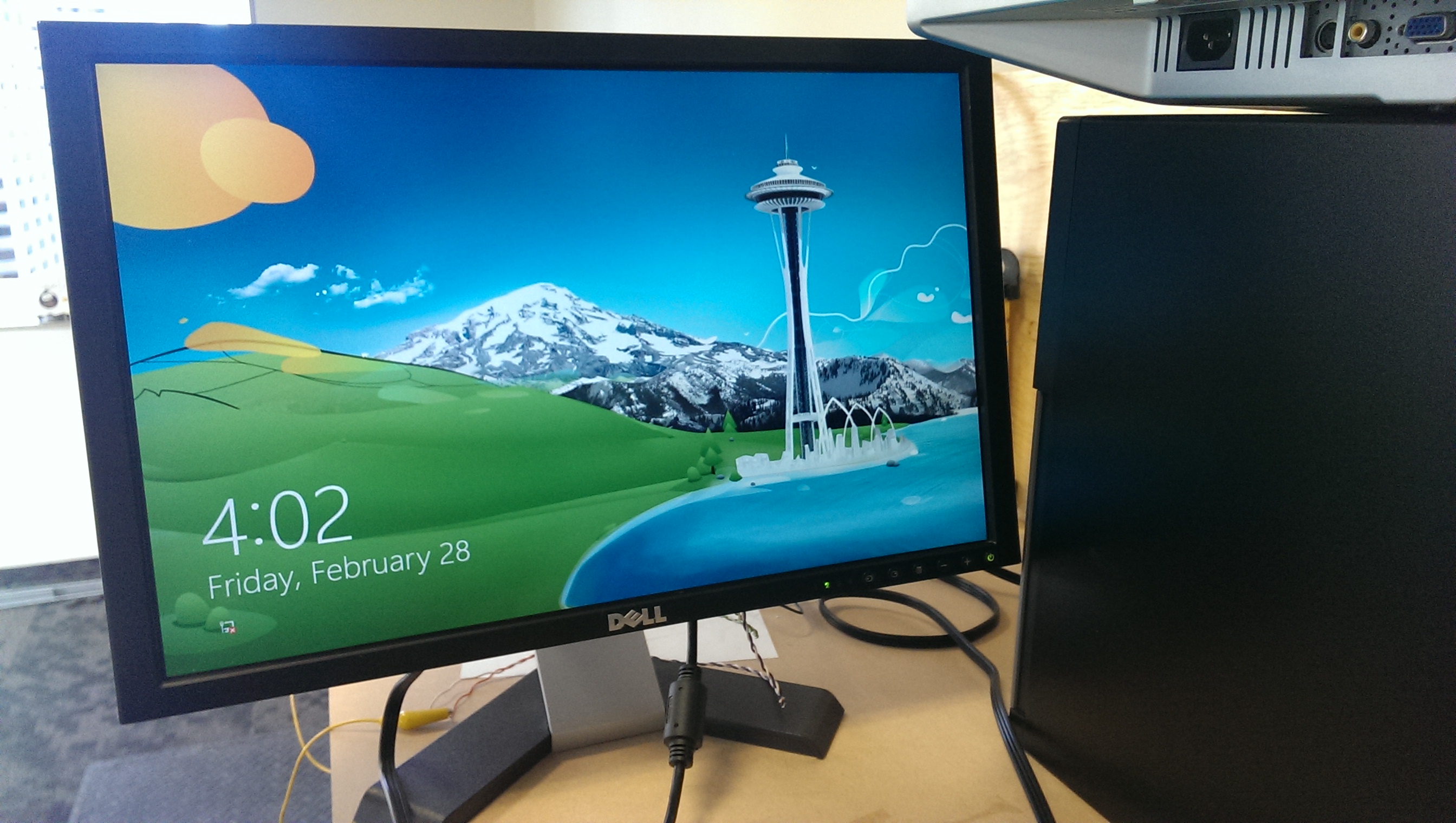

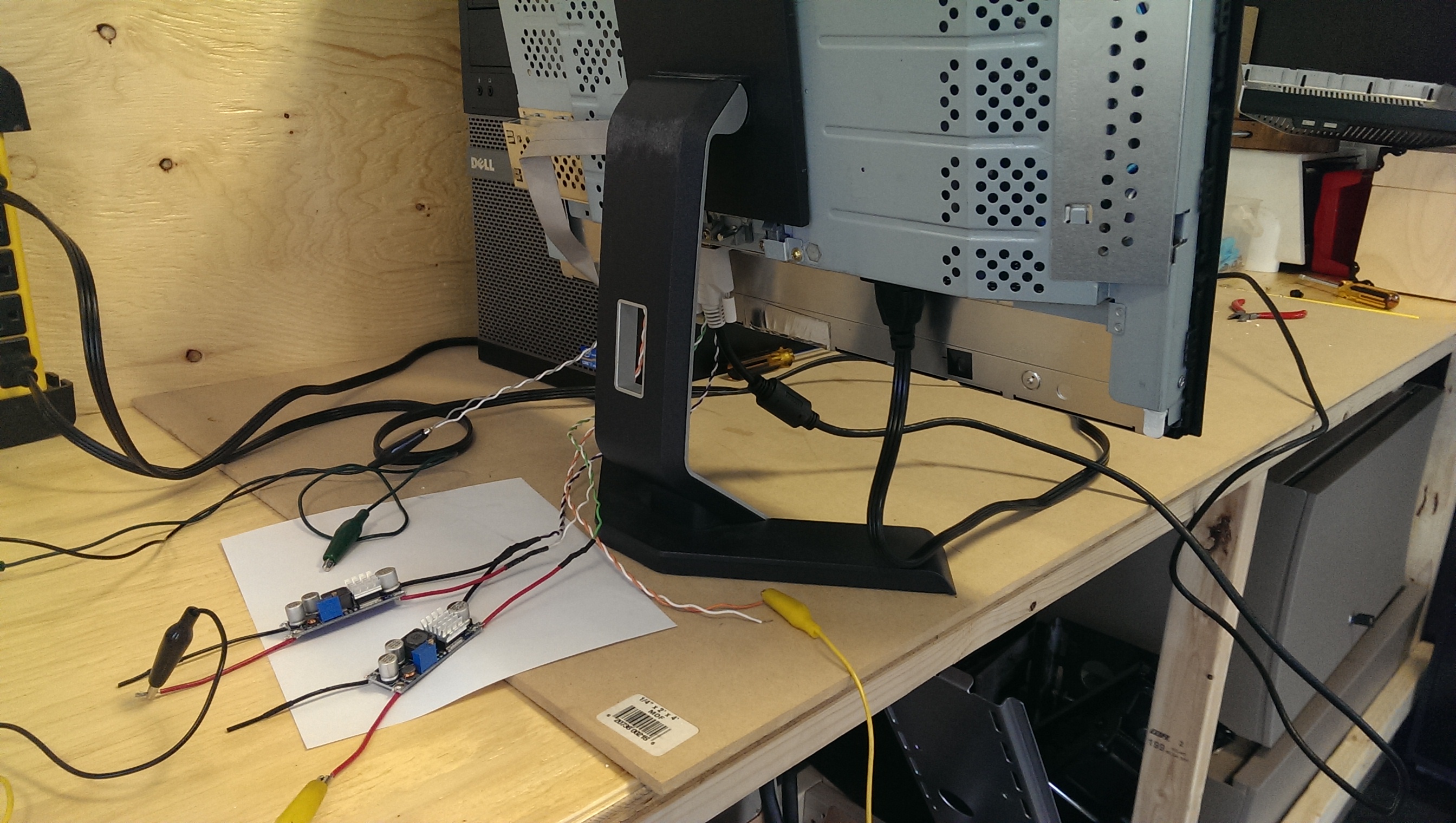

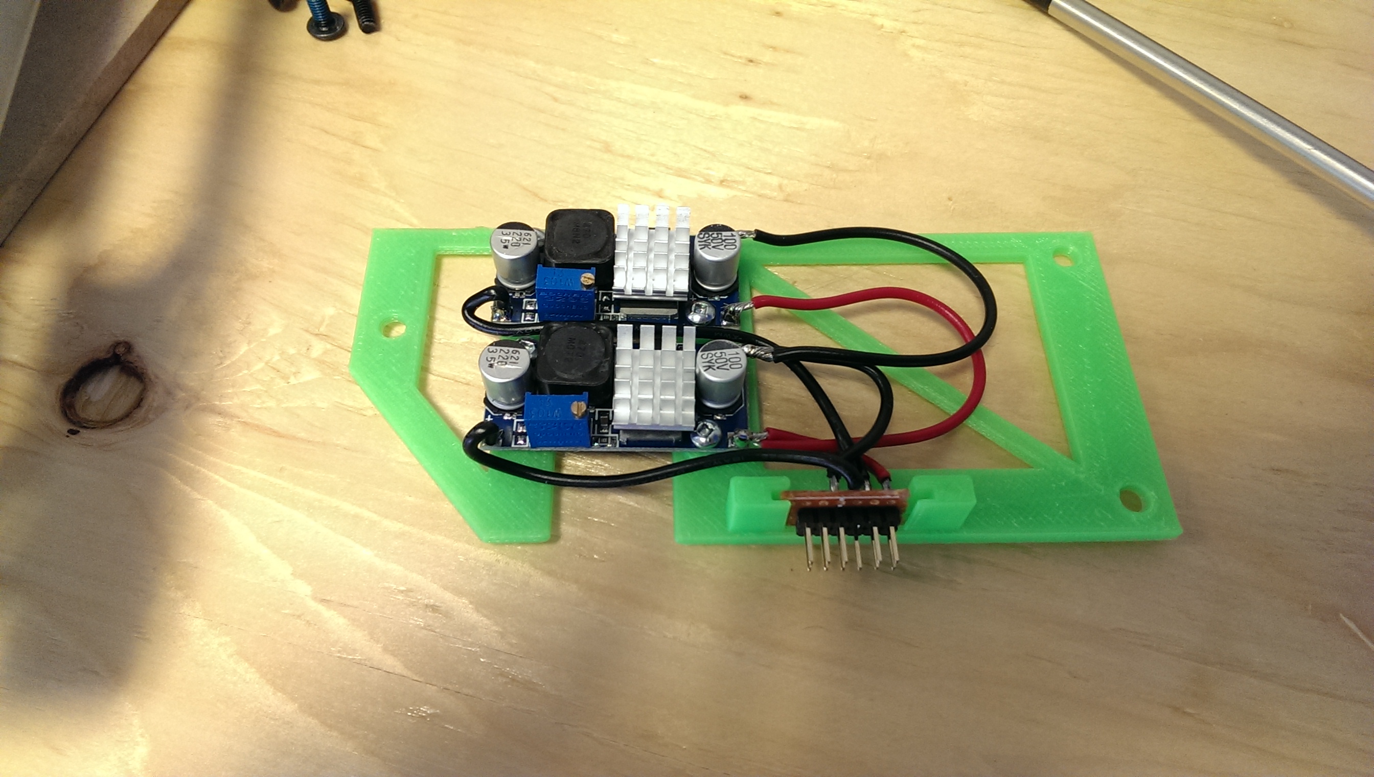

            Just a quick update - I have done some further testing and have what appears to be good news. After reading the other posts again I saw mention of one fellow replacing his large usb / power board with universal DC-DC converter boards I decided that it was worth a try to do the same with mine.
            I am worried that in removing the silicone from the power board to replace the resistors will damage something else so I have shyed away from trying this.
            I swapped in 2 cheap deal extreme DC-DC converter boards and was able to get one of the monitors to power up and display the input selection popup (which was more than it would do before!) so I'm going to test the other one and if it seems okay I'll fabricate a bracket to hold these boards permanently and do some sturdier wiring, mount it all up and bring it to my desk for proper testing. Hopefully I'll have some results soon

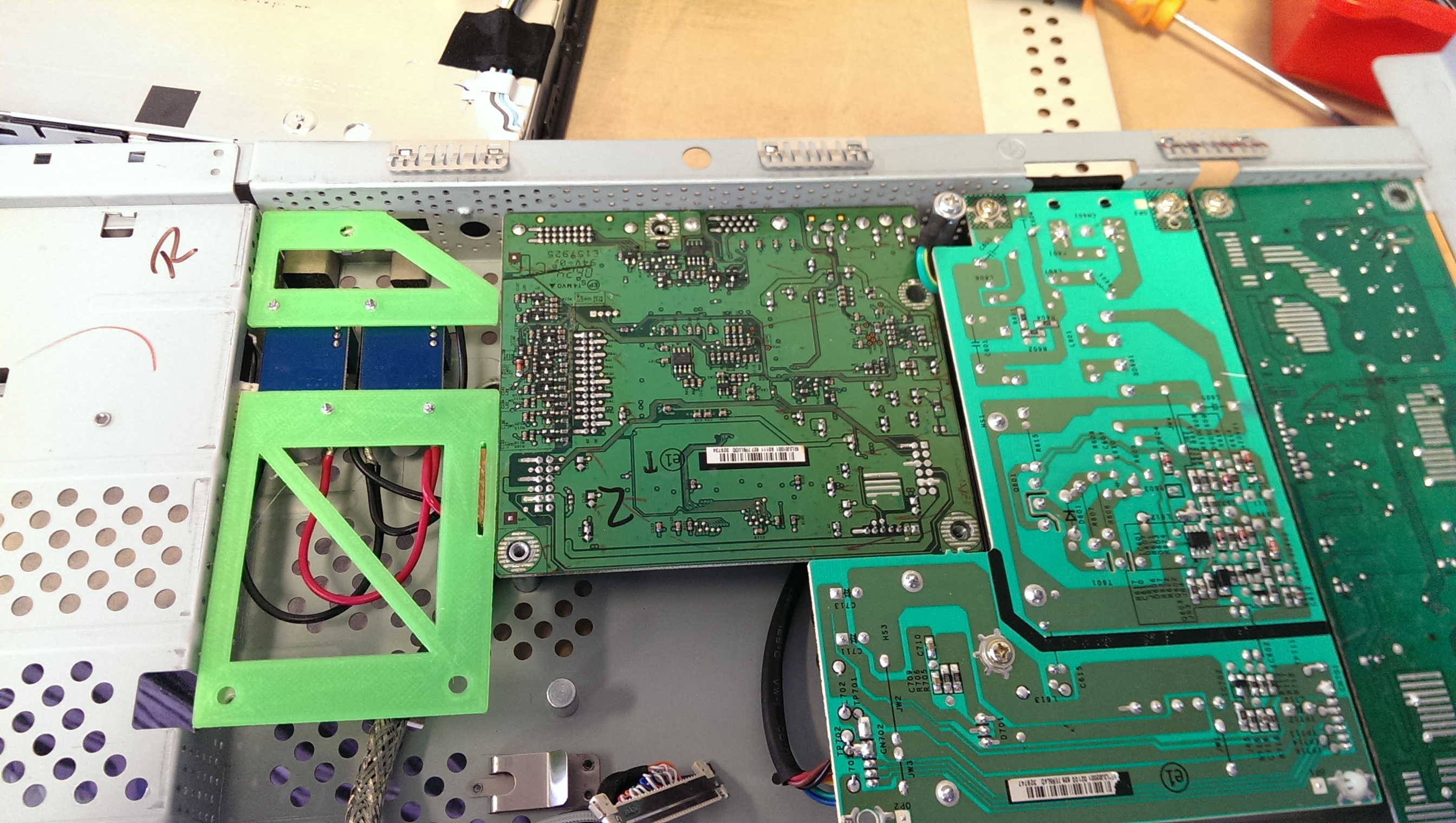

                  Sure. I don't have great lighting or more than a camera phone here at the office today so this isn't a troubleshooting picture, just a "here's what's wrong" picture
                  I have attached a picture of the failed resistors (mostly still entombed in silicone) and the monitor running with the makeshift power boards hanging out the back. I noticed that you don't actually need 5V for the monitor, only 3.3V and 12V so I reduced the board count to 2. So far they have been running 30 minutes and the heat sinks on them (which I applied) are at about 50-55*C. A little warm for my likes, I'll probably use higher current capable boards when I do the permanent repair, or actually repair the Dell boards themselves.
                  In the picture of the board with the silicone the resistors towards the right of the white strip of silicone have failed. One board has 3 bad resistors, the other has 2. I can scavenge the parts from one to fix the other, and if successful can order new parts for the part donor board, but I don't want to go digging in the silicone and damage the traces so I'm going to try to remove it chemically with little force. If successful I'll move ahead repairing the dell boards. If not, these cheap DC-DC regulator boards seem to do the job, the monitors just lose the USB hub and speaker bar power (not that I care)

                    Interesting set up - still wondering why the silicon is there - its not holding anything big in place - perhaps some high voltages on the big IC? so its to stop accidental touching.
                    With it set up do you have full control of the screen - dimming, colours and so on?

                      I use Silicone sealer which is in liquid from for sealing the grout, it soften up the silicone and you can just brush it off. So those resistors that failed, what are there values and do they fail open or shorted?
                      There is no high voltage in that area to burn up resistor in K Ohm range. The silicone may be used for moisture protection since it is in the high frequency switching circuits that drives those MOSFETs for the Buck regulator circuits.

                        These resistors are not in a high power part of the board and they have gone open or very high resistance. Interesting that the other identical setup on the board is not covered in silicone. I wonder if with such small components and the silicone insulating them thermally if they eventually overheated and failed...?
                        The failed resistors should be in the k range, I don't have the board in front of me but I think they were 2.7k, 4.7k and 14k, but don't quote me on that
                        With my current setup everything works on the monitor, dimmer, multiple inputs, pip, everything that I could think to test.
